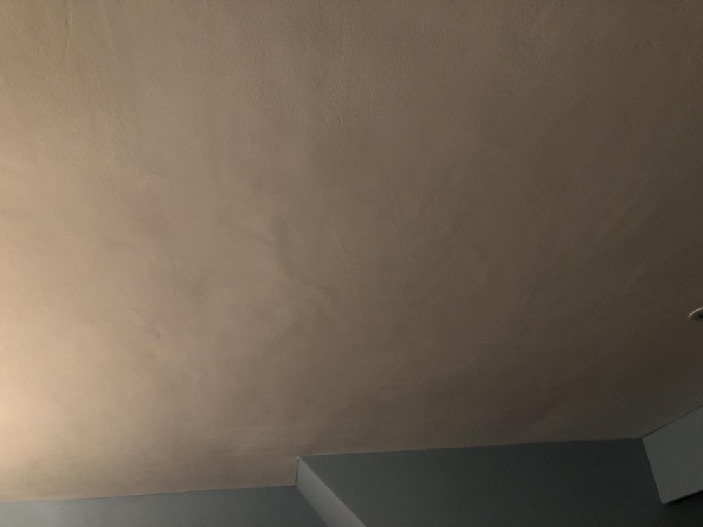

Hi,
We are on the cusp of really falling out with our builder.
We have had to move into the house which is way over schedule, they are just finishing off the decorating.
In many man places the wall finish seems unacceptable.
The architect came in and made the builder reskim and repaint two ceilings.
But the more I look at the walls and ceilings the more the finish looks poor. Basically the finish is rippled in many places as well as having many rough patches.
I am not clear who is doing a poor job, the plasterer or the painters, but ultimately the builder is responsible. My wife wants the painters fired, the woodwork doesn't look great either tbf. They have not primed the edges of MDF in the door frames so it looks very poor compared to the ready primed woodwork.
We have paid an absolute fortune to have all walls and ceilings painted as it is supposed to be a better finish, but in most places it actually looks worse than our previous house that was taped.
I don't want to be unreasonable but the finish is letting down, what is a very expensive build.
I noticed in my last house the painters had some kind of large spinning brush sander that they took across the walls before they painted. Here they just seem to be going around with filler and sandpaper.
The builder says just to leave it until snagging time and indeed the architect has decided after some work has been redone to just do the same as he wants them to finish and not delay any further. The trouble is that we won't really be finished if they then have to come back into every single room and start sanding and repainting. I just don't understand the attitude of the building trade that you do a poor job and then keep coming back to redo it.
Any thoughts on where they may be going wrong?

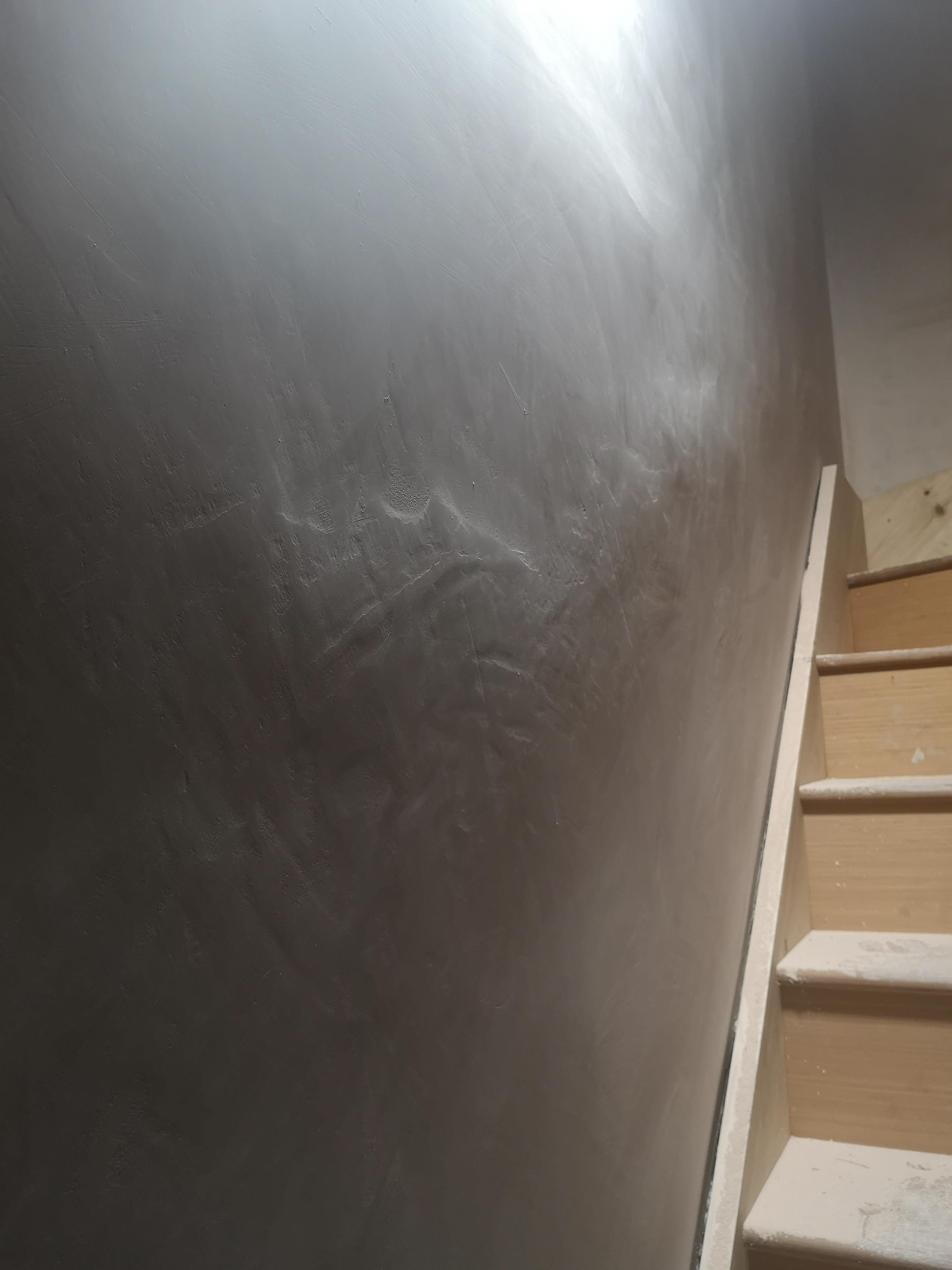

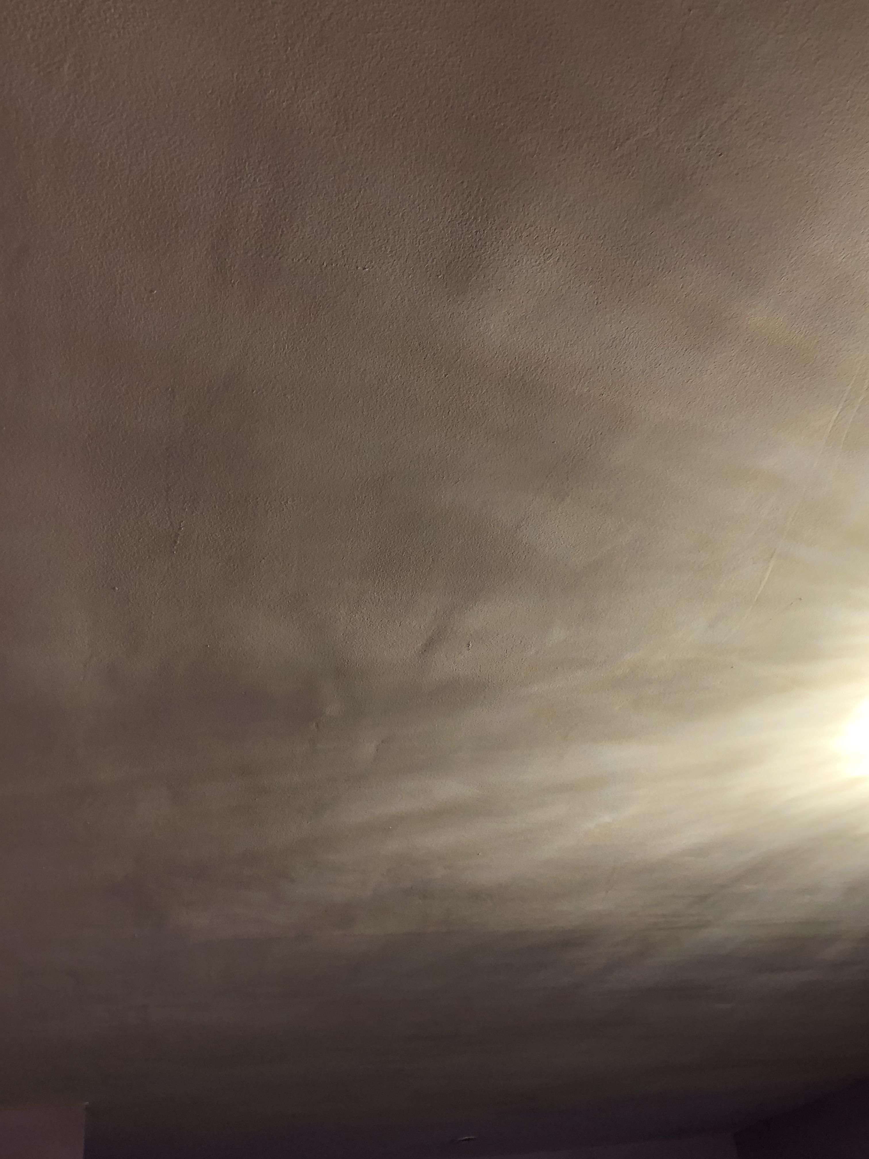

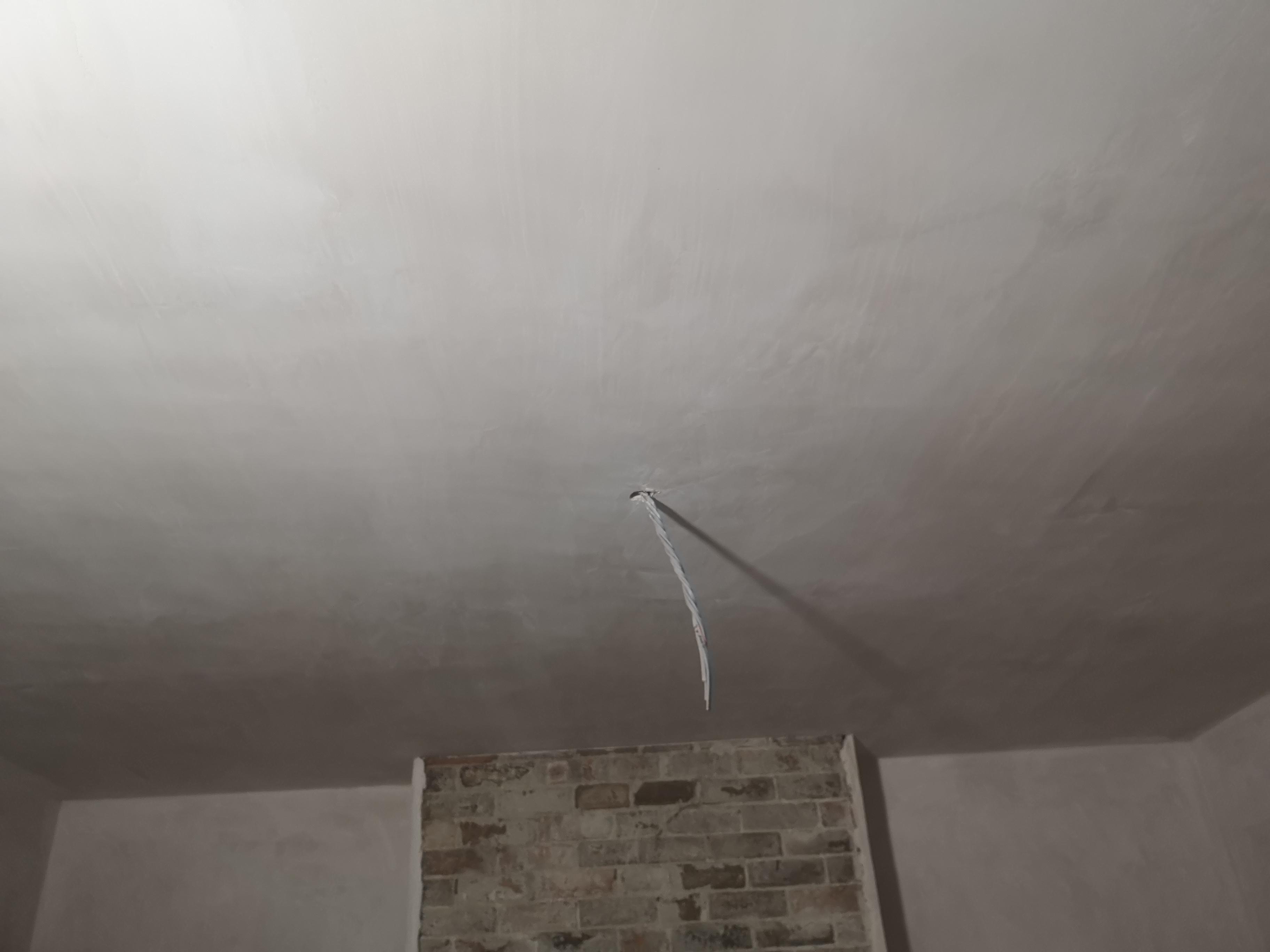

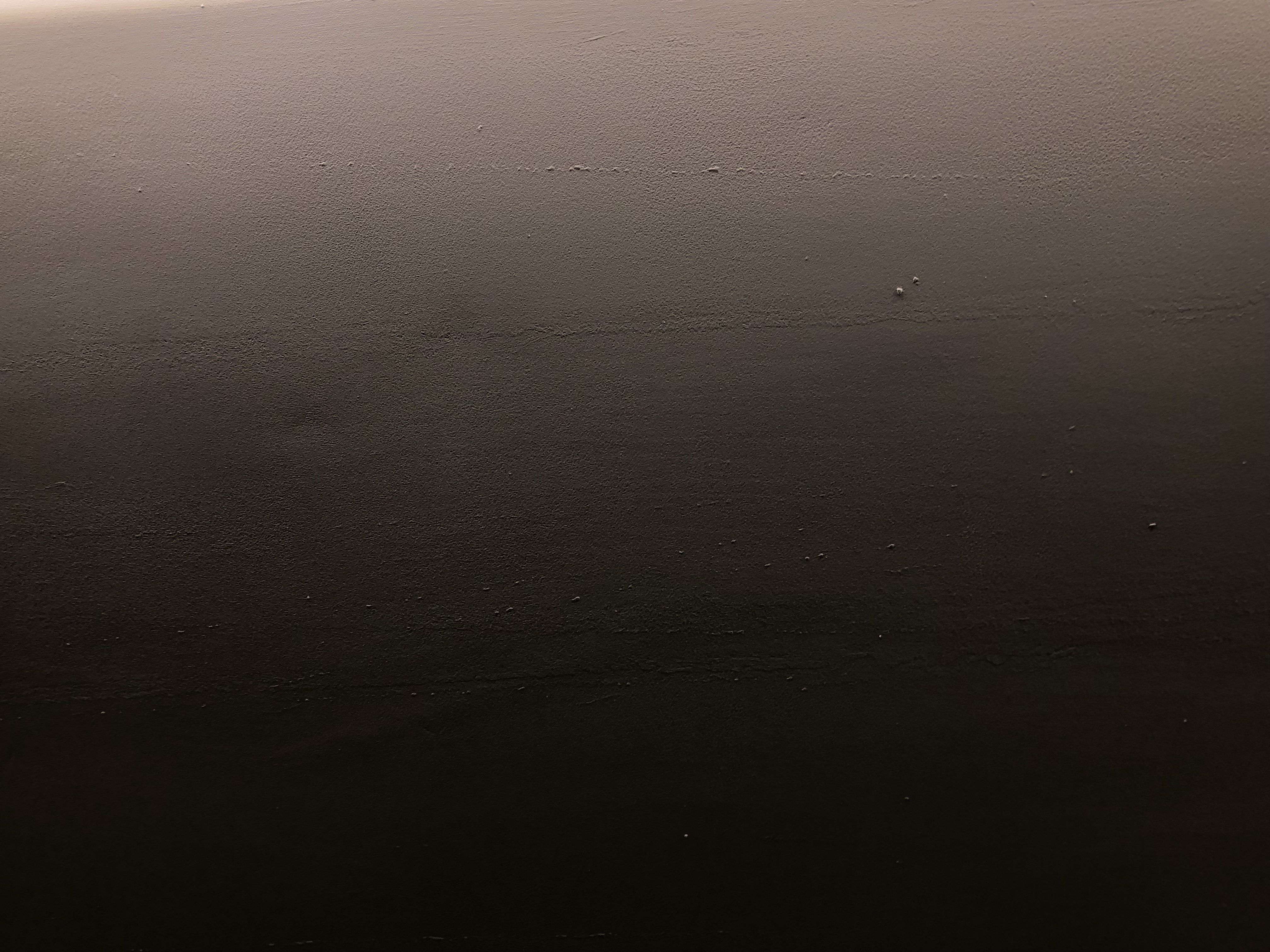

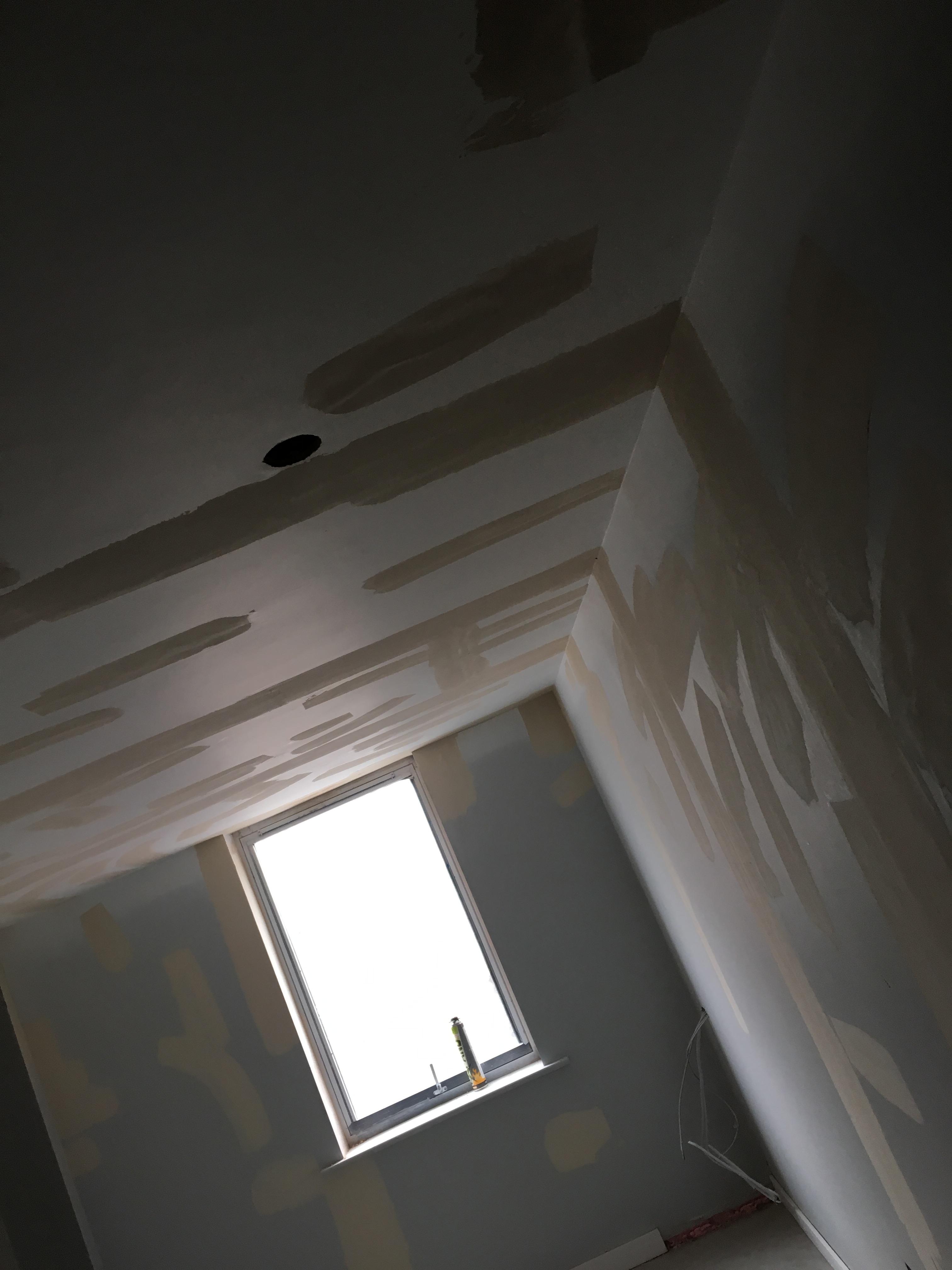

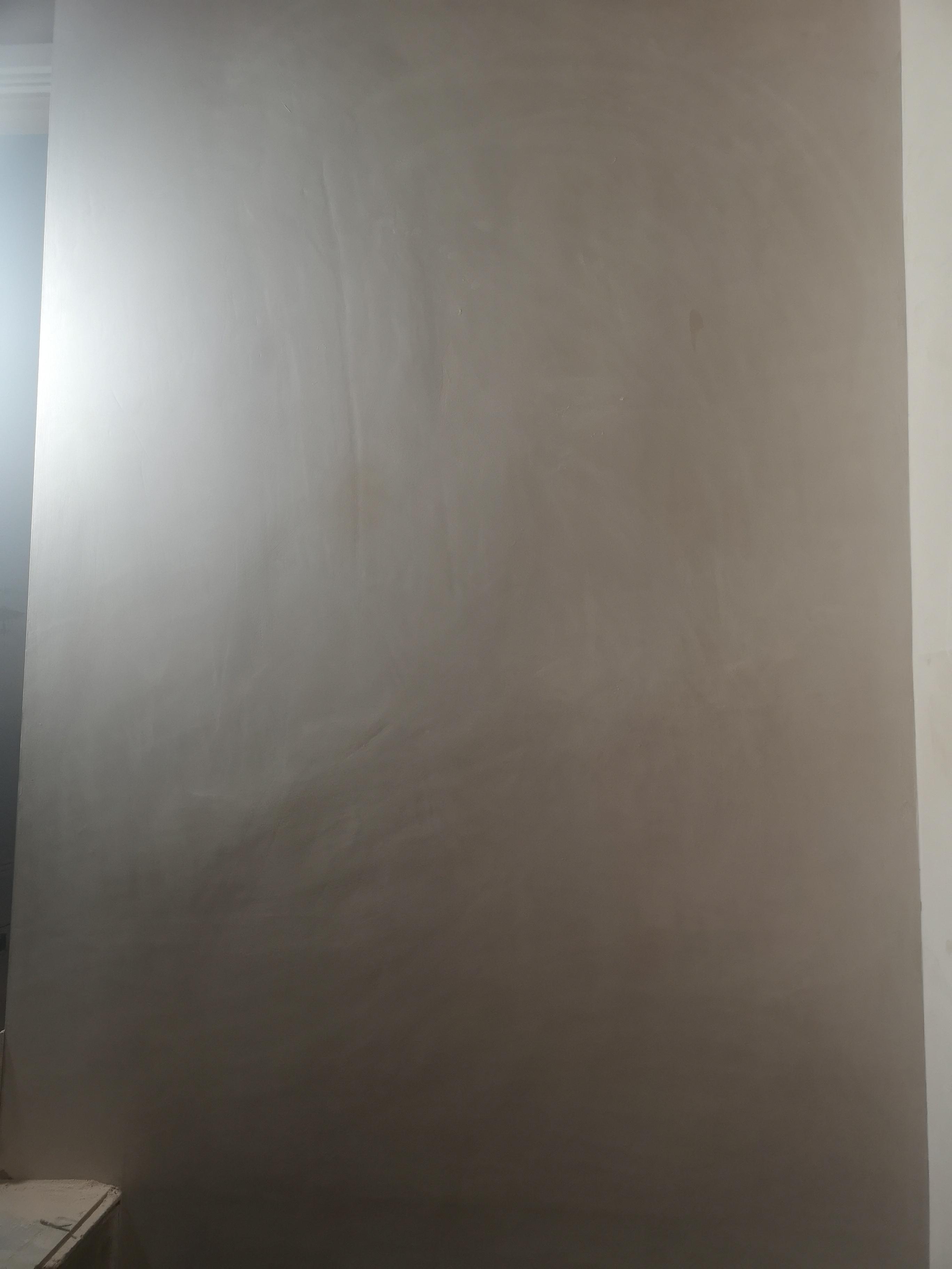

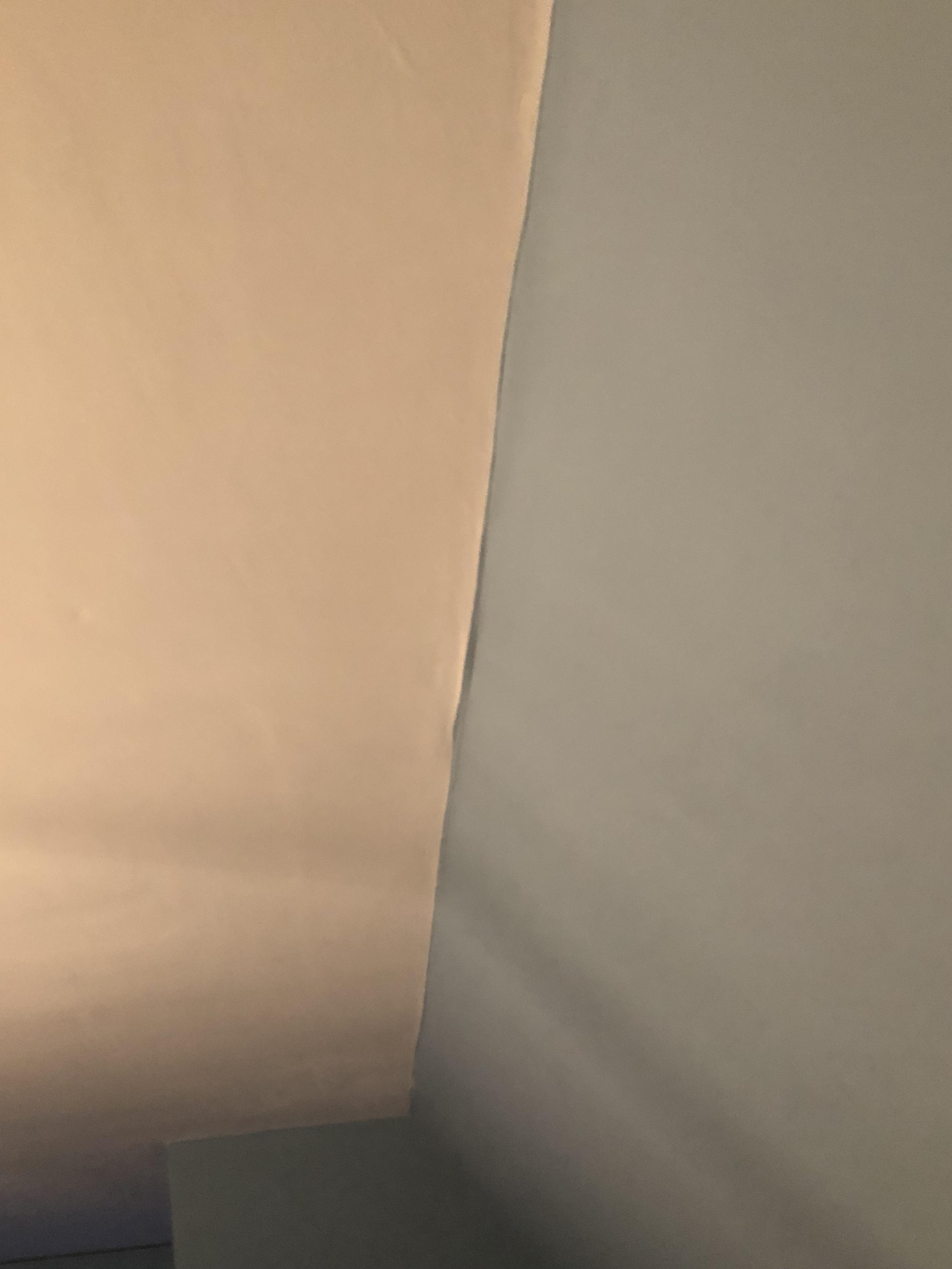

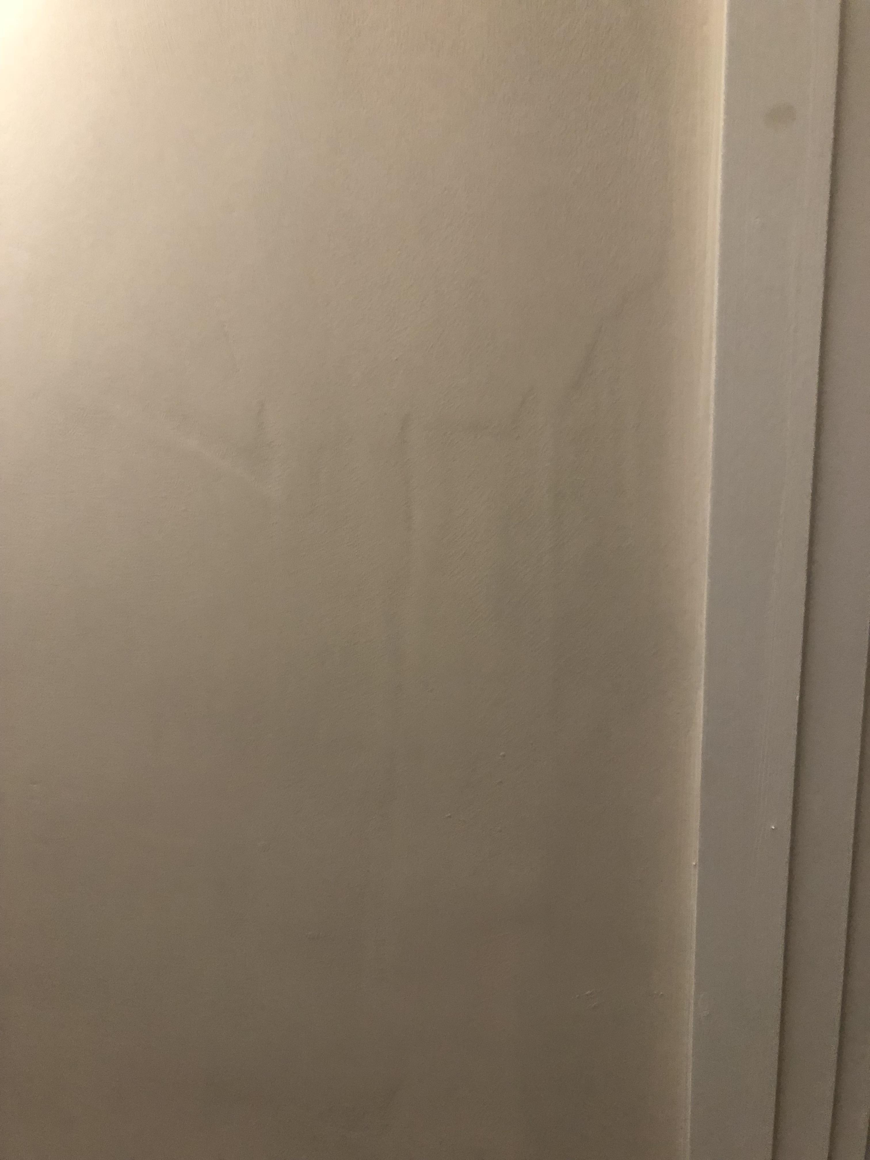

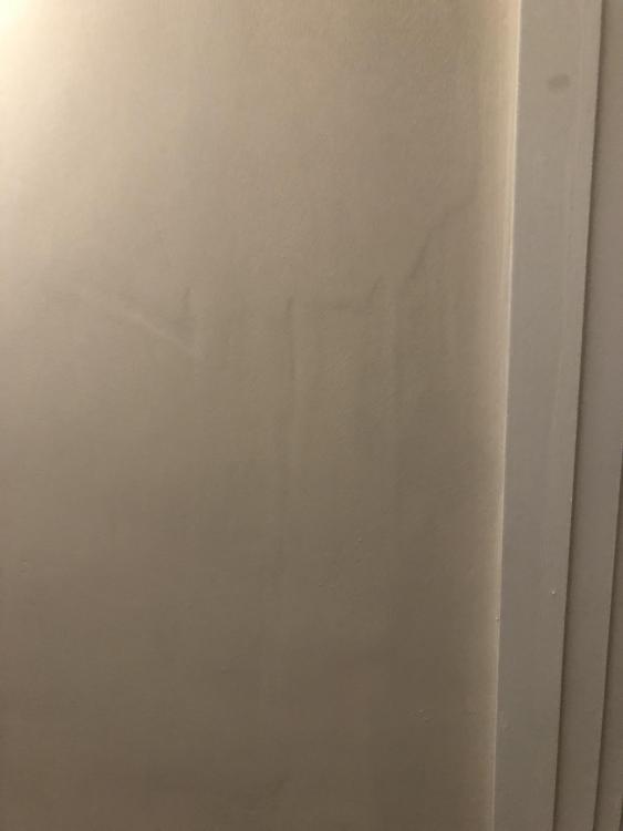

It is quite hard to capture this in pictures but I just had a go
This is the reskimmed and painted ceiling (I think they plan to further sand and paint it)
My daughter's bedroom
A 45degree joint
This is part of probably the worst wall in the house
My daughter's ceiling again

Firstly, a properly skimmed wall or ceiling needs no sanding. It is totally different to taping and filling where a soft filler is used and sanding the joint is normal.
Sorry to say, you need a different plasterer.  It really is a job where you want a personal recommendation. We are pleased with the plaster finish in our house, but I knew the plasterer.
I know you contracted the job to a builder so did not employ the plasterer directly, but he would have been off my site by now.

The builder's argument is that it was dark when they were skimming, but I said that was nonsense as often people must plaster in far from ideal light conditions.
TBF I couldn't see the imperfections then.
The painters put a mist coat onto the walls which is supposed to highlight imperfections before painting, but the that wall I described as the worst one they just went ahead and painted last week.
All the skimming was done some time ago, the poor standard is only coming to light now that we are in and they are painting which highlights it.
In some areas it is absolutely fine and as it is a large house there will be areas that need redone, but some areas are just laughably bad. In our last house we had ceilings skimmed after leaks upstairs and they were absolutely immaculate.
When shown bad areas now the builder just says that they will come back and sand them down.

I'm no expert in this - but I wouldn't be at all happy with this finish.
Our place was skimmed by a pedantic, perfectionist plasterer (and team) then spray painted with three coats of white emulsion with no sanding or other surface preparation required. The resulting walls are almost optically flat. To me this looks like an issue with the quality of the plastering. The fact that your architect has seen it necessary to direct the builder to re-skim a couple of ceilings already speaks volumes. A competent plasterer who take pride in their works doesn't need to be told.
I agree with Dave Poor
No sanding
I skimmed five bedrooms last week There will be no ripples or filling
To many are one coating and running over the skim with plastic float or spatula

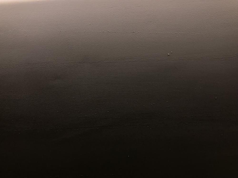

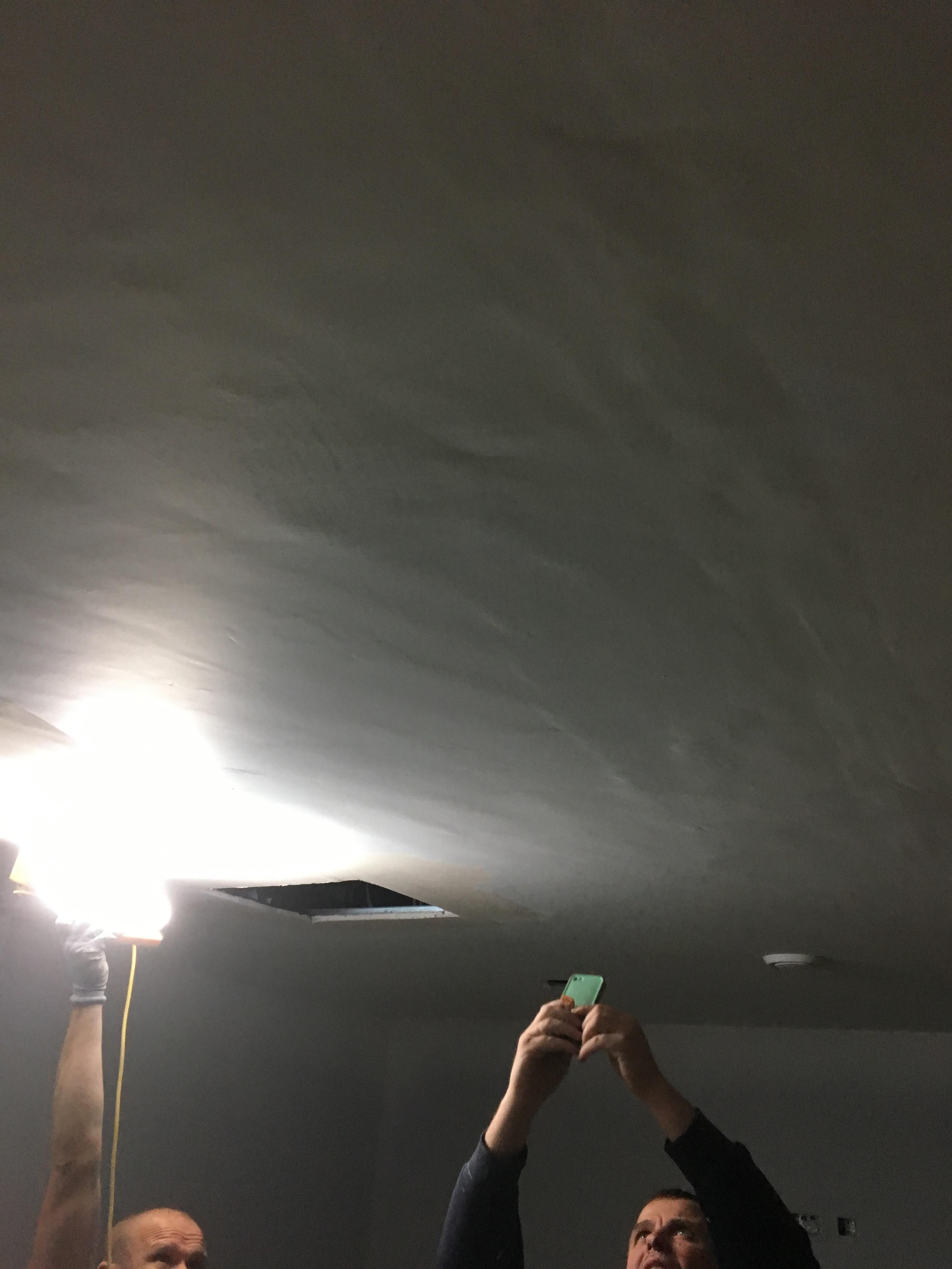

This is one of about thirty large ceilings that I quoted to redo on a block of apartments
We just redid the worst ones
The agent said they looked good till they were painted
Speed floated
The irony was that we were undercut for the original job
  • Like 1

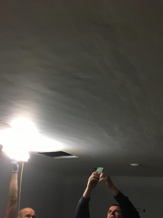

The two guys in the picture are Russian tapers who do taping and jointing for me
They had stated to fill some of the rooms as the contractor was addament he couldn’t afford to have the lot re skimmed
Vlads Dnglish is coming on
Whdn I showed him the ceilings
He said OH F***
  • Haha 1

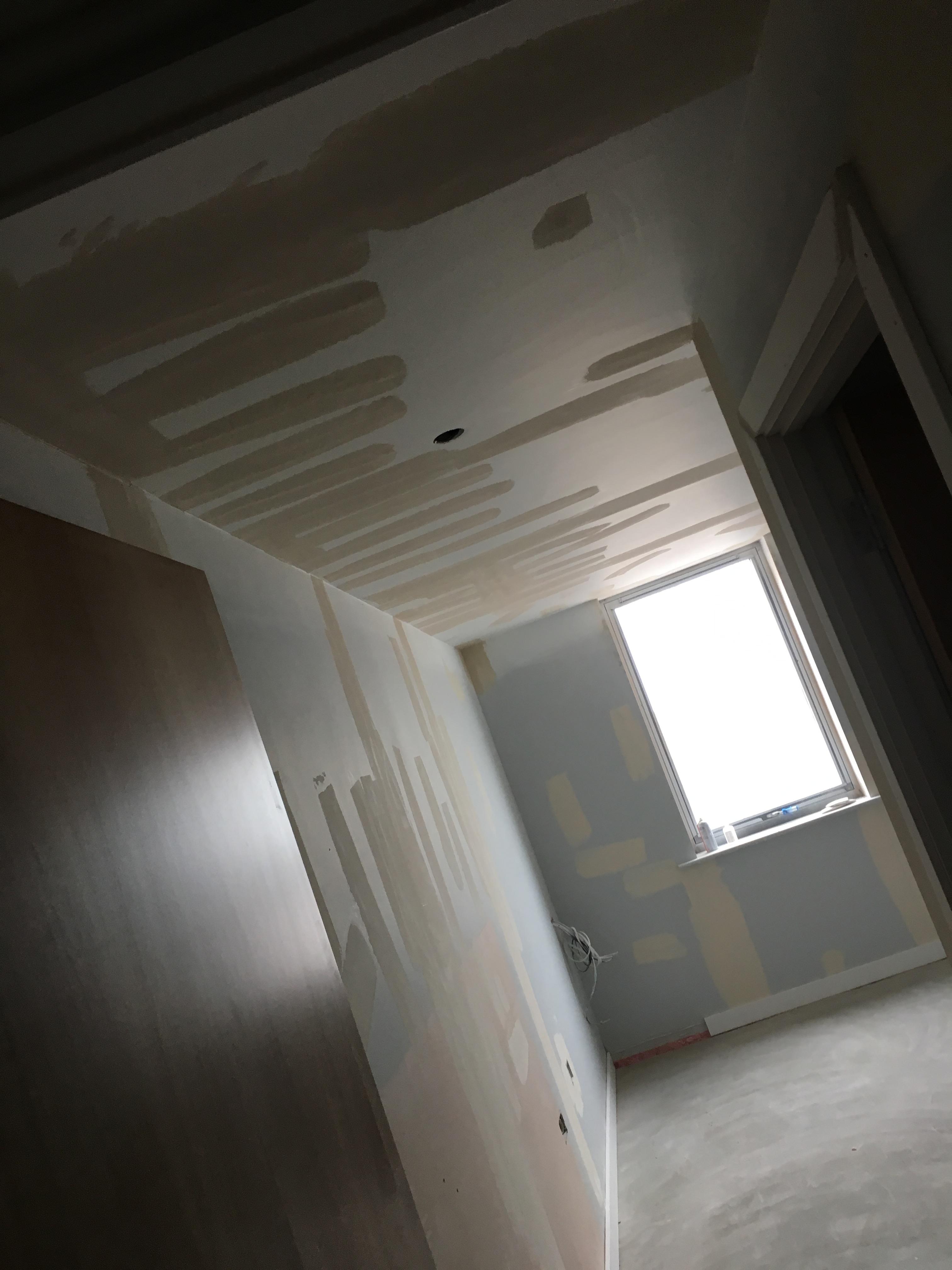

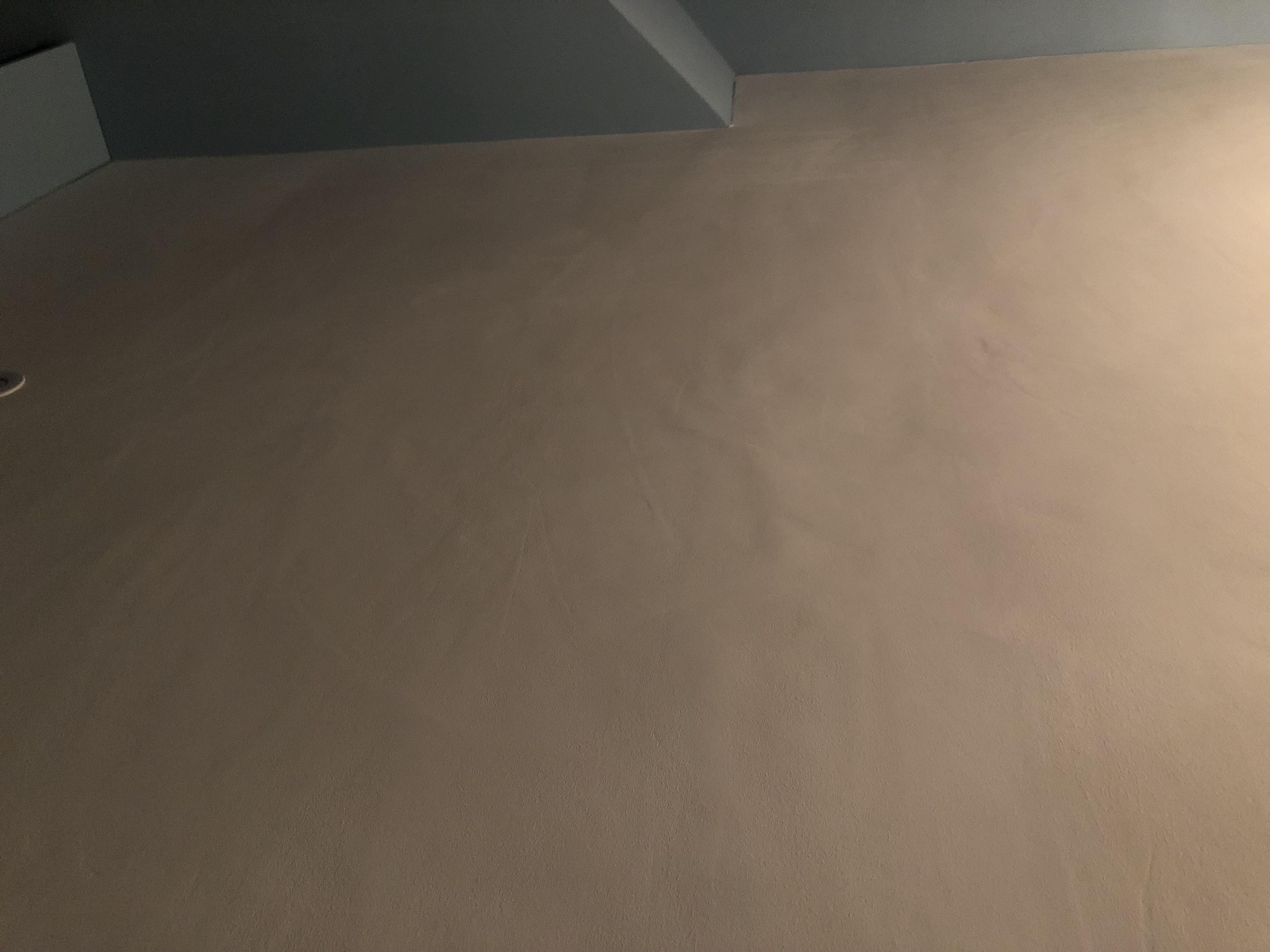

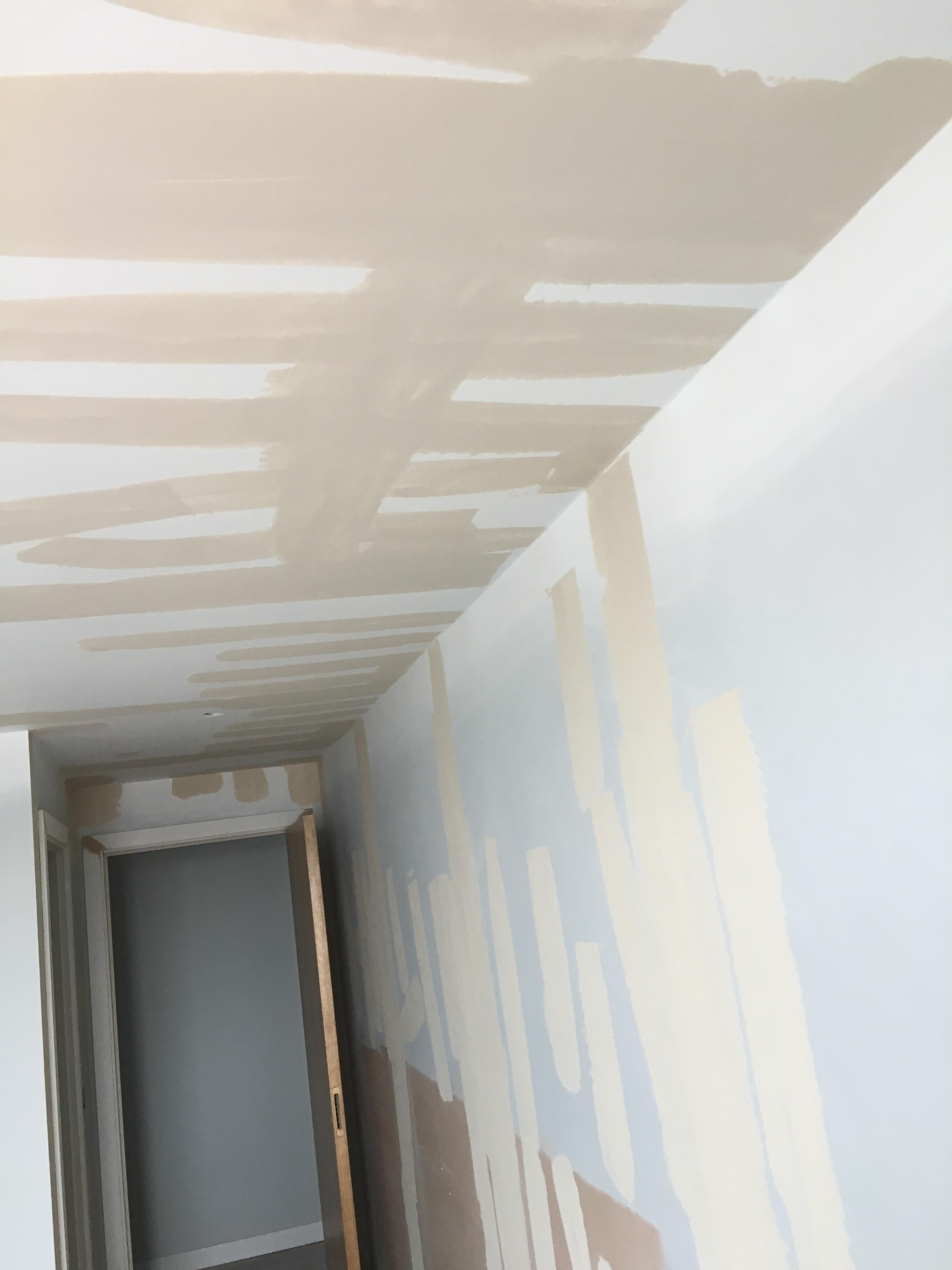

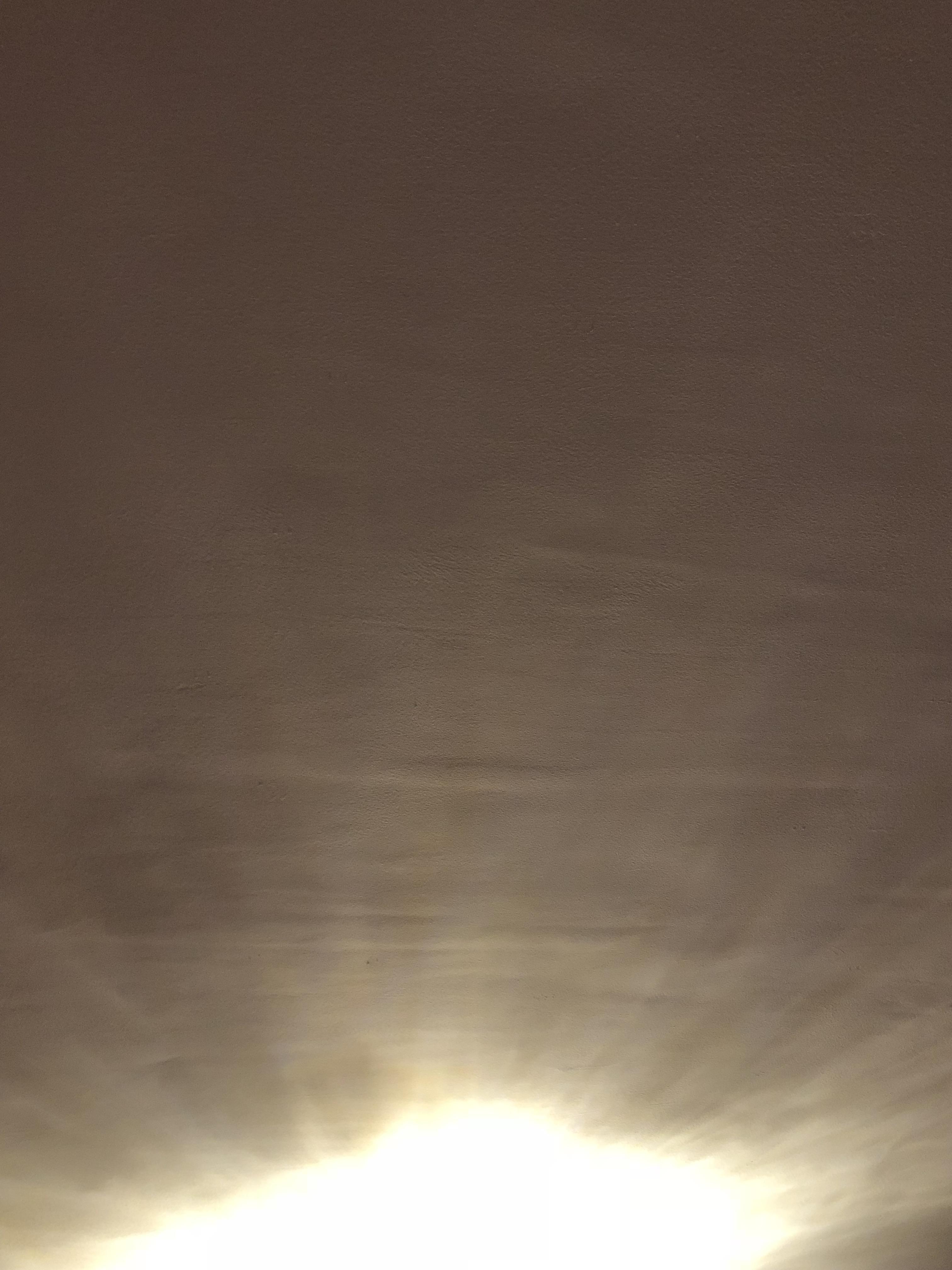

I had just a quick reccie round the house.
Spot lights are the plasterer's friend. In the rooms with spots either the ceilings are much better or you just cannot see it as they don't create shadows on the ceiling.
I don't know at what point it is considered unacceptable.

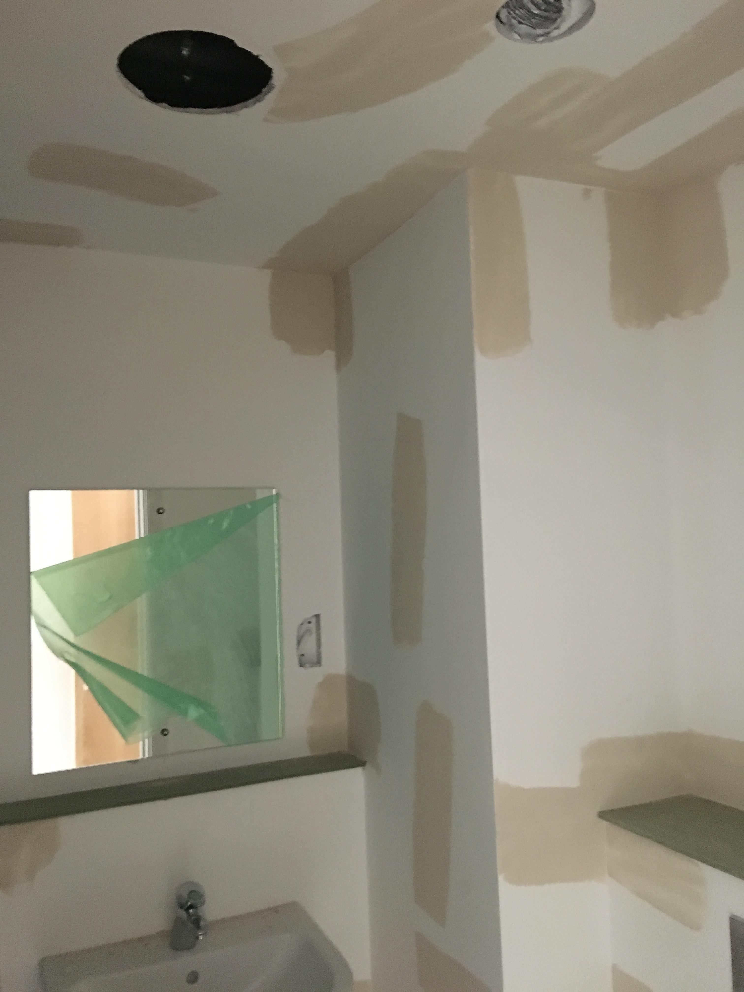

I took a picture of a room that isn't perfect but might be considered passable?
I looked at the redone lounge ceiling. It was done by the guys who rendered the outside of the house where they have done a fantastic job. It is now flat but has a few lines in it as shown in the picture above. I think that is the kind of thing that could be fixed with a little sanding but you cannot fix an undulating ceiling with sanding.
I'd guess around 10-20% of the plastering is poor if I look at the whole house.
Edited by AliG
Speed floated
It's not quite that bad but close in some places

You think they look bad now if you fully paint them up and let them sit once the sun hits them you will regret it. They will look woeful.
Let them redo 1 wall/ceiling and if it ain't up to scratch then inform your builder they are gone and for him to get good plasterers in.
The working in the dark excuse is horse shit as well. Good plasterers know roughly by the size of the wall/ceiling how long they will have to get the skim on and work with it before it gets to dark to see what your at and won't start a new bit if they don't have time. Also they all have lights just incase.

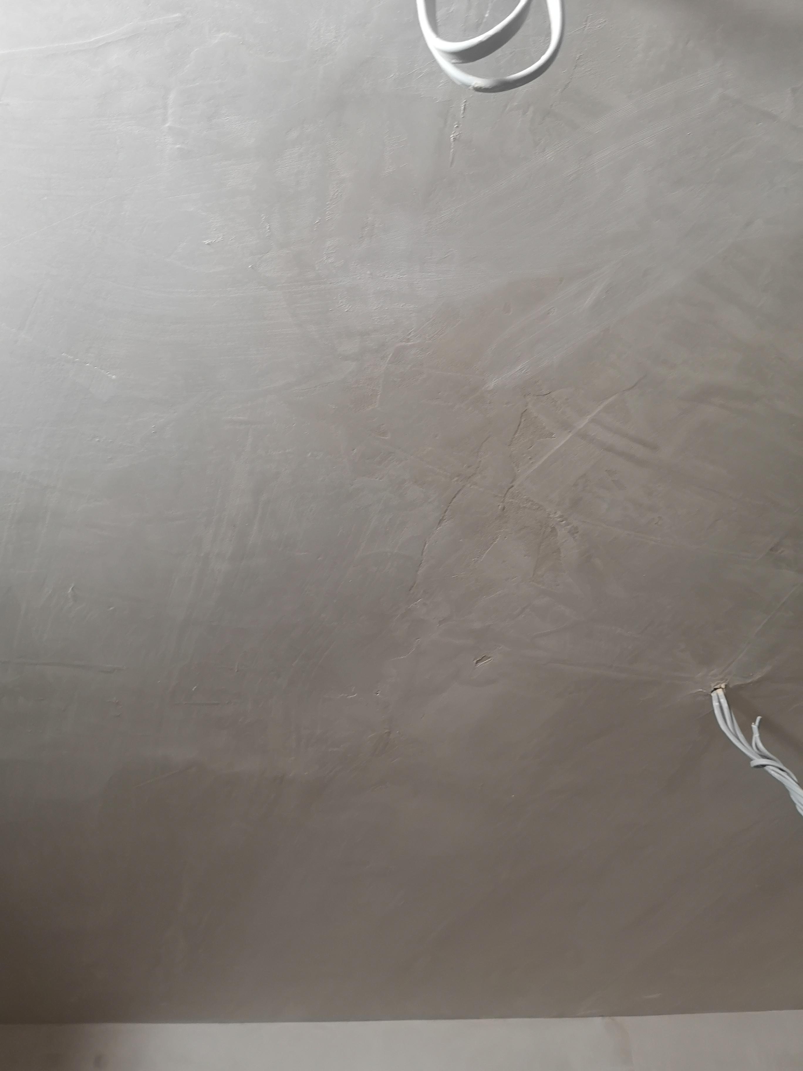

Hi AliG,
I've just come across this post whilst researching bad plastering.

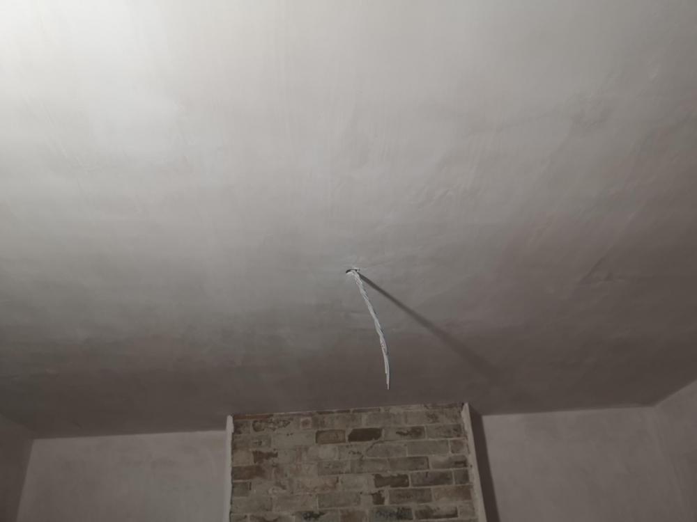

We have had a pretty dodgy plastering job on a huge extension and renovation. We've just noticed, like you, that some of the plastering is really below par. Ripples, bad joins, scrim tape grinning through etc. We've spoken to him and he is quite defensive saying that the mist coat would cover it, but the areas that have been mist coated, you can still see the ripples and scars etc.
How did you get over the issue with yours? Did you have to get your ceilings reskimmed or did you just live with it? We had a bad plastering job at our last house and I know that even when we tried to remedy it, it was still noticeable in places. Are the things you noticed before as noticeable now? We have no interior lights yet either so we can't know what it'll look like once they are in.
All help is appreciated.

I am not a plasterer but can plaster and this is atrocious work. ( there are plasterers on this forum who will give their professional opinion). Not sure what you can do about it now as skimming again is a lot of work/expense depending on who is going to do it as I would not use the plaster you have used again.
Easifill is great for going over slight blemishes but again is a lot of work. Hope you can get it sorted.
