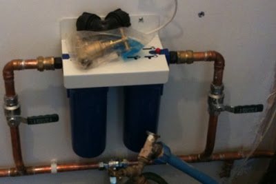

newhome Posted February 22, 2018 Author Posted February 22, 2018 There is an in line water softener (no idea if it works) but I think I’m in an area with pretty soft water (never any scale in the kettle) so not sure whether things have scaled up. The photo was when it was being being installed hence the extra parts on top.

Nickfromwales Posted February 22, 2018 Posted February 22, 2018 1 hour ago, newhome said: There is an in line water softener (no idea if it works) but I think I’m in an area with pretty soft water (never any scale in the kettle) so not sure whether things have scaled up. The photo was when it was being being installed hence the extra parts on top. Are those two vertical lever taps ( left and right ) in line with the pipe now eh ? They're off in that pic. The bottom one ( centre ) should be still off as per that pic.

newhome Posted February 22, 2018 Author Posted February 22, 2018 10 minutes ago, Nickfromwales said: Are those two vertical lever taps ( left and right ) in line with the pipe now eh ? They're off in that pic. The bottom one ( centre ) should be still off as per that pic. Nope they are in the same position as the photo so not sure if they've never been on or have been switched off at some point!

Nickfromwales Posted February 22, 2018 Posted February 22, 2018 10 minutes ago, newhome said: Nope they are in the same position as the photo so not sure if they've never been on or have been switched off at some point! @JSHarris. Can you advise on any possible risks with bringing that 'softener' on line after so long please?

Jeremy Harris Posted February 22, 2018 Posted February 22, 2018 2 minutes ago, Nickfromwales said: @JSHarris. Can you advise on any possible risks with bringing that 'softener' on line after so long please? Doesn't look like a softener to me, it looks like a pair of water filters. One may be a fine filter, probably 5µ, the other may be something like a carbon block filter, to take out chlorine and any other things that might taint the water. The only way to tell is to isolate them, switch to bypass (which they may already be switched to anyway) and unscrew the filter case (may need a big plastic hollow spanner that should have been supplied with the filters) and see what's in them. If one is a carbon filter it will be well out of date, so will have to be replaced (they have a life of around 6 months between replacements, mainly driven by their tendency to grow bugs inside the filter after that period of time). Once we know what's in there I can advise further, on what to fit by way of replacement cartridges. 2

newhome Posted February 22, 2018 Author Posted February 22, 2018 18 minutes ago, JSHarris said: Doesn't look like a softener to me, it looks like a pair of water filters. One may be a fine filter, probably 5µ, the other may be something like a carbon block filter, to take out chlorine and any other things that might taint the water. The only way to tell is to isolate them, switch to bypass (which they may already be switched to anyway) and unscrew the filter case (may need a big plastic hollow spanner that should have been supplied with the filters) and see what's in them. If one is a carbon filter it will be well out of date, so will have to be replaced (they have a life of around 6 months between replacements, mainly driven by their tendency to grow bugs inside the filter after that period of time). Once we know what's in there I can advise further, on what to fit by way of replacement cartridges. Once I get the invoices back from HMRC I will dig out the invoice and see what it says.
