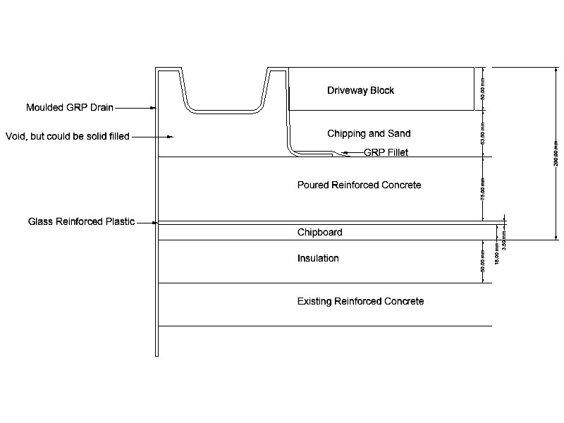

Posted
As this is going to be a buried barrier, I would GRP it.
If there are areas of high load, or point loads, then extra layers can be placed there.
One advantage of a buried layer is that there are no UV problems to worry about, so a vinyl ester resin can be used.

Posted
I'd put OSB on top of the insulation, then GRP on top of that.  It's far easier to lay GRP on OSB, and it will bond pretty well to the OSB. making for a much stronger part of the structure.
Posted
@pocsterI am a bit tied up at the moment, but shall come back and give my thoughts on how to do your layup.
Any chance that you can post a picture or sketch up of the two run off areas and any these up stands.  It may help clarify what you are trying to do.
Basically GRP is easy to put into a corner/edge, harder to put over a corner/edge.
