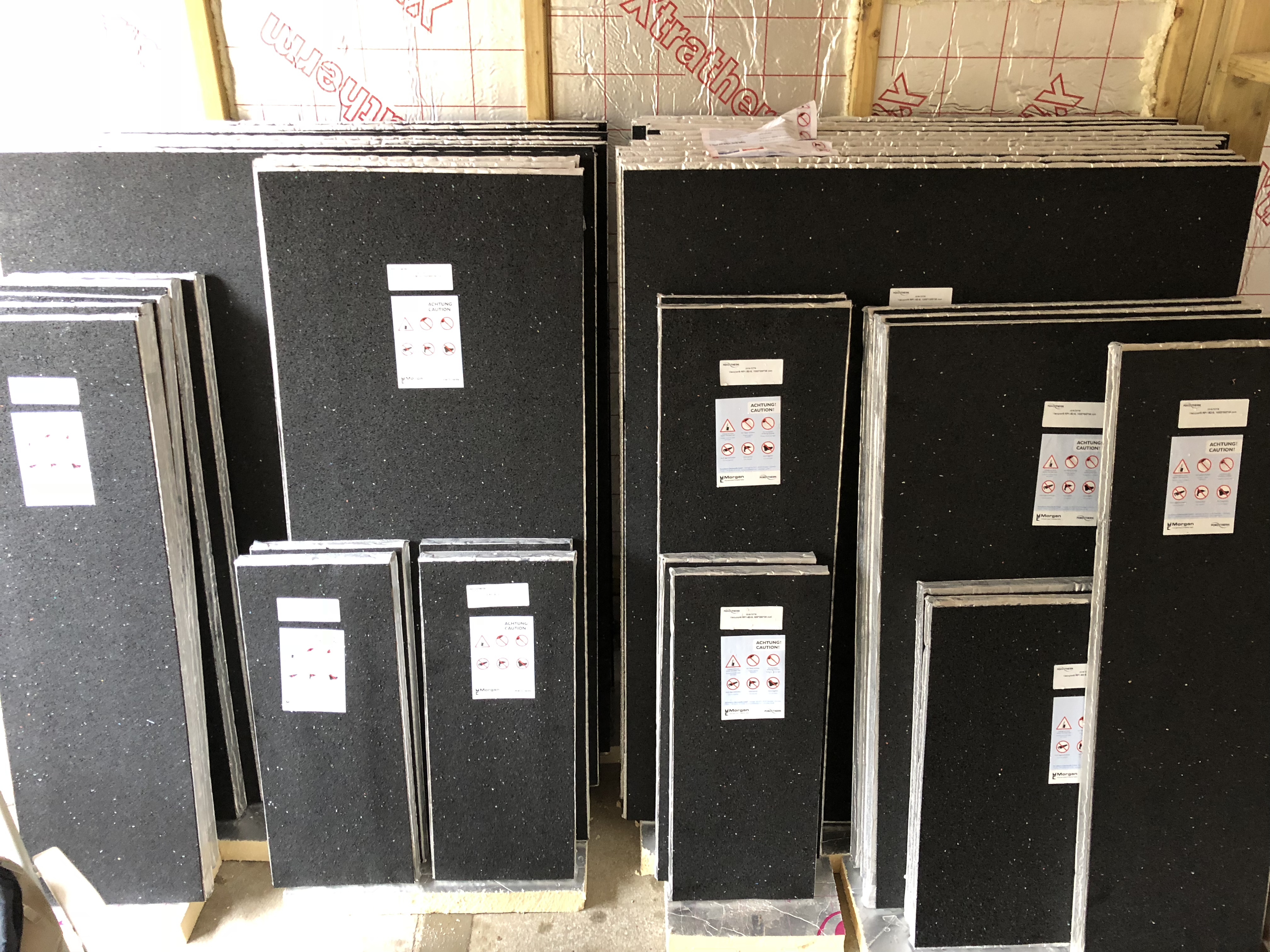

Super vac insulation has arrived !
some exhilarating photos ?
