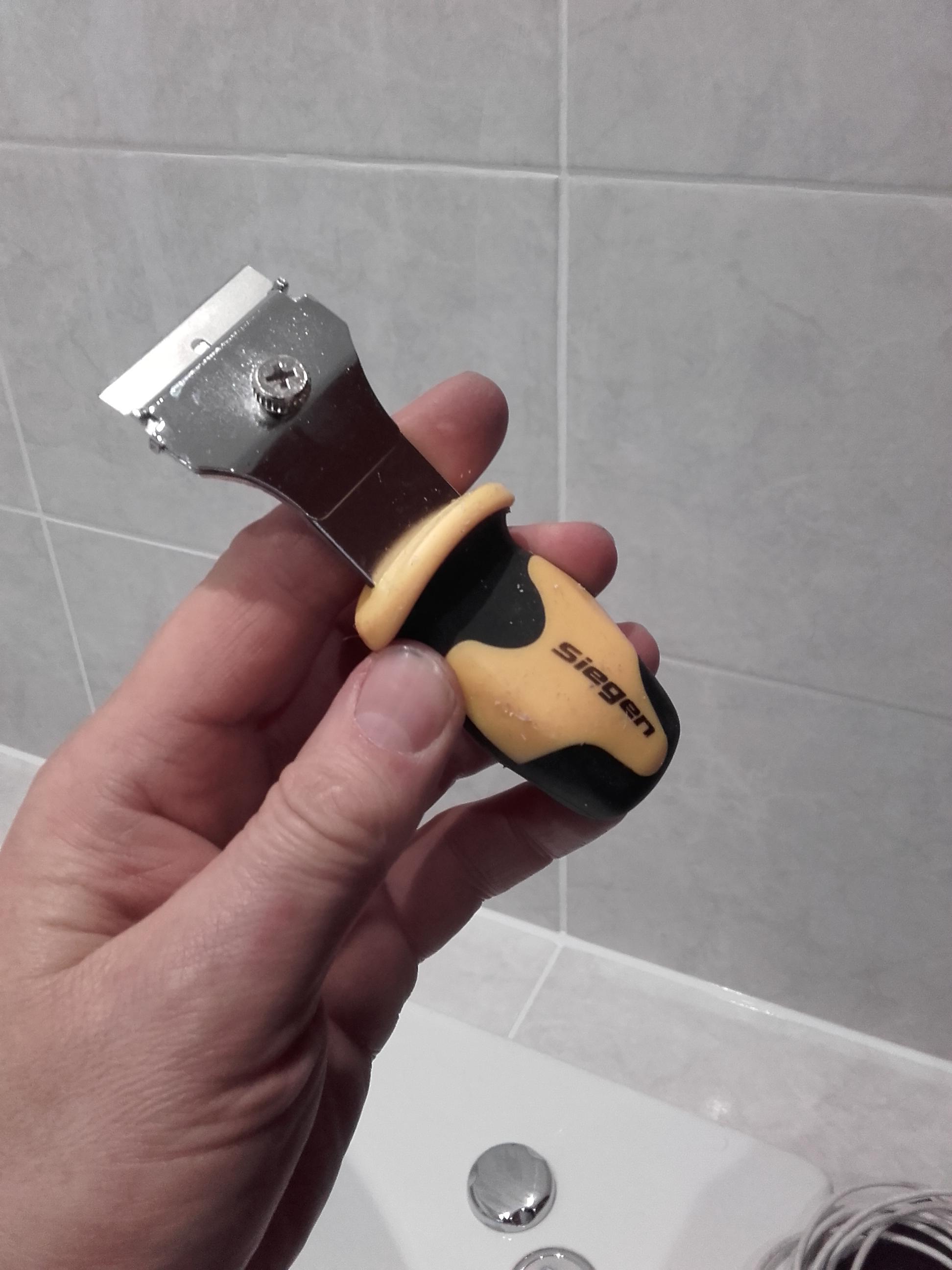

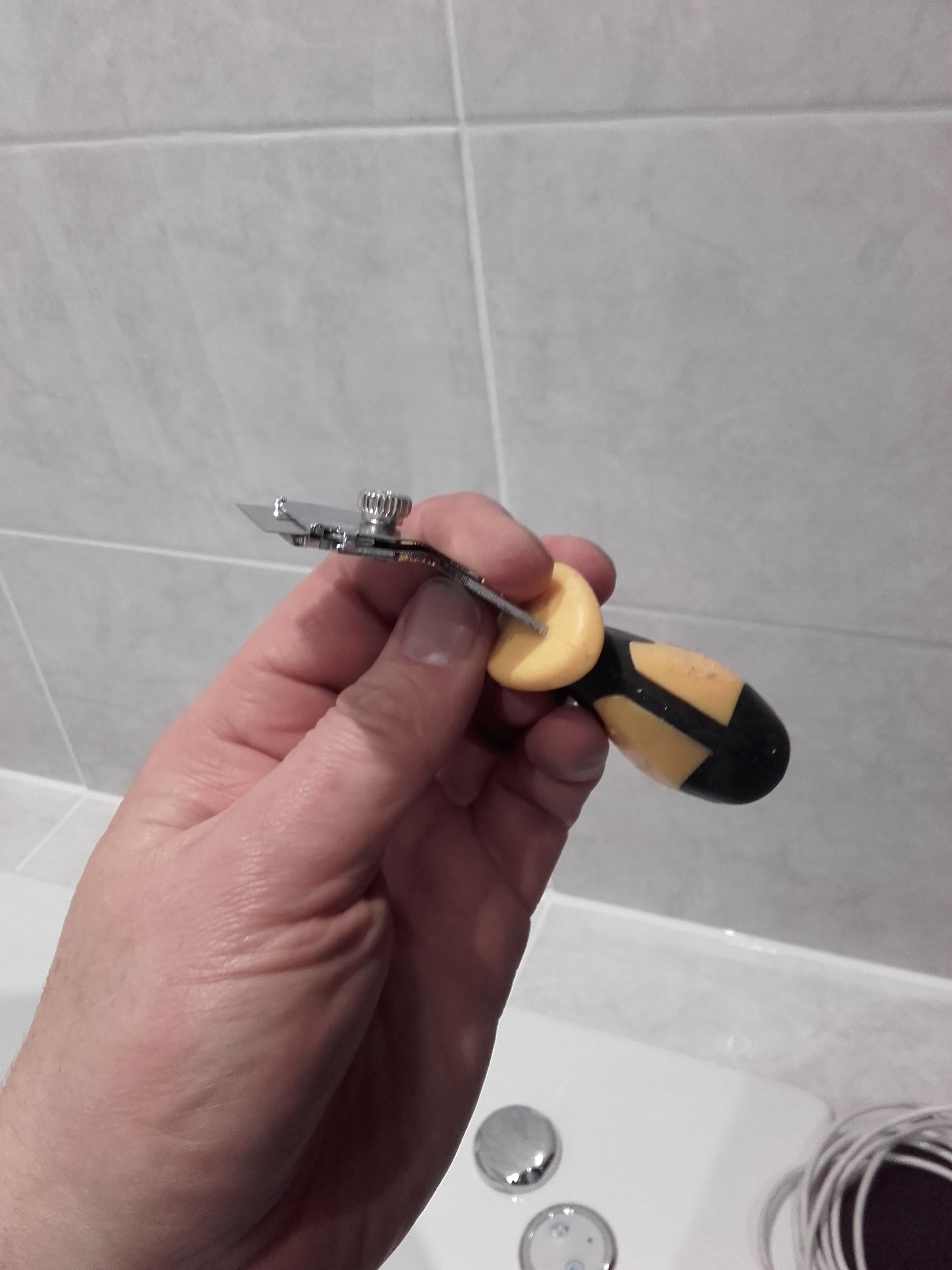

Onoff Posted February 27, 2019 Author Share Posted February 27, 2019 (edited) Picked this little tool up at the motor factors. Far superior at removing silicone from the tiles than the Stanley bladed window scraper type: £2.50 for the tool and £2 for a pack of 5 spare blades (both + VAT). Edited February 27, 2019 by Onoff 2 Link to comment Share on other sites More sharing options...
