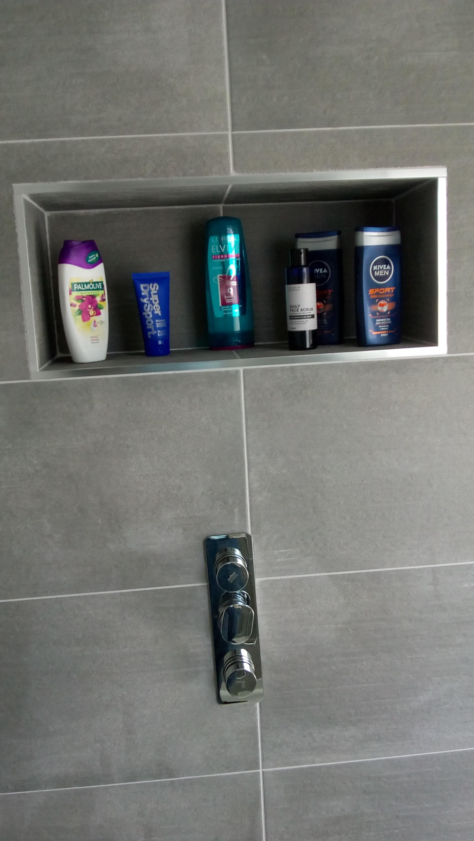

@Tennentslager, looks good from where I'm sitting does yours. So much better than mine! :(
Replaced the hacked out 12.5mm Aqua Panel with 6mm. Just whacked it up with some Sticks Like Sh!t:
20181006_154332
20181006_154525
My pockets look alright from a distance. Last one came out best and that's far from perfect.
20181006_145640
20181006_145648
20181006_145706
Close up, one of the better joints:
20181006_145825
  • Like 2

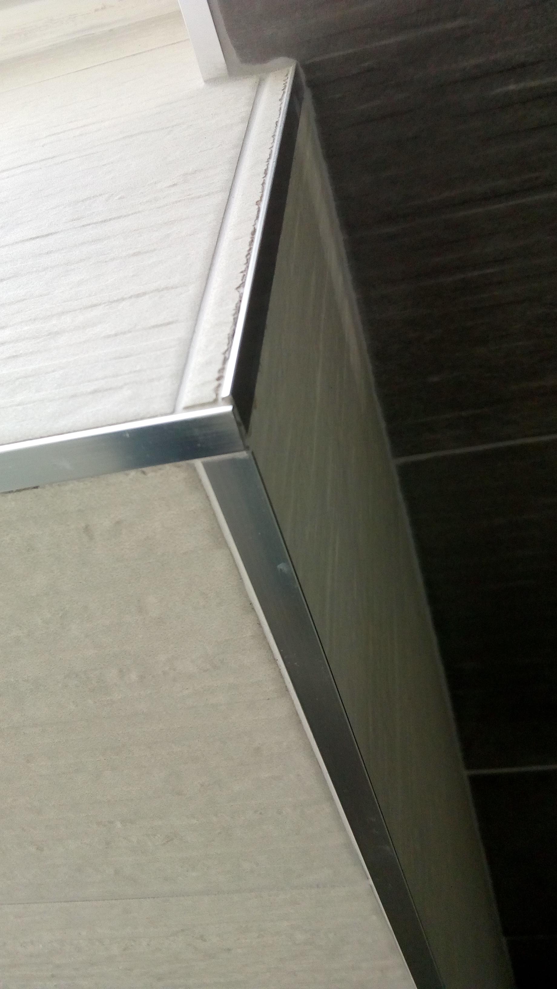

2 hours ago, Tennentslager said:
This off centre job would rip some folks knitting...and external corners without mitres...looks good thoughIMG_20181006_143330325.thumb.jpg.d3cf9acaff037d14adcd6dfd97cc5c68.jpgIMG_20181006_143300093.thumb.jpg.5d9888cbded3d3b04b4e73970030cdc8.jpg
Looks good
Shower inset must be mitred yes ? ; zooming in can’t tell !

Posted
4 hours ago, pocster said:
Looks good
Nope square finish...my sister's no 1 bathroom, not mine.
Mine cost under £2k and kinda basic but nice.
How much I asked Susan for all this loveliness...no answer but I suspect many £££
Posted
8 hours ago, Tennentslager said:
This off centre job would rip some folks knitting...and external corners without mitres...looks good thoughIMG_20181006_143300093.thumb.jpg.5d9888cbded3d3b04b4e73970030cdc8.jpg
So why is it off centre? Just the way it ended up or did you plan it different in your head?
