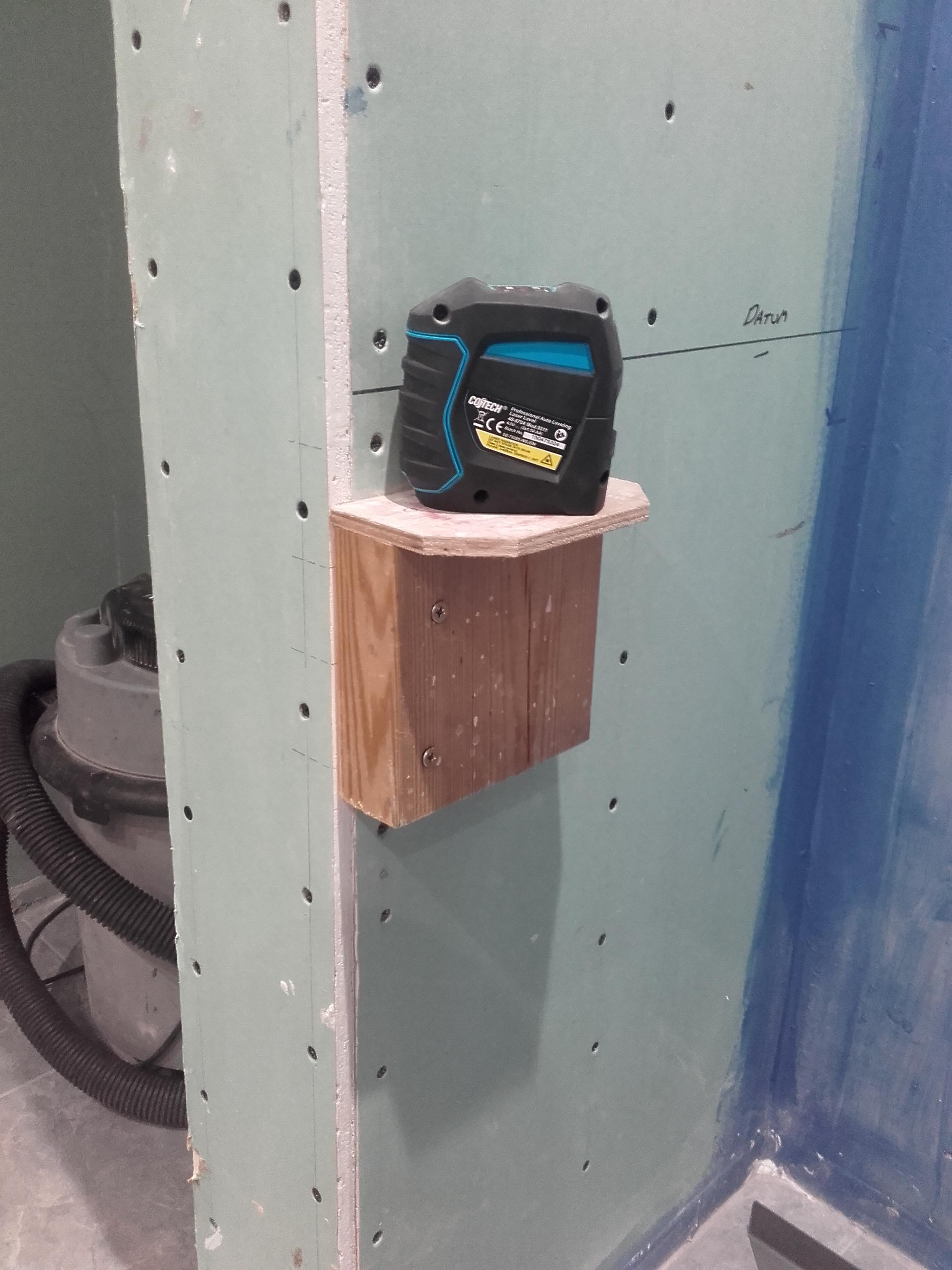

Ed Davies Posted August 15, 2018 Posted August 15, 2018 Love the way you determine the exact position of the bottom edges of the full tiles: size of a box of staples + the height of the laser.
Onoff Posted August 15, 2018 Author Posted August 15, 2018 (edited) 5 minutes ago, Ed Davies said: Love the way you determine the exact position of the bottom edges of the full tiles: size of a box of staples + the height of the laser. Just proof of concept at the mo! It usually sits on a dedicated little shelf. Edited August 15, 2018 by Onoff
Onoff Posted August 15, 2018 Author Posted August 15, 2018 On the assumption the tile butts up tight to the u/side of the trim on the shelf and I'm 4 and a bit tiles to the floor then I need to set the top of my support angle: 250+3+250+3+250+3+250 = 1009mm ... from the underside of the trim / bottom shelf of the pocket. I think...
