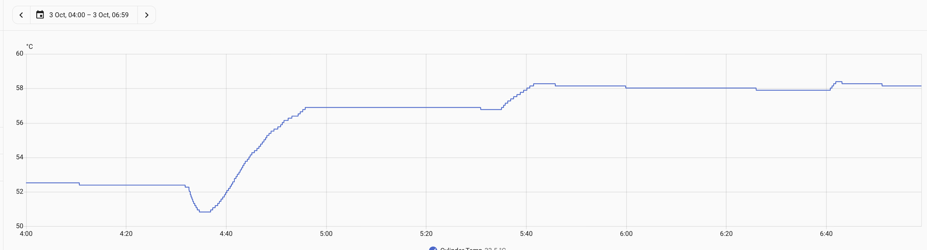

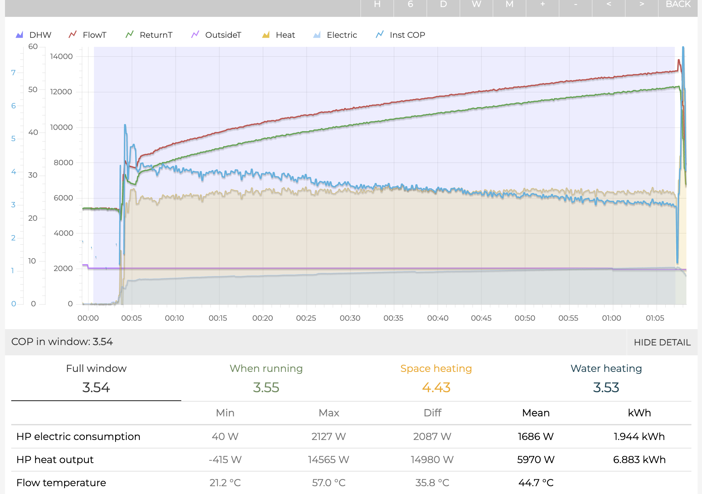

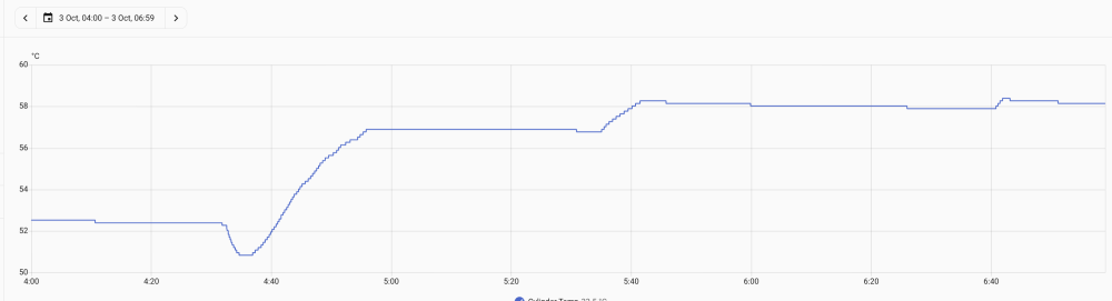

Can the ashp recharge quicker than immersion? Depends on the output, but our 210L is generally charged in an hour or less with immersion (heat twice per day), it took that long also with the a 6kW heat pump - not tried now we have a 4kW (installed in January).  A heat pump will slowly ramp up temperature from as low a flow temperature as it can, here is a typical night time reheat (our 6kW ASHP) - was 8 degs outside.
It took an hour and would have heated cylinder to 47 degs.  Used 2kWh.
Plot showing cylinder temperature - Last night I reheated cylinder, it starting at 4.30am and was finished at just before 5am and then around 1 hr later ran for a further 6 mins, an hour later another couple of mins, so all up just over 3kWk - but cylinder was at 58 degs, not 47 degs.

All correct, but point is I am spending only 15 to 30p per day on DHW, if I averaged a CoP of 3 it's 5p to 10p. So between £50 and £100 let's call it £75. It would about £28 on a heat pump. So £47 cheaper doing a heat pump. If the difference in cylinder price is £1000 you have a 21 year payback just to break even.
Also like that during a cheap period I can heat the house for the whole period and same when cooling instead of switching over the heating hot water when you need actually need the cooling on.

The other is about direct DHW with immersion v heat pump. The heat pump is always going to beat the immersion as even with just a COP of 2, you're onto a winner, and if you're putting in more that 3kW (or 6kW if you've got dual immersions) then your reheat time is going to be reduced. Some factors limiting this are that if you have a badly commissioned system DHW temp may be set so high the heat pump doesn't like it and you can see a drop of COP sometimes to below 1 on older R32 units.
