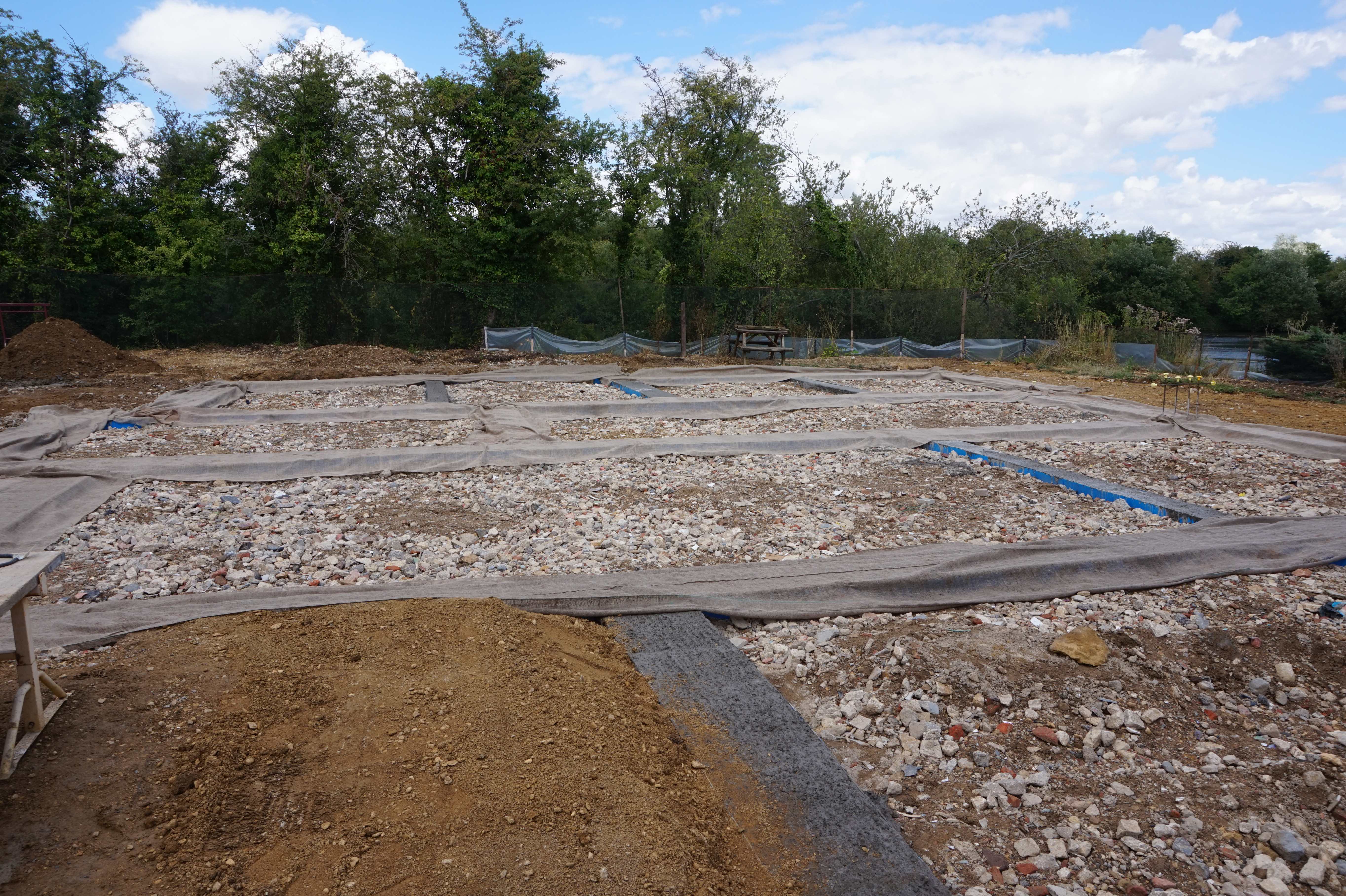

Ground bearing slab curing
I have found a company to come and pour and 'finish' the concrete slabs next week.  As always, everything is vague and nothing is done with a formal contract.  Just been told the job has been booked in.
Should the company be responsible for applying a curing agent as they have already said that they don't provide polythene sheeting to cover it to aid curing.

It's not that simple @Gus Potter unfortunately, we moved to an area where I have zero connections.  Previously, I knew many, but it's too far to travel.  The downfall was in thinking that I could find reputable trades who would do a good job.  This has been an absolute mare and it's akin to the Wild West.  Shysters who are either shit or think they can take you for a ride.   Our last bricklayer was exactly that.  As soon as I picked him up on his levels being out, I'm convinced he binned us off, but continued for 5 days before walking off site and onto a new house build for a builder.
In hindsight, a single contractor for a shell would have been the best option, but I'm here now and I've just got to get slabs done and then the next lot of bricklayers can start mid August.   Unlike many on here, we are not blessed with deep pockets and have to watch every penny.  This build is being done on the basis of keeping to the Estimators QS and that means me managing trades.

You need to confirm with the contractor that they will immediately spray the curing compound on the finished slab.  If the water evaporates from the slab too quickly the concrete will not properly cure.  That said, the house will not fall down.

But back to the slab, your structural design should detail rebar and concrete specification fully. If it doesn't it should. Scottish system makes this all blissfully easy, structural design not completed - no building warrant - no permission to build.
Curing agent or not depends on few things, such as outside temperature, so in winter in Scotland is completely different from summer in England. Get advise from your structural engineer, as they should be giving you the structural design certificate.

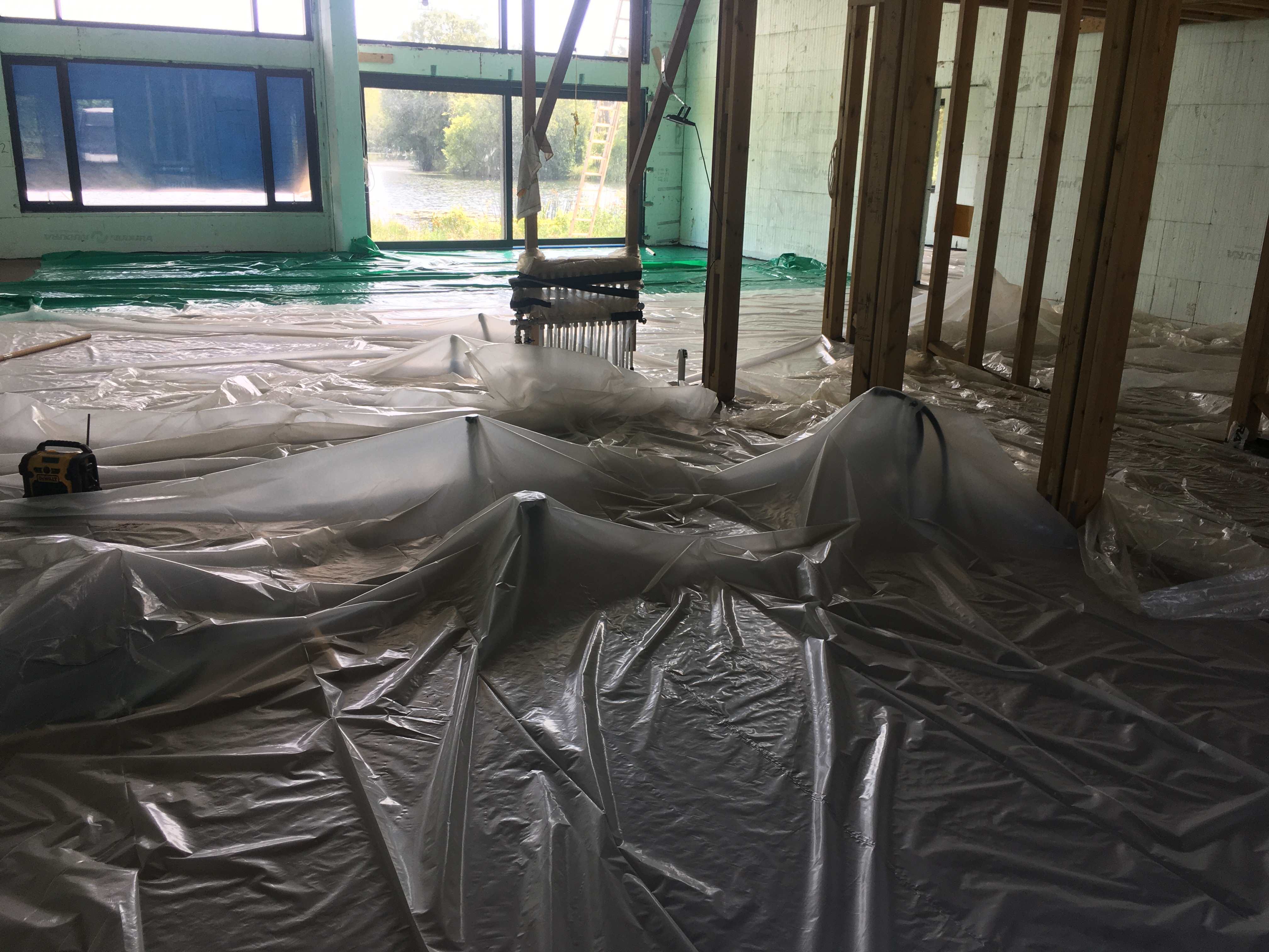

I was recommended a screed company, I was told they are absolutely shit hot, I met the main man and he knew what he was talking about, I asked about screed curl at the edges and covering the screed to slow down evaporation.
he said it wasn’t necessary.
so I did some more reading and asked a few questions.
they did the screed, an hour after they had gone I hosed it down with a very fine mist spray, I then covered it in polythene and also covered all the windows to stop the sunlight coming in.
the result is I have the flattest most level screed I’ve ever seen.
you need to satisfy yourself how it should be done, and any short comings in your opinion you need to make up.
buy the polythene and install it yourself or do you due diligence and insist on a curing agent.
if you think they are good why do they not want to cover it ?
Can do no harm and may do a lot of good. Would you mind reporting back on how much condensation is there tomorrow?

This may be nonsense advice for your situation, but we chose to run a garden lawn sprinkler, actually two, on a hose timer - coming on for say 5 mins every hour. We actually did this for a couple of weeks as we were away and the weather was properly hot. Zero cracking. As others have said, a little cracking isn’t a big deal anyway. The contractor asked whether we wanted relief cuts / control joints, but we chose our sprinkler method and plan to use it again.

There are rules about not pouring in cold weather. But for hot it will depend on the mix, the thickness, time of day.
I've never used sprinklers but I see the advantage as compared to single use polythene. Curing spray may be optimum.
If I was pouring a slab in this weather I would have rolls of hessian stacking in an old bathtub of water, an hour after the final trowel up i would cover the slab in the damp hessian.
the picture is just ring beams, but it was 28 degrees and the hessian cost pennies compared to the cost of the concrete the pump and the labour.
cheap insurance really.
The concrete company I was planning on using wouldn't put anything in writing, so I've cancelled them and am going to pour SCC slabs myself.  Ordered the items below
Screed levelling tripods
2m dapple bar
Concrete curing spray applicator
Still need to order concrete curing liquid, but have read I need something like https://www.basetec.co.uk/product/adomast-adocure-super-90-efficiency-concrete-curing-compound-25-litre/?srsltid=AfmBOorxYXyscZ_1VVJ7ucvmRyLi4QzWQFiEre_tL2fbDiv2bvj-OyGh
It's not rocket science and my biggest slab is 6mx6m, so all manageable.  I'll report back when done.
