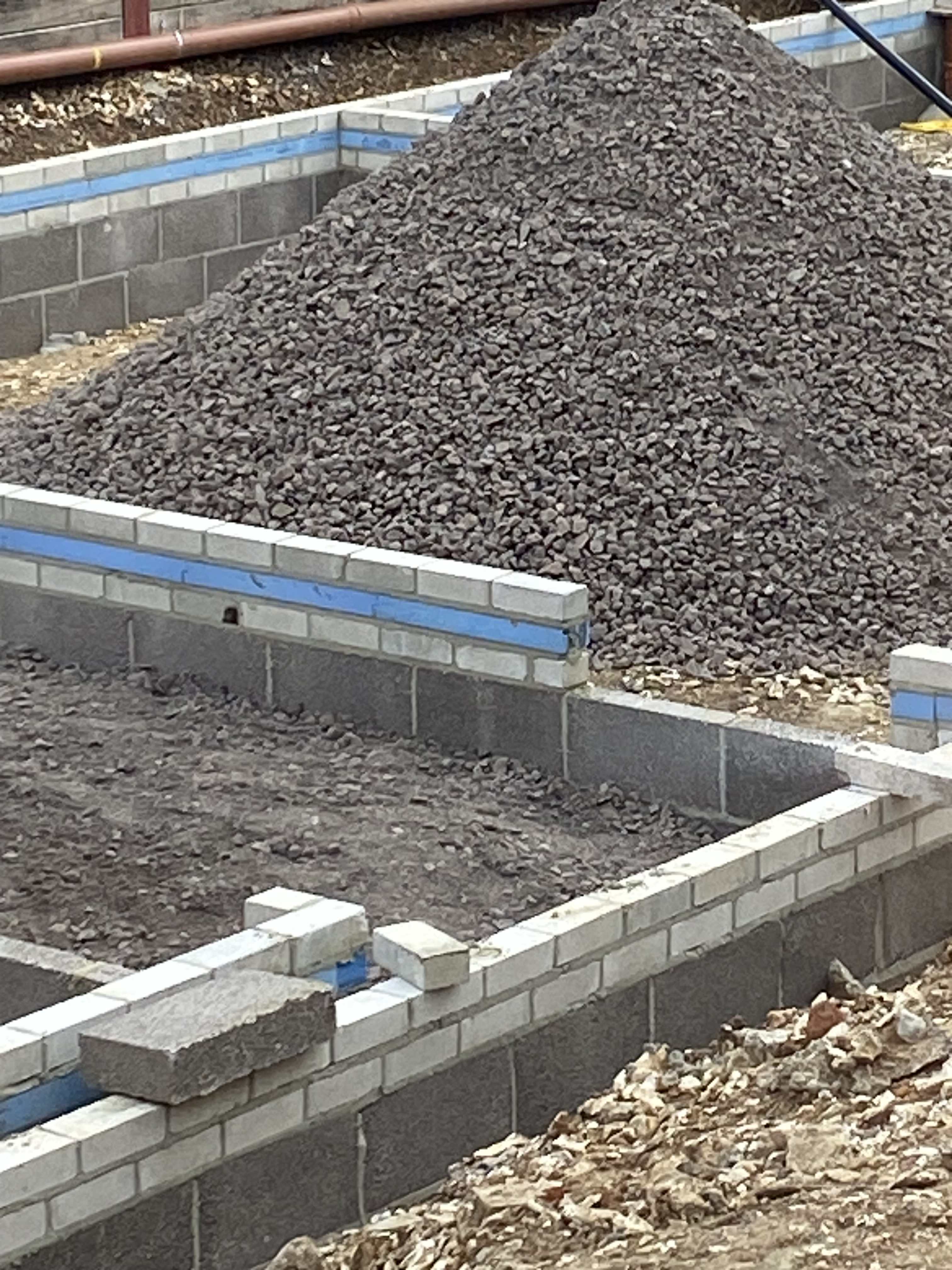

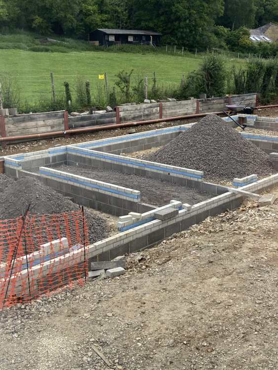

As some of you predicted, our self build has turned into a disaster.  We’ve now parted ways with bricklayer number two.  Choosing a ground bearing slab was a dumb idea and beam and block would have enabled everything to run more smoothly.
i think the bricklayer could have made things simpler by not building up the internal walls the past the block course.  This has now made the Radon membrane detailing more tricky and expensive, due to the number of internal door ways.  I also feel it’s going to be difficult to lay the slab as the open door ways will mean you have different levels for tamping off.
I am contemplating taking the internal walls down to the top block course.  What do people think?

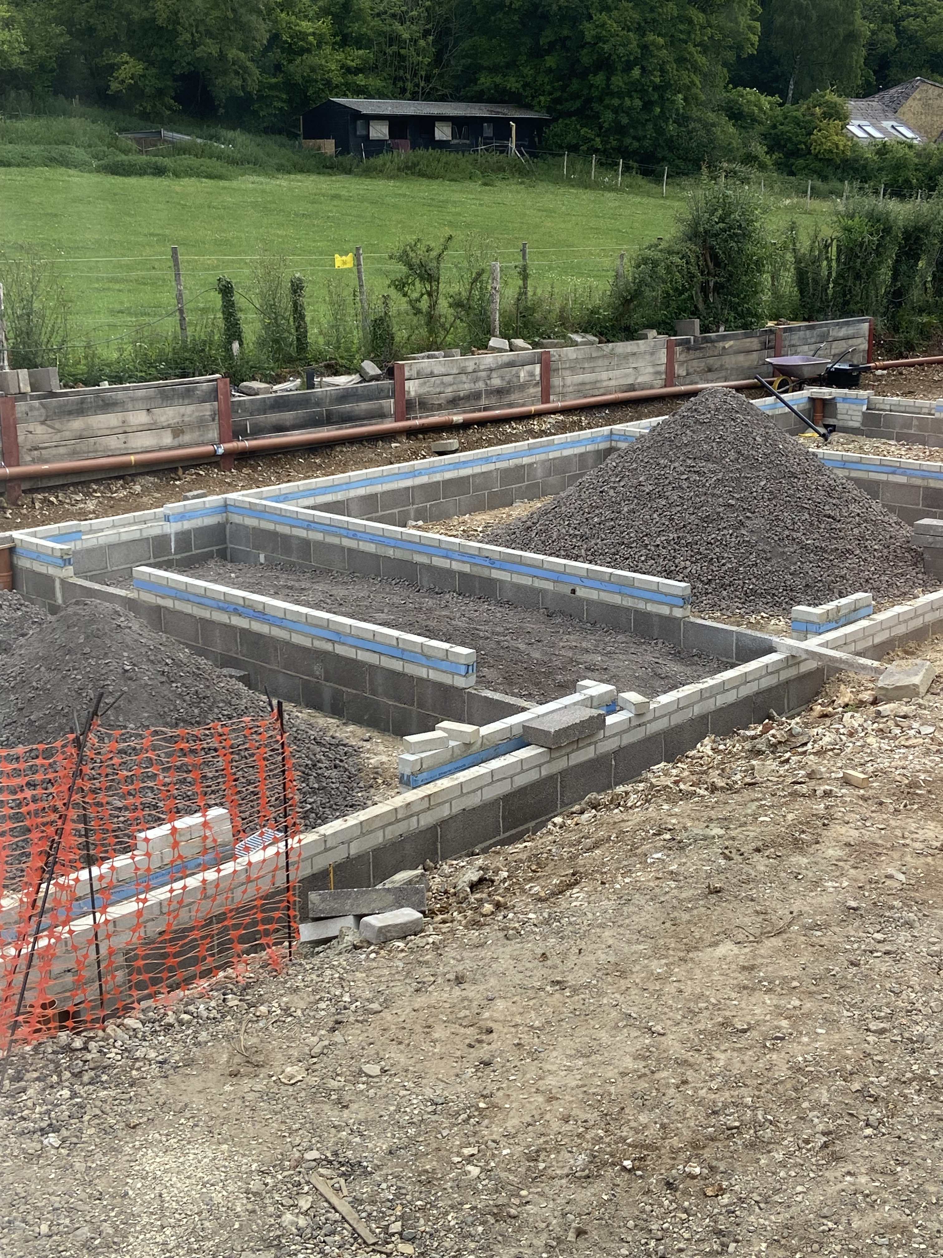

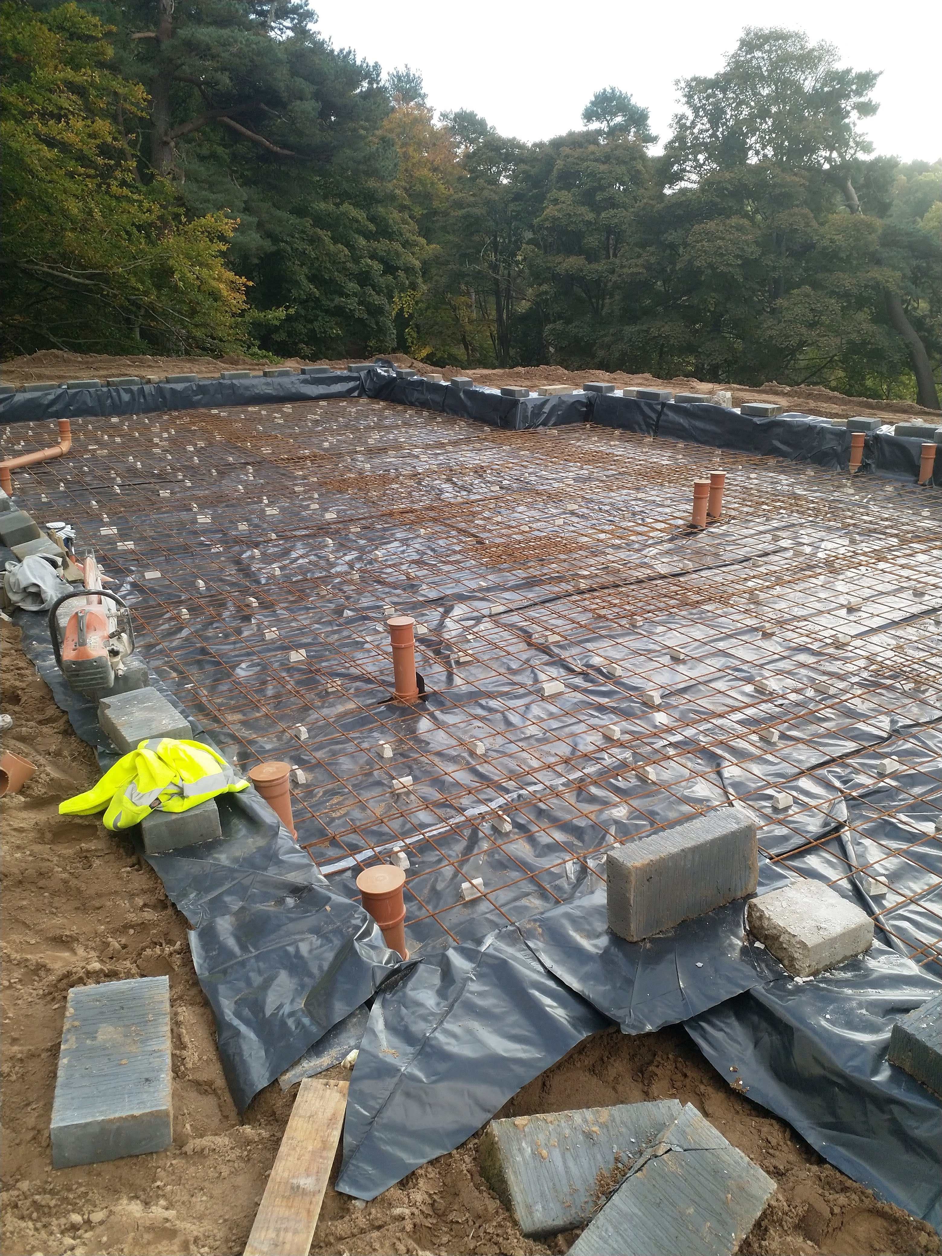

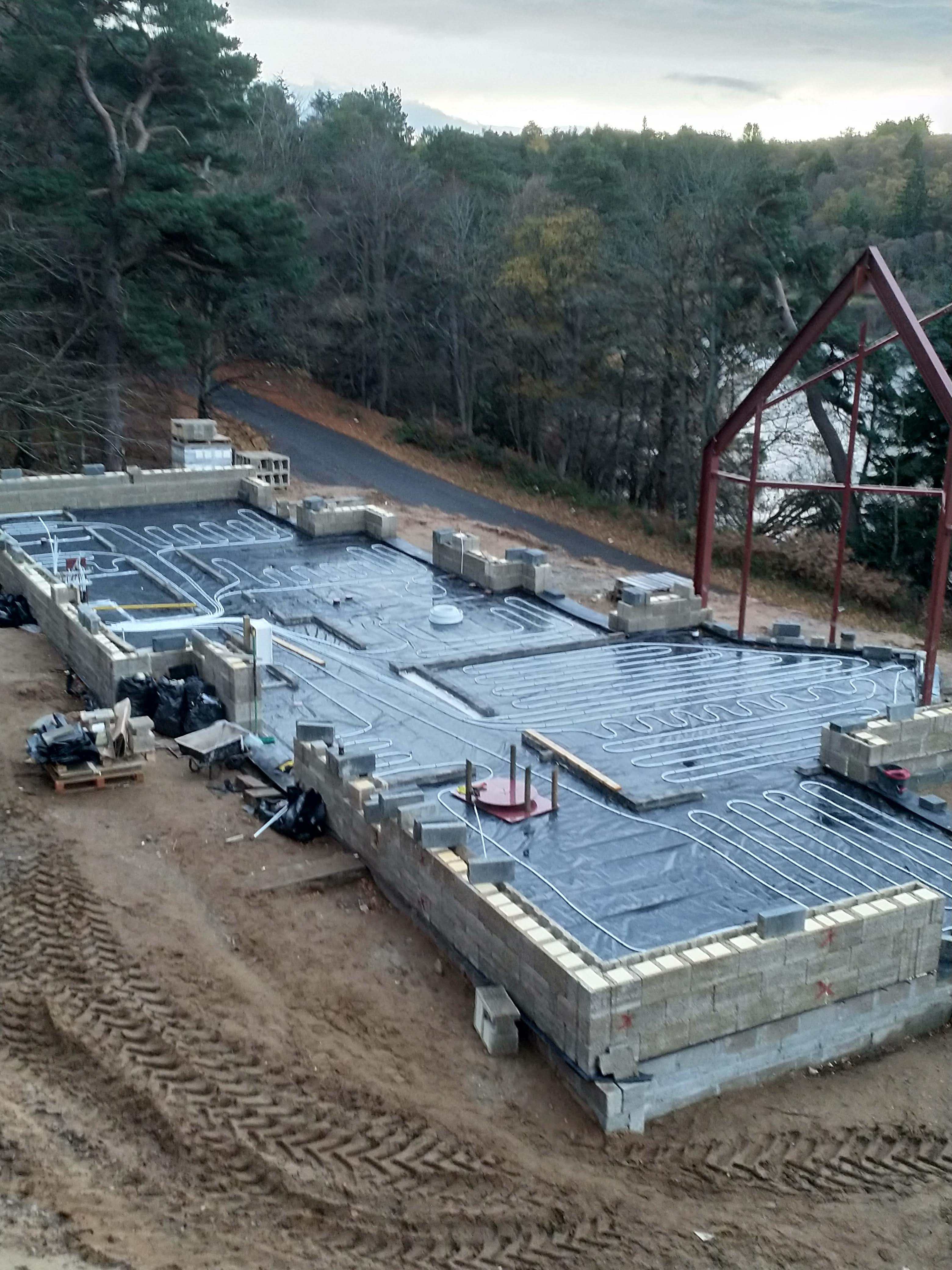

I did mine almost the same as yours, but stopped doing block work at dpm level. Then backfilled floor to get a level site. This allowed the DPM to be installed and taken up the external walls.
Above you can see where my internal wall block work stops
DPM in place with rebar ready for concrete pour.
Once you have poured your concrete, you build the internal walls up from the concrete directly above your foundations.
This image show the top of the stub structural walls (after floor insulation and UFH added and prior to floor being poured)
You have just carried away and built too high.
You need detailed drawings and make sure your workers understand them. Suspect you need to remove the engineered bricks and Marmox blocks only, depending on where you have defined the DPM/DPC levels

I have often had to reduce some wall heights or taken down sections built with wrong DPC.  You should be able to reuse the Marmox, which is good considering the price!  Ground bearing slab is nicer in the winter as you don't have freezing air circulating underneath.

Yes.  Slab build up is as you have stated.  Taking down the internal 3 courses won't take long and it will help considerably with gas membrane installation and concreting.
If Radon is known to be a ‘high’ level, then I assume detailing the way that membrane is closed off correctly (as shown) would be a major issue here; not just time / cost, but in having this executed perfectly (BCO and warranty eyes will focus on this quite intensively if the risk is significant).
Try knocking a couple of the common bricks off to see how well the Marmox breakers have adhered, as on a previous project you didn’t have to do much more than sneeze for these to come loose (tripped over a few and that was enough to dislodge them, prob too dry a bedding mix).

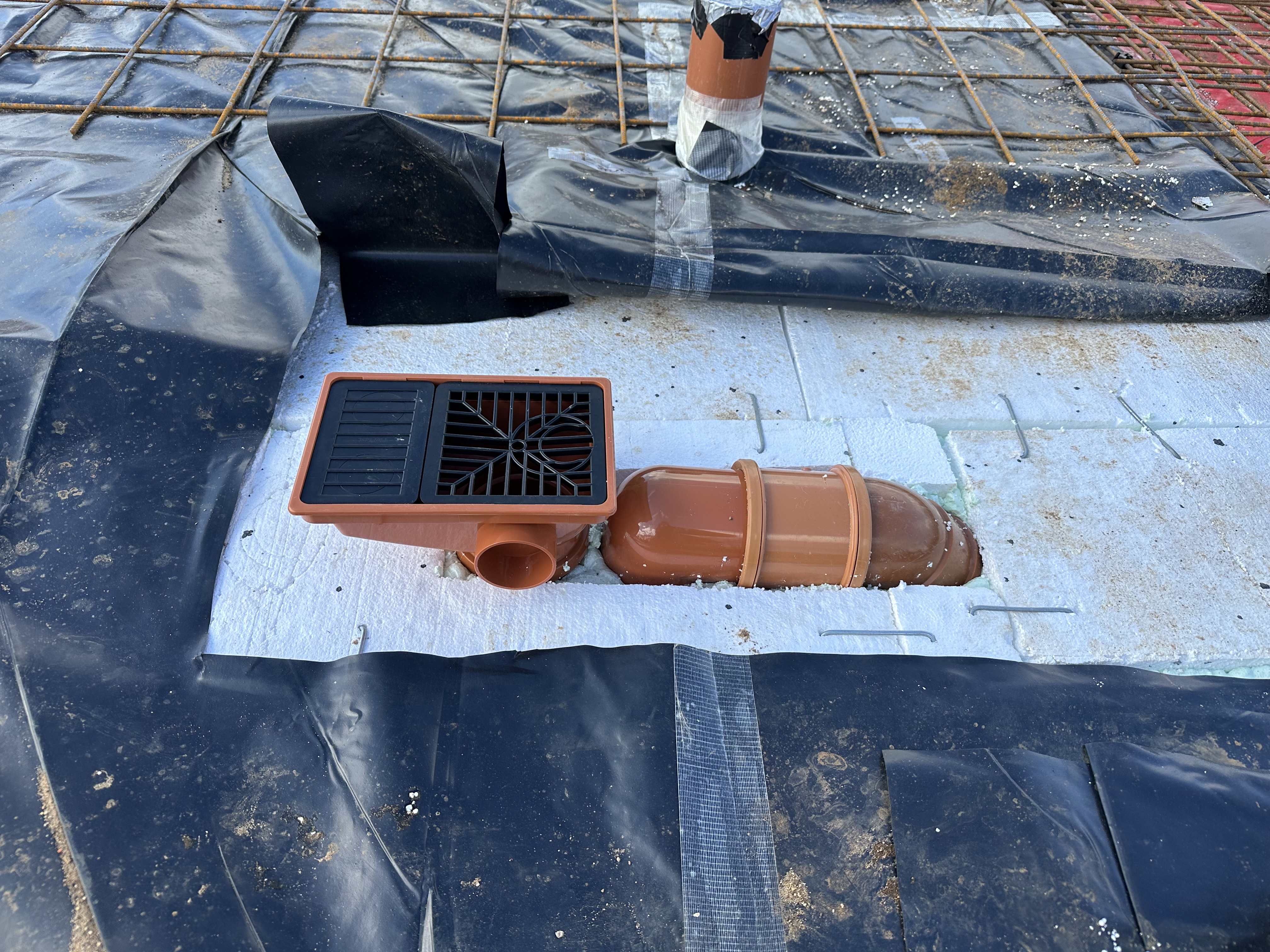

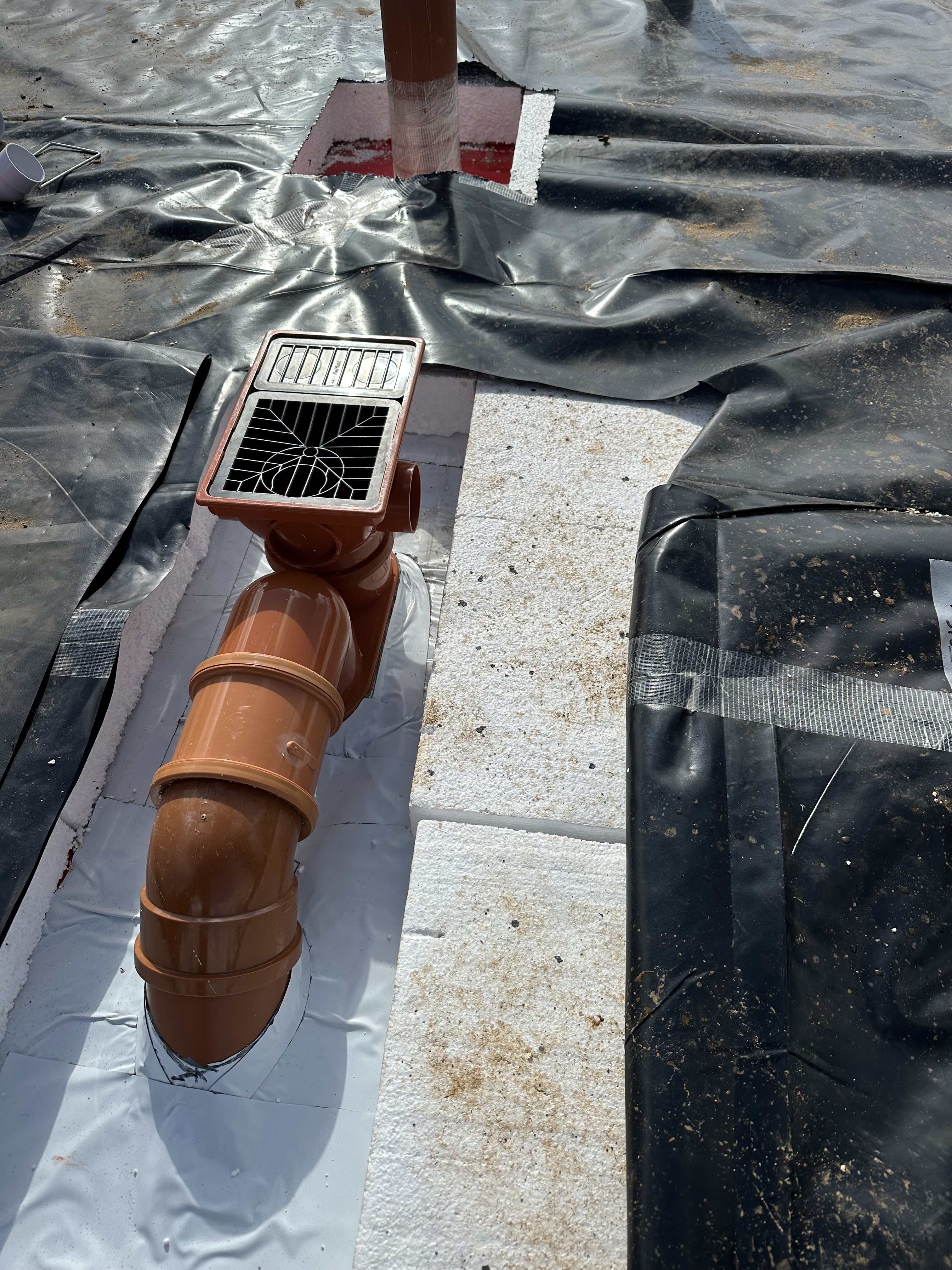

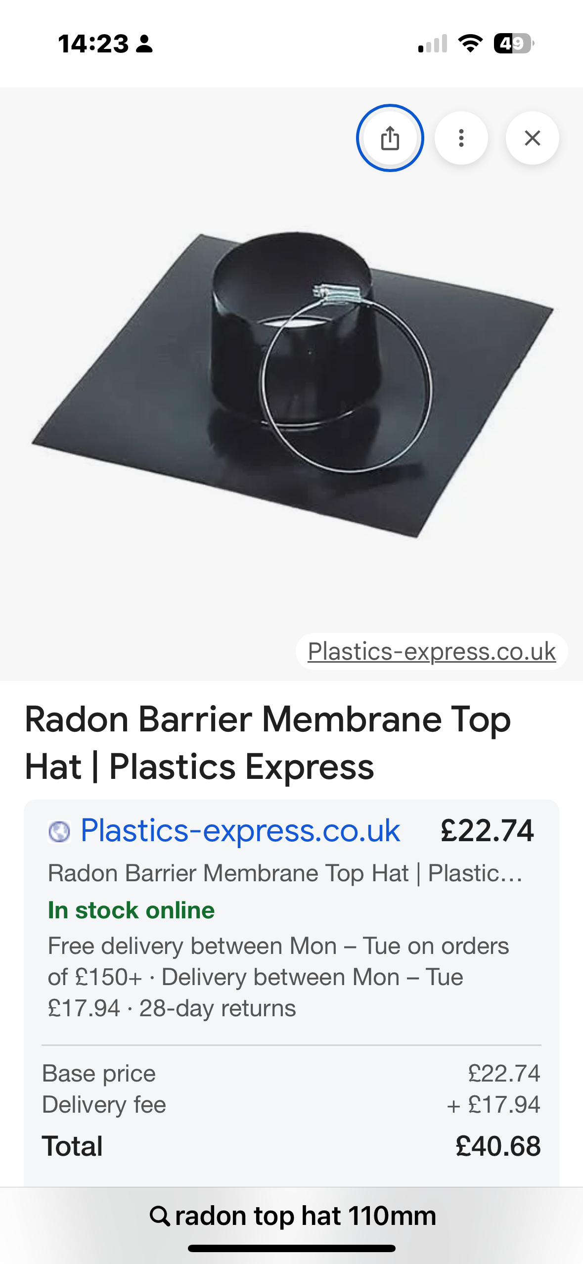

We only require 'Basic' Radon protection as we are in a 3-5% area.  The one issue I've got is that the membrane sits at the same level as the coupling on the rest bend.  No idea how I'm going to solve that problem.  But the top hats I purchased won't work.  I think Juta do a liquid rubber that you create a dam and pour.  The top hats are great for soil pipes in the middle of a room, but not so when your soil pipe is in the corner of a room.

Regarding the brickie. From the picture it looks like what he's done is good work. Unless you have had a major falling out with angry words exchanged, it may be worth eating a little humble pie and asking them to return when needed.
Taking off few courses is easiest. There may be an alternative though. How much higher is ffl than the top of your current blockwork level. Instead of the planned buildup can you not do mot, dpm, insulation, gas membrane, self compacting concrete slab. No screed needed and brings your membrane level up higher so stripping off less masonry or maybe none?

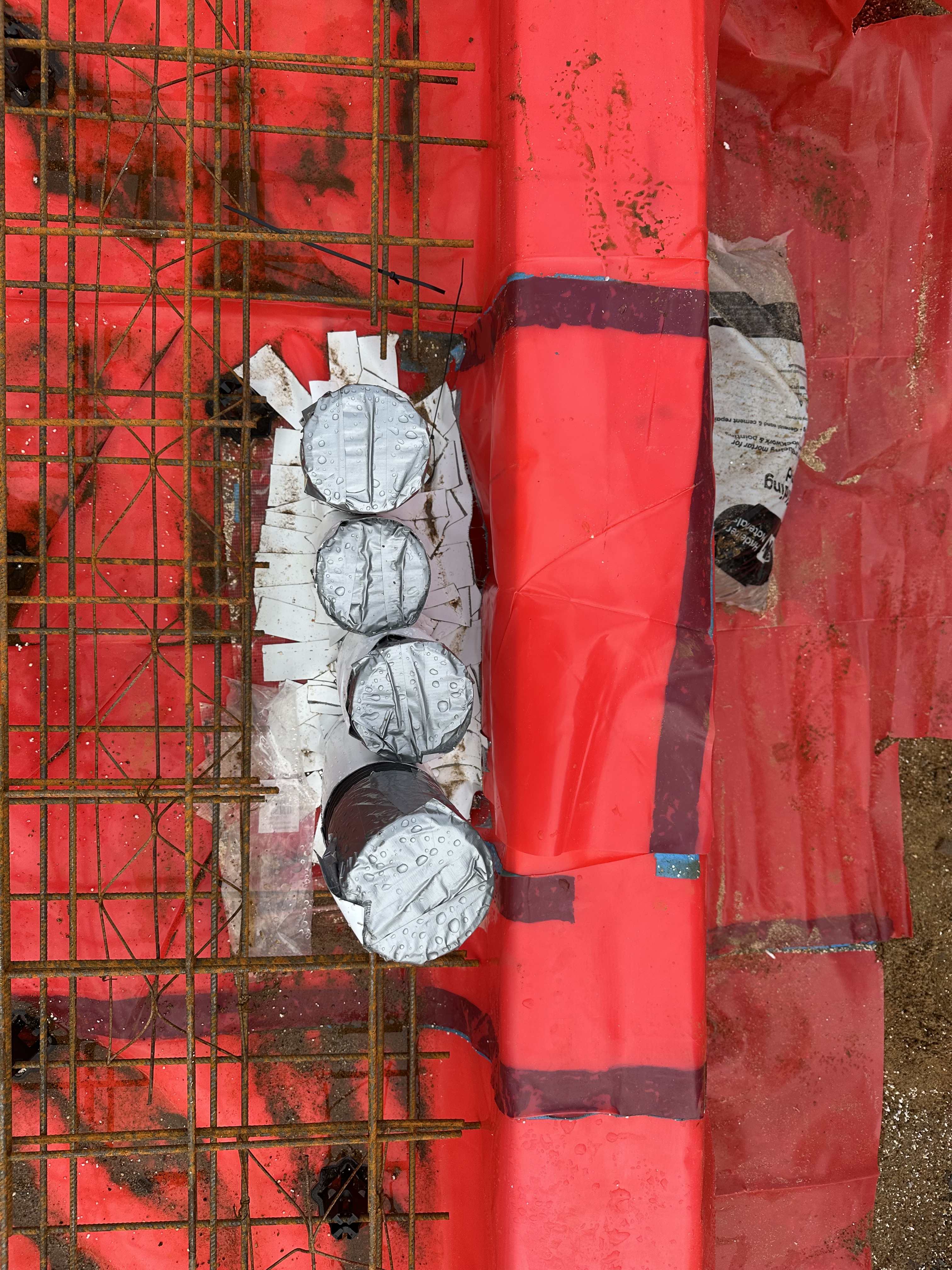

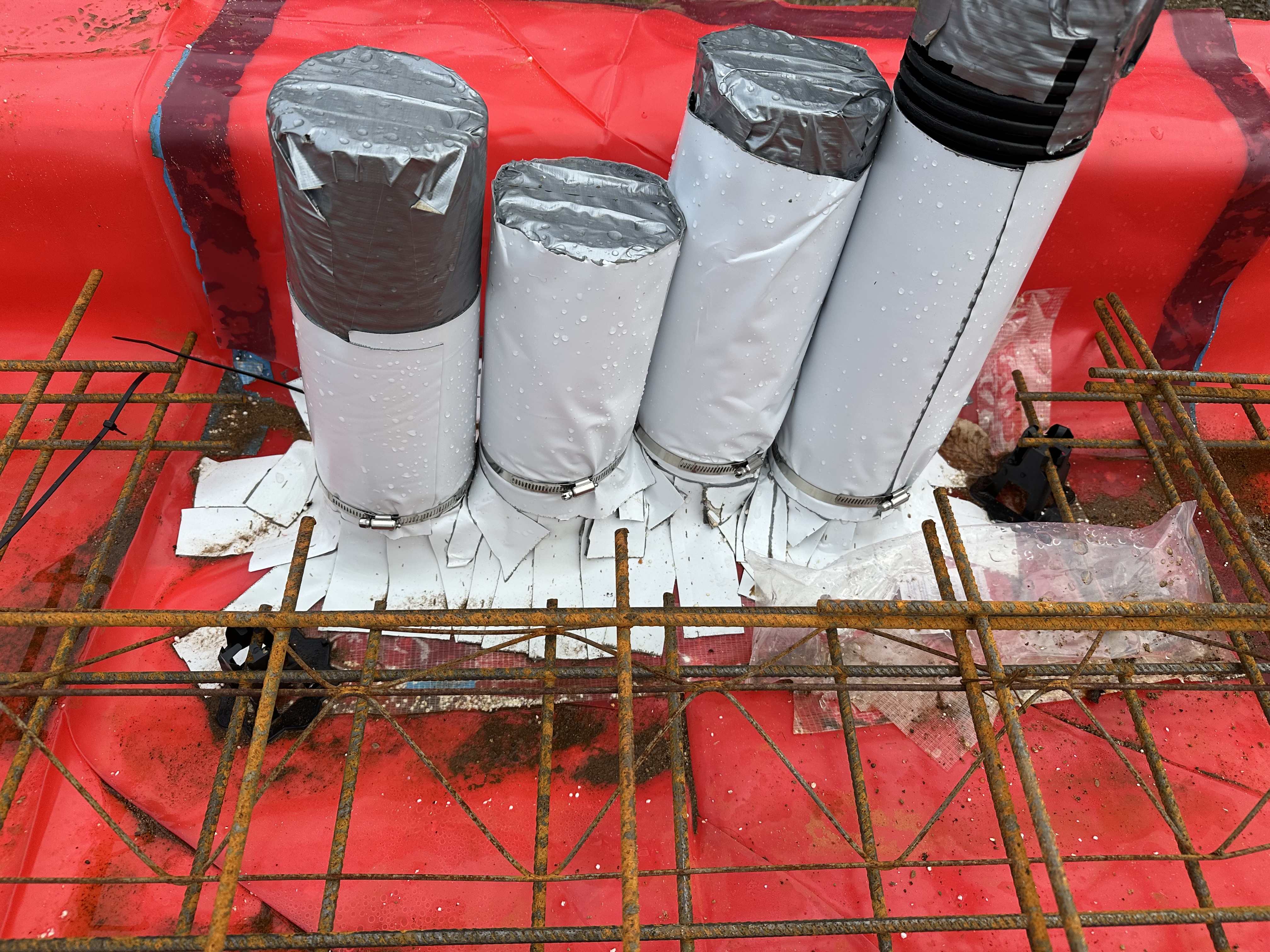

There’s a self-adhesive ‘peel and stick’ detail strip, on a roll, which I applied to these right awkward bastards:
LINK
Note we added stainless jubilee clips for belt & braces as Radon was v high.
LINK
Thanks for the photos.  So it can be done, just doesn’t look as tidy as a collar, but needs must.
