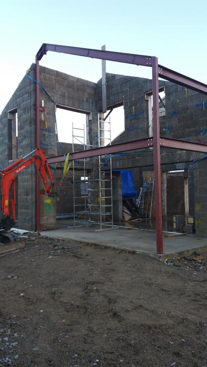

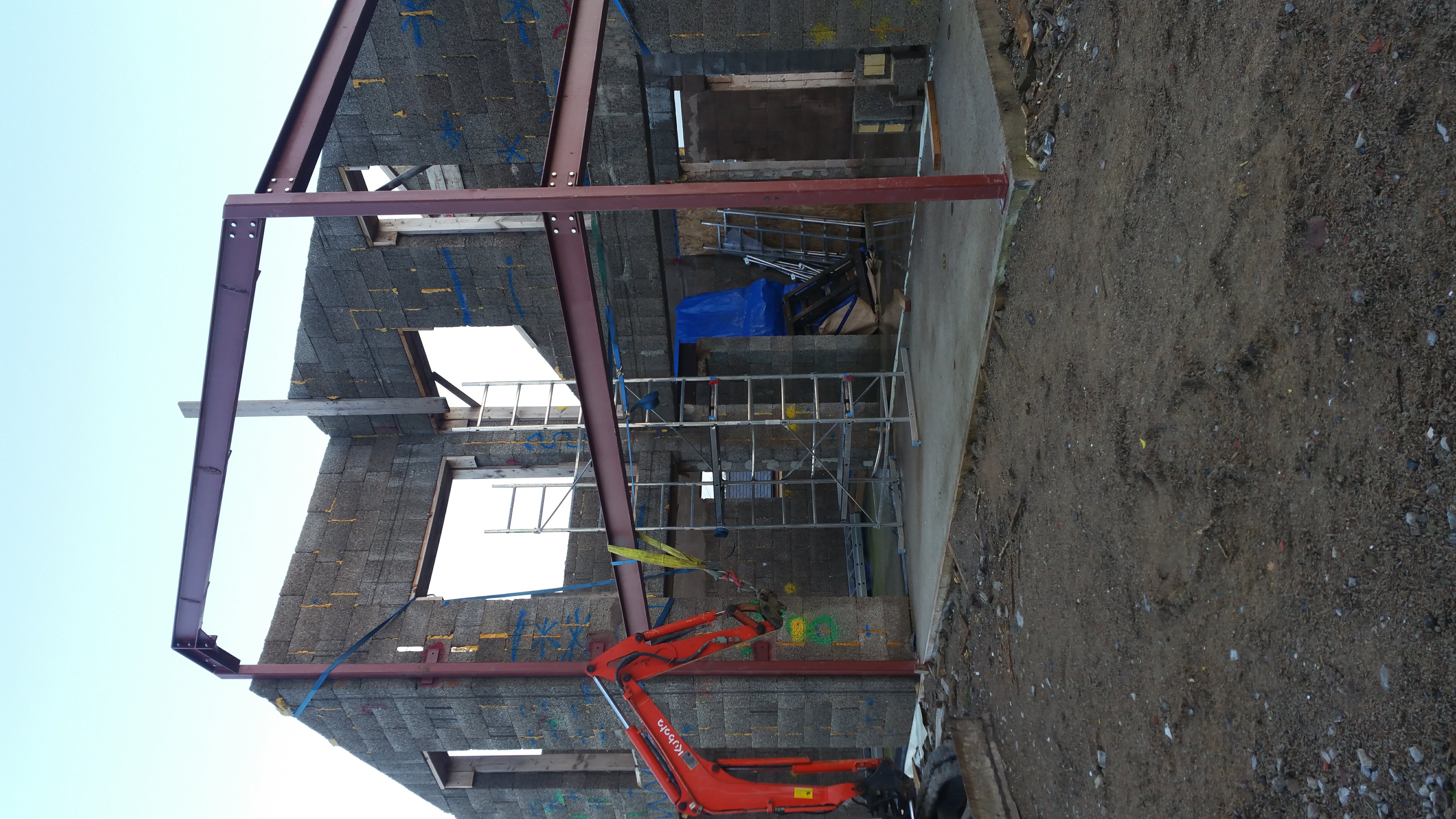

ToughButterCup Posted January 31, 2018 Share Posted January 31, 2018 Steels are up! After a fashion: with our build, there's always a twist so read on! First have a look at this....... We finished late last night SWMBO is really happy, and, to an extent so am I. The L shaped steel structure is secured to the floor with Thunder bolts, and will be secured to the wall with 16mm threaded bar embedded in the Durisol block. So far so simple. There was a gale last night , and attack of wind if you like : a useful gale, because it made me think hard. The purpose of this post is to ask you to check my thinking and offer relevant comments before I talk to the SE and Durisol. Many of you will remember the hiccup we had recently with the wall collapse (If not read this) And I am quite prepared to accept that that experience is colouring my thinking too much; but here goes. For those of you who are unfamiliar with Durisol block, here is a brief introduction - to understand the rest of this, it's worth a quick look (Links to an image search for Durisol: you only need to understand what it looks like) The vertical columns (steels) are attached to walls with threaded bar. It's that 16mm threaded bar connection that concern me. Because I cannot guarantee the continuity of the concrete within the Durisol blocks: it is that concrete into which I drill and attach the threaded bar and secure with Fischer Resin mortar One of the holes I drilled through the blocks showed that there was no concrete there at all. (The drill went straight through and out the other side of the block) Normally that lack of continuity will not not matter one little bit. But it does matter when the integrity of another structure depends in part on the attachment to the wall. Proposed Strategy Talk the issue with the architect (already done - strategy agreed) Talk to you all Think it through again on the light of the above and Ring Tanners (our SE) Ring Dursiol - maybe ask them to visit Agree problem solution : Talk to BC and ask for a visit before doing the following - Proposed problem solution Examine each of the current drilled holes with an inspection camera: checking to see 100% concrete continuity Attach the steel columns to those holes which 'pass' the test Create another series of attachment points by; identifying 5 further attachment points and exposing the concrete behind the insulation by cutting out that insulation entirely verifying the quality of the concrete drilling into it to create five more attachment points (one per hole) replacing some of the insulation and backfilling with cements and PVA mix. Bit of a faff, but I have realised that technical reassurance that (in this case) the structure is self-supporting is not enough. I need to know deep down in my gut that the structure is rock solid. The psychology is as important as the technical stuff. Link to comment Share on other sites More sharing options...

ToughButterCup Posted January 31, 2018 Author Share Posted January 31, 2018 Hmmm, @ProDave and @jamiehamy It's Germanic-Me that's thinking of the BCO.... message understood No, @jamiehamy, both structures are said to be independent. I know from experience that the house has stood many (named) storms so far with no ill effect - a few trades people have commented that any other build system (they know about) would have blown down by now. But the steels need to be rock solid too; and given this hiccup (thank God I found it!) I'm proceeding with caution. Thanks very much for your help. Ian Link to comment Share on other sites More sharing options...
Declan52 Posted January 31, 2018 Share Posted January 31, 2018 Could you not put some small diagonals on the frame somewhere that won't be seen to stiffen it up. Link to comment Share on other sites More sharing options...

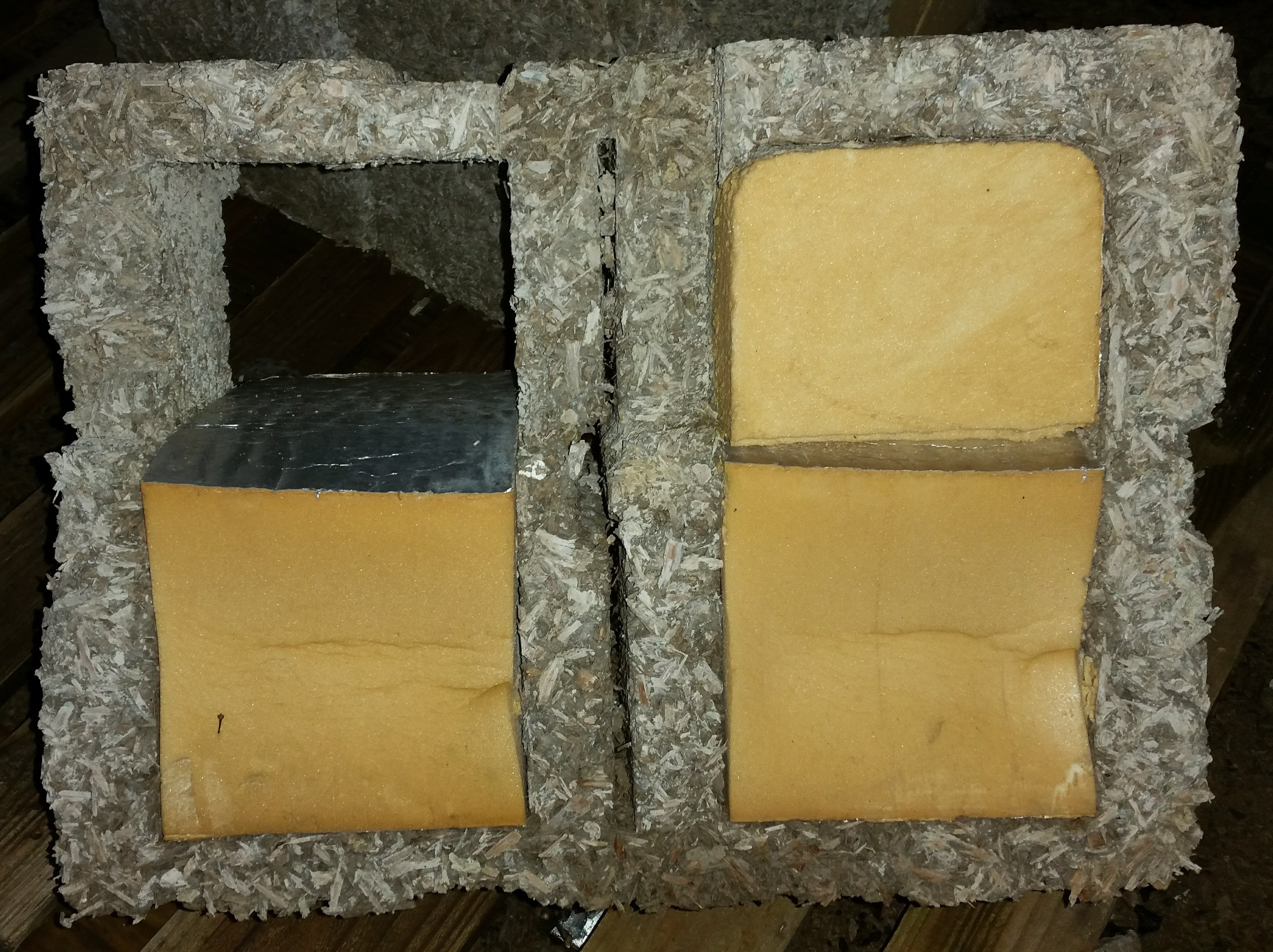

ToughButterCup Posted February 2, 2018 Author Share Posted February 2, 2018 And the best outcome possible has been found ..... The camera shows a hole with solid sides all the way through. How can that be? Easy To facilitate cutting blocks exactly in half some blocks have a double central wall with a three or four mil gap between them. Normally blocks have a single web joining both sides. Those would be really hard to cut in half. I had accidentally put my drill exactly between the two central webs : and so drilled through fresh air. Photo to follow. I will double check by drilling 20mm either side of the original hole where there should be concrete (and back-fill with foam) Yours faithfully, Relieved of Lancaster 1 1 Link to comment Share on other sites More sharing options...
Gone West Posted February 2, 2018 Share Posted February 2, 2018 1 hour ago, recoveringacademic said: I had accidentally put my drill exactly between the two central webs : and so drilled through fresh air. Great news. Link to comment Share on other sites More sharing options...
ToughButterCup Posted February 2, 2018 Author Share Posted February 2, 2018 For those of you who might be interested in Durisol, here's the detail from outside a block and from inside it..... The blocks look like this : the gap between the two halves is where (the bit that looks like a crevasse) , unwittingly I drilled.... and this is the image created by the inspection camera As you can see, there is no void (other than that created by the drill) in the block. The inspection camera I used creates an image and a video which it saves to it's internal drive (4 Gb): it hooks up to a computer (in this case a Chromebook) and the tool acts just like any other external drive. Very easy to create an evidence base. Now there's money spent on a tool which gave an instant return. 1 Link to comment Share on other sites More sharing options...
