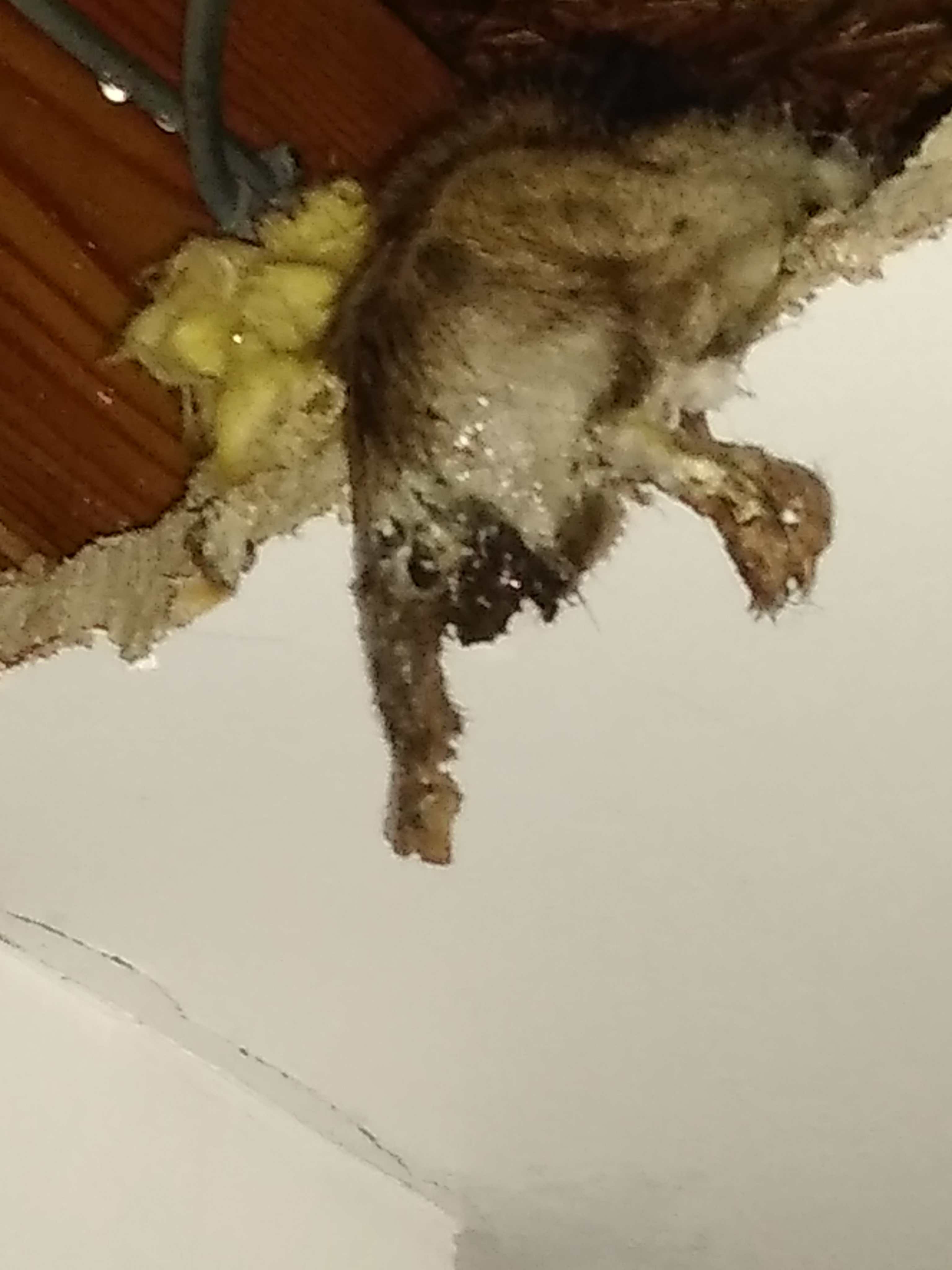

Is there a void that an animal might have crawled into and died?  I know there shouldn't be with airtightness regs but the last time I had a smell that I couldn't find the source for it turned out to be a dead neighbour 😌
Didn't you say on another thread that you were putting traps out for rats ? And had tried poison ?
You could perhaps have dead rats somewhere. Got any flies ?
What happened with us years ago - rats came up a drain - got into some house voids/cavities/subfloor - wife claimed she could smell something - rat man put down poison - also blocked drain aperture - rats slowly disappear - 2-3 weeks later a plague of flies in the house.

We had a strange, intermittent  smell at work, seemed to be coming out of an unused air vent.
Turned out to be a dead rat in a ceiling void.
The intermittency was caused by water leaking through the roof.
