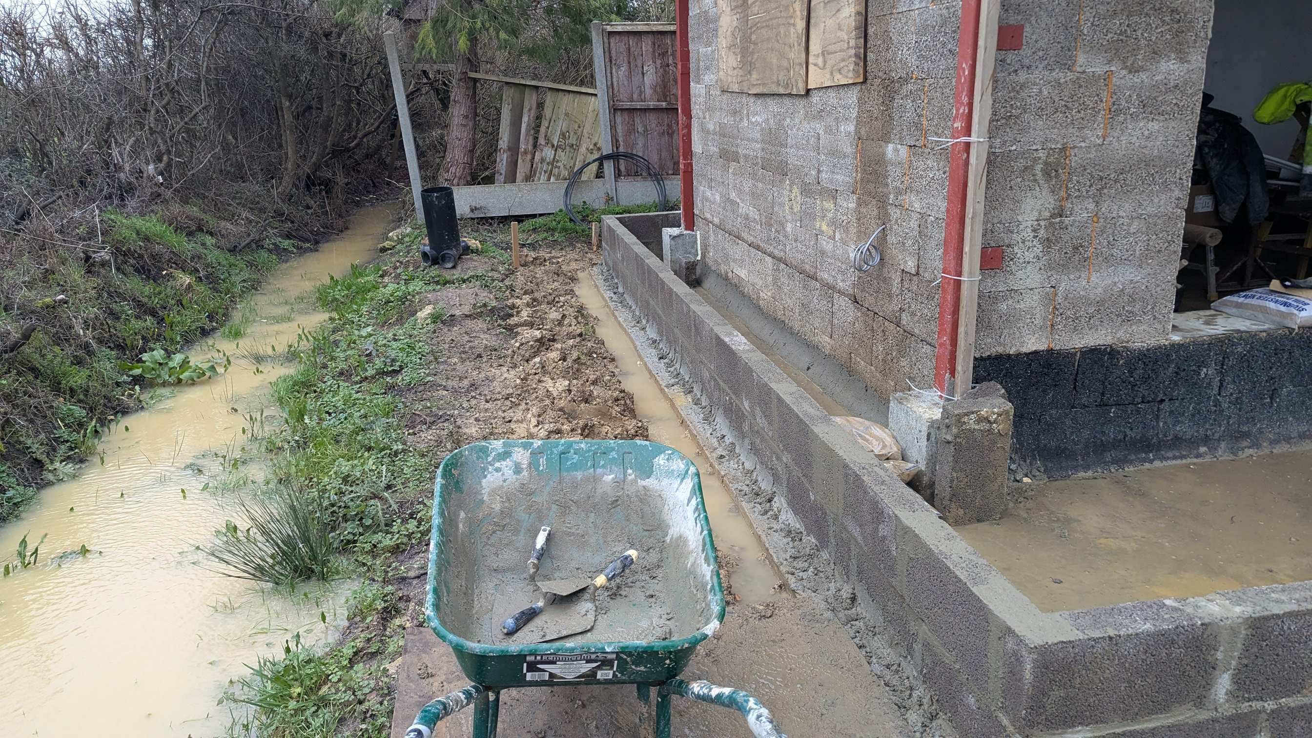

January 22Jan 22 We are battling the rain as much as possible, but it is difficult. We have a sloping site and dammed the foundations on the main house further up the garden so that I could build a small wall the last week or so round the Pod at the rear of the garden. That's finished now and today we will release the water from the house foundations! We are fortunate that there is a drainage ditch at the back of the garden that clears quickly. After having such a dry summer it is becoming very frustrating the amount of rain that we are having. Edited January 22Jan 22 by mjc55
January 22Jan 22 19 hours ago, flanagaj said: .... Are people literally just carrying on in the rain and pumping out ... Yes. Cladding our piggery in the rain. We've run out of contraband (Siberian Larch), so we're having to be creative 😐 1 minute ago, mjc55 said: ... We have a sloping site and dammed the foundations on the main house further up the garden ... That's the advantage you have that we had too: you can actually drain water somewhere
