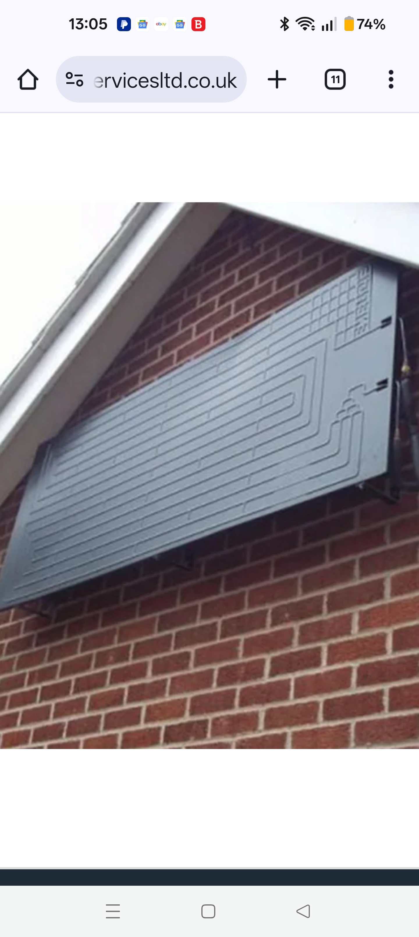

Beelbeebub Posted 3 hours ago Author Posted 3 hours ago 45 minutes ago, JohnMo said: Exactly the same a solar assist heat pump outdoor condenser, but indoors Ha! Yeah, but prettier obviously. What is that product? I wonder if you could get around the big box of an outdoor unit with a large black roof/wall mounted panel

JohnMo Posted 2 hours ago Posted 2 hours ago 58 minutes ago, Beelbeebub said: What is that product? Video -
-rick- Posted 2 hours ago Posted 2 hours ago Are they defunct? The website they give in the video seems dead. www.sahp.info Whats the website in your earlier screenshot?
JohnMo Posted 1 hour ago Posted 1 hour ago https://acwservicesltd.co.uk/electrical-services/solar-assisted-heat-pumps/ 1
