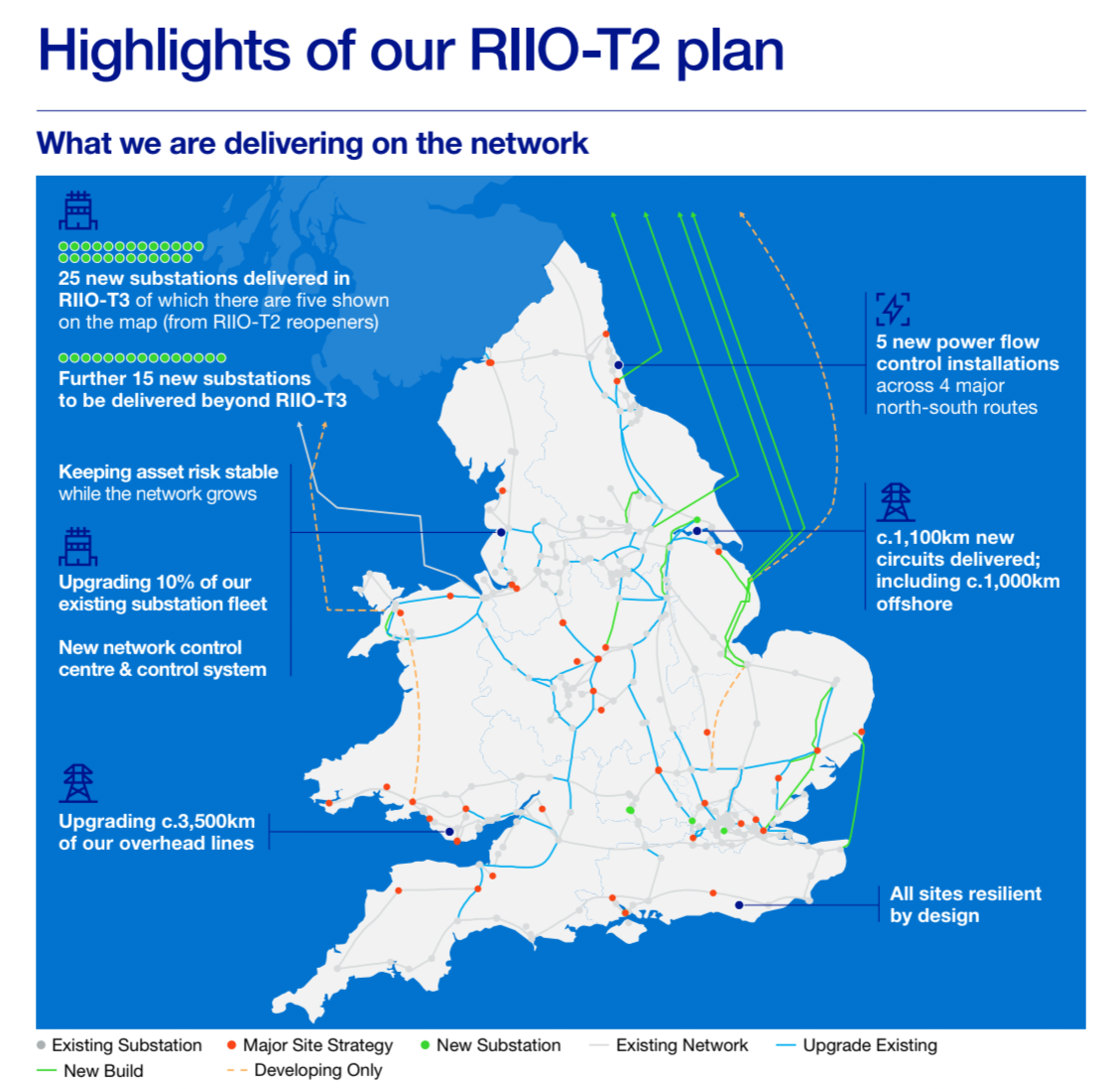

Regarding the cost of pylons vs underground.
The 4.5x figure is from this study by the IET & Mott Macdonald.
https://www.theiet.org/media/axwkktkb/100110238_001-rev-j-electricity-transmission-costs-and-characteristics_final-full.pdf
It's extremely comprehensive but the TLDR is
Pylons are £1-1.5k per Mw/km lifetime cost (so including capital, maintenance, lifetime etc) depending on the distamce and capacity.
Underground is £4.5-6.5k per Mw/km, again depending on distance and capacity.
So at best 3x at worst 6.5x - 4.5x being a nice central estimate.
Offshore cable is even more expensive at £9k per Mw/km and up.
It's worth noting an older 2010's) consultation reply by the CPRE put the cost differential, based on case studies in Europe (Denmark IIRC) at 3.5x and they had every incentive to pick the lowest figure possible as thry were arguing for more underground cable.
Unless someone can come up with a better study (not handwaving or "well it should be simple to....") we can take it as fact that underground transmission is about 4x the cost of overhead.
So, there is a compelling cost argument to go with pylons. Obviously the people who see them would prefer underground,but we must be aware of the strategy of those who oppose something to insist that a more costly approach be taken, then point to the high cost as a reason not to do the thing.
IIRC national grid has a £35bn plan over the next 5 years to upgrade the grid Screenshot_2026-01-26-16-52-43-100_com.android.chrome.thumb.png.ab838a2494ceec159d16618aca12487f.png
Note that the vast majority of new lines are offshore (so more costly) which was no doubt done to reduce the impact of the lines. There is also a lot of upgrading existing lines with new conductors.
(also this is the transmission network, the local distribution network has it's own set of upgrades)

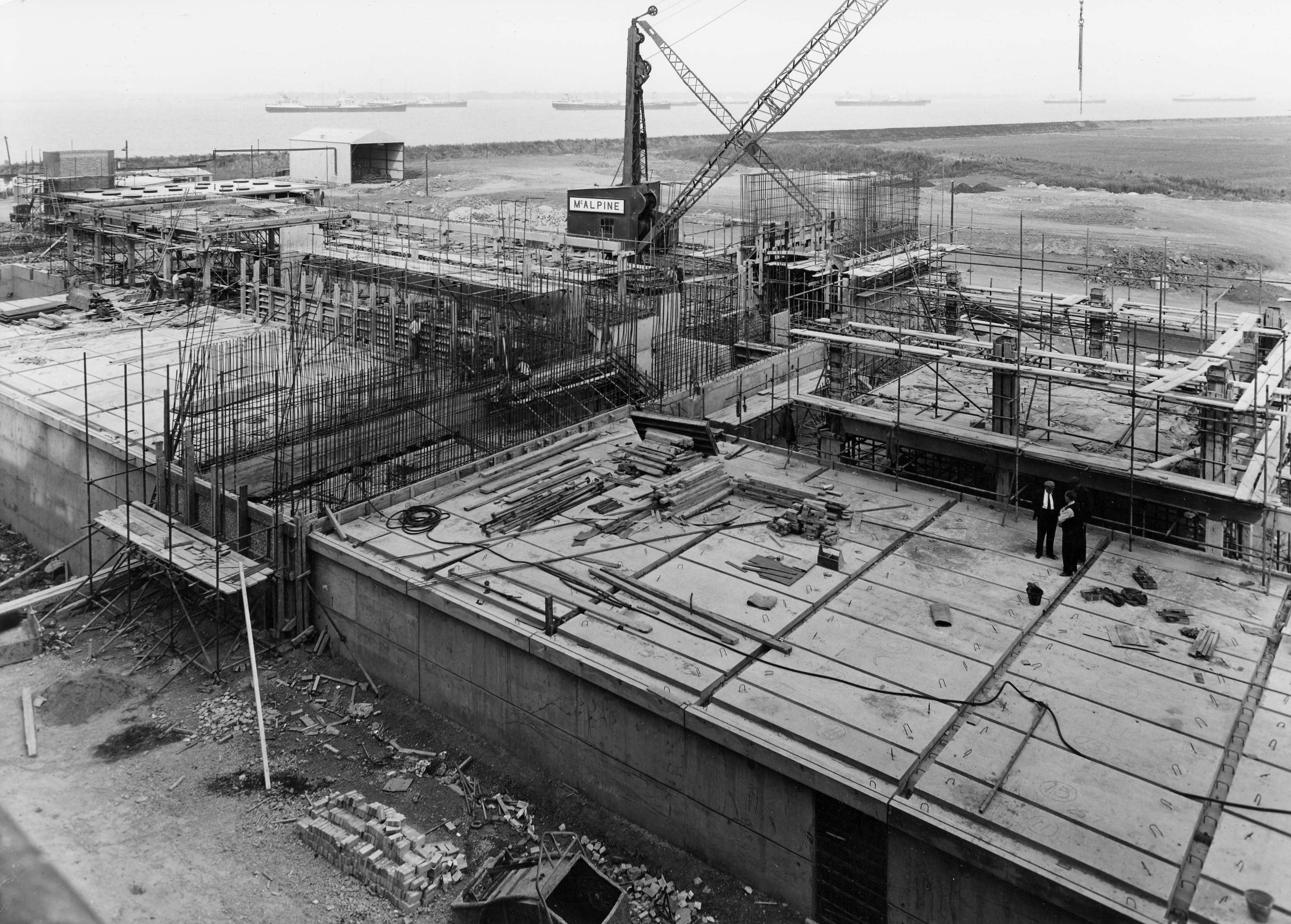

I have a technical background as the day job. As quick rundown. I worked at Torness Nuclear Power Station in my late teens early twenties, then became a local builder for 20 years, that was when Chernobyle accident happened and the Ayrshire farmland got potentially contaminated, that was a worry,  went to uni to become an Engineer. That was 20 years ago. My Master's degree group project was on energy, at that time Fuchishima happened. I got into cold formed steel and ended up designing a structure that sat over the cooling ponds on the Bradwell Nuclear power station at the decomissing stage. My litle bit was to do the structure that house the ventiulation units.. but it had to be lightweight.. but blast protected.. so a bit of a challenge, h3ence the cold formed steel.
But for fun to design this building we have to look back an understand how it was built in the first place, how far we could drill into the lid to stop radiation getting out. Below is a photo of the cooling ponds during construction. Check out the bowler hats! When I was at uni I got a summer job for McAlpine as a project Engineer.Bradwell008-21-09-1959.thumb.jpg.77d8486fdf80ecc8d97d7701a6893824.jpg
I'm not going to go into my own political views but as an Engineer I think the UK is a bit (expletive deleted)ed as we are living from day to day essentially. We use to be an Empire, strong, we made war and more often than not we won, you don't go to war to lose! . But remember the British ended slavery for example, we paid for that as it was the right thing to do.
For me national security has to come first. There are many countries in the world that do not share out values. Appeasment will not work, yes we would like it to,  but lots of young folk just don't understand that there are a lot of bad folk in the world.
So in the round. Yes we need to reduce our carbon footprint, reduce our usage but there those that say that our oil and gas industry is kaput are talking out of political nonsence. The West of Shetland fields contain lots of oil. There are plenty on BH that advocate this. I disagree with you on a strategic basis.
You see lots of folk on BH that are really invested and have made a good go of making their houses "say a bit passive" but they have enough money to do this. They can afford to be that way! Your average punter is just trying to make ends meet! You have some on BH making eco arguments.. but do not look at how things work in the wide world and their actual carbon footprint. Many on BH are just enthusiasts, just like car enthusiasts when it comes to energy usage, there is no harm in that. But that comes at a price.
I actually grew up in Africa..been in the middle east.. so I am not some daft "gammon" as many may assume I am.
In the round I feel that UK energy policy should be driven by say a 50 year plan ( I wish) that means exploiting our own oil and gas, digging some coal! , using that money to innovate. The Chinese think we are all soft, trying not to offend religions, woke.. well we are let's face it, about half our politicial representatives don't know what a woman is!
I despair as an Engineer and am very worried about the future of our kids.
Anyway I hope the photo of Bradwell lets everyone see how a plant like this was constructed at the time. Even if you disagree with me then that's ok, just enjoy how these guys constructed a plant that operated safely and is still, to this day, getting decomissioned.. at losts of cost mind. But hey ho just admire what these guys did.
