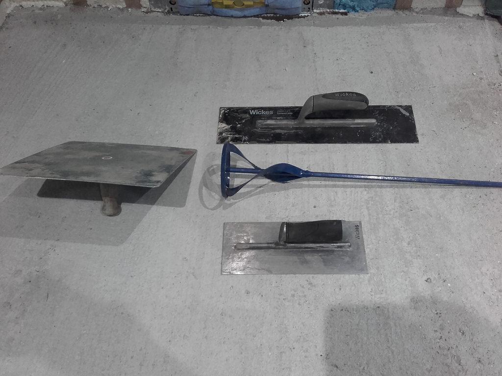

PeterW Posted June 15, 2018 Share Posted June 15, 2018 33 minutes ago, Onoff said: I might lay some to stop pva etc falling on the concrete and causing later adhesion issues with the floor tiles. Veering towards Febond Blue Grit now though! I'm v.likely going to have a crack myself. Rest assured I'll post up if it cocks up! I take it you’ve bought the new trowel too then ..?? Link to comment Share on other sites More sharing options...
Onoff Posted June 15, 2018 Author Share Posted June 15, 2018 55 minutes ago, PeterW said: I take it you’ve bought the new trowel too then ..?? I've got what I've got Link to comment Share on other sites More sharing options...
PeterW Posted June 15, 2018 Share Posted June 15, 2018 If the big one isn’t a decent brand broken in Plasterer’s trowel then walk away... you will never get a good finish with a cheap trowel. Seriously - get someone to do it ..! Will take you twice as long and cost more if you need someone to get it fixed. Link to comment Share on other sites More sharing options...
Onoff Posted June 15, 2018 Author Share Posted June 15, 2018 7 minutes ago, PeterW said: If the big one isn’t a decent brand broken in Plasterer’s trowel then walk away... you will never get a good finish with a cheap trowel. Seriously - get someone to do it ..! Will take you twice as long and cost more if you need someone to get it fixed. The big one's a st/st one from Wickes. I've used it before and the BiL used it previous when he did some for me. Link to comment Share on other sites More sharing options...
