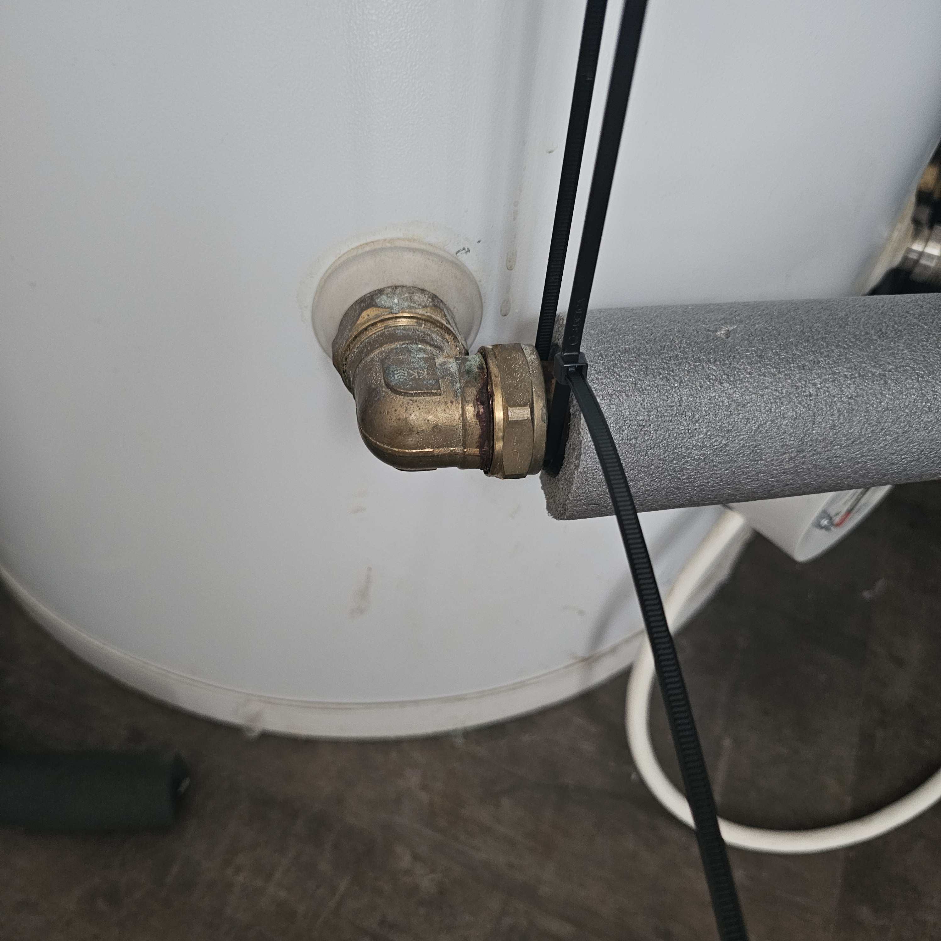

canalsiderenovation Posted January 16 Author Posted January 16 (edited) Will fully update later but have a guy here now from same company whose first question was "who did the service?" Embarassing when I said same company you work for but different guy! This guy seems to know what he is doing been doing it 27 years. Expansion tanks just needed pumping up which he has done and DO NOT need replacing.... paid 50% deposit on the basis they said they needed replacing and guy is going to sort with office. Is sorting that leak (pic I uploaded with the leak from the bottom of Gledhill tank) which he noticed right away. Will explain other stuff later on.... Edited January 16 by canalsiderenovation 4

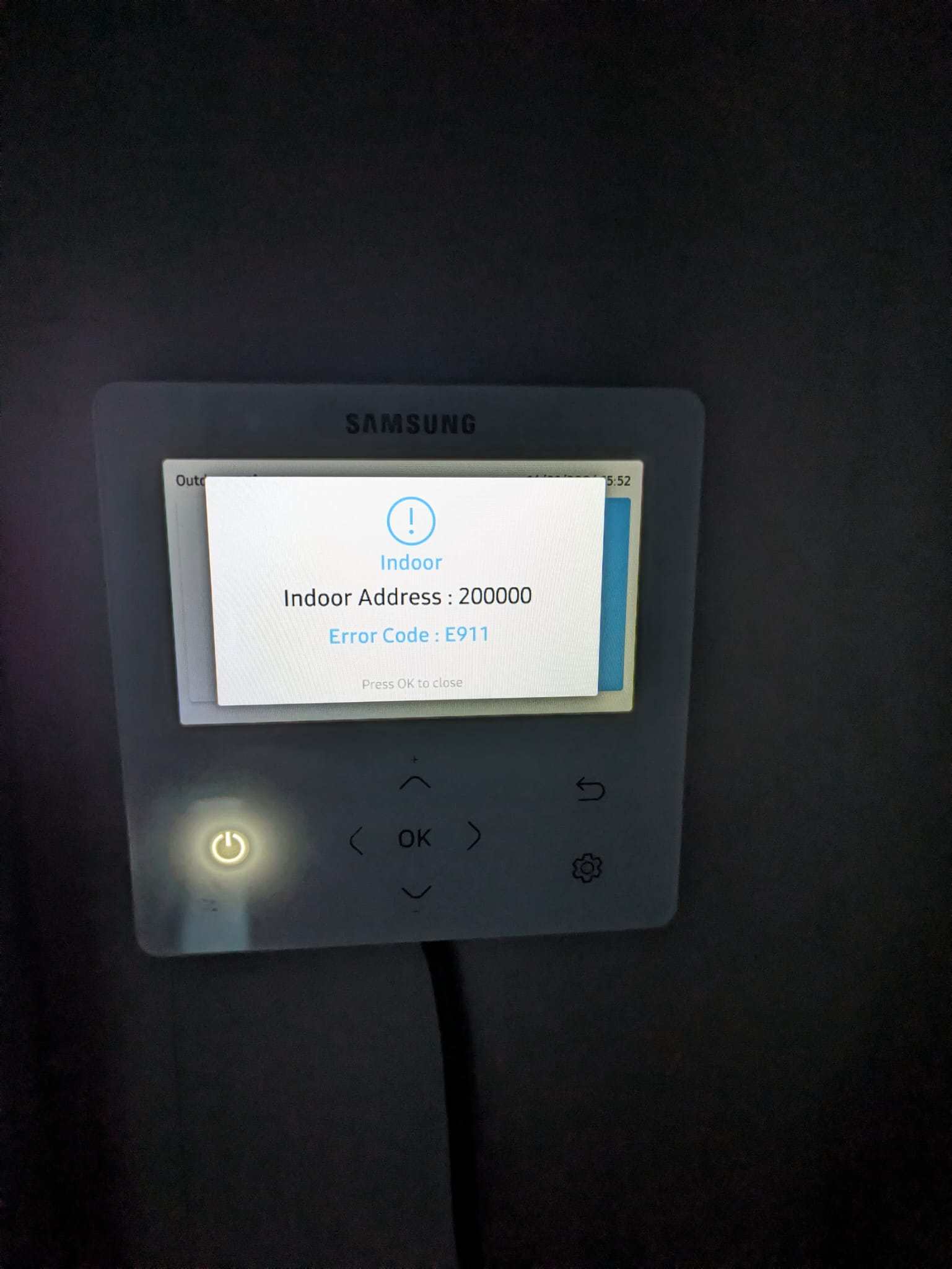

canalsiderenovation Posted January 16 Author Posted January 16 5 hours ago, ProDave said: Looks hopeful. Can't wait for your later update. I spoke to soon. Now we have no heating or hot water and an error code. We had to leave the minute the engineer left as they were 2 hours late. He left the heating and hot water on. Clearly the error code came right after he left as our hot water is 18 degrees and the house is cold. I am absolutely fuming. We are in an even worse position than before. I will be on the phone to them at 9am in the morning!

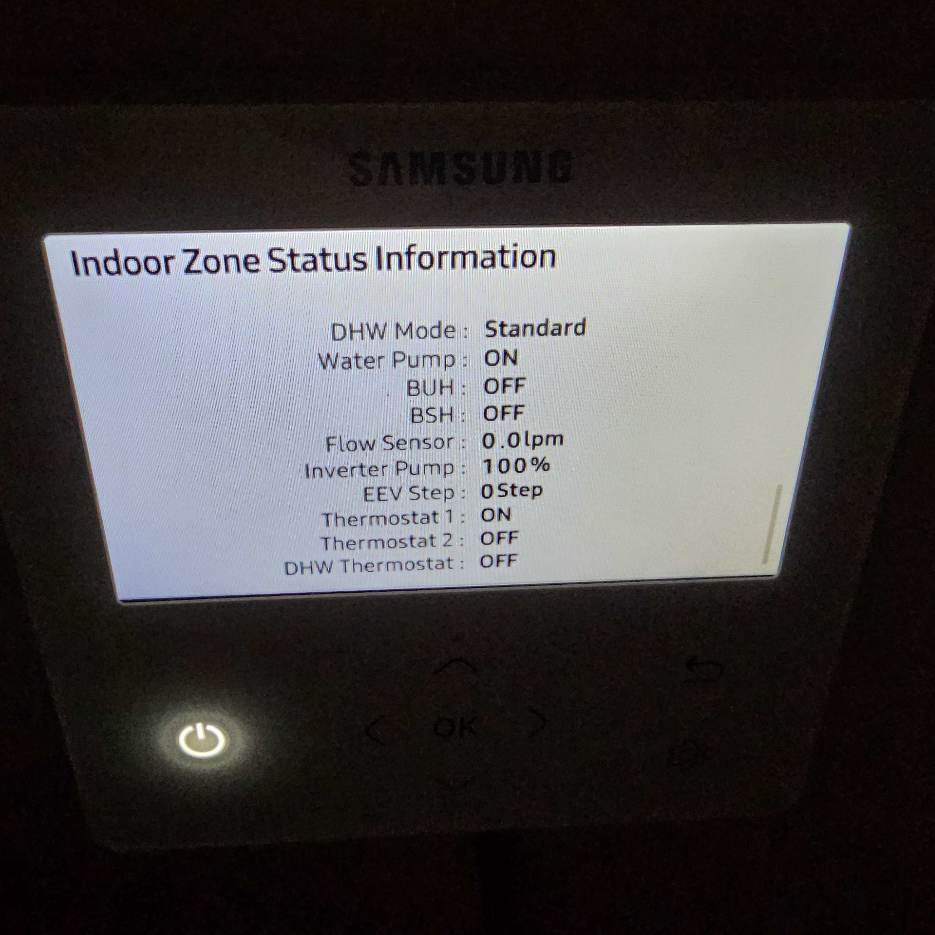

canalsiderenovation Posted January 16 Author Posted January 16 Flow sensor is zero so that is the problem but I can't test any further. Within a few seconds of turning the heating on the error code comes up.

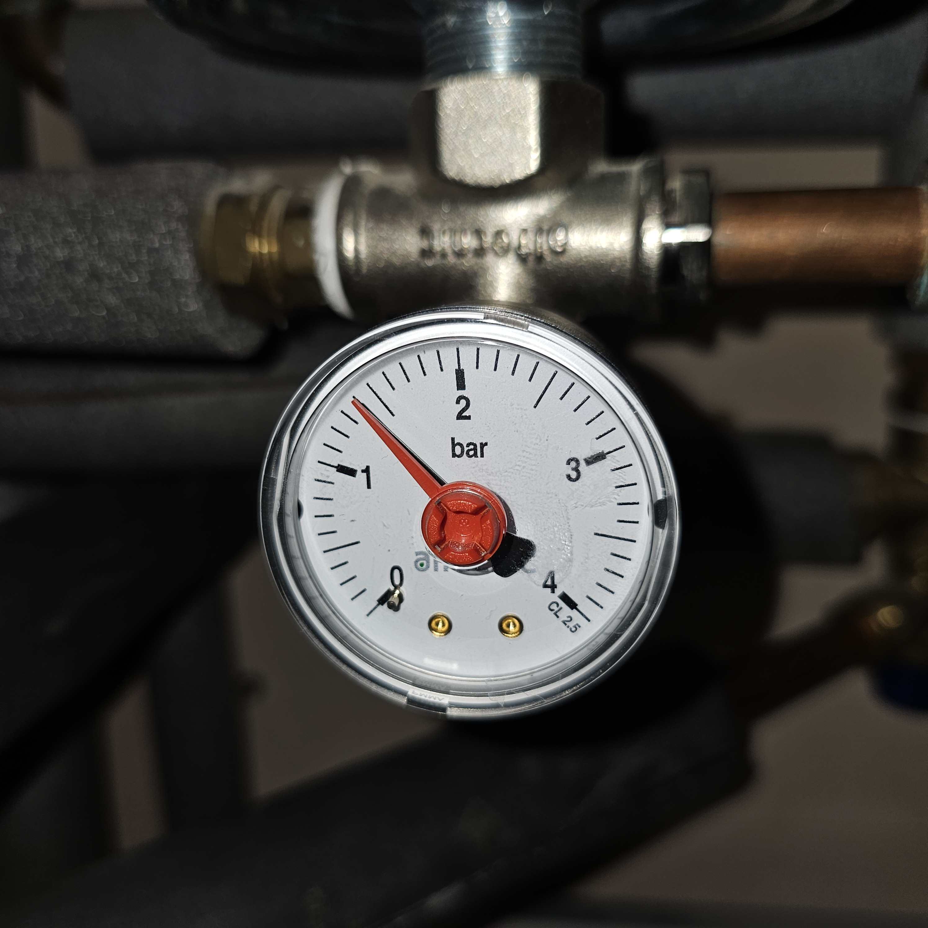

canalsiderenovation Posted January 16 Author Posted January 16 (edited) 27 minutes ago, -rick- said: Whats the pressure reading below the red tank? Fine. When I go to turn on the heating or hot water there is what sounds like a grind noise coming from below (I think the pump thing). I have sent a scathing email to the company. We are in an even worse position than 24 hours ago. How they have managed to cause more problems I have no idea. We had heating 24 hours ago and even hot water albeit with a leaking tundish. Edited January 16 by canalsiderenovation

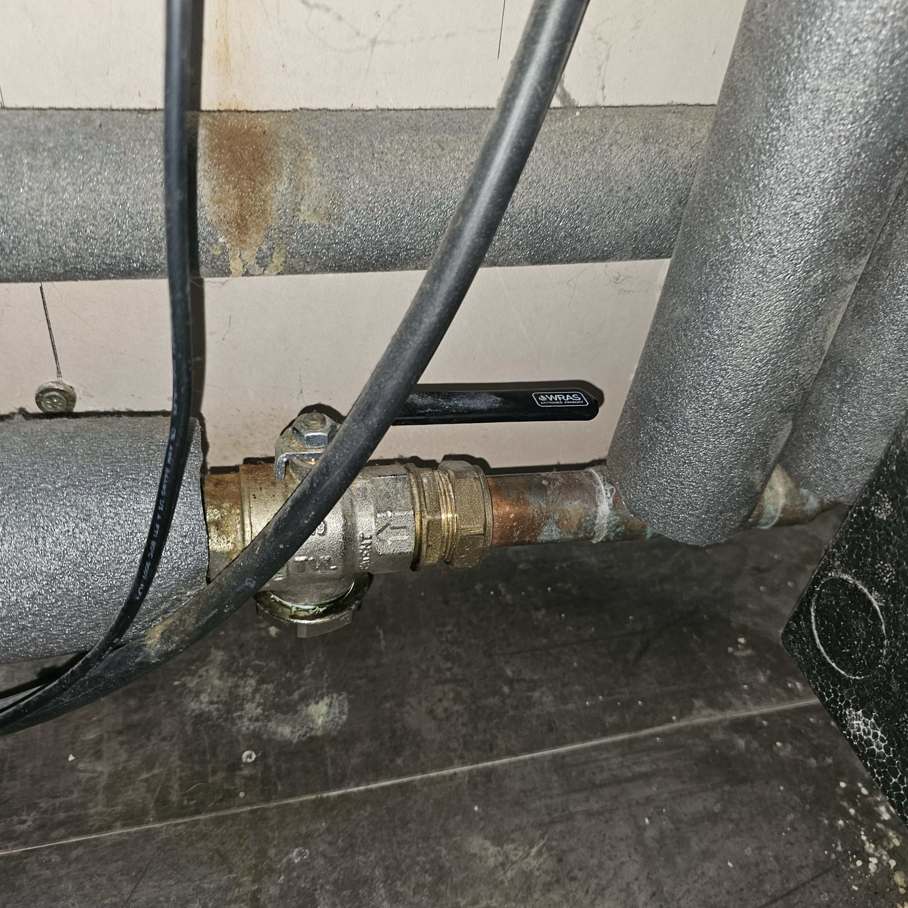

Beelbeebub Posted January 16 Posted January 16 Have they left an isolation valve shut somewhere? Eg the ones usually by the HP outside? Pretty poor show though.
canalsiderenovation Posted January 16 Author Posted January 16 40 minutes ago, Beelbeebub said: Have they left an isolation valve shut somewhere? Eg the ones usually by the HP outside? Pretty poor show though. What would this look like?
Beelbeebub Posted January 16 Posted January 16 1 hour ago, canalsiderenovation said: What would this look like? Honestly, there are too many types to say. Sometimes they have levers on, or "butterfly" handles, a slot for a screwdriver or sometimes thry are removable so there isn't much to see. Without wanting to sound mean, if you have to ask, you probably need to wait until tomorrow morning and get the engineer out. It wouldn't be the first time an engineer has left a Friday job forgetting to turn a critical bit of of equipment back on. Good luck.

canalsiderenovation Posted January 17 Author Posted January 17 The same guy from yesterday came out. The filter was blocked (this bit). He said he did test it before leaving but obviously more crap got in it. He has shown me exactly what to do to check the filter now for future. The rattling sound is actually the coil at the bottom of the Gledhill tank. He has adjusted the flow etc and its 18.2lpm. There is a little rattle and he showed me if you apply a bit of pressure to the top and bottom pipes it stops. I'm still not sure why we have this now and didnt before. He has used zip ties to apply this pressure. Not ideal but for now we have heating and hot water. I think perhaps in the long term we need to get someone else out as I don't know why we have had no rattle for years and now do. He did say you can fit a valve/additional pipework. 20260117_104834.mp4 Going back to yesterday. The issue with the tundish was all to do with the pressure issues and there was quite a leak from here which needed tightening. He said that was likely the cause of the pressure drop and subsequent issues. The expansion tanks did not need replacing, just pumping back up. 1
