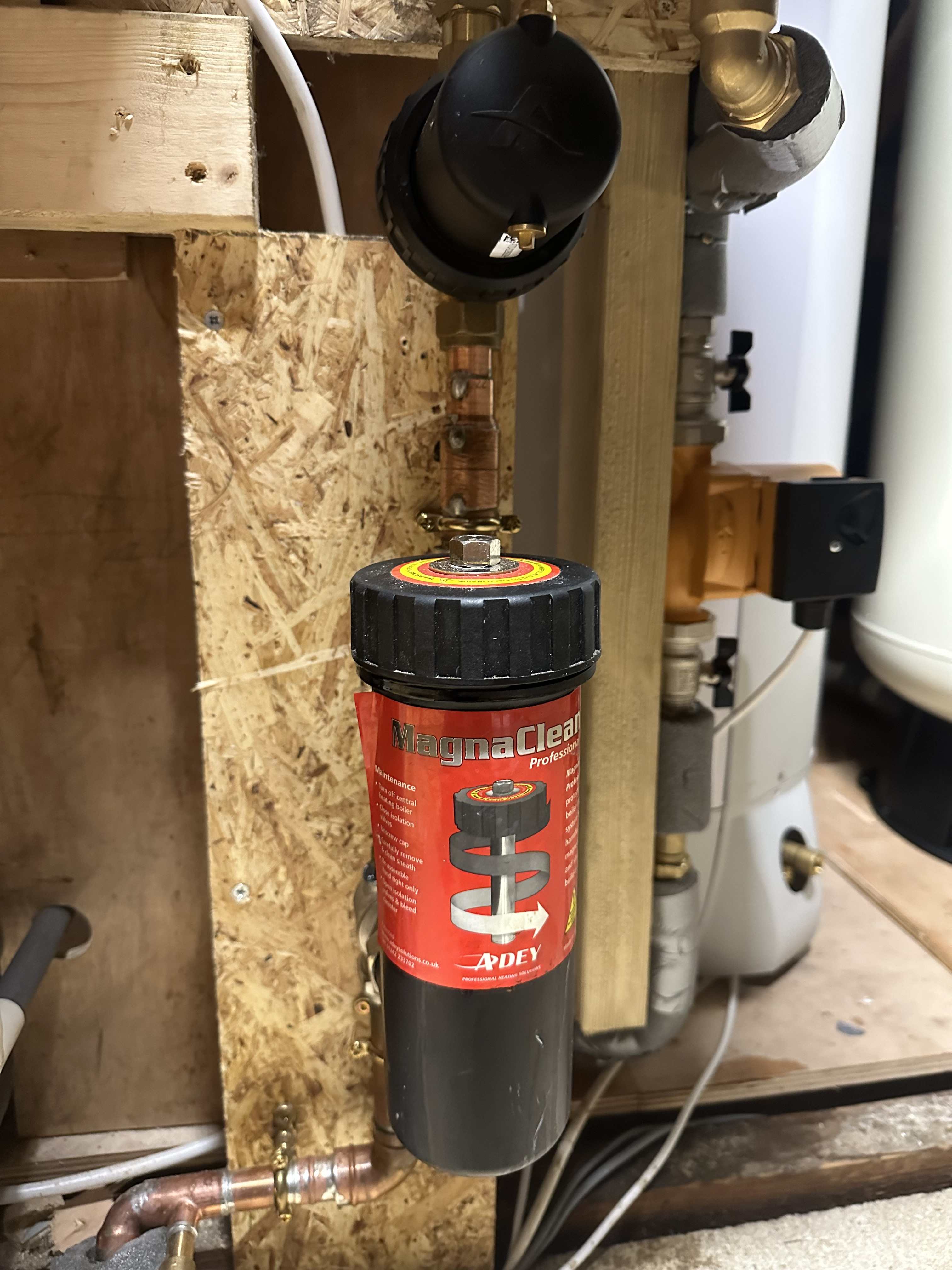

Also ask (whoever) to fit a mag filter which has a drain point at the bottom (a-la the TF1); it was annoying as feck to have to siphon out the water in an Adey Magnaclean to dump in some inhibitor this week.

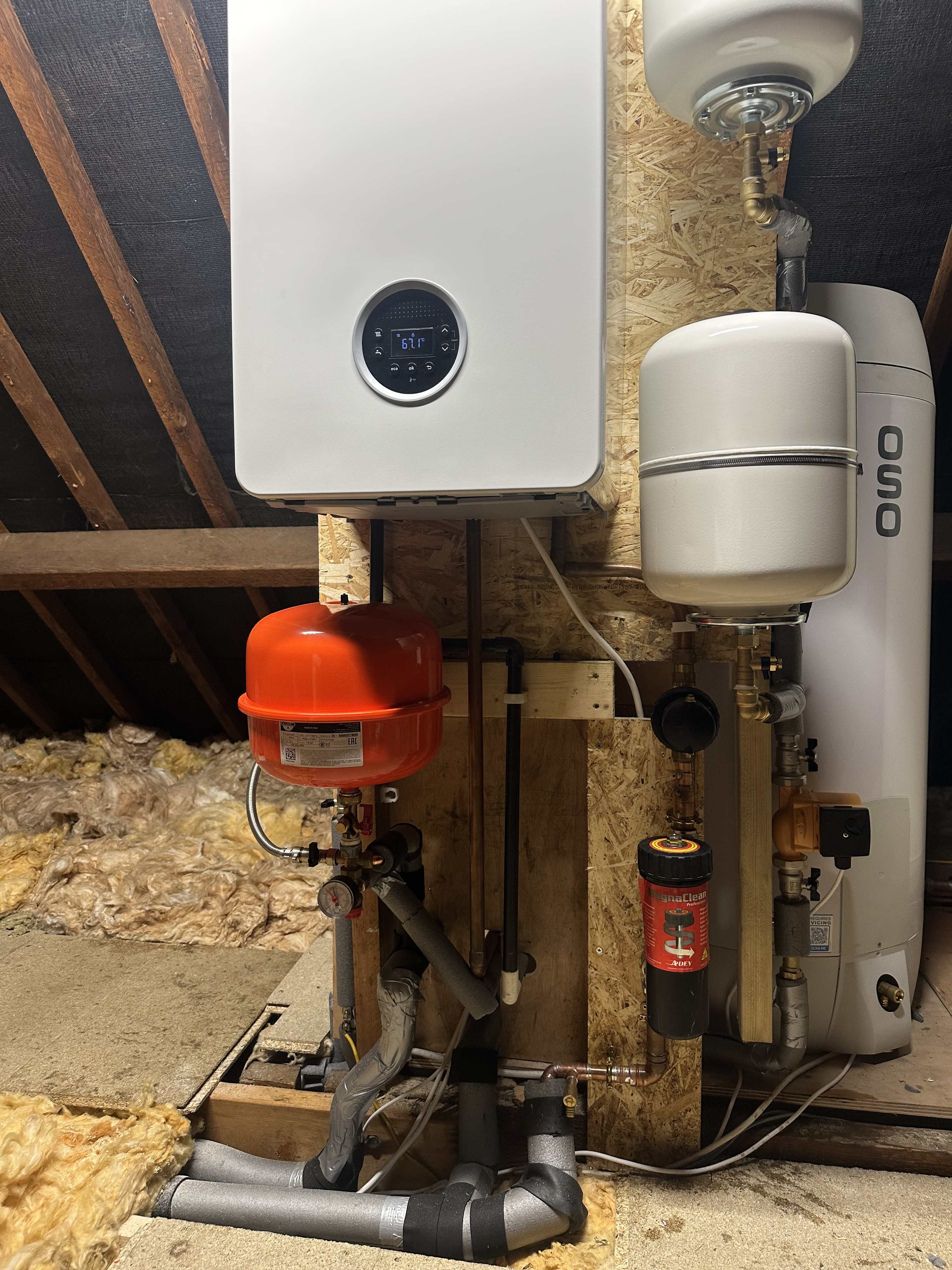

IMG_3645.thumb.jpeg.bcfe8c9bc7c481565ba1e54da6ebefa8.jpegIMG_3652.thumb.jpeg.a40cfb2b9f1bd44fe39d6d07237c1cda.jpeg
The client had a new WB boiler fitted, so the one above was requisite for warranty. Note that is an Adey one (mass produced for WB most prob) but has a vent on top and a drain off at the bottom.
The Magnaclean had just the vent at the top which was quite annoying. More annoying was the valves on the Magnaclean wept slightly when in the off position.
@canalsiderenovation, I’d go for a TF1, but the biggest plus here is when the system needs dosing again.
You just turn off the valves either side of the filter, put a bowl under the filter and open the drain to empty out. You remove the magnetic cartridge and clean it, then put it back in, remembering to check you closed the drain off properly (1/4 turn like the filling loop ;) ).
You can then self administer the additional glycol by pouring it into the empty filter vessel.
Close the lid, open the two isolators back up, vent the filter with a radiator key, and get your arses to the pub. No plumber needed.
