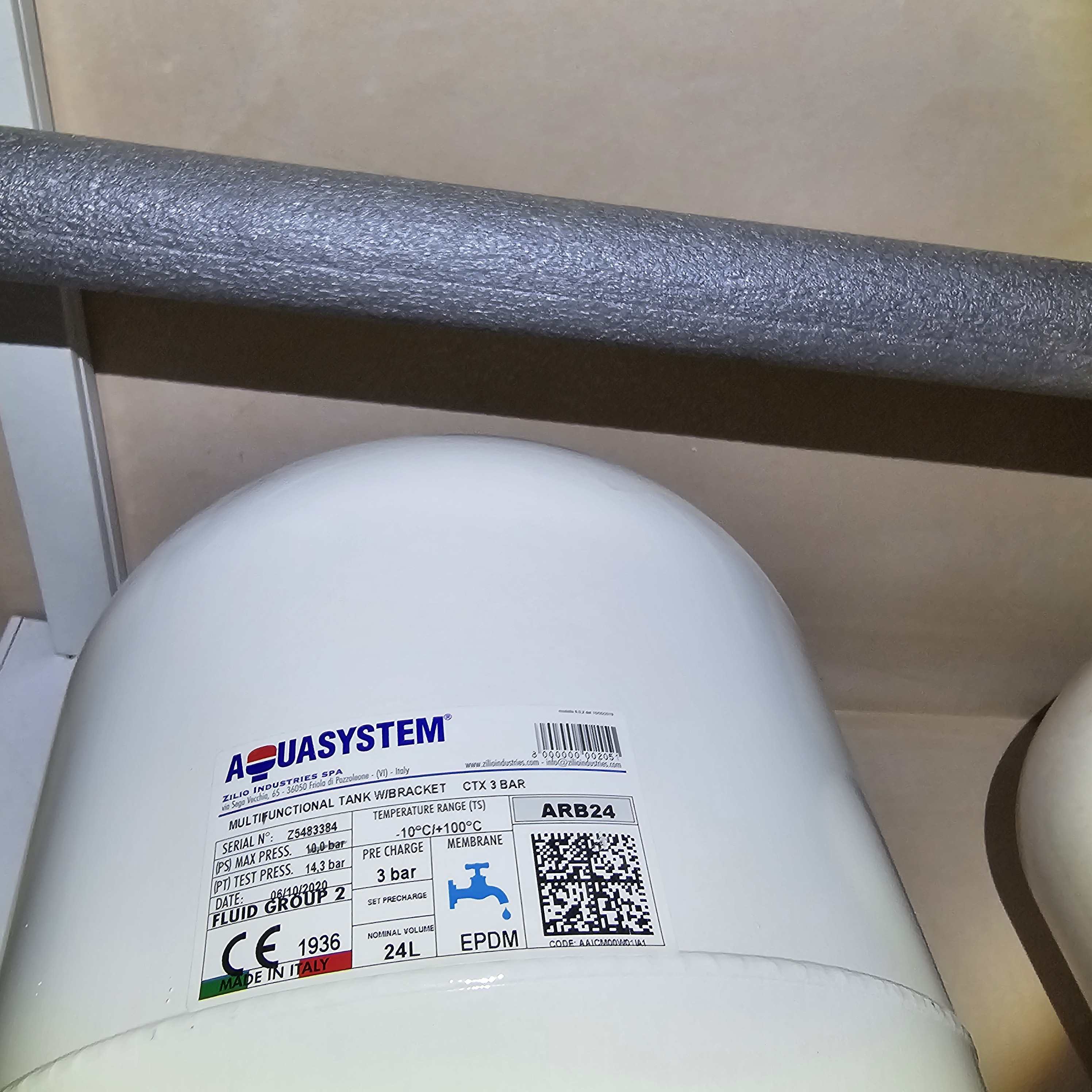

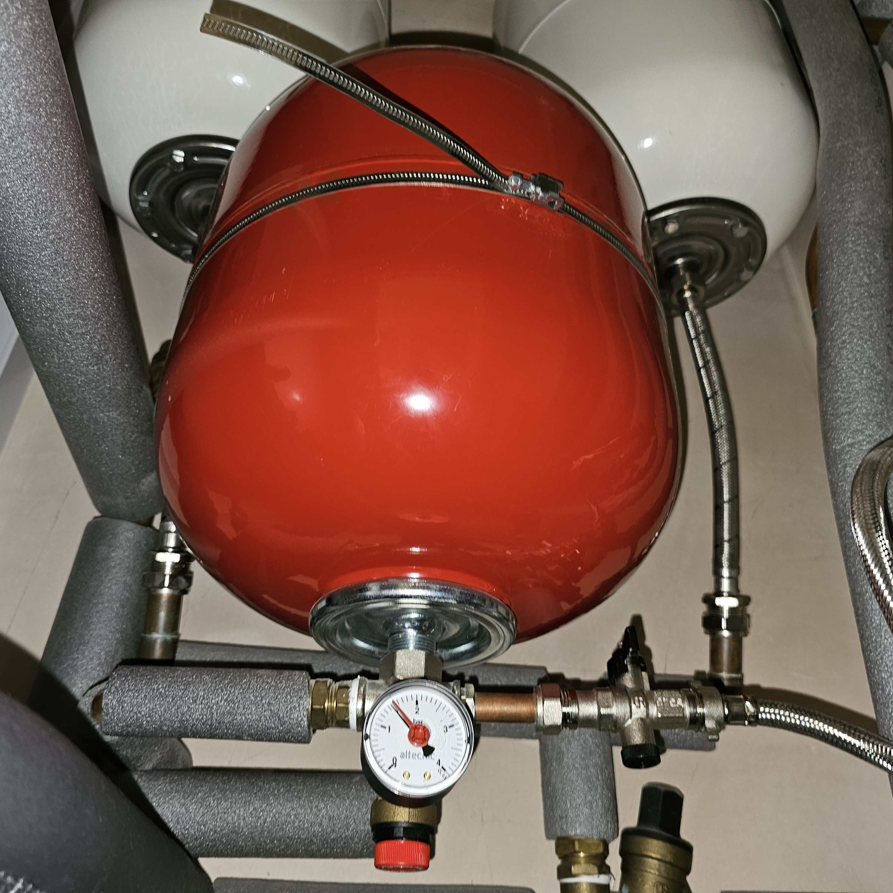

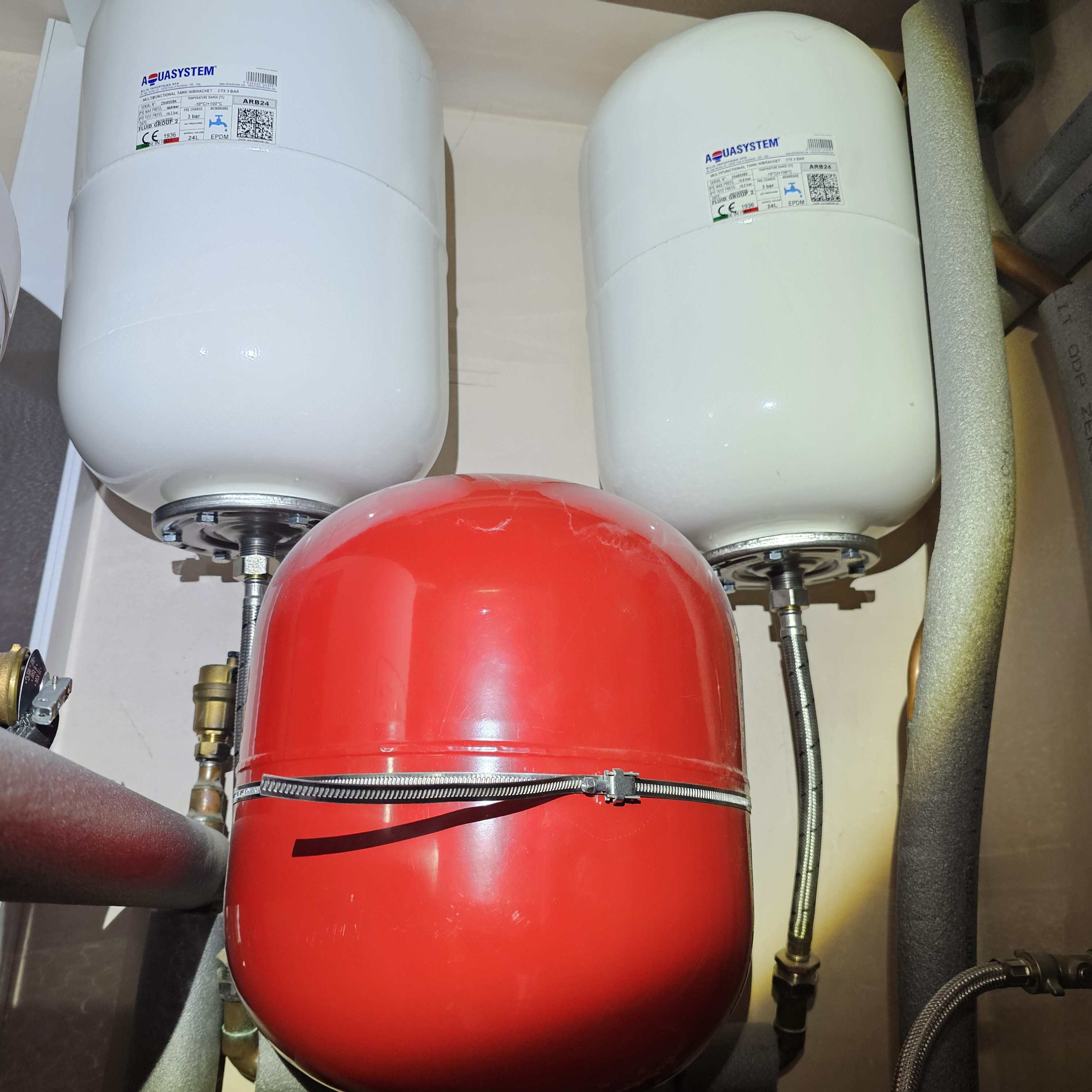

It was installed on 8.12.2020. So over 5 years old. Here are some better pictures.
20260109_151530.thumb.jpg.029e6dae3cd897ae27c897d9056793fe.jpg20260109_151558.thumb.jpg.5a2c51fe6d05ee57eba50a91ed0c5372.jpg
Oh you have 3 in total.  The red one will be for heating, that is your one with the immediate issue. The TWO white ones are for the hot water.  There is no indication that there is actually an issue with those yet.  The fact this guy suggests replacing the 2 white ones but has not addressed the low pressure on the red one has done nothing to give me confidence in him.
Lets tackle each separately.
The white ones don't have a pressure gauge, they will be at mains water pressure.  They are to take up the expansion when the water in the tanks gets heated.  IF they have a problem, you will see water being discharged via the tundish after you have say had a shower and used up some hot water and the cold water that has entered the tank to replace it is being heated.
If you want help identifying what the tundish is, post a picture of the pipework below those tanks.
A further note, those tanks are of the type where you can take that bottom flange off and use that access to replace the bladder if it has burst.  But I suspect the labour charge would make that more expensive than just replacing it, if they are faulty.
Summary.  If you just accept that quote, you will get 2 shiny new white tanks that may or may not be faulty, and the low pressure on the red one will still be the same.
+ 1
The heating one needs to be tested and it's not always possible to do this at one visit because of the test that are done:
1. tank is found at low pressure - you've got to re-pressurise and see how it performs over a few heating cycles
2. If the valve squirts out water when under pressure, this does not immediatley indicate the bladder is shot as it can be condensation build up over the years. So always re-pressurise and see over a few heating cycles.
The indication is that because the system has to be de-pressurised and cold to check the expansion vessel pressure properly, it probably wasn't done.
But, if the expansion vessel has failed, you will see an increase in system pressure when the system gets hot and this will continue to rise as the system is topped up until the pressure relief valve starts letting by. It's therefore a good idea to check to see if there's any indication of let-by from the heating system prv tundish. The pattern to watch for is - top up pressure, pressure goes down, top up more pressure, pressure goes down until the expansion vessel is completely full and there is no expansion space left, then pressure increases to let by of prv.

Where was their rationale for the 2x potable (white) vessels needing changing?? Bloody nonsense. At (only) 5 years old they should be fine!
Unusual to see two on the hot water, but I always add extra volume on all of my installs, simply as a good measure; you can't have too much expansion afaic.
Does the UVC ever heat off the immersion, routinely, as that can seriously over-exert the expansion vessel(s), off solar PV divert etc maybe? If off the ASHP only then these should be living a very easy life, and last a fecking long time.
Defo kick these lot to the kerb, and get a new plumber who actually gives a shit.

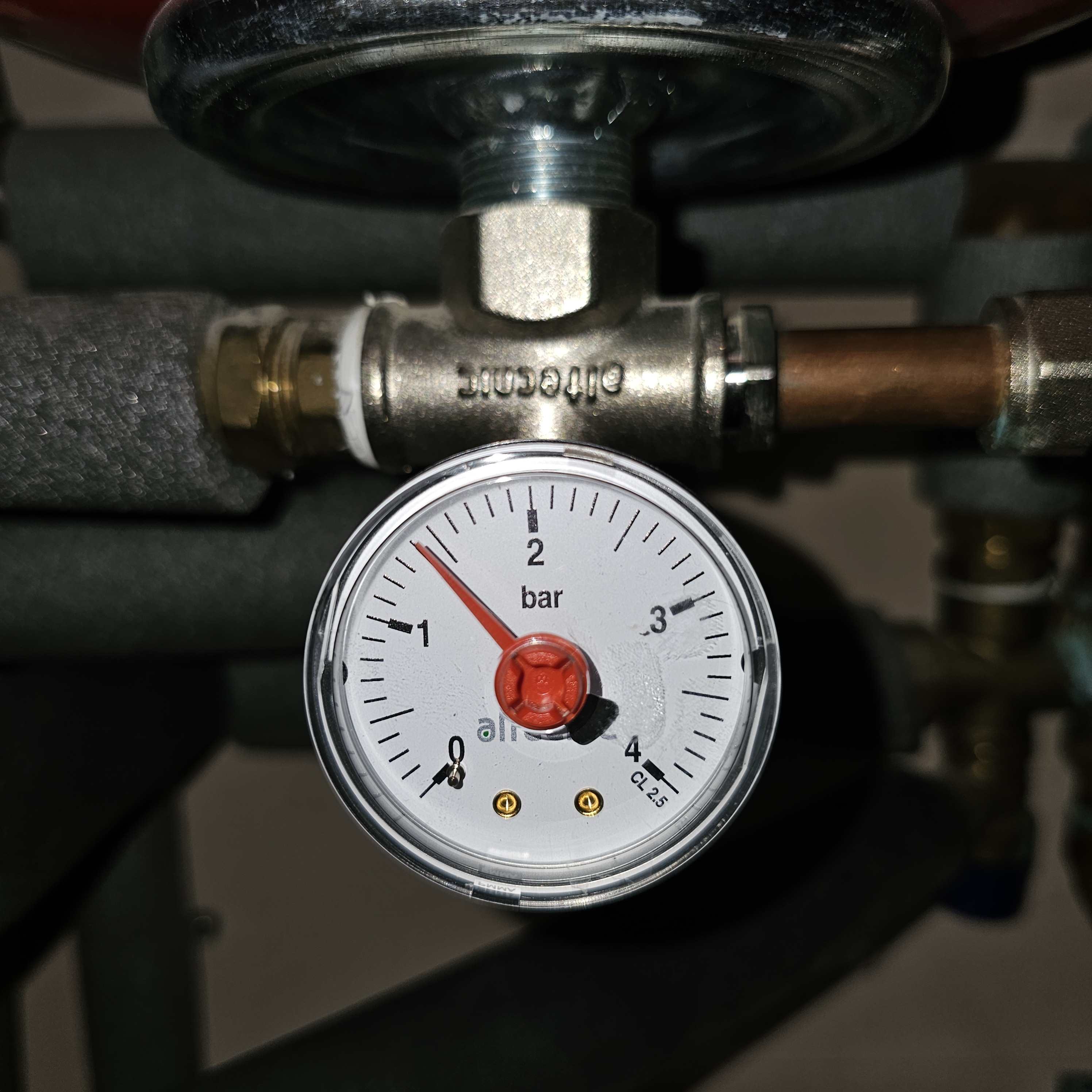

So, checked this morning and everything all fine since I added pressure back. Heating and hot water working, not noticed any dips in the black/red bar thibgys when the heating or hot water is on or off. Since I added the pressure back I have made a few checks throughout the day today and yesterday when heating is on and off and hot water is on and off. No change.

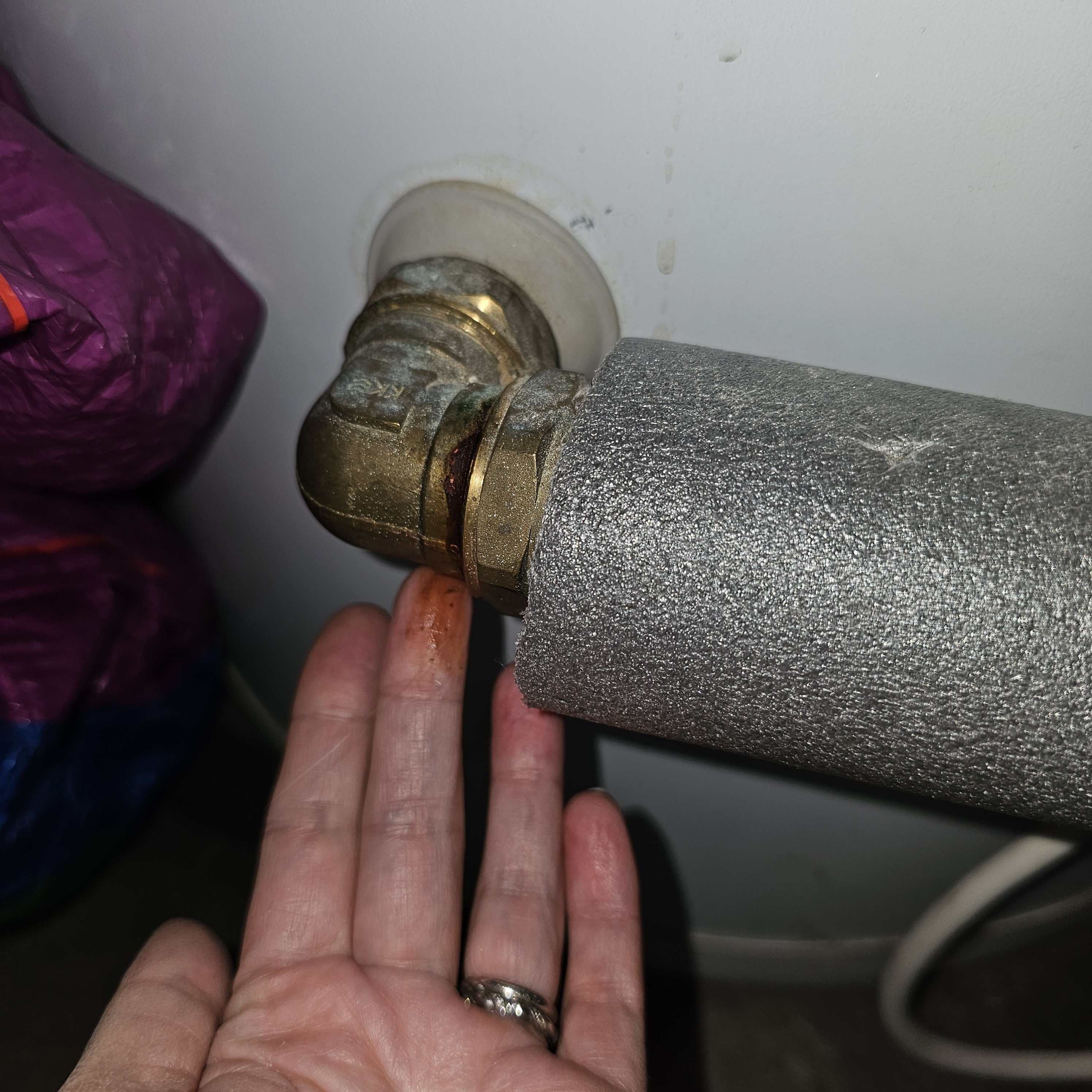

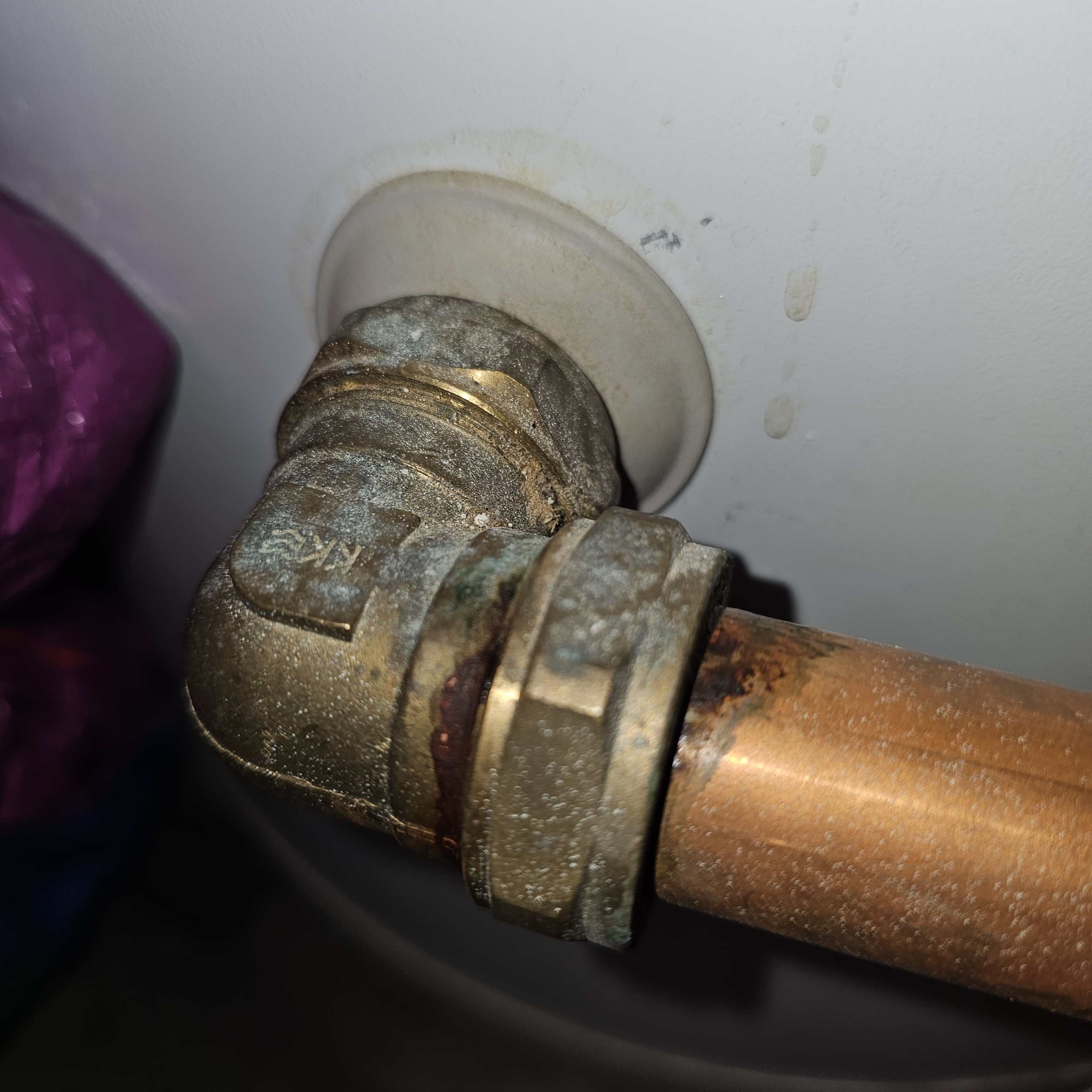

One thing I did notice when having a good nosy around is on the bottom of the Gledhill tank. It is not dripping or but there was a copper wet mark on the floor and when I touched the pipe I got a rusty damp finger.

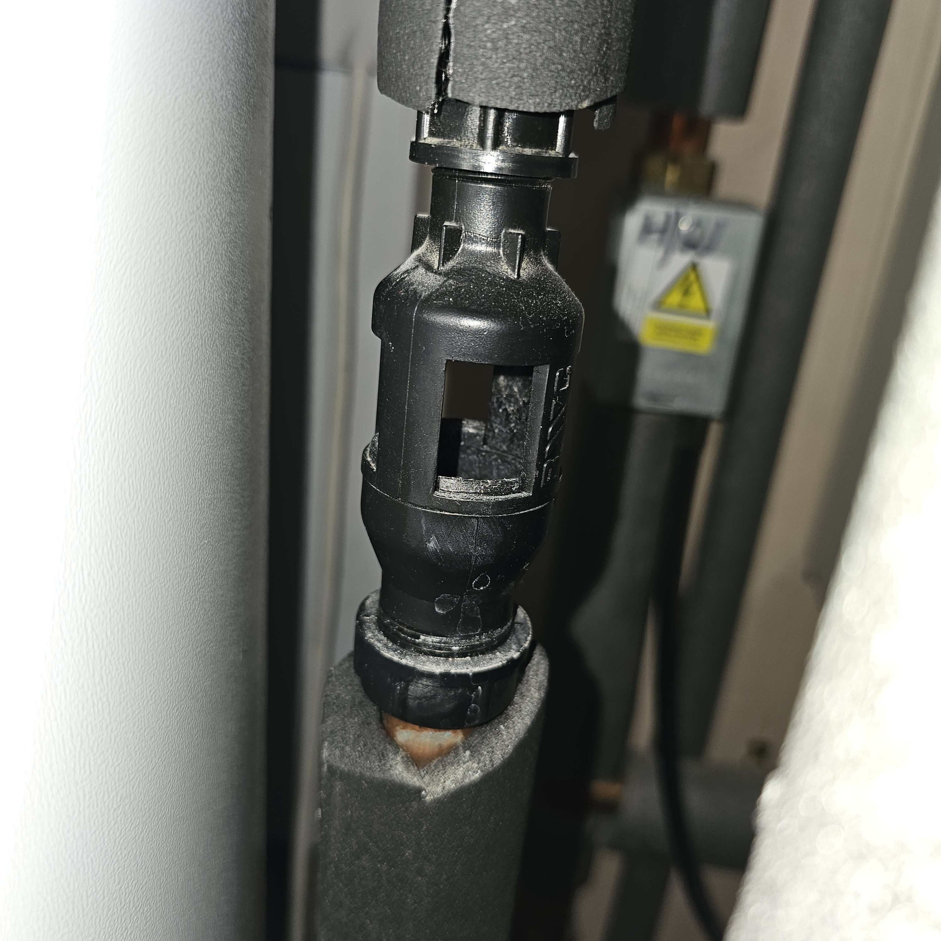

So it looks like the red heating expansion vessel is okay.

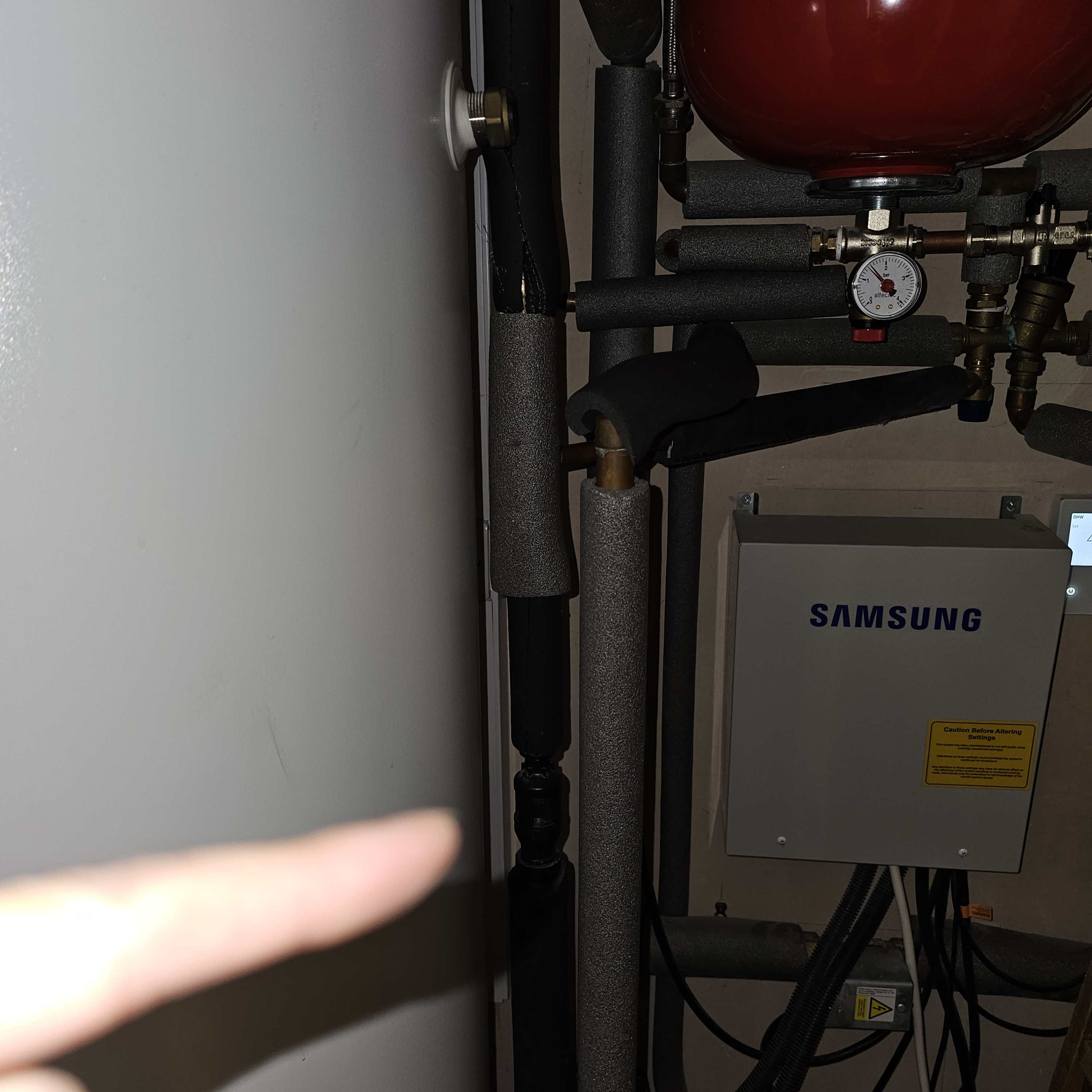

Just the 2 white ones to check.  Can we have a photo of the pipework under the tanks?  We are looking for a Tundish that will look a bit like this
Triton Instaflow Discharge Tundish 15mm x 22mm
When you find something like that, have a close look at it.  If there is a problem with the 2 white tanks that the plumber wants to change, then whenever it heats the hot water, you will see water dribbling down the inside of this.  It should be bone dry normally.
The red bar thibgy won’t move unless you move it. It’s a marker to show where the black thibgy should be.
You should never need to move it but it can be moved to indicate a different pressure by using a screwdriver in the centre.
Is it this that is coming from the Gledhill tank?
It feels dry at the moment. I can test it later and turn the water on after I have had a bath.
Cant see anything else like that.
