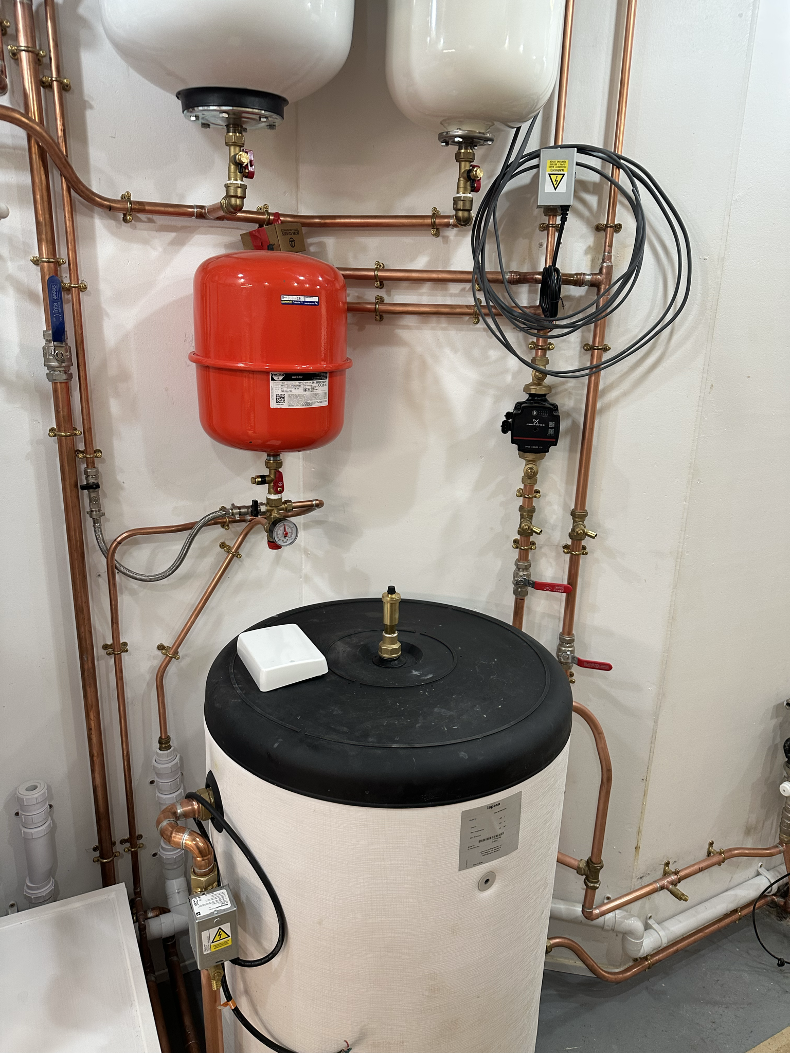

ASHP low pressure help pls
3 hours ago, canalsiderenovation said:
We had not noticed any issue with pressure dropping or leaking tundish til after then so maybe....
....they didn't top back up and run the system to bleed it after topping up the glycol....
That's what my money is on if this issue never previously existed, and has now 'gone away'. Will be interesting to hear you report back as it is best to now check it every other week and note any drop. Check it when the system is cold if you can, so the readings aren't of hot (expanded) and then cold (contracted back).

  • canalsiderenovation
    canalsiderenovation
    Will fully update later but have a guy here now from same company whose first question was "who did the service?" Embarassing when I said same company you work for but different guy! This guy seems to
  • Beelbeebub
    Beelbeebub
    2 possibilities   You have a leak somewhere   You may have an issue with the expansion vessel (red tank)    First check the expansion vessel   When the pressure
  • Nickfromwales
    Nickfromwales
    Where was their rationale for the 2x potable (white) vessels needing changing?? Bloody nonsense. At (only) 5 years old they should be fine!   Unusual to see two on the hot water, but I alway

I don't think they topped up the glycol, this is on their quote to do with the expansion tanks. They noted the glycol was low.... they are doing it on Friday.
The system will be cold (we have not turned the ASHP hot water on since yesterday and won't be turning it on before they come Friday AM. The heating will be off at that time too.
A service is supposed to test stuff and then fix and replace items needed. A standard item is test glycol and top up as required. They are also supposed to clean the condenser (finned heat exchanger you fan blows through), clean the casing, inspect expansion vessel pre charge pressure and top up as needed. A cylinder that has got a defective expansion vessel should not be put back in service, as the expansion vessel is a safety item, and be an item to fix asap, as the home owner would no longer have hot water.
If you took your car for a service and it came back with a service invoice stating your oil and filter needed to be replaced, and you will need to book that in as it's additional cost, you would be well pissed. That is the service level you have just experienced with ASHP.
Ok. Once the glycol has been topped up, ask them to pressurise when cold to exactly 1.5bar so you can use that as a benchmark to monitor by.
They’ll have to raise the red vessels, as that’s on fixed pipework, but the white ones are on flexible hoses so make sure that if they just bend the hoses instead of lifting them that the hoses aren’t kinked.
If you can ask them to raise the brackets for all the vessels, to accommodate the Tesla valves, then I’d do so to ensure as good job has been done as possible for the fee.
I guess the problem with a prv test is a proper test is to stick the immersion on and boil the tank, but that isn't really safe or practical.
The units we had fitted had a knob on the top you turned and that would lift the valve, which isn't really a test of the system only to see if the valve would open.
TBH fitting a burst disc would be the safest way but i've never seen one on a domestic system.

This is why I always bin the tiny supplied tundish and go from 15mm in / 22mm out, to 22mm in / 28mm out, and have the vertical drop sufficient for the gravity runoff to never back up.
I always add another EV and I always buy my own tundish. Stock supply doesn’t cater for worst case or near-to-ok installation standards (or worse), plus the supplied items are bean-counted to death.
Factory EV to the left (400L UVC) and the one I added sits alongside. As this has a hot return there is additional heated volume of DHW outside the cylinder to consider, so I always go nuts on expansion and I don’t get recalls to jobs.
Some of my handy work :
Note, these EV’s all have the splendid Tesla service valves on them ;)
