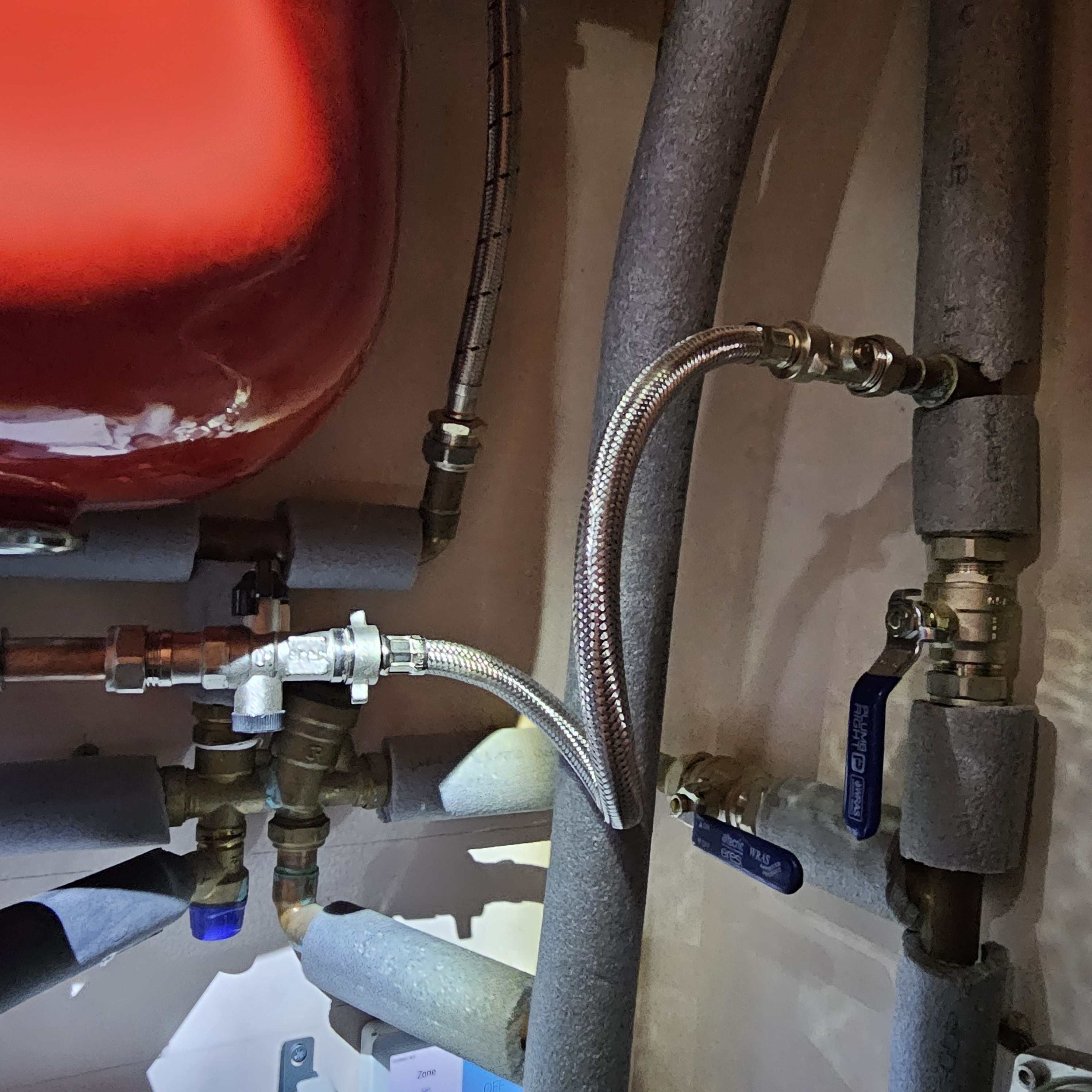

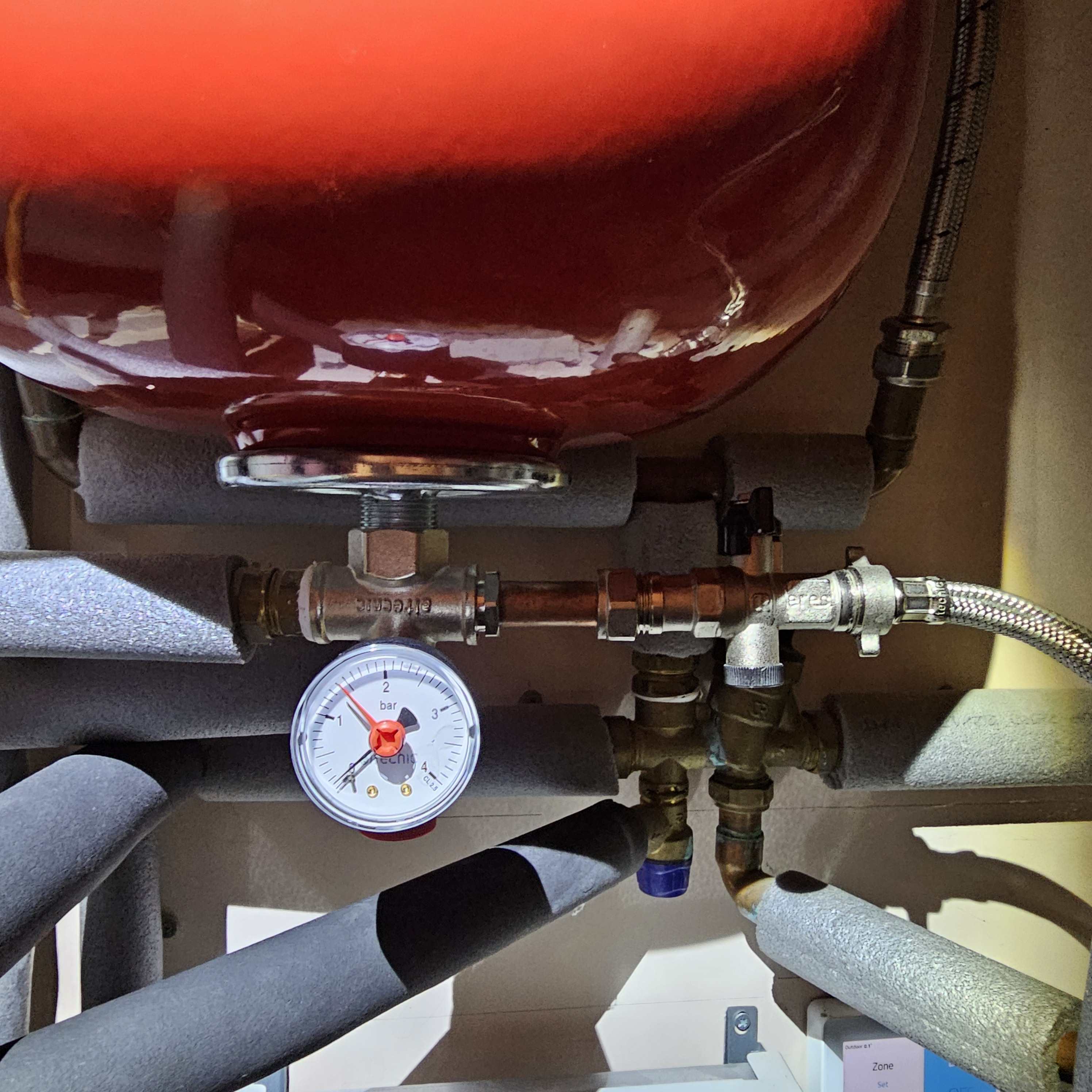

Non technical description....I noticed today that the black needle thing is pretty much on zero but the bar seems fine. I think the black one is to do with the heating. I know I need to look at adding pressure but any youtube vidros say I should have two valves and I only have one (the black one to the right). If I turn this nothing happens. Is there something else I need to turn as well? There are two blue lever things to the right.20260108_230433.thumb.jpg.b090dfcec01f929cc9a06fe6c15c14ce.jpg

The heating has tripped in and it has creeped up a bit to about 0.5 bar but it seems if the heating goes off it drops again.
Edit. Spoke to soon, heating still on and it fluctuating between 0.5 and lower. If I manually turn on hot water programme (it is normally on a timer) black needle drops rapidly to zero.

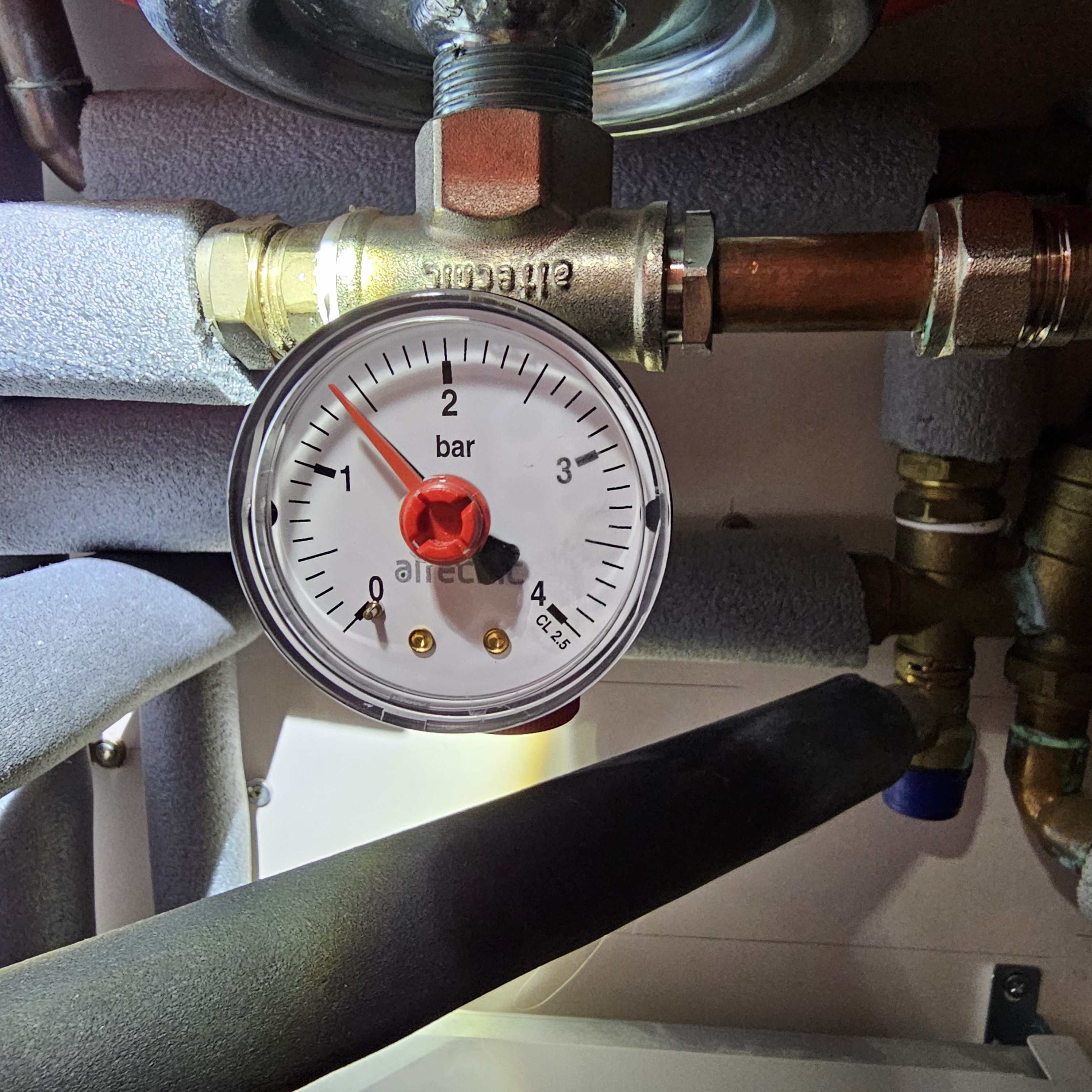

I’m no expert. The red pointer is just a marker for where the black pointer should be. Clearly the pressure has dropped.

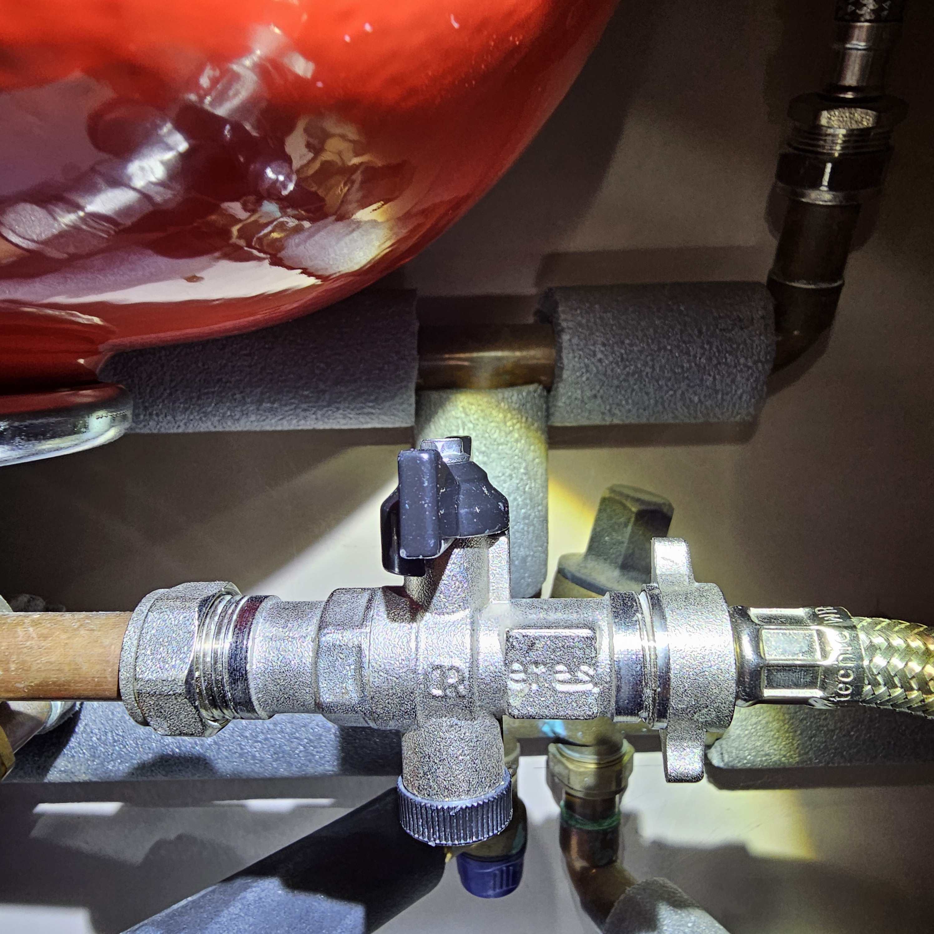

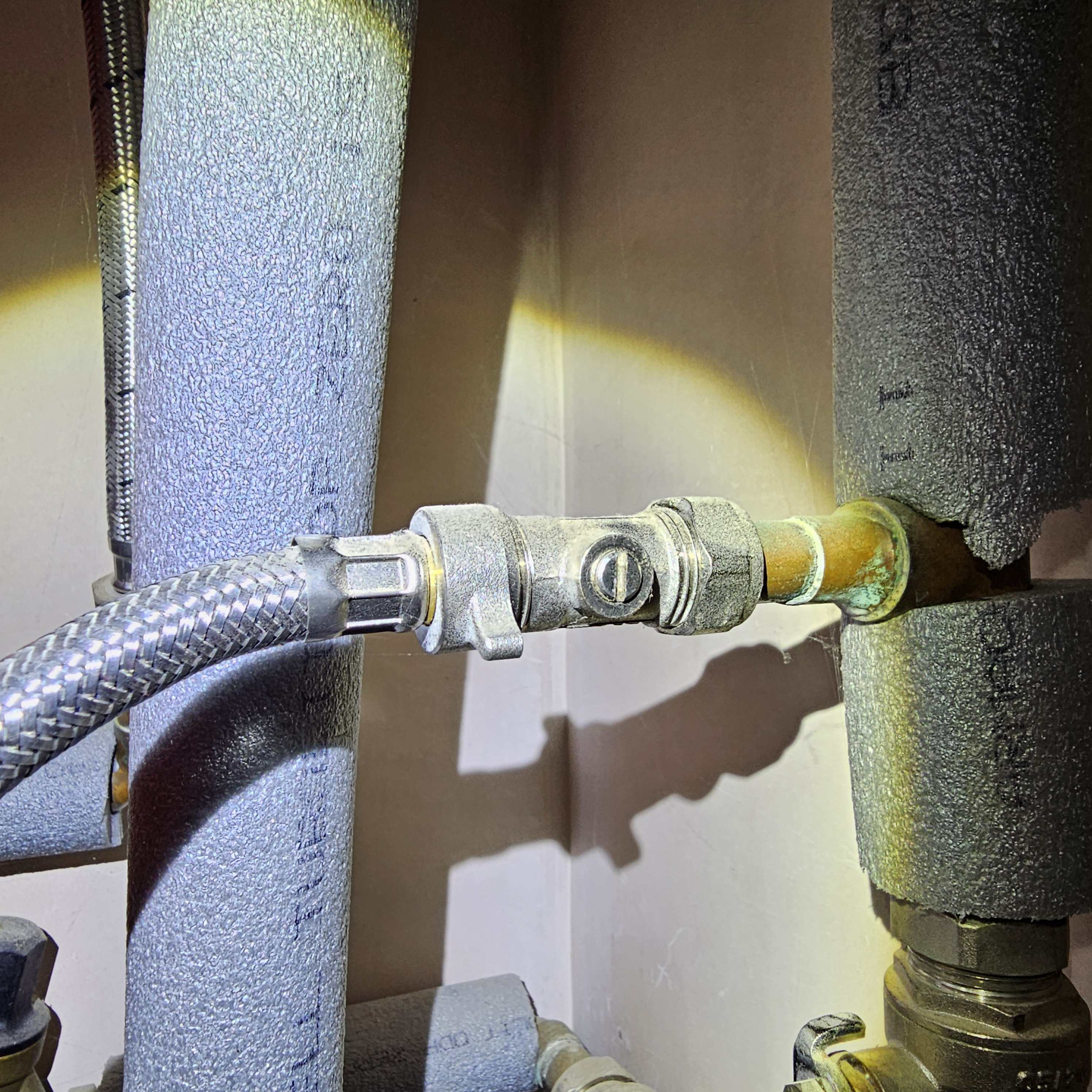

I can’t see clearly in the video but on the right hand side of the flexi hose, that looks like an isolation valve. Is that open? Slot in line with the valve not across the valve?
With that open then slowly opening the black one you mentioned should allow water through and the pressure should rise.
Stop when the black pointer is in line with the red pointer.
Somebody smarter will be along to give better information I would hope.
This you mean..
One side of flexi hose this..
And the other side this...

So, to re pressurise the big red expansion vessel you need to open the silver isolatation valve (second photo) with a screwdriver (90 degree turn either way, doesn’t matter, it’s open when the slot is in line with flexi hose).
Then turn the black handle lever thingy (first photo) to slowly open it and you should see the pressure increase indicated by the black pointer creeping towards the red pointer (third photo).
It’s probably best done with the heating off, but I don’t know.
The fact the pressure has gone from the expansion vessel is indicative of a leak somewhere.

When the pressure is near zero, like in the first picture, get a tyre pressure gauge and read the pressure in the red cylinder. There should be a valve exactly like a car tyre one on the top. It should be something like 0.7bar, 1 bar or similar.
If it has pressure eg 0. 7bar but the gauge on the water reads near zero, it is possible you have a leak somewhere.
If it reads near zero your expansion vessel has lost has pressure (you may still ha e a leak but it's a bit less likely)
If the latter you can pump it up with a.tyre or bicycle pump.
Then top it up with the flexi hose.
You need to turn the. Slotted screwdriver thing so it's. Inline withe the pipe, then turn the black handle at the other end.  There should be a whooshing sound and the pressure creep up. Once at desired. Level (1 - 1.5bar) turn both valves off and disconnect the pipe (get a saucepan under as some water will come out.
Beware just topping up the pressure continuously. The water is going somewhere!

The pipe shouldn’t be disconnected, in real life nobody removes these ‘temporary links’, as there’s no blank cap for the cold supply to be made safe with.
Most fitters pull these blank caps off their rubber noose and throw them away, to save explaining what they’re for.

If the system pressure target is 1.5bar when cold, then your pressure vessel should be at a little bit below (say 1.4bar) when empty. This allows a little water into the vessel when at system pressure and the maximum volume change when hot.
So if your water pressure gauge shows 0.2bar your vessel should show 1.4bar.  Of it shows lower then the pressure is wrong.
You can top it up but the fact the air has been lost points to a failure in either the valve or the internal membrane.
