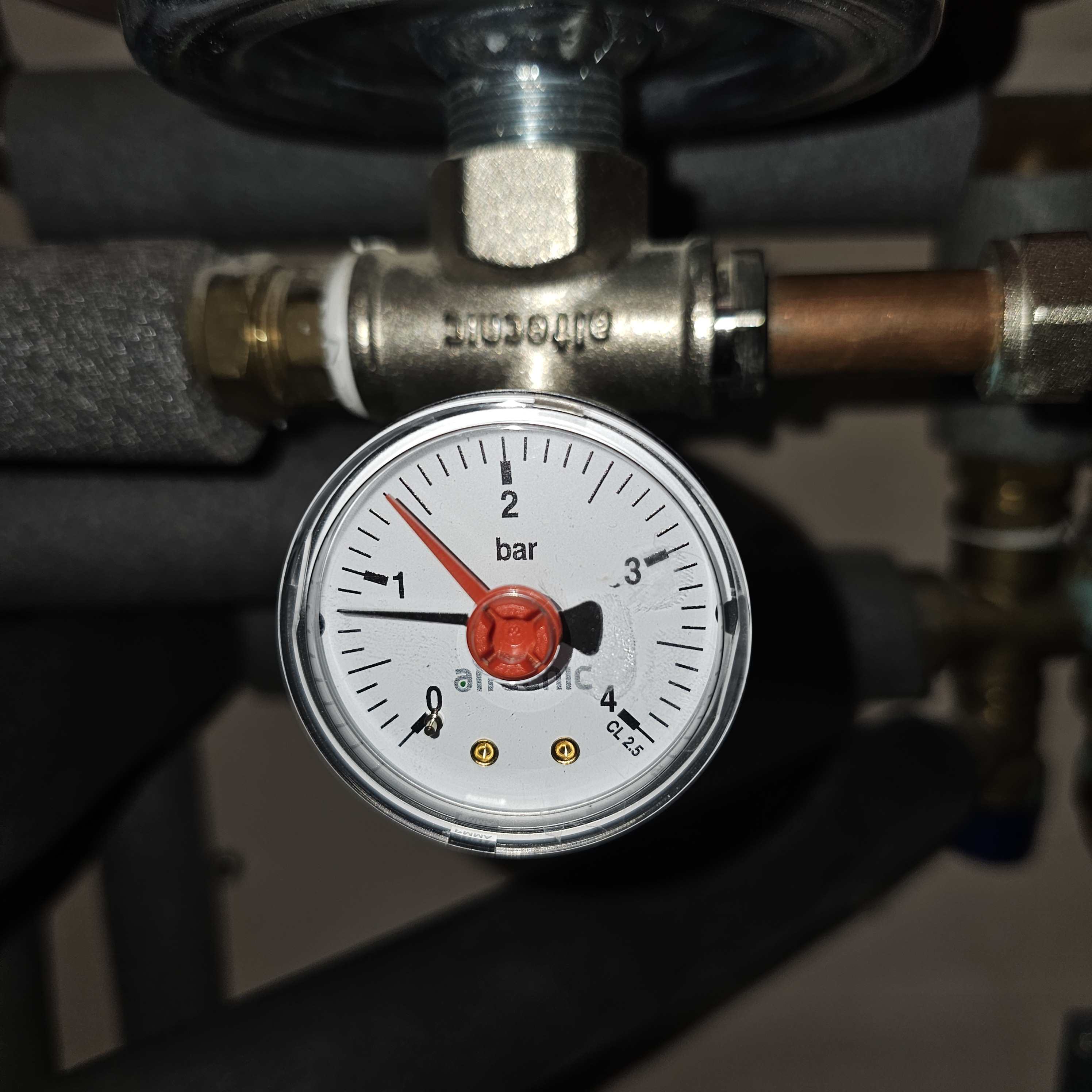

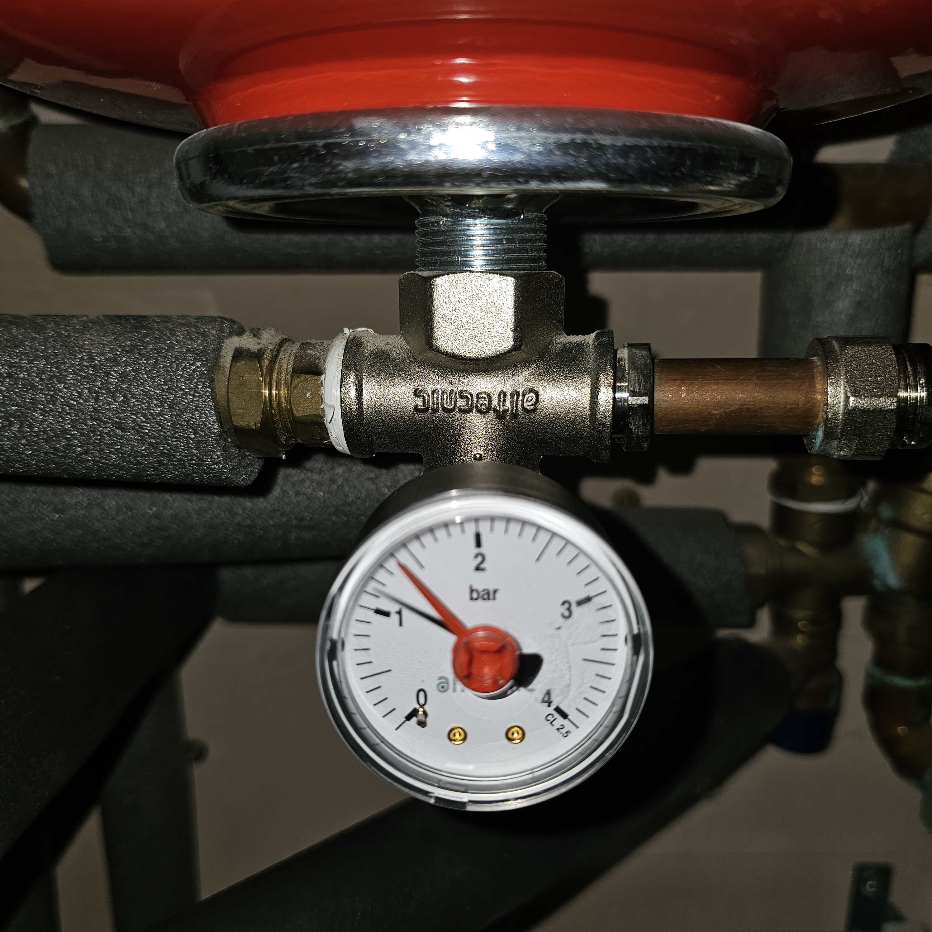

Hot water had not been on since yesterday as I turned it off on the ASHP as I wanted to manually switch it on today and watch to see if there were any leaks from that tundish.
Haven't turned it on yet and just noticed the black pressure needle has dropped - photo taken 1.10pm(ASHP heating came on at 1pm). Is this normal?
Edit to say, it creeped back up again (photo taken below 35 mins later at 1.45 so maybe just dropped as heating came on/is on now..)

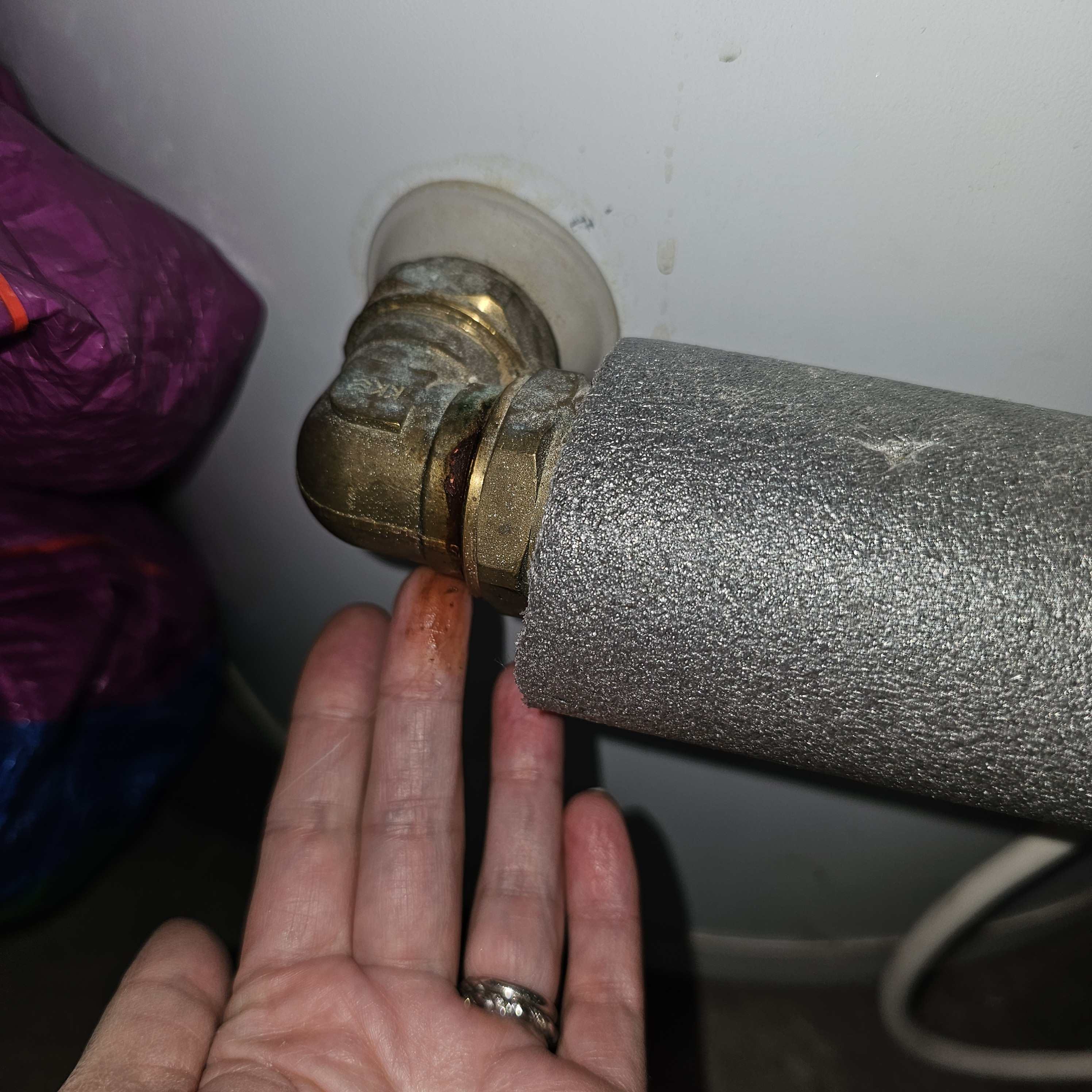

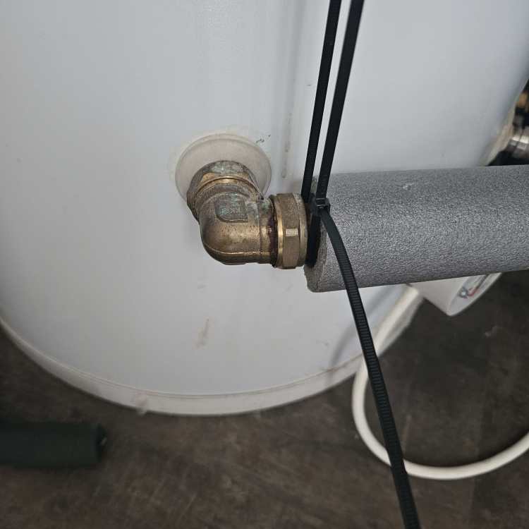

22 hours ago, canalsiderenovation said:
One thing I did notice when having a good nosy around is on the bottom of the Gledhill tank. It is not dripping or but there was a copper wet mark on the floor and when I touched the pipe I got a rusty damp finger.
Don't think I've seen anyone else mention this yet so I will. A small leak like this is all thats needed to drop the pressure in the system. I'm guessing this pipe is part of the DHW heating loop though wider photos would confirm.
Unless I'm mistaken, until that dampness is solved I'm not sure it's worth looking for other issues.

Spoke to soon! Definately leaking. Turned water off on ASHP.. presume we shoulsld try and avoid using the ASHP to heat our hot water and probably try and get this sorted asap. Maybe I was too quick to doubt the first company then.

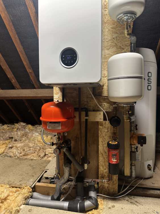

I'm guessing the drips are warm? It definitely appears to be an expansion vessel issue, but it doesn't mean that the expansion vessels need to be replaced. They may just need recharging. From what we've seen we can't be sure that the service involved a proper check of the expansion vessels. Personally, I find it slightly surprising that both have failed a the same time after just 5 years or so.
It's actually easier to check the expansion vessels on an unvented cylinder than heating because you just need to isolated the incoming mains (there's usually an isolation valve just before the multi-bloc and then you open a hot tap to take out the pressure, leave the hot tap open while you check and adjust the expansion vessel pressure).
Okay progress. We know the hot tank is over pressurising when the water is heated which does indeed usually indicate the expansion vessels(s) have failed.  I am a little surprised as there are two of them so would expect them not to be particularly stressed.
This is not something to ignore.  You have to trust your gut feeling and get the person that quoted to replace them or a different plumber that comes trusted or recommended by a friend.  This does not need to be a heat pump plumber as these expansion vessels are the same regardless of whether it is a heat pump, gas or oil boiler, or just plain direct immersion heated.
Switch off the solar diverter for now and only heat the hot water occasionally as needed using the heat pump to heat it.
A lesson here is be there when the next plumber comes so you can engage with them and when they find a problem like this they can probably show you what they are testing that made them conclude they need replacing.  One would hope they had de pressurised and concluded the air bladders are burst and they would be able to show you.
EDIT: to add to the above post, if you have a car pressure gauge and a bicycle pump we could talk you though checking the pressure to be absolutely certain if they have failed or just not enough pressure in them.
