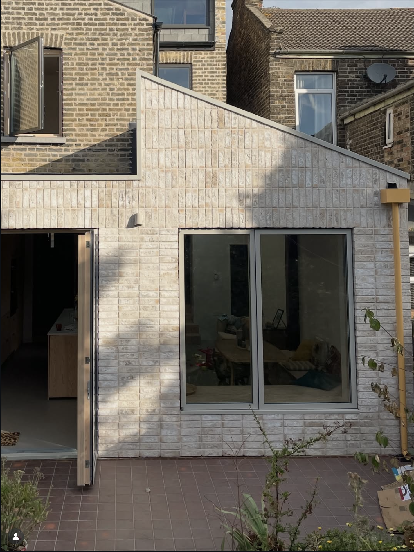

flanagaj Posted Monday at 22:21 Posted Monday at 22:21 We have had our material palette signed off and I'm curious as to how you'd achieve the mortar look below. I'm conscious that it's not going to be the cheapest. Are we talking simply white cement and a pale sand, or is there a lime constituent in there too?

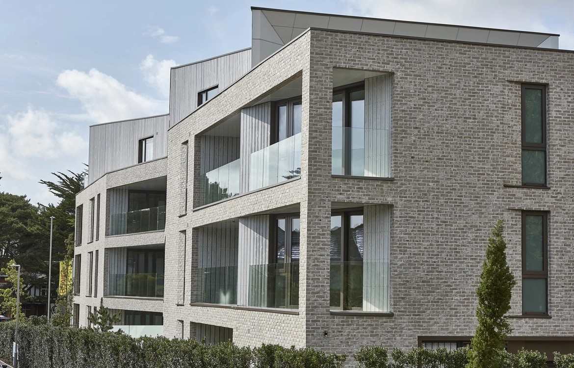

Bonner Posted Tuesday at 07:05 Posted Tuesday at 07:05 Very difficult to say without making your own samples, not just the mortar but panels with the chosen bricks. I was going for lime but switched to white cement which achieved a very similar result, albeit a completely different colour scheme to what you are trying to achieve. I used the brick manufacturers tool as a starting point, was surprised how different the bricks look even with slight changes in joint colour https://nsxpwebapp.nelissen.be/publicconfigurator/?_gl=1*1fxpchc*_gcl_au*MzcxNDA4OTIwLjE3Njc2ODI0NDE.# 1
Big Jimbo Posted Tuesday at 07:10 Posted Tuesday at 07:10 My thoughts would bethat there may be some lime in there. I like the look if that is what you are going for. Best of luck with your build. 1
MortarThePoint Posted Tuesday at 07:40 Posted Tuesday at 07:40 Loads of colours available to add to white cement. White cement is more expensive (2x I think) but small difference Vs labour costs. If achieving the colour using an additive rather than sand, check how consistent it will be. The brickie's labourer may vary the dose and that could create banding. There is an expensive new college building I see in Cambridge and it's a dogs dinner due to this issue I think. You can influence the colour a lot with choice of sand and that should be more consistent as long as everyone understands. I'd be cautious of going the lime route. Fewer brickies have experience with it and it can be less tolerant (e.g. temperature). In the right hands it's great and looks brilliant though. 1
Gone West Posted Tuesday at 08:19 Posted Tuesday at 08:19 The local fine sand in this area is pale grey which when added to Snowcrete produces mortar of a similar colour to your picture. 1
Russell griffiths Posted Tuesday at 09:35 Posted Tuesday at 09:35 The mix is not important, getting your bricklaying team to mix it the same every time is the important thing. when you get the colour you want you need to discuss it with the bricky and get it in writing that they will use a gauge box to get it the same every time. any not up to standard gets taken down at their cost. you will need to buy sand in bulk and cement to get the same batch every time. DO NOT USE any form of mortar dye. 3

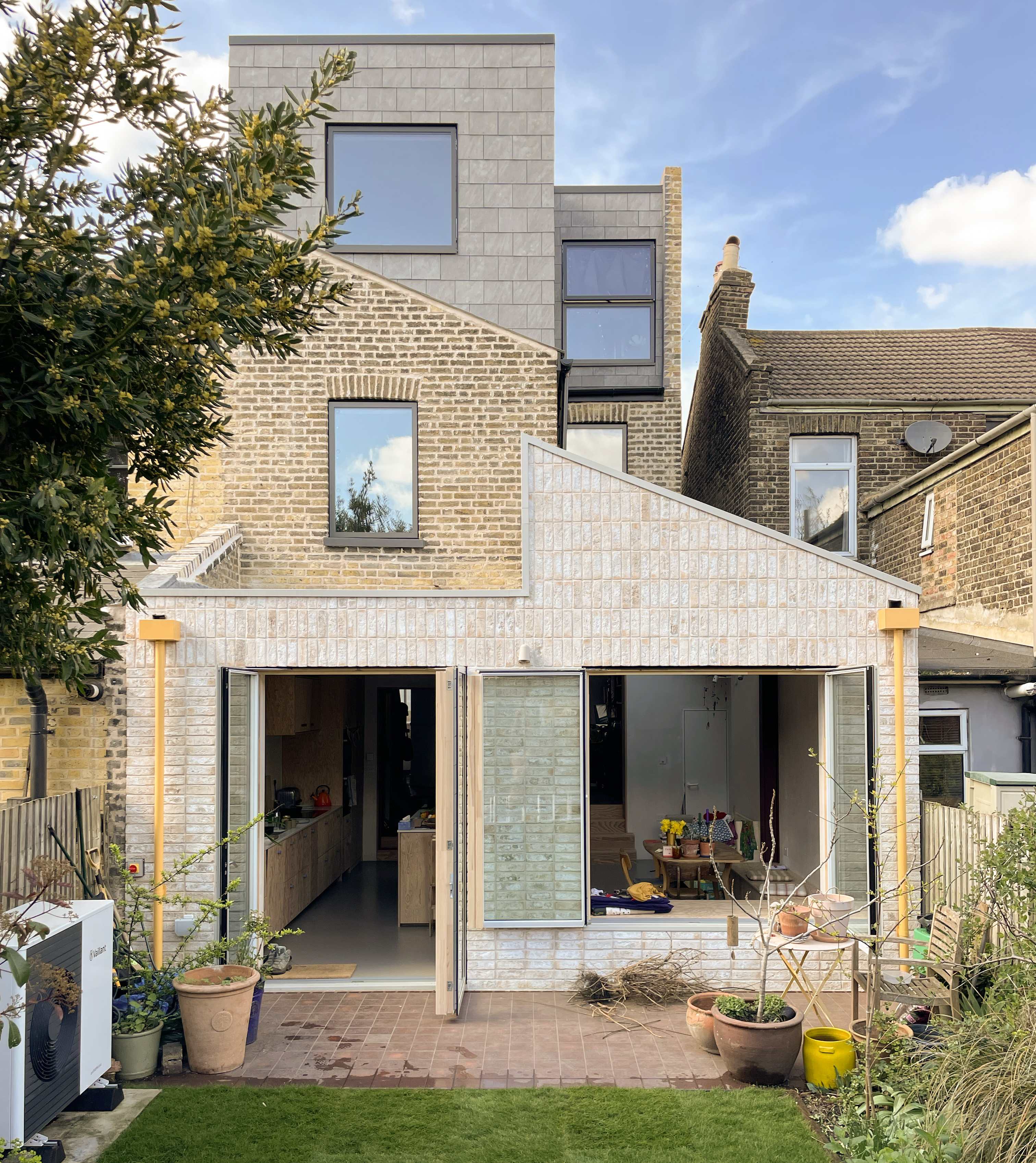

ectoplasmosis Posted Tuesday at 15:55 Posted Tuesday at 15:55 I used Lime Green Natural Lime Mortar for our extension below: https://www.lime-green.co.uk/products/lime-mortar/natural-lime-mortar Comes in bags, just add water. Loads of colours; I used 'Chalk'. 1
ectoplasmosis Posted Tuesday at 15:59 Posted Tuesday at 15:59 Another shot. Difficult to see, but it's a creamy off-white in real life.
Russell griffiths Posted Tuesday at 16:10 Posted Tuesday at 16:10 56 minutes ago, Oz07 said: Why's this? Very inconsistent results, it takes only a small mistake in measuring to alter the colour which might not be noticeable until properly dry, I’ve had some horrible results using dark browns which looked brilliant while wet but dried very inconsistent they also tend to not like being wetted after they have dried and tend to look patchy. 2
