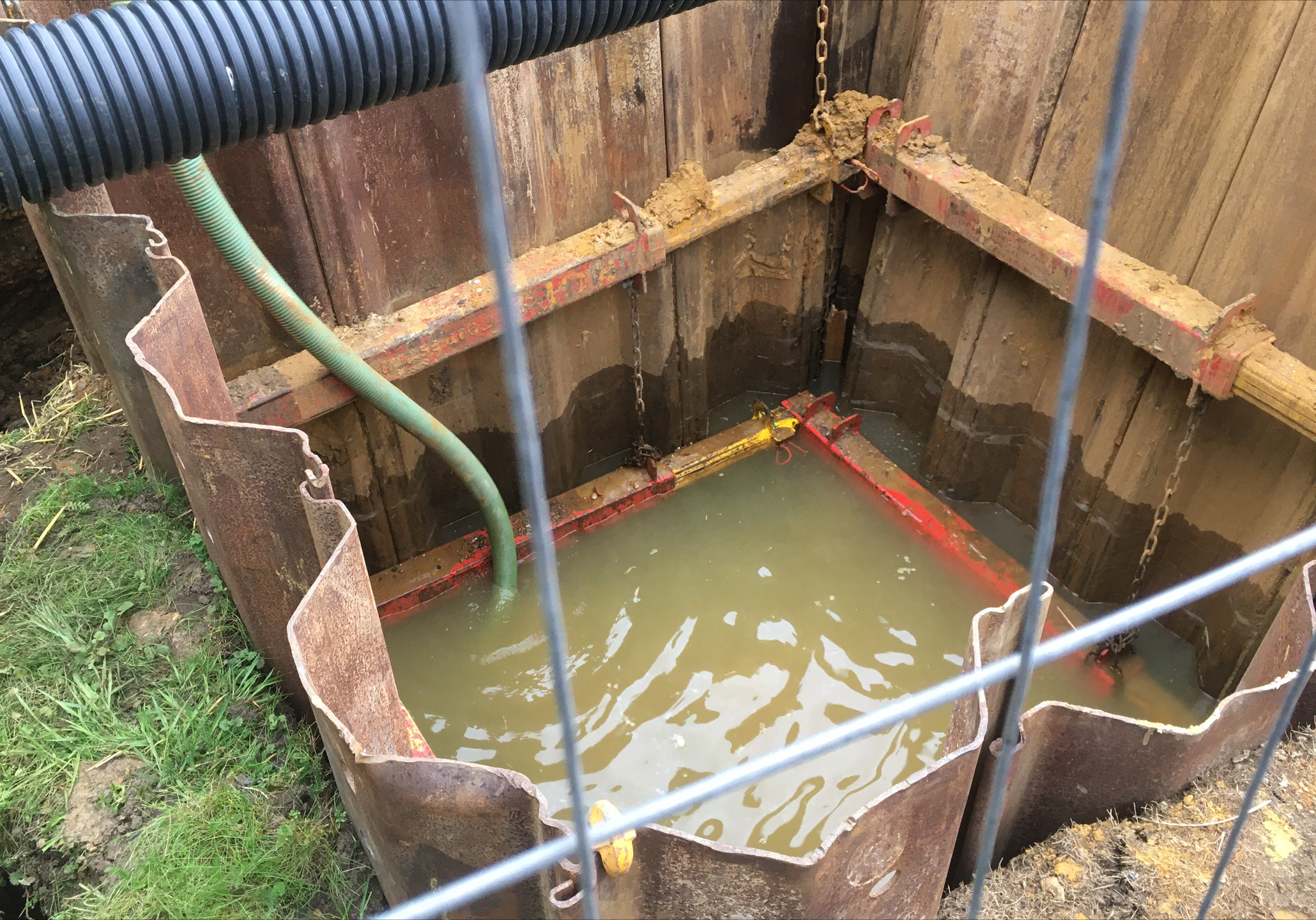

My ground workers first install attempt failed, when the hole collapsed.
They abandoned that hole and started in another location.
We needed expensive shuttering and bracing to support the install. Special attachment on the digger, rams the shutters into the ground.

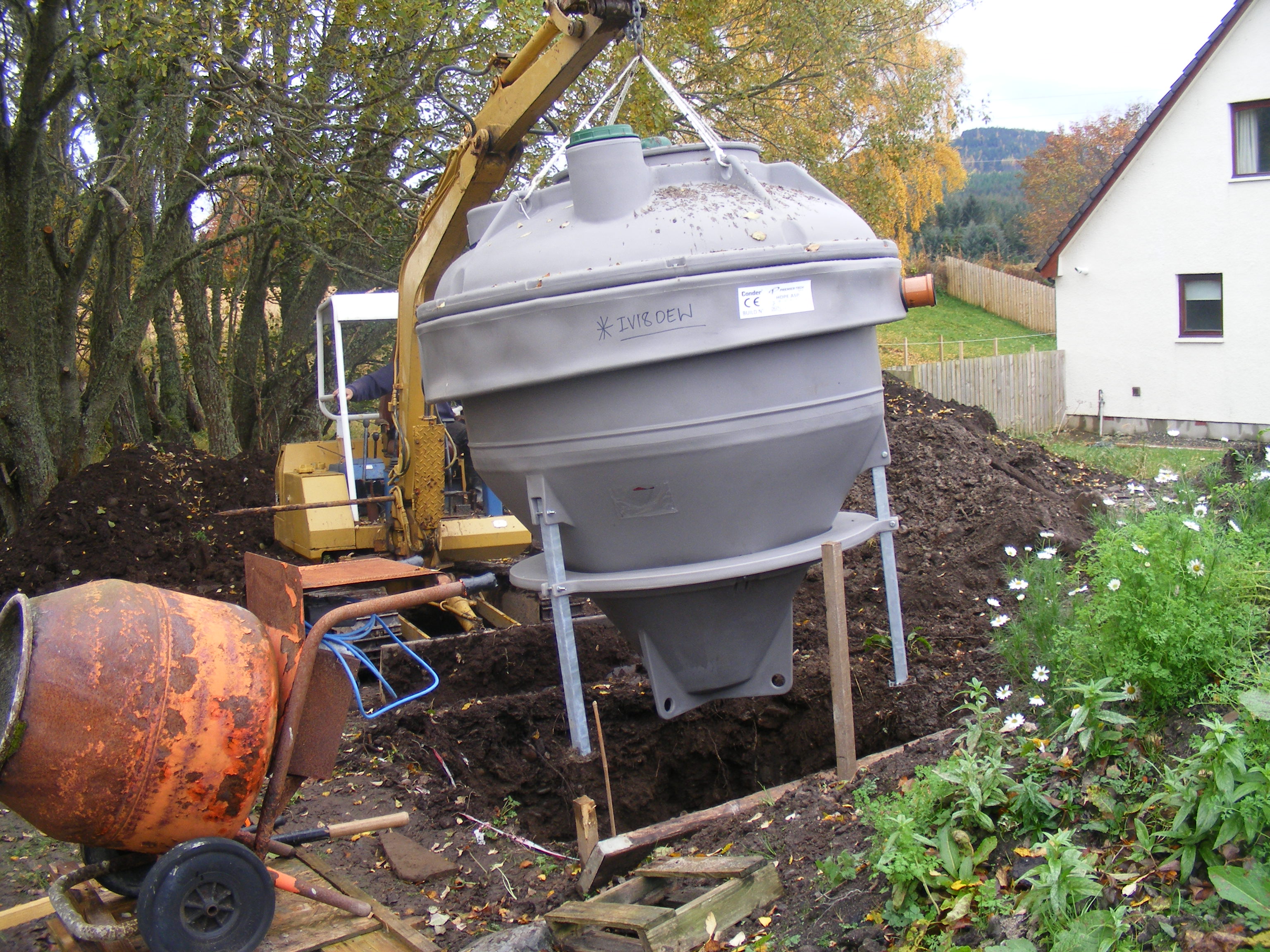

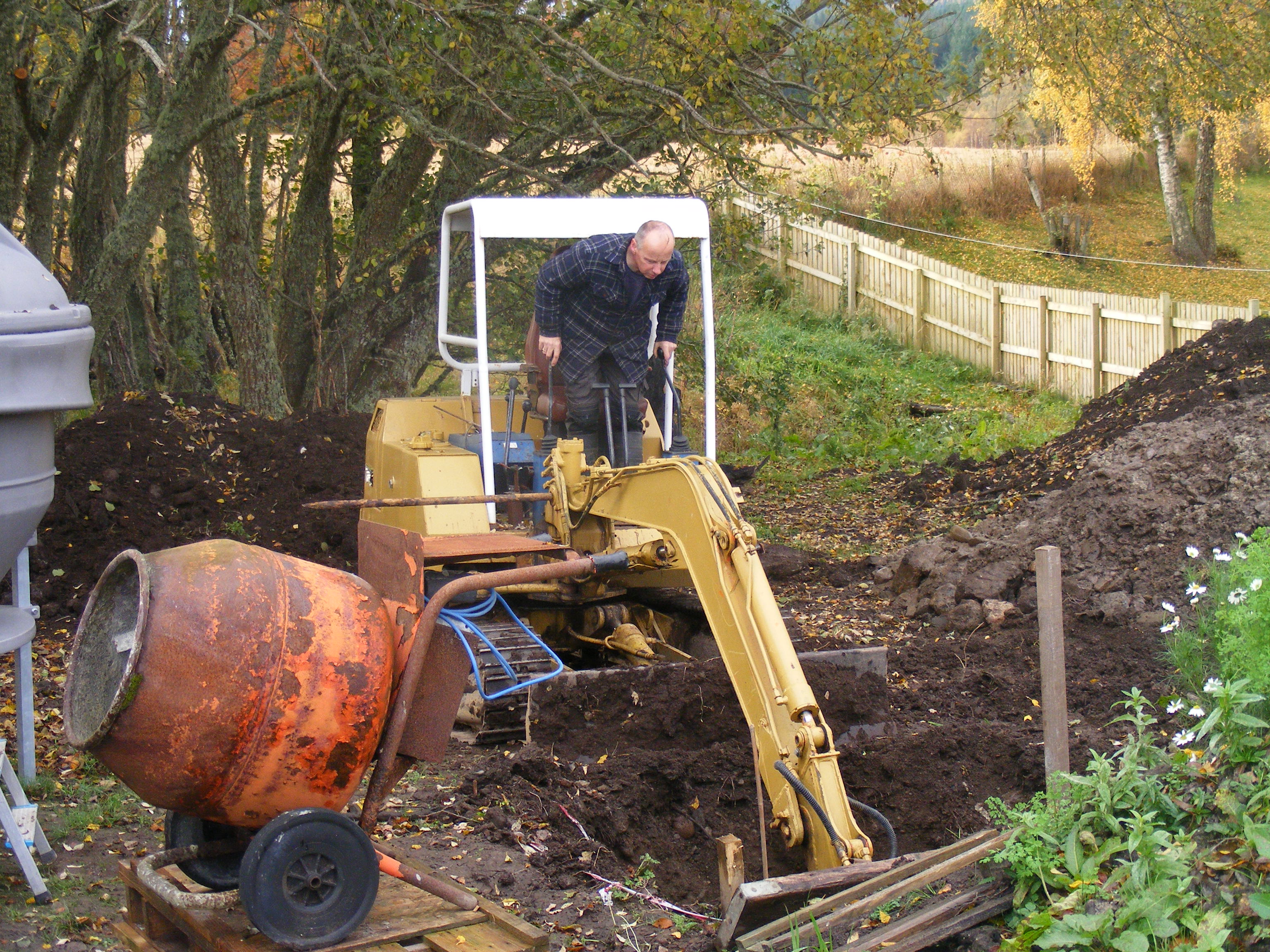

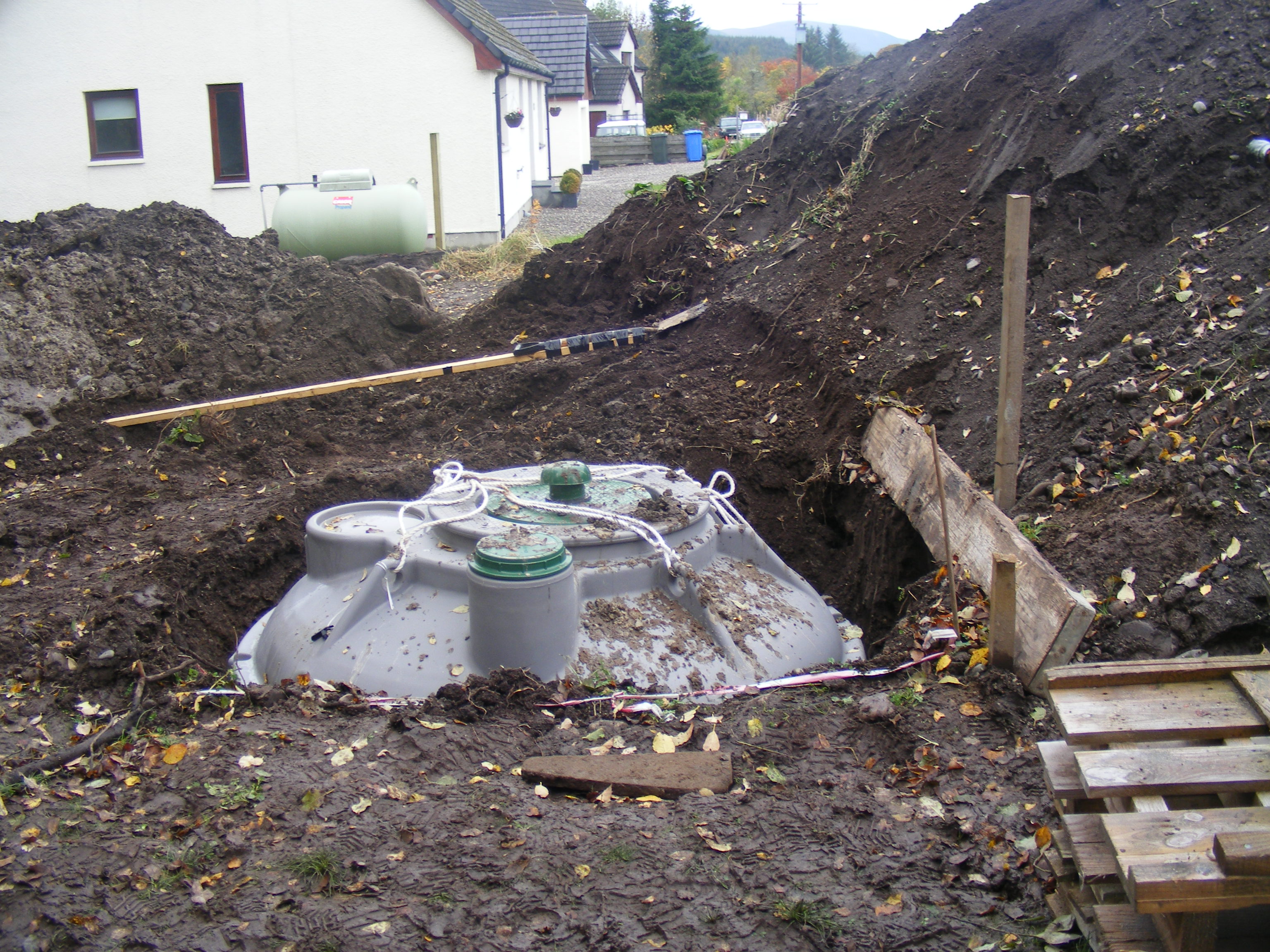

I did mine in 2 days myself.  One day digging the hole and putting the tank in, then the rest of day 1 mixing barrowing and pouring concrete.  Day 2 lots more mixing barrowing and pouring concrete.
I had my own digger and was reasonably competent driving it so no extra cost for that.  I had ordered a load of gravel and bags of cement and I had plenty of sand on site so I mixed my own concrete with my own mixer.
The trick was to dig the smallest hole the STP would fit into so there was not so much concrete to mix and pour
Disposal of spoil was not an issue.  This was a building site pre landscaping, so the contents of this excavation were spread around before the top soil was spread back on the site to finish it off.

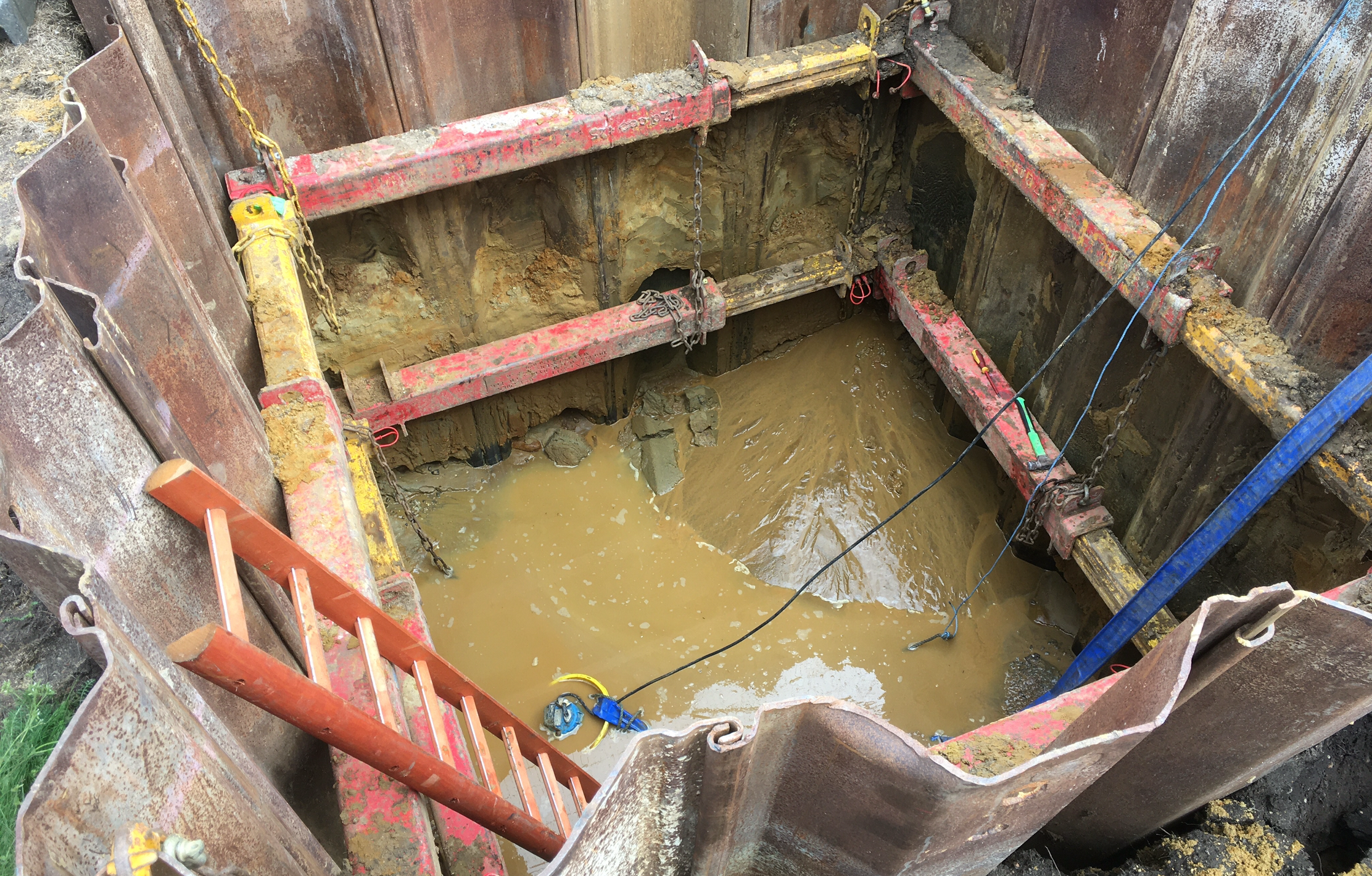

The main issue my ground workers had, was very high water table, and sandy/gravely soil. The site is a former gravel pit.

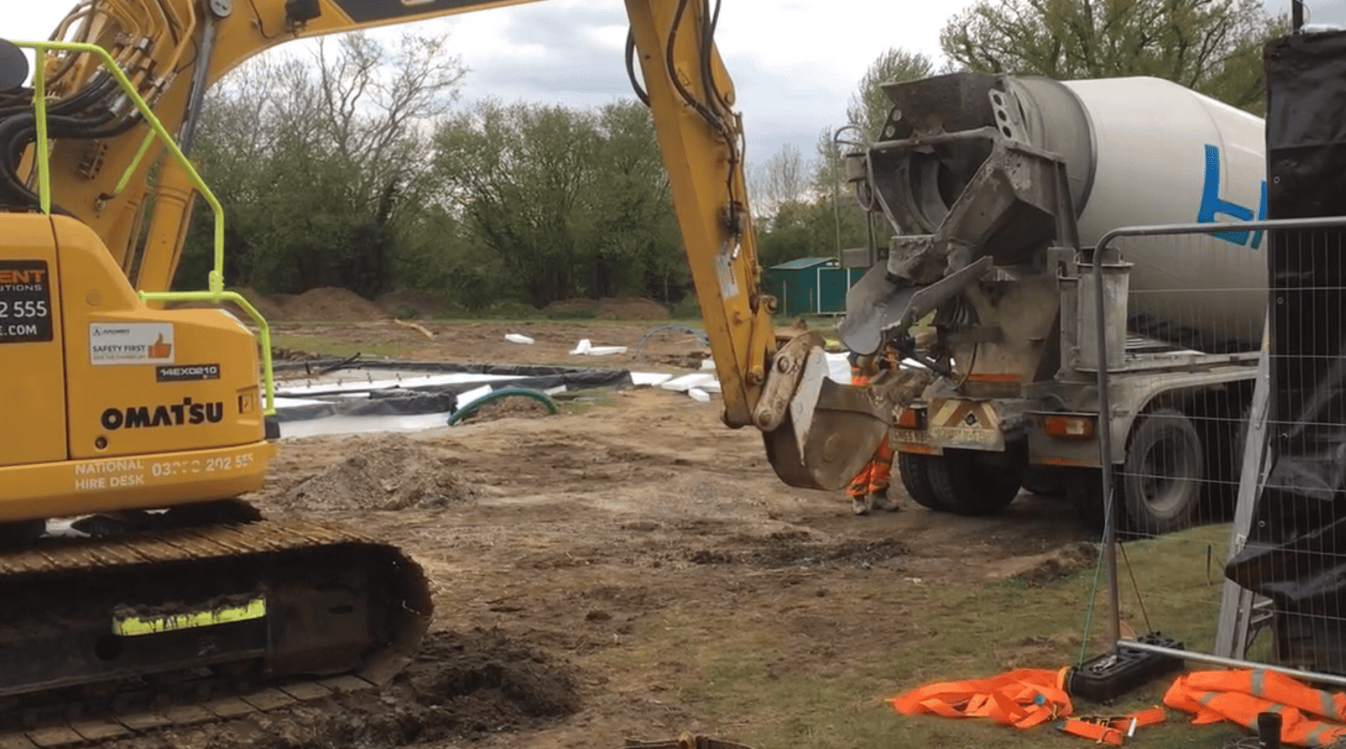

We have the same STP as @ProDave. They were worried about the unit popping out of the ground.
They took the concrete from the back of the mixer into the digger bucket.

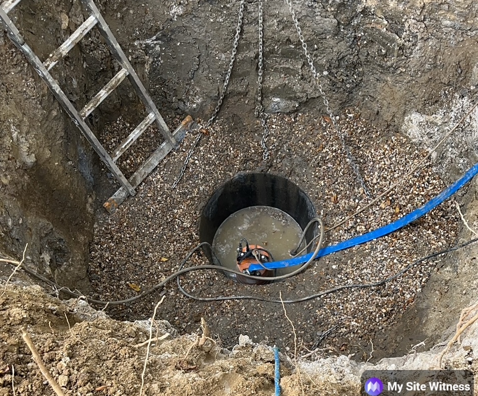

I had to excavate a 3m * 3m * 2.6m hole for our tank.  Digging the hole took a day with a 2.7T Kubota and then another day putting the tank in.  Filling the tank with water before back filling each section took a long time.  A bowser would have helped.
I would also hire the excavator for a week as it's nearly the same price.  Don't forget you'll need a dumper and have a lot of muck away too.

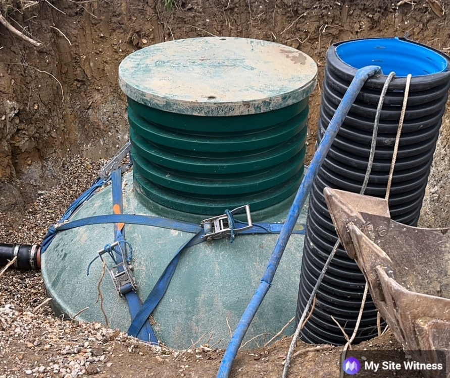

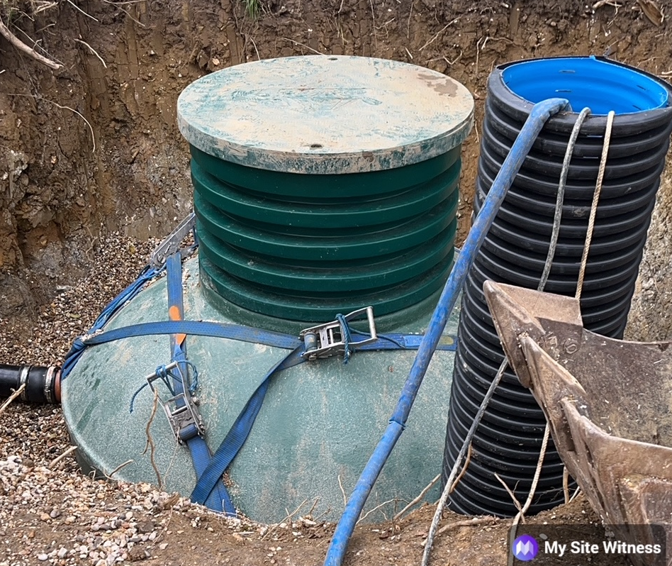

We installed a conical shaped STP, which just sat on the top of a thick concrete paving slab. The sloping sided hole was dug out by the local farmer who placed the slab at the bottom of the hole. The STP was chained down to four angle irons which I banged into the side of the hole. It was easy to level the STP because it just sat on it's pointed base. The hole was back filled with type 1. The STP had a 450mm turret riser which was concreted in. The farmer charged £160 but this was fifteen years ago.

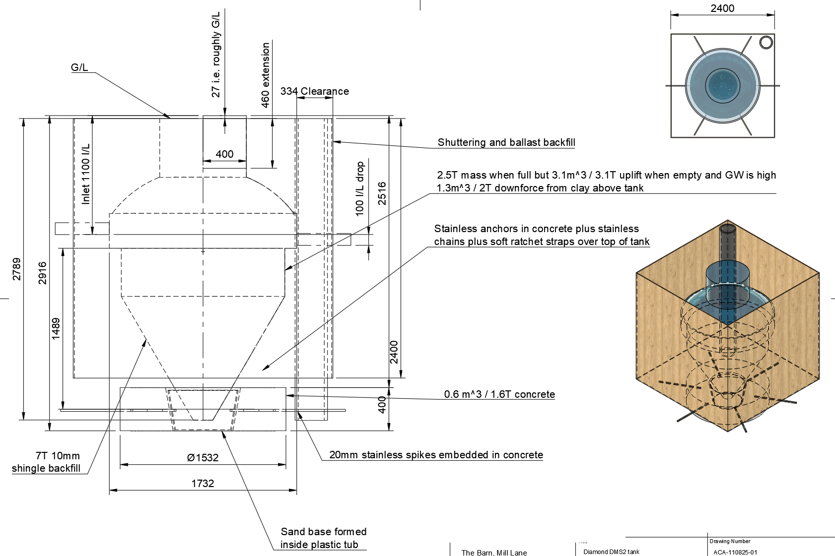

We were working on this today. A properly anal approach, but I wanted to be able to get it out easily if there was a future problem. Very doable DIY - although it would be easier .... the next time 😁. Main issues were falls (courtesy of some earlier careless groundworkers) and, believe it or not, making the straps work sensibly. My digger skills are improving, although the original dig out was done by an experienced guy in one day. There was properly hard dried out clay that far down. The dry mix was done by hand on a piece of ply - we didn't even bother to get the cement mixer out.  The perforated twinwall in the last picture is for checking on GW level.
image.thumb.png.773067215169d87959cbd2a83a93a80e.pngimage.thumb.png.5da8e74bfd308426f76e7ba5e74af6c6.pngimage.thumb.png.af34357905b7f80991196c55612da202.png

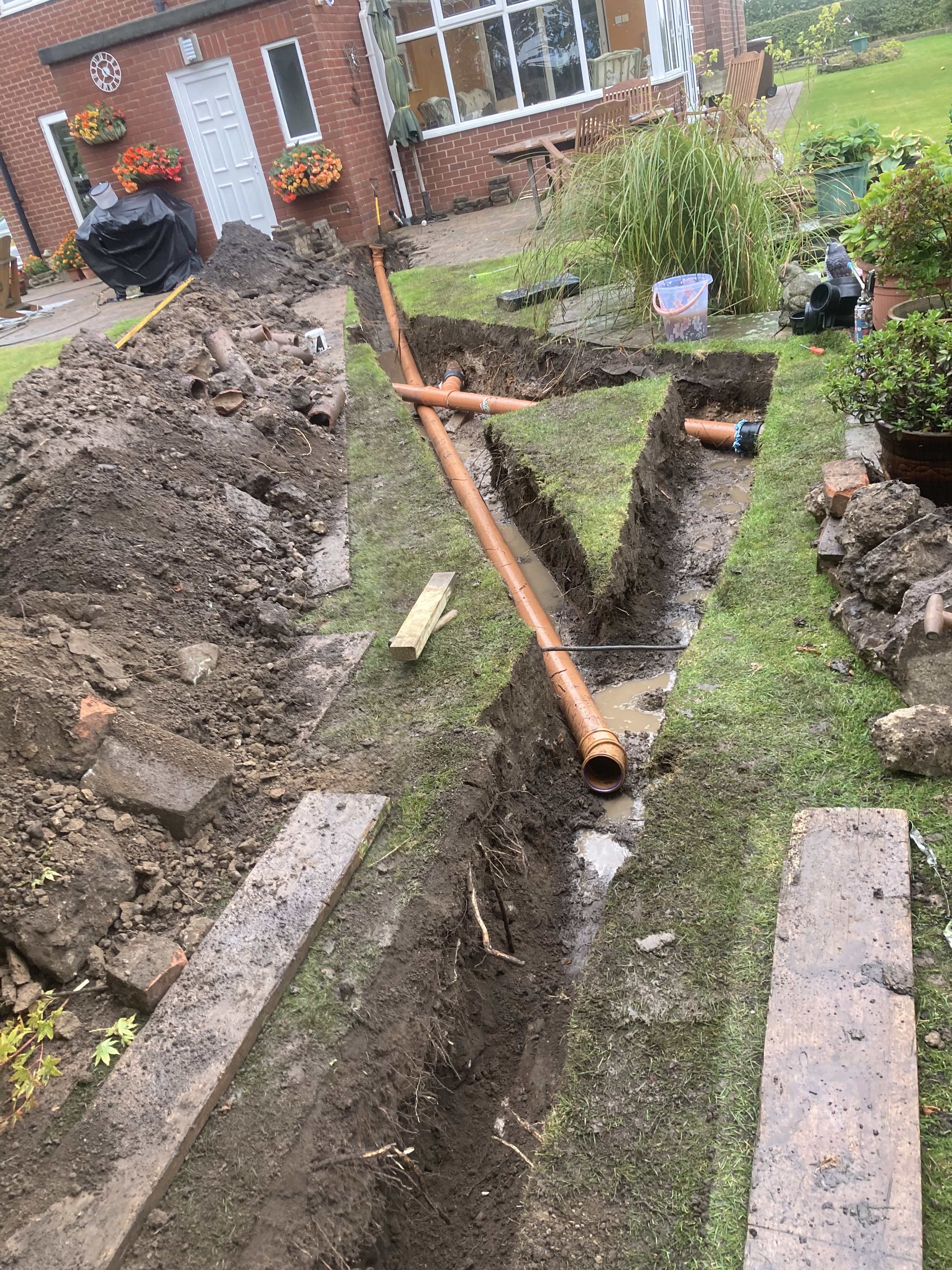

To be fair we had a full day sorting the drainage in the neighbors garden
Bolder clay so the 3 tone digger I borrowed wasn’t man enough to dig right down So my maté reluctantly leant me his almost new 5 tonner
