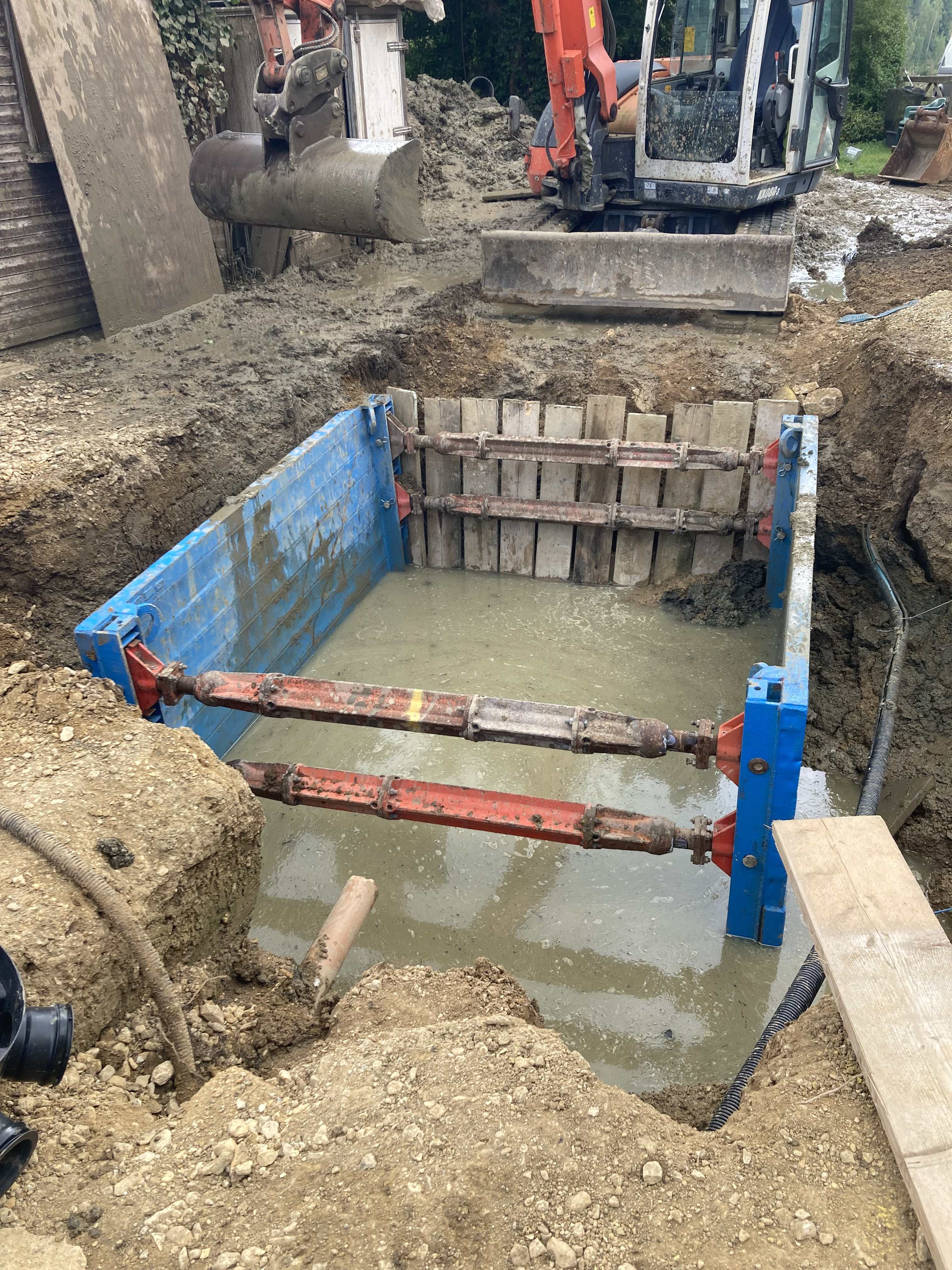

October 15, 20251 yr like the other photo in this post it’s all down to how high your water table is. having to hire box shuttering to install your tank can seriously damage your wallet.

October 15, 20251 yr Some fundamentals. Don't dig the hole bigger than necessary. You have to stop an empty tank from floating. So a)if the water table is low then no risk. b). There are several ways to hold it down and that isn't with total concrete backfill. It depends on the tank but the Graf pic above shows holes through the base for bars or ties. Options are 1. to backfill in stages with concrete against the tank and earth away from it. 2. Concrete slab as a base and tie the tank tied to it...then all fill is acting on the slab and it won't move. ..in which case gravel surround will work too. You mustn't have anything against the tank which might puncture it eg fill with bricks in it. But some tanks may have other requirements. But some tanks instructions may be overcautious. If the hole is filling with water during vjnsyruction it's going to be a good test. Dig a sump lower than base level and pump from there. I wonder.... could those auger piles sold for decking and fencing bases be used as anchors. Or platypus anchors?

October 16, 20251 yr 14 hours ago, saveasteading said: backfill in stages This is the way if mixing on site. Position a board (600 high or so) at about 300mm off the tank, and pour your concrete or gravel in there. Backfill the rest, pull out board, repeat. A small digger to fill the hole is preferable to barrowing. Saves money on concrete or gravel, and in muckaway. This process may work with ready-mix too , IF you have the labour to speed it along.

October 17, 20251 yr On 15/10/2025 at 10:41, Russell griffiths said: We all seam to answer with our opinions, but it’s never really answering the original question Dave said he did his in a couple of days, but his hole is tiny, the hole you are suggesting is huge and will have approx 30 cubic m of clay coming out of it. dave said he mixed his concrete himself, again no problem but his hole is again tiny, yours is huge, your not hand mixing 10 cubic meters. you can use a wet mix if your hole is dry, if you have water in the hole you need a dry mix. I think this job is very different depending on ground conditions and tank used. @flanagaj has just done his maybe he could put up some more up to date and in context pictures. russel is correct --ground conditions control it all me I have free draining granite rubble etc iwth 45 degree babnk about 10metres away follwed by a 8o m drop into the quarry about 30 m,.s away so dig was hard work for digger but no need to do anything but backfill hole open for 3 days and it was raining and all water just drained away

October 17, 20251 yr On the point about filling, you should fill the tank with water as you backfill the hole, keeping the water level in the tank level with the backfill. Our previous house we had bad advice from the installer and that tank is just backfilled with gravel. It is okay if you ONLY have it pumped out in the summer preferably after a long dry spell when the water table is low. It could end very badly if pumped out in the middle of winter. we made sure the buyers of the house were aware of that.
October 17, 20251 yr 4 hours ago, ProDave said: tank is just backfilled with gravel That's OK if there is a slab under it, which takes the weight of thd gravel, and if the tank is tied down.
October 17, 20251 yr Completely encased our tank in concrete just to be sure it stopped there, half filled with water then half outside with concrete, then filled rest and poured concrete, better not move, tank stands on a concrete base.
