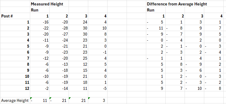

Alan Ambrose Posted August 27, 2025 Posted August 27, 2025 I'm trying to measure height on various bits of my slab accurately to figure out whether I need to adjust some structural post heights which assume a flat slab. I went round the 8 points needed a couple of times and measured the height with the receiver (new Spectra HL760). I tried four circuits with the rotating laser (a 6-month old Imex) in various positions on the slab. I thought I got the rod accurately vertical at each point. I went round 4 times and the results were a bit nonsense: That is, the height of a post base seems sometimes 20mm different when measured again. The slab is ~12mx6m i.e. not huge. I thought I would check the accuracy of the set-up today by leaving the receiver and laser in the same positions and just rotated the laser on the tripod carefully through 45 degree intervals. I got rained off before finishing, but I was getting readings that varied only a couple of mm. I did notice that the wind made a difference and the tripod (the Imex one) is a bit lightweight. Any ideas or tips on how to ensure laser accuracy?

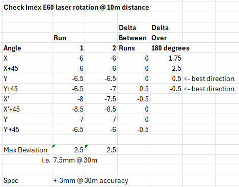

markc Posted August 27, 2025 Posted August 27, 2025 (edited) Quick check of auto level accuracy. set in middle of room, mark laser position on opposite walls. Turn laser around 180 degrees and points (or difference in points) should be the same. laser receivers are not that accurate, when checking floors it’s easier to set laser low and use a rule or tape to check height Edited August 27, 2025 by markc
MikeSharp01 Posted August 27, 2025 Posted August 27, 2025 Take the laser off the tripod and put it on the slab, use some thin packers to get it level - that stops any wavering from the tripod and minimises the rod verticality issue. You can then use a very short rod on the receiver or maybe the laser will scan roughly the middle when its standing on the ground.

saveasteading Posted August 27, 2025 Posted August 27, 2025 Instrument check. It is basically a spirit level with a torch on the end. if the laser is not projecting level then it describes a circle below or above the correct line. The error increases with distance. To check it, set it up and use it to measure the height difference between 2 points at equal distance from the machine, a distance of say 20m. then move. Move the machine close to one of those points and still distant from the other. Measure the height difference between those same points again. The close one has very little distance over which to project its error. The far one has the same potential error as before, If the machine is accurate then the number will be much the same. if it is out of adjustment then the number will be rather different.
Alan Ambrose Posted August 27, 2025 Author Posted August 27, 2025 (edited) OK I repeated my rotating the laser on the tripod thing again with the laser and receiver fixed at the same points: So, the laser seems fairly consistent and close to spec. I don't think the E60 has any adjustment possible. One thing I learnt is that '3mm @ 30m' really means '+-3mm (i.e. 6mm total) at 30m'. Maybe this argues for figuring out the most consistent laser direction and then positioning the laser to keep most of the measurements in that arc. Edited August 27, 2025 by Alan Ambrose
