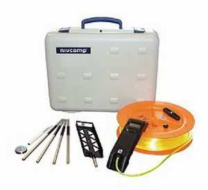

Re: Ziplevel
Says it has gas and liquid and a reference cell. Reads in cm and I wonder if that gives a clue to accuracy. Claims 0.25mm / 0.2% reading, which I guess means 2mm per metre height difference. I wonder if that's +-2mm? See below.
There's a competitor called the Nivcomp, claims +-2mm.
ZIPLEVEL® is a high precision pressurized hydrostatic altimeter. It works much like an aircraft altimeter that measures the weight of the air above it except that ZIPLEVEL does not use the atmosphere to measure elevation. Instead, ZIPLEVEL is a pressurized system that measures the weight of a proprietary liquid sealed within its Cord relative to a Reference Cell in the hub of its reel. This makes ZIPLEVEL 10,000 times as precise as an aircraft altimeter and immune from both barometric pressure and altitude changes. It's internal pressure prevents bubbles from desorbing from its liquid when under vacuum when the Module is above the Base Unit and is one of our powerful patented features.
14 minutes ago, Alan Ambrose said:
ZIPLEVEL
Thats exactly what i have. Mine iimage.jpeg.cf04a1b4d8051b8c06abeec21792fdb3.jpegs about 15 years old.
It works OK for you? What kind of accuracy do you feel it has in real use?
58 minutes ago, Alan Ambrose said:
in real use?
Used rigorously i'm happy it is +/-  2mm, maybe much better than that.
That's a hunch, and I haven't checked it against known levels.
Where I've had issues was in doing levels over a period of time in hot weather.  The tube/gas would be heating up I suppose.
I learnt to reset and start again.
But doing, say, 20 points around a perimeter wall or over a slab Im very happy with it. Especially that distance is inconsequential.
