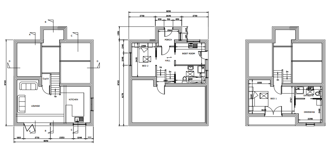

My thoughts, all along, have been to have wet underfloor heating throughout.
Reading another thread, can't remember whose, has made me want to think about it a bit more.
I will be living there alone and don't intend to move until I have to be carried out. (Hopefully in a box as the thought of .... no I'll not go there)
House will be well insulated to modern standards BUT not passive by any means (didn't find this forum early enough)
Options I  am currently considering
Wet underfloor heating and hot water coming from a combi
Wet underfloor on the ground floor, electric elsewhere rarely used except in dressing room (I like a cold bedroom and other rooms won't be used that often)
All electric including immersion heater for showers
All electric with electric showers and instant hot water features to sinks
Experiences, pros, cons or alternatives to consider please.
Added floor plans for info with downstairs loo added and bathroom to become just a mini en suite off second bedroom.  (Second bedroom and ensuite will get 3 to 6 days use a year)

Forget electric showers unless you like showering under a dribble.
If mains gas is available then it's a no brainer. Decent size combi or system boiler and unvented hot water tank.
I would go UFH
Wet UFH downstairs, radiators everywhere else with individual trv's so can be turned up / down / off as required or even UFH throughout on all floors. Remember a key feature of UFH is an individual thermostat for every room so unused rooms turned right down and your bedroom set to your cool temperature.

Thanks  what you have said is what I thought I wanted BUT having read so much on here, I'm starting to second guess myself.

One thing to consider is the physical size of any heating/DHW system.
Gas Combi is probably the smallest.  As soon as you get into storing energy i.e. DHW, then you need more space.
Now if it is just you, and the occasional guest, it need not take up much room (your house has about double the footprint of mine).  I live alone, but have had a lodger in the past, and a 200 lt cylinder was fine.
If I was starting from scratch, I would fit a Sunamp, with PV and an ASHP (no gas and I know how they work).
As odd as this sound, I would also consider what I have at the moment, Economy 7.  The capital outlay is very low and I am a low user (sub 4 MWh/year).  There are limitations, but being single, they are easy to work around.
I find it is always worth doing an estimate on an E7 heating and DHW system as a reality check when looking at quotes for other systems.
You may need to fit a water softener as well, they take up a bit of room.  I don't have the problem.  Partly why my DHW cylinder has lasted 30 years, but I do need to change the lower element now, but scared to as the cylinder may buckle and spring a leak.

@Hecateh are you having MVHR..?? (Another acronym..)
With your upside down house design I would go for Wet UFH in the slab on the ground floor and then work out if air rads would benefit the lesser used rooms.
Is the staircase open enough to allow heat transfer between floors ..?

Would have had it if I had known about it earlier but my builder hasn't even heard of it so would be an extra expense at this stage - one which I would have considered if it hadn't been for the 15 to 20k hit I got on the the foundations
staircase open as I want it to be.  there will be a door ato my bedroom at the top which can b left open or not as required the rest will be open

Ok. If your having solar pv then you need to decide now. If your not, then I'd say a combi. If you are then I'd say system boiler and an UVC, as the hot tank will give you somewhere to store excess pv as hot water.
Your DHW consumption is likely to better suit a combi however, and there are some very good ones out there these days ?
I think I'd put UFH on both floors TBH, with room stats in each space for the ground / sleeping quarters, and a single room stat for overall control upstairs. I'd also fit two manifolds, one up and one down, so you can choose the flow temps accordingly to get the maximum comfort levels. It's a little complex compared to just radiators but not exactly OTT ( if your staying until your wings flap you out of there. :D ).
Only downfall with UFH off a gas boiler is it won't like running uber low temp / flow, eg when the house is nigh on up to temp and idling there, so a buffer tank may be needed so you can guarantee the boiler stays in the realm of ideal condensing flow temperatures ( for maximised efficiency).
Fyi, both manifolds can go upstairs in a single location and pipes can drop down, but can't go downstairs and run up realistically, unless you vent each upstairs UFH loop with air vents which need to be inspected / maintained.
As @ProDave says, forget electric showers. Yuk. ?

I understand there are combi boilers that are suitable for UFH, - 'unvented cylinder' not sure what this is or if I would have one
18 minutes ago, SteamyTea said:
There is also a shift in primary energy sources, we are moving from thermal generation to renewables, and at a faster pace that even I imagined just 5 years ago.
At the moment, gas is so much cheaper than electricity, even allowing for the efficiency losses and extra meter rental that, financially, it is the best option.  I am not sure if this will always be the case though.  You just have to do the sums and work out what is the best overall and maybe build in some future contingency i.e. can you easily swap out a gas boiler for a heat pump (the newer CO2 ones can produce a higher temperature).
this was something I was thinking about but not sure about - as you say things are changing quickly and I'm not convinced there is not going to be a lot more change meaning surrent new technology has a short shelf life so to speak.
Also, how are you zoning the heating system? could you design it so that unused bedrooms can be at a lower temperature, that can save a bit of energy.
Definitely zoning it - downstairs one zone, mid floor one zone and upstairs possibly two as I want bedroom cool and dressing room bathroom etc warm
Link to comment
Share on other sites
10 minutes ago, joe90 said:
Well we are having wet UFH downstairs ( run by ASHP as we don’t have Gas) with tiles and engineered wood flooring throughout ( we will have a dog(s)) but carpet all upstairs with no heating except for our en suite with electric UFH and vinyl floor with a heated towel radiator. As a backup I plan to have slim electric radiators in the bedrooms for exceptionally cold weather. We are going to have a no shoes policy throughout the house as this will keep dirt to a minimum. ( my daughter in law is Spanish and she does not understand why people in England wear their shoes indoors).
Is ASHP expensive to install?
What are you doing for DHW?
