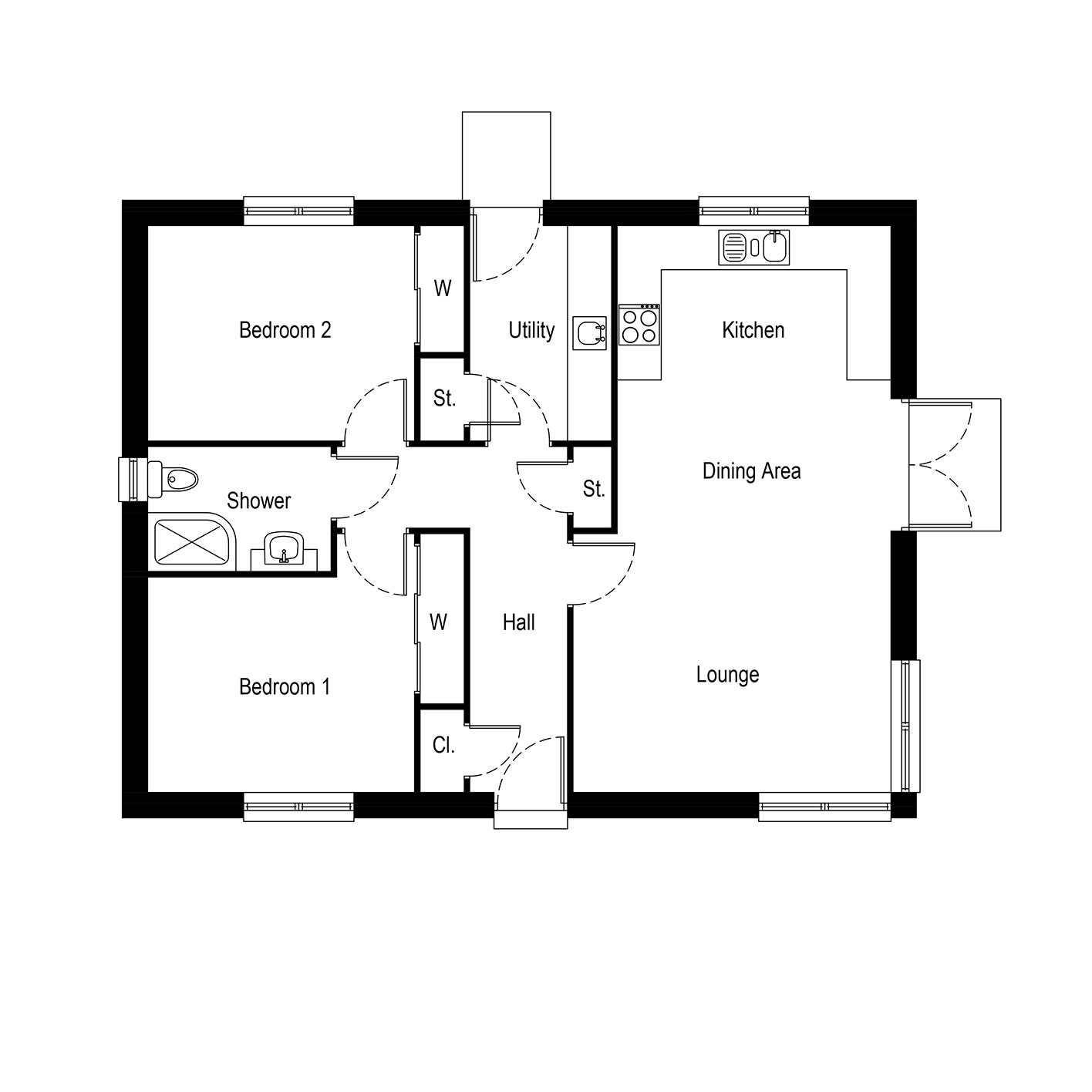

Budgethouse Posted Wednesday at 18:01 Posted Wednesday at 18:01 (edited) Hello, Me and my wife have a small plot of land and hope to build our own house. We have researching timber frame house kits and are visiting the NSBRC in Swindon next week for more insight. The thing is we don’t have much money and want to avoid mortgages. Our budget if we are able to borrow from family is roughly 60-80k and we have lots of friends and family that are electricians/ builders etc that are willing to lend a hand. We don’t have any planning permissions but hope to build a house like the Scotsframe “Calder” floor plan. i joined this website to learn and get advice as we start our journey! Edited Wednesday at 18:03 by Budgethouse

Kelvin Posted Wednesday at 18:21 Posted Wednesday at 18:21 Welcome. Perfect house to stick build on-site rather than a timber kit which would likely be a bit dearer. The budget is very tight though so will need careful thought and no surprises in the ground or with utilities. There are people who have spent close to your budget just getting utilities to their site so the first thing I’d do is look into that if you haven’t already. That said most of us have a tight budget even if the absolute number is higher.
SimonD Posted Wednesday at 18:27 Posted Wednesday at 18:27 1 minute ago, Kelvin said: That said most of us have a tight budget even if the absolute number is higher. That has got to be the best self-builder quote in a while! So if my budget is 1m and the estimated build cost is 1.2m, then definitely a tight budget..maybe too tight and certainly no room for cost shaving 😉 But on the op - that is a tight budget in today's building space and would require some very careful assessment in the high risk areas as already mentioned, but also in decisions all the way through the build with materials etc.
JohnMo Posted Wednesday at 20:03 Posted Wednesday at 20:03 General cost adders are 1. not planning well enough, there should be no surprises once out the ground. 2. Deviations from drawings once drawn. 3. Getting carried away with expensive kitchens and bathrooms. My advise Plan everything at the drawing stage. Map out you sockets and lights Map out all your plumbing and heating - how are you heating? Map out a ventilation scheme Massive savings are possible by keeping things simple - one zone heating fully open system. Fully understand how and what you are doing about insulation airtightness etc - if planned well, need not cost you anything additional. All the above allows you to spot bargains but ahead of time and save loads. Things on your plan that look expensive already are 1. the corner with the glazing in the lounge - looks like and expensive structural detail you could eliminate. 2. Do you need french doors in the dining area? 2

Crofter Posted yesterday at 02:58 Posted yesterday at 02:58 That house design seems like a good starting point for a budget build. It's nearly square, and it doesn't have any costly features like stairs, dormers, bay windows, or a chimney. You might find it useful to pick up a copy of 'The Housebuilder's Bible'. I'm not sure how up to date the current version is, but the one I used was pretty no nonsense. Just for reference, the house I built (see profile pic) cost me £40k. That's the full build minus land. It's small (50m²) and was built between 2015-2018, so pre inflation. In your position, I would look to play to your strengths. Are you handy with woodwork, or can you lay blocks? Do you have friends or family with skills, who would do you a favour? The various build methods and materials all have pros and cons. I found that timber frame with timber cladding and a sheet steel roof was very cost effective and DIY friendly. Good luck 🙂

torre Posted 22 hours ago Posted 22 hours ago 14 hours ago, Budgethouse said: avoid mortgages. Our budget if we are able to borrow from family What's your plan if family circumstances change and they need money back? If you may need a mortgage in future you'll need to budget for some sort of warranty, also if you end up needing to sell. Your house looks well suited to being built on a budget but you need to plan for worst cases and have contingency. What are ground conditions like and service access? So much money can go just getting out of the ground. It's an exciting plan and I want to sound cautionary not negative but if you risk running out of money an unfinished, unwarranted house may not be worth much more than the land it's sitting on.
ProDave Posted 22 hours ago Posted 22 hours ago Put some dimensions on that drawing or tell us how many square metres? You will do well indeed now to build for under £1000 per square metre. We did, but it was a slow build with a LOT of DIY work and it finished about 5 years ago. But as others have said, once you have foundations in, that would be an easy timber frame built on site which is entirely DIY possible if you have some basic skills and tools. Other DIY things, buy some kwikstage or similar scaffold and do it yourself. no scaffold rental and no time pressures to get it done and scaffold down.
