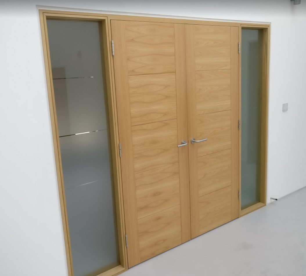

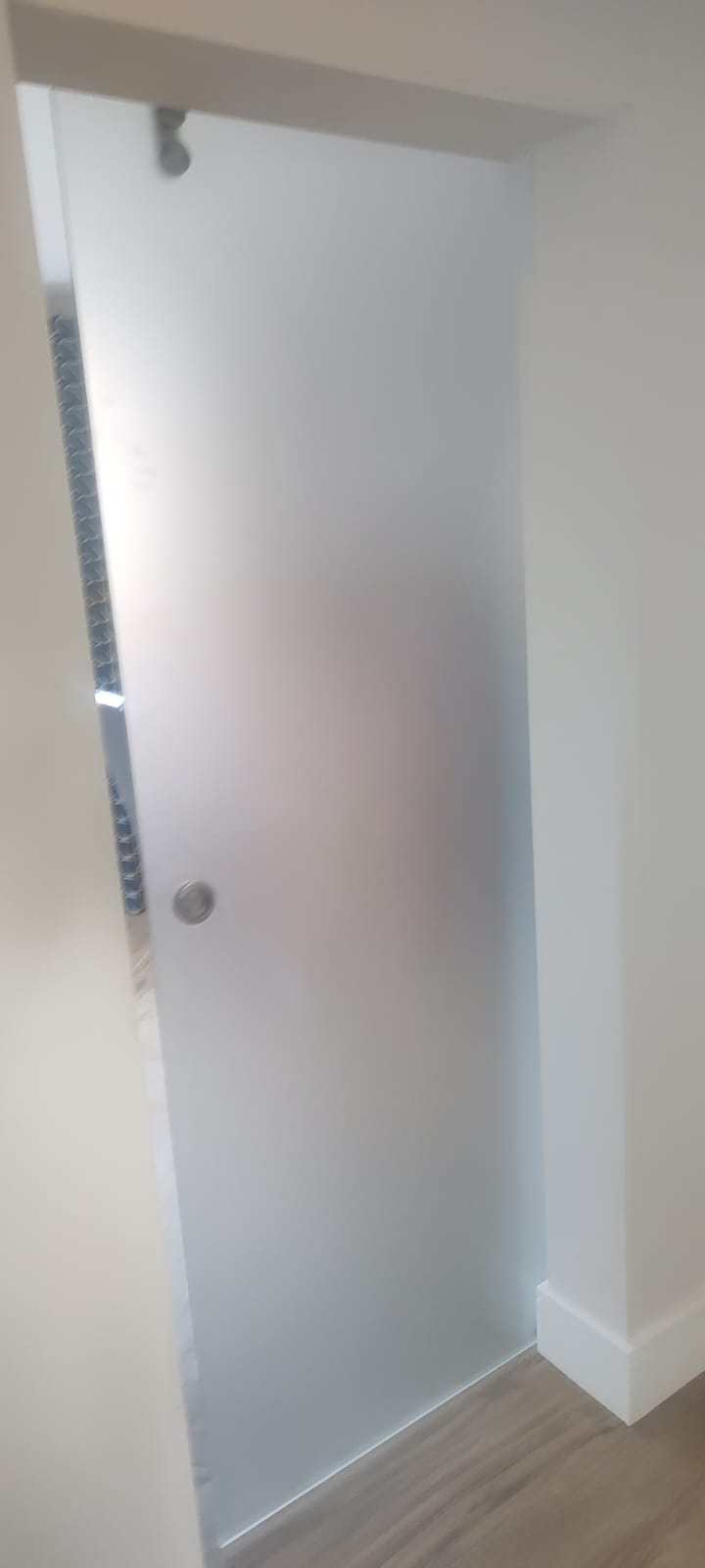

Russell griffiths Posted January 3, 2018 Posted January 3, 2018 I prefer this type of finish, as previously mentioned I would hate to run plasterboard to the floor and get it damaged by kids toys, hoover. What about it getting damaged by say water from a steam mop or something similar. 2

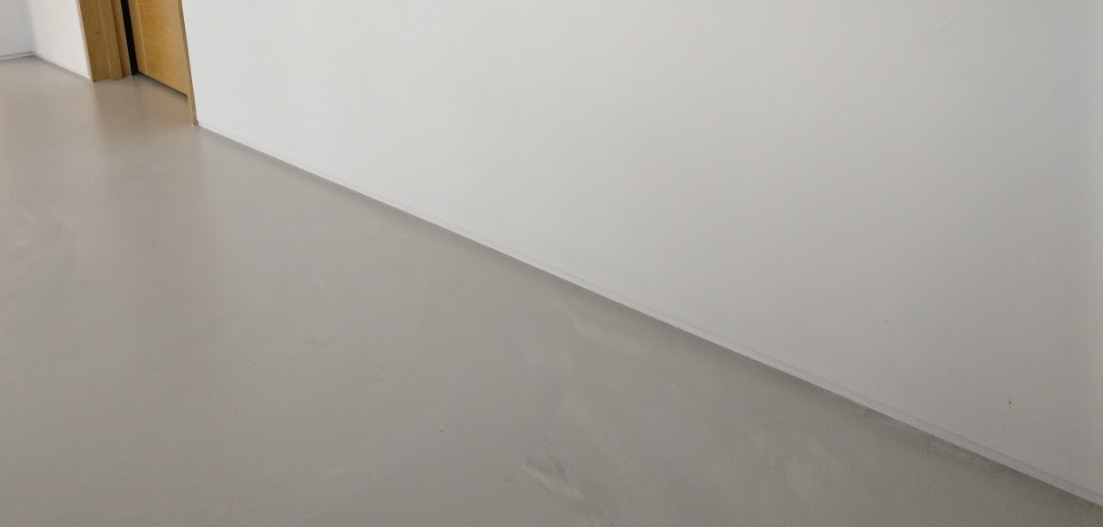

Stephen Aitch Posted September 18, 2020 Posted September 18, 2020 Hi all, Architect has recommended a shadow gap on our new build. On GF we are having polished concrete, so I am happy it will work well. On 1F we are fitting carpets. Struggling to find images of carpet with shadow gap. Any views on whether this will work pls?
Tom Posted September 18, 2020 Posted September 18, 2020 Interestingly Stephen, we want shadow gaps with our concrete floor but our architect is warning against. He's worried that any irregularity/wavyness in the floor will be too easy to see with unforgiving shadow gaps. We're planning a power floated finish rather than polished. Are you happy you will be able to achieve a crisp finish - and if so can you share how?!
Stephen Aitch Posted November 29, 2020 Posted November 29, 2020 On 18/09/2020 at 17:51, Tom said: Interestingly Stephen, we want shadow gaps with our concrete floor but our architect is warning against. He's worried that any irregularity/wavyness in the floor will be too easy to see with unforgiving shadow gaps. We're planning a power floated finish rather than polished. Are you happy you will be able to achieve a crisp finish - and if so can you share how?! Expand Hi Tom, sorry - just seen this now! The concrete floor is being installed first - Lazeby insisted on this. That should derisk builders setting the shadow gap at irregular intervals. Lets hope it works! I will keep you posted. For the first floor we are now going with skirting - to help pin our accoustic flooring down.

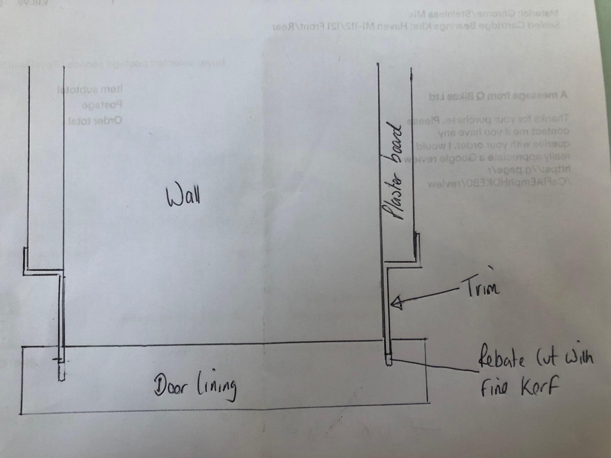

flanagaj Posted September 21, 2023 Posted September 21, 2023 So this got me thinking last night to see whether there was a good solution to installing these around door linings. I came up with the below approach. If fitting them to stud walls then the dimensions of the wall will be 95mm and therefore your rebates that you cut with the fine kerf will be straightforward. Block walls might be trickier. it all depends on how and who fits the trims to the stud work or blockwork. 1

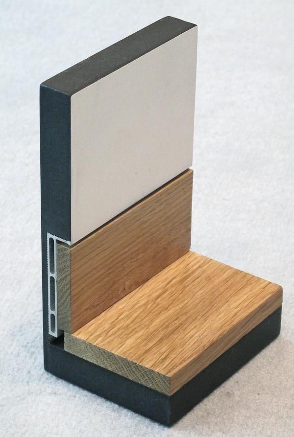

ToughButterCup Posted September 21, 2023 Author Posted September 21, 2023 On 21/09/2023 at 07:02, flanagaj said: ... it all depends on how and who fits the trims to the stud work or blockwork. ... Expand Every last bit of research I have done about this issue makes the same point. Here's Scott Brown (Kiwi carpenter) on the subject - well worth following 1

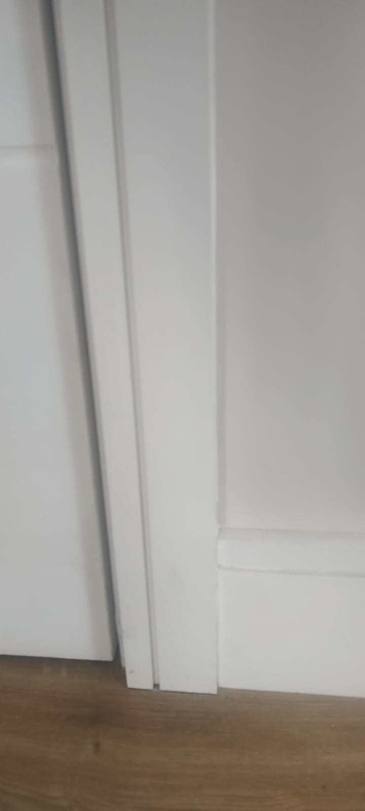

Tetrarch Posted January 29 Posted January 29 I specified shadow gaps in our refurb but actually moved away from the idea for a couple of reasons: Effectively "removing" the layer of plasterboard would expose the steel frame and void that would compromise the internal insulation and make airthightedness more difficult to achieve. Good though my plasterer was, shadow gaps are extremely difficult to get perfect and any discrepancy would stick out (as previously noted) Getting a really good intersection around door frames would be a challenge and would likely place for cracking in the future I went with a "shadow gap" architrave, which I am satisfied with, the bonus is that using the same profile with thicker architrave made decorating exceptionally easy Regards Tet
