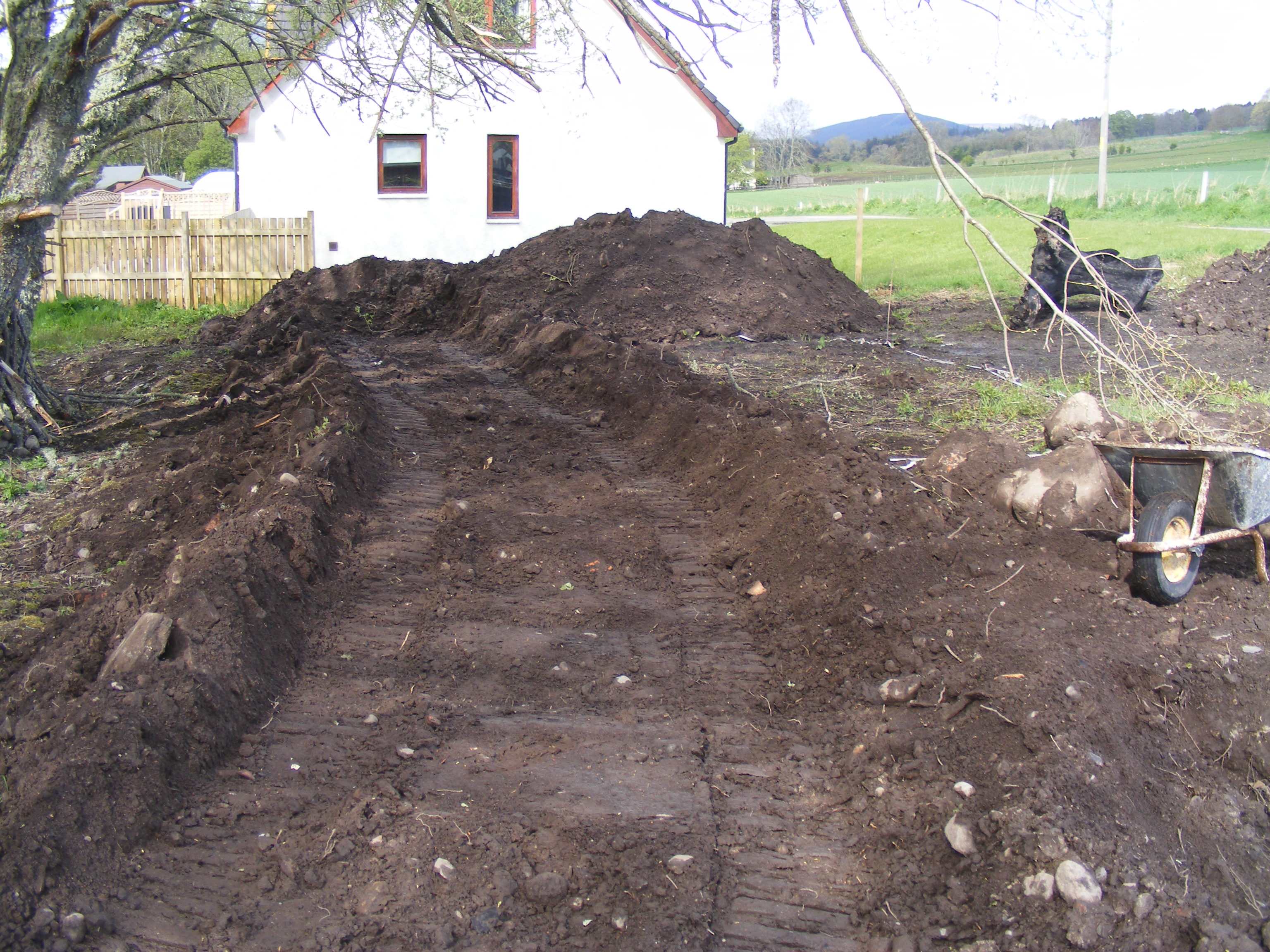

Moving soil with the dozer blade
When I was doing my groundwork I wanted to clear all the topsoil and pile it up at the edge of the site.  I did not find a cheap enough dumper close enough so was doing it all with my 3t digger.
So I used the dozer blade.  Piled up a load of soil in front and pushed it.  After a few runs, what spilled out from the sides formed a trench and thereafter not much escaped.
Once pushed to the edge, used the digger bucket again to pile it up into one big pile.  So it can be done.
