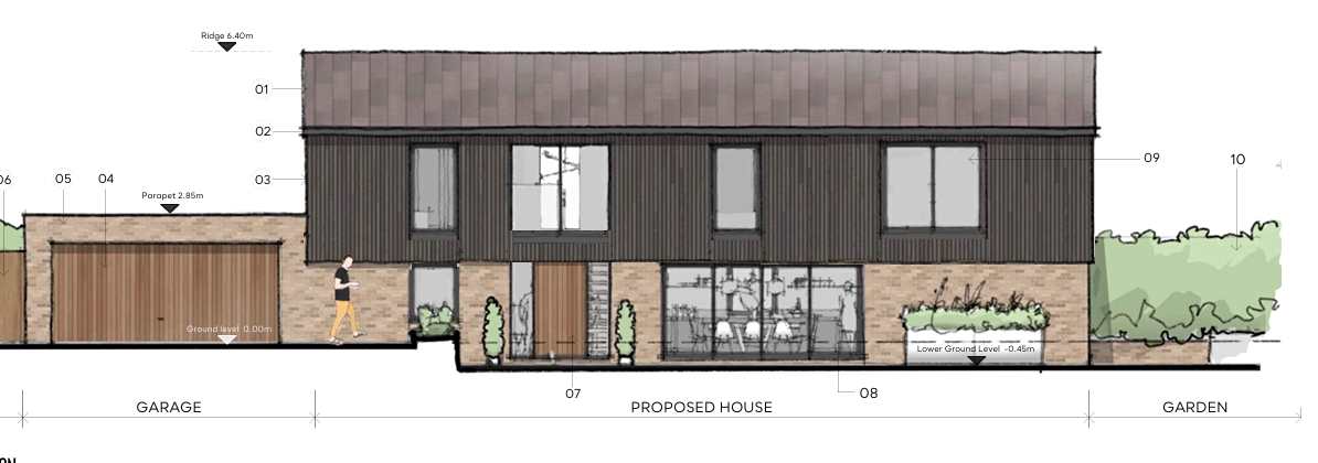

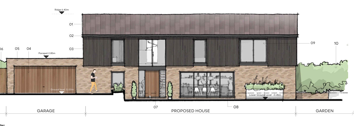

flanagaj Posted 23 hours ago Posted 23 hours ago Our approved plans are as below. This is south facing and there is zero shading. The architect hasn't specified eaves and I am concerned that unless we go with solar glass (already baulking at cost just for DG units), then the whole house will be unbearable during the warmer months. Does anyone have any suggestions of things that we could potentially do. We are submitting a NMA shortly and we could always put something on then.

joth Posted 22 hours ago Posted 22 hours ago Carefully planted and maintained trees can block summer sun but still let in some winter light. That tech is beyond me though (and takes time). You could add brise soleil to the plans, gives you the approval to install them if you ever want to in the future Else +1 for external shutter blinds, it's what the rest of Europe uses surely only time before we wake up to using them more here.

flanagaj Posted 19 hours ago Author Posted 19 hours ago 3 hours ago, joth said: Carefully planted and maintained trees can block summer sun but still let in some winter light. That tech is beyond me though (and takes time). You could add brise soleil to the plans, gives you the approval to install them if you ever want to in the future Else +1 for external shutter blinds, it's what the rest of Europe uses surely only time before we wake up to using them more here. Given we are installing vertical timber cladding, these could in theory be added. without changing the appearance of the property. Downstairs could be achieved using some sort of sun shade.

IanR Posted 15 hours ago Posted 15 hours ago 4 hours ago, flanagaj said: Given we are installing vertical timber cladding, these could in theory be added. without changing the appearance of the property. Downstairs could be achieved using some sort of sun shade. Bring down the lower edge of the cladding to the top of the ground floor windows, so you can put the top boxes for the ground floor blinds behind the cladding also: +1 for external blinds with automated shading control. 1

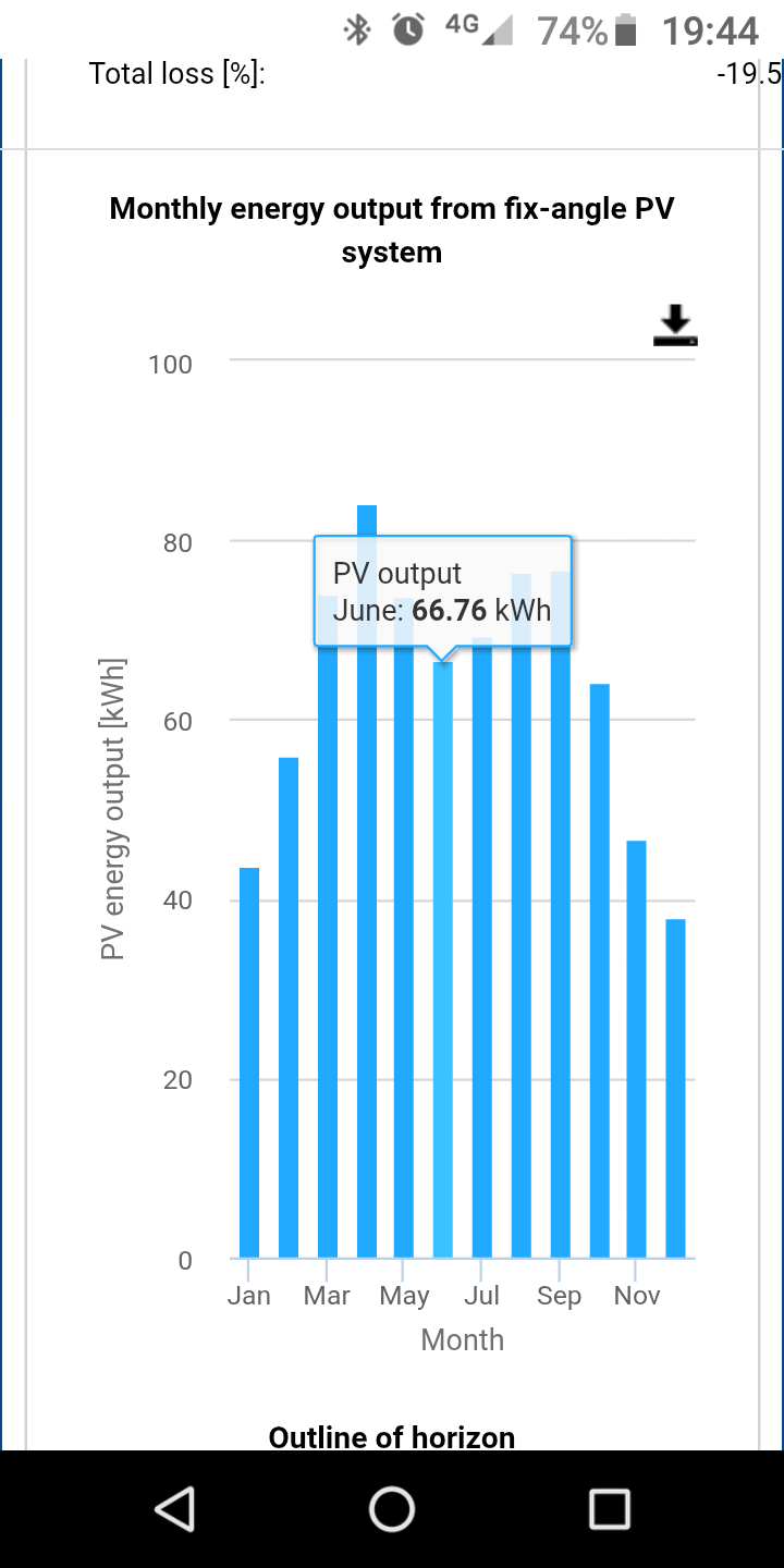

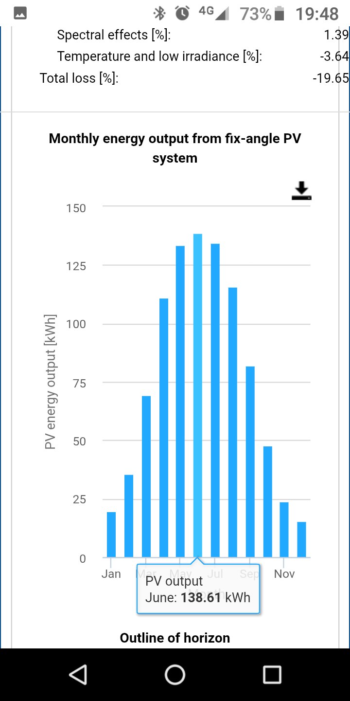

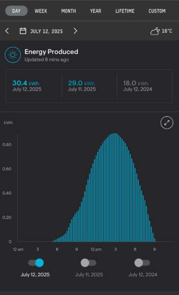

SteamyTea Posted 11 hours ago Posted 11 hours ago 12 minutes ago, JohnMo said: Panels make great fence panels, But greatly reduced output during the summer, if you want to use them for cooling. This is the project for a 1kWp system, South facing, by the sea in Penzance. First screenshot is vertical, second is horizontal.

JohnMo Posted 11 hours ago Posted 11 hours ago 6 minutes ago, -rick- said: consider planning for a wooden pergola in front of the main downstairs windows That's a good suggestion - a pergola doesn't have to cost much. I just built one with 2x PV panels. So solar shade and generation in one assembly. 13 minutes ago, SteamyTea said: 1kWp system, South facing, by the sea in Penzance. First screenshot is vertical Vertical just do 3x 500W panels to a 1kW inverter. Or as you say horizontal or any angle in between. It's also useful to have PV generation in winter, vertical will give twice the output in Dec/Jan. A 200m² new build to a half decent build spec, should only need a 4kW heat pump. CoP of 5 to 6 doing cooling, will generally be pulling less than 500W (modulated down). If the sun's out and you need cooling, PV is generating. Our two horizontal 500W panels in full sun the other day were generating between 800 and 900W, which is enough to run our 6kW heat pump.
