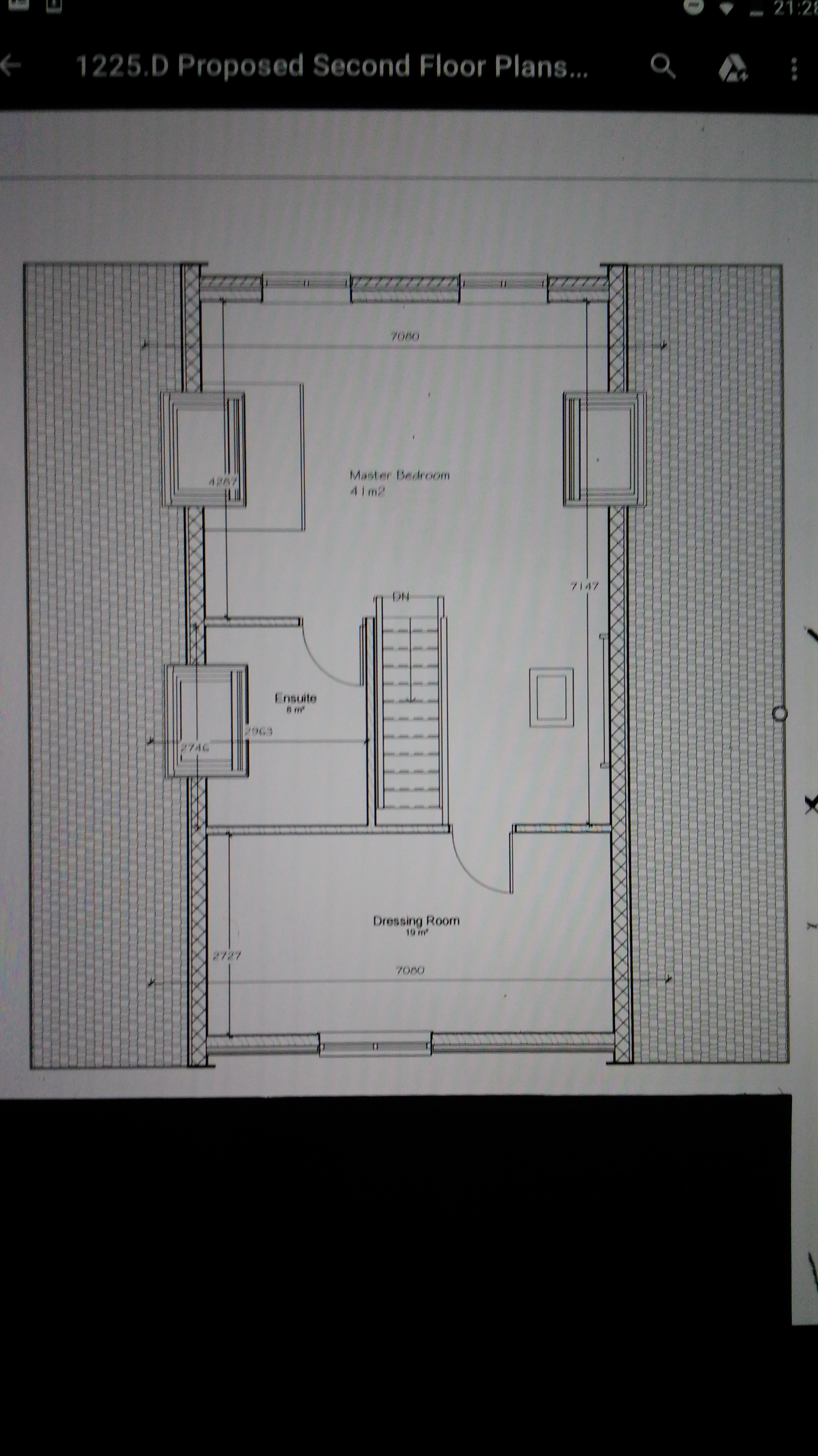

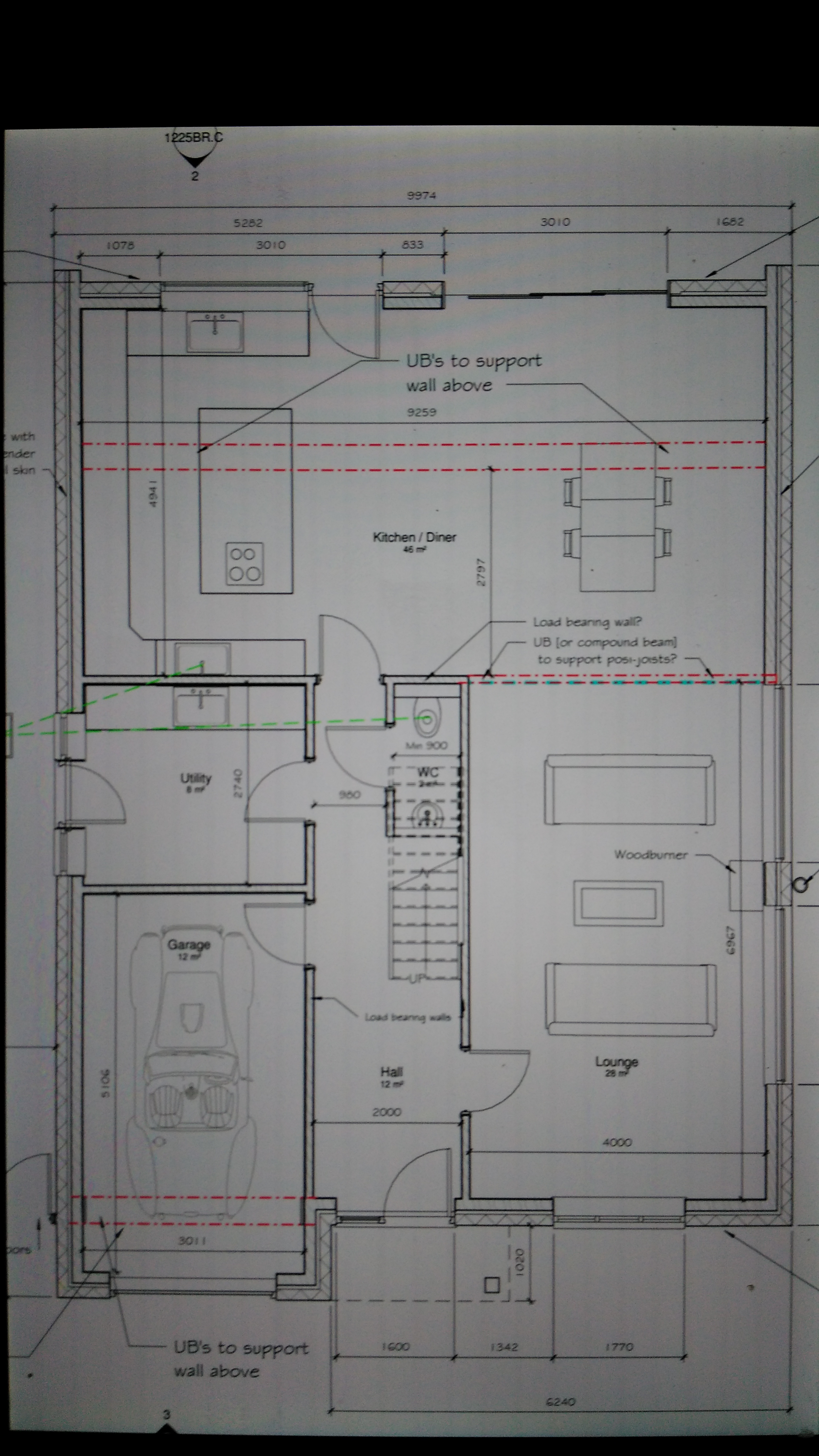

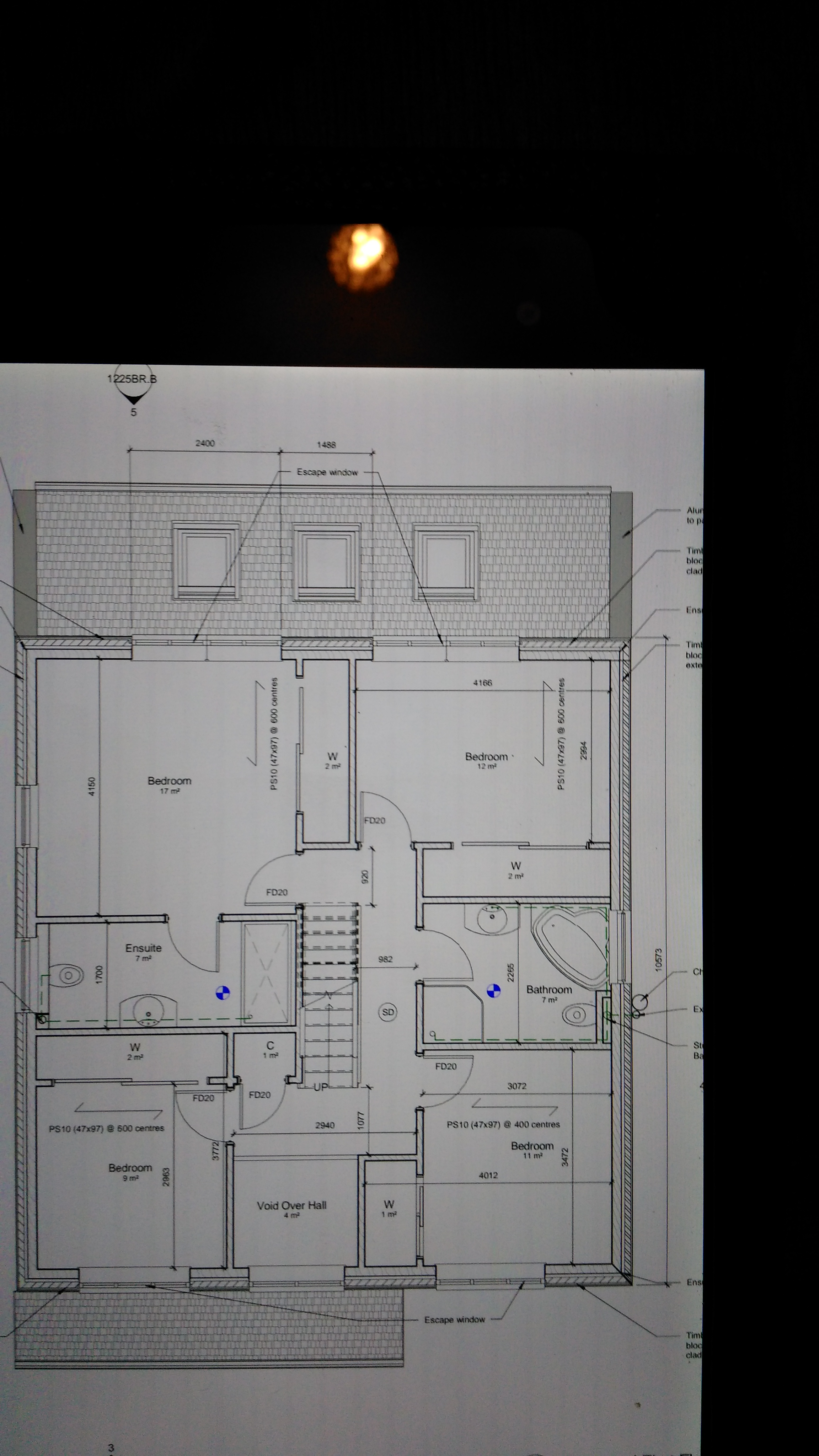

jpinthehouse Posted December 21, 2017 Share Posted December 21, 2017 not sure if should have Mvhr, see attached plans advice greatly received Thanks Link to comment Share on other sites More sharing options...
Declan52 Posted December 21, 2017 Share Posted December 21, 2017 If you are trying to save money in the long run by making your house by insulating it good and making it as airtight as you can get it then you have to provide some method of ventilation, the easiest being mhrv. You can get complete systems for £2k which can be self installed fairly easy. If you are going down the route of building regs type house with trickle vents in the windows then it would be a waste. The choice is up to you. Link to comment Share on other sites More sharing options...
jpinthehouse Posted December 21, 2017 Author Share Posted December 21, 2017 So if I have Mvhr there is no need for trickle vents?, I am insulating above b regs Link to comment Share on other sites More sharing options...
Redoctober Posted December 21, 2017 Share Posted December 21, 2017 (edited) It;s not as easy as that I fear Have a read of this as a starting point to understand what is required - http://www.nhbc.co.uk/ProductsandServices/ConsultancyandTesting/Airleakageservices/documents/filedownload,38528,en.pdf They mention that every new build requires an - Air Permeability Testing is a requirement for new buildings under Part L of the Building Regulations. If a score of under 5 is achieved then an MVHR should be on your radar. Others will be able to explain more and in greater detail but the attached should get you up and running. PW Edited December 21, 2017 by Redoctober typo Link to comment Share on other sites More sharing options...
Declan52 Posted December 21, 2017 Share Posted December 21, 2017 No if you go down that route then when the time comes to spec your Windows and doors you can tell them no trickle vents or even a letter box. There is a lot more work involved getting a building airtight than just no trickle vents though. Link to comment Share on other sites More sharing options...
