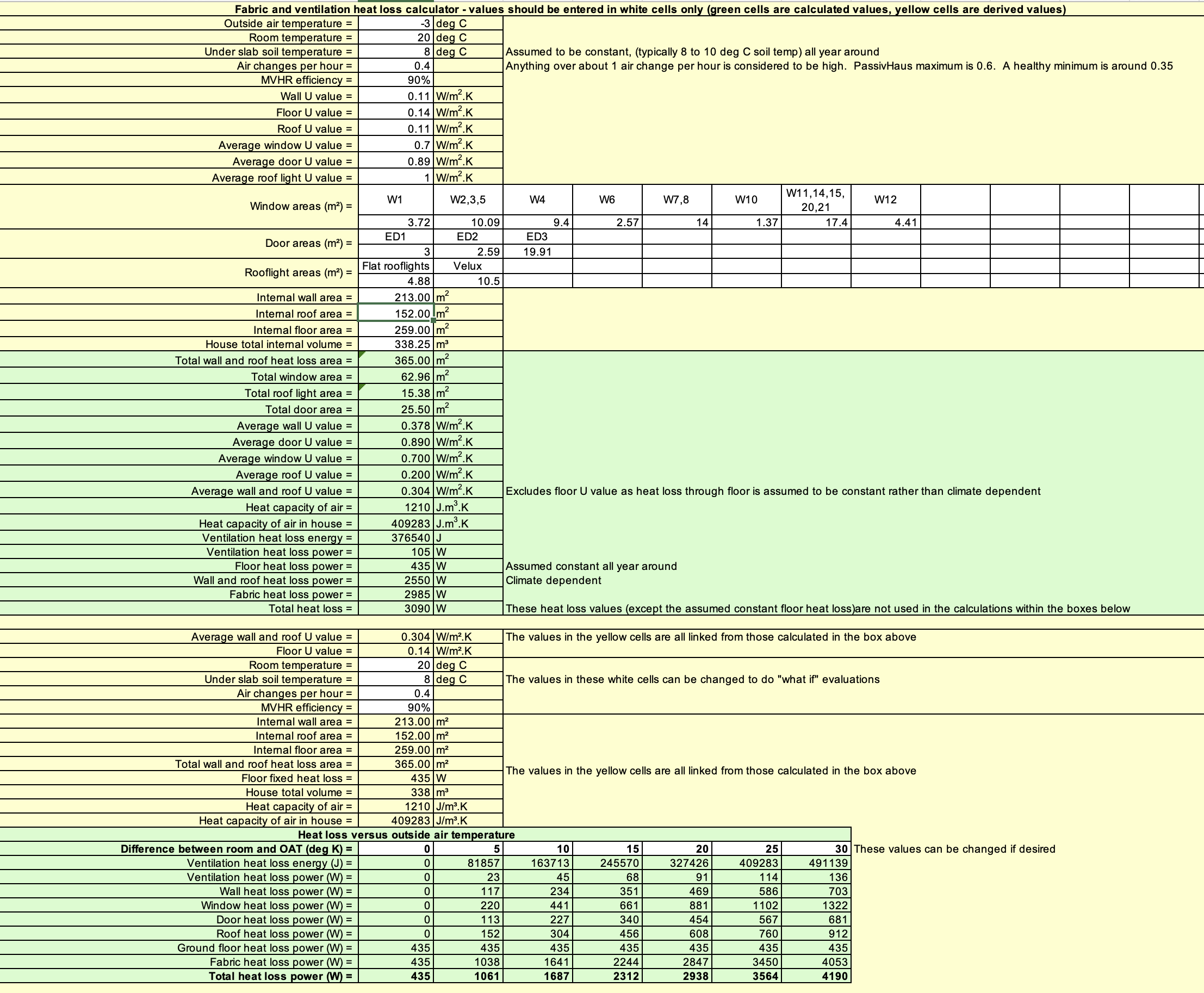

Ok, so please excuse the basic questions...
1. Internal wall area = is this just the external wall dimensions? could I just as easily calculate the external wall area (noting that this ignores the depth of the first floor and the thickness of walls that are perpendicular to the external wall, but as it's just a simplified calculation I assume this doesn't really matter much)
2. Internal roof area = could I just measure the roof? Ours is a warm roof and the upstairs is almost all inside the roof fault (small top collar)
3. Internal floor area = assume this is the sum of both floors?
And the most basic question till last...
4. Which cell contains the figure I'm looking for as to size of my ASHP? I've read some comments about multiplying the total heat loss power by 24(!?), but couldn't see anything on the spreadsheet that mentions or suggests this.
Grateful for your help in spelling out the obvious to me! (screenshot attached but sure I've not got some of these bits right; temperatures not changed from the default)

1. Either will.be good enough
2. You need the area exposed to the internal temperature. So a vaulted ceiling wouldn't be the flat area, the it would be whole area you can see and touch
3. The floor area is the area touching the ground.
4. Bottom green box in middle "total heat loss"
You need to allow room for DHW.

Don’t worry I had the same challenges.
Don’t forget the spreadsheet is an estimate
so if you use external vs internal wall/roof areas I wouldn’t imagine it’s hugely different. Youll get a higher heat loss by using larger dimensions remember. .
Internal floor area is measuring heat loss on ground floor so only put in the floor area of the ground. There is no loss through intermediary floors.
The ‘total heat loss’ cell (3090W) gives
your worst case heat loss when it’s -3 outside.
I would question your house volume though that looks really small if you have 259sqm floor space multiplied by 2.4m that’s a minimum volume of 621m3. Are You sure?
0.4 ach is a bit low as well id go higher.
