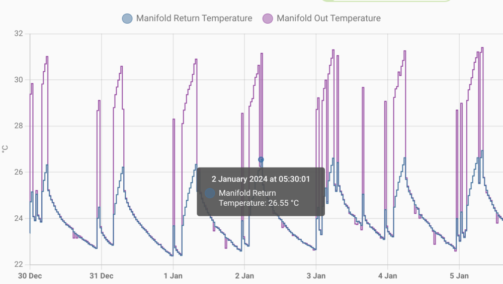

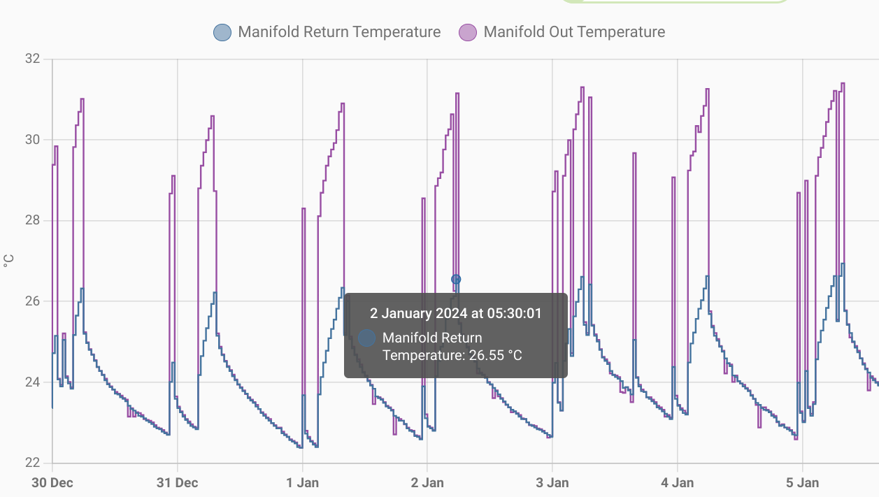

Adrian Walker Posted January 5 Share Posted January 5 7 hours ago, TerryE said: @Chris D, I have a warm slab (essentially 17 tonne of slab + another 10 tonne ring-beams wrapped in 200-300 mm EPS) with the UFH loops running in the slab itself. The house is a near-passive design so the slab only needs to run about 3°C warmer at its surface to provide enough space heating to keep the house at ~ 22½ °C which is what we like. Here is a plot of the last 7 days manifold return temps: I do my heating using Octopus Agile. The CH algo calculates the total heat required daily and heat the slab at the cheapest ½hr price slots, which are mostly (but not always) in the overnight period -- hence the jaggies. The house is treated as a single zone. Currently the return peaks at 26-27 °C and decays to room temp through the day. The outs are ~3°C hotter during heating. ☹️ I have been following your approach and solution to UFH with interest over the years. What is the slab temperature over the same period? Do you get jaggies or does the mass smooth it out? Link to comment Share on other sites More sharing options...
jack Posted January 5 Share Posted January 5 31 minutes ago, Adrian Walker said: I have been following your approach and solution to UFH with interest over the years. What is the slab temperature over the same period? Do you get jaggies or does the mass smooth it out? I also have an MBC slab and try to do as much heating overnight as possible. I have a typical daily ripple of about 0.2 degrees as measured at the top of our concrete floor. 1 Link to comment Share on other sites More sharing options...
TerryE Posted January 5 Share Posted January 5 (edited) @Adrian Walker, a bit off topic I discuss this in my blog posts, but to summarise for your Q, I have added the manifold out temperatures. This is a Home Assistant plot. My CH system is a standalone RPi running Node-RED. It publishes temperature and other stats ½ hourly to my local MQTT instance and these are tracked by HA, so the jaggies in the plot are partly because of the 30 min subsampling, and partly because the heating is only on when the electricity is cheapest. (Octopus actually paid me to heat the house on a couple of days over the Xmas break.) As you can see the out whilst heating is ~4°C hotter than the return and the temp gradient is pretty even along the loops so the UFH pipework peaks at ~6°C hotter than the slab surface during heating. The heat flows out radially from the UFH loop throughout the slab and within 15 mins of so of the heating stopping the bulk of the heat has spread pretty uniformly throughout the slab at around just over 25°C or 3 °C hotter than room temp. It is noticeable and Jan really like padding around in the kitchen in her bare feet in the morning when the slab is at its warmest. My ripple is was little more that J's: when I measured it with a spot IR temp meter -- about 1°C. Edited January 5 by TerryE 1 Link to comment Share on other sites More sharing options...
