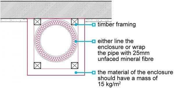

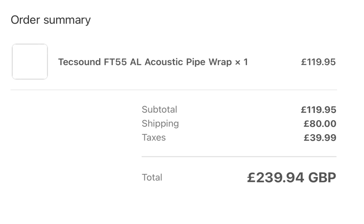

Nick Laslett Posted April 17, 2025 Posted April 17, 2025 (edited) 8 hours ago, bmj1 said: I'm curious. What material did you use to insulate your SVPs? Here is the NHBC technical detail for SVP boxing. This is a good starting point using mineral wool. If you stuff the enclosure with too much mineral wool, you risk creating a coupling effect which enhances the sound transfer. The air gap is important. The next step up from this is denser mineral wool with an aluminium foil backing from Rockwell, Isover, etc. Armaflex have a version with aluminium foil, edpm and foam. I went with the Tecsound FT55 AL Acoustic pipe wrap, which has the best acoustic reduction by depth, only 12.5mm for -25dB. This consists of porous felt bonded to the Tecsound membrane, reinforced with an aluminium foil. I bought it from here: https://soundstop.co.uk/products/tecsound-ft55-acoustic-pipe-wrap Ouch! This site looks like it stocks most of the options: https://www.buyinsulationonline.co.uk/blog/soil-pipe-insulation-a-step-by-step-guide Another product I bought was Muftilag R51 Acoustic Insulation Sheet, which is slightly thicker. I also used the Wavin AS+ SVP product line. This is similar to Geberit Silent-PP and Marley dBlue. There are probably other options. The acoustic soil pipe has a much thicker wall than standard SVP, but the main area where it improves the sound reduction is the female coupling and the edpm padded brackets. https://wavin.com/gb/s/C03_F011_S276/wavin-as Finally, I used Fermacell boards for my build. These are higher density boards with better sound reduction than soundblock plasterboard at the same thickness. I don’t know what board NHBC are specifying to get 15kg/m2, 15mm soundblock plasterboard is 13kg/m2. 12.5mm Fermacell board is 14.5kg/m2. Edited April 17, 2025 by Nick Laslett
bmj1 Posted April 17, 2025 Posted April 17, 2025 That's a nice approach. And arguably a better solution than the blue acoustic push fit svp I ended up using
Spinny Posted April 18, 2025 Posted April 18, 2025 Yes, we have used that acoustic pipe wrap for ensuite soil pipe running across a ceiling. The Mass Loaded Vinyl does seem effective. We found we had an issue with rain noise beating down on a singly ply warm roof like a drum, so we are sticking a layer of adhesive MLV internally to the underside of the deck between the joists. We tried it out in one room and it was very effective in reducing the rain noise. Agree with all comments above. Obtaining the right materials at the right time is a hell of a challenge. Builders & trades are often completely uninterested and unwilling to obtain anything which isn't immediately available off the shelf at any builders merchant. If you want anything other than the most basic spec items it is highly unlikely to be stocked by any standard merchant as they all seem to focus down their stock ranges very severely. The internet amazon style delivery model has taken over for anything beyond basic items. Often there will be a weeks lead time. And our builders were constantly over optimistic about when they would need items and we have stuff stored all over the house for months. I have had to help unload and carry stuff delivered on an artic lorry that couldn't get down residential streets. Unfortunately I consider the building materials market as pretty dysfunctional. Most materials are purchased by trades people and not the building end customer. This means many manufacturers focus on the needs and interests of trades which are distinctly different to those of end users. Trades want - off the shelf, low discounted price to them with high list price they can charge their customer, to use the same stuff on every job, stuff which is very quick and easy to cut, handle and install. One product variation, not 15 different colours, and 10 options. They don't care about 'nice to have's' or 'bells and whistles' or 'detailed spec requirements' etc. They are not going to live in what they build. They don't want 12 different trade accounts. This makes the building industry very resistant to change, and makes it very difficult for manufacturers to get products which benefit the end customer, but not the tradesman, into the market. I have used habito plasterboard...higher spec, higher price, heavier, and you have to work to source it and no tradesperson knows or cares that it exists. https://youtu.be/VltFR-kXtcw?feature=shared 3
