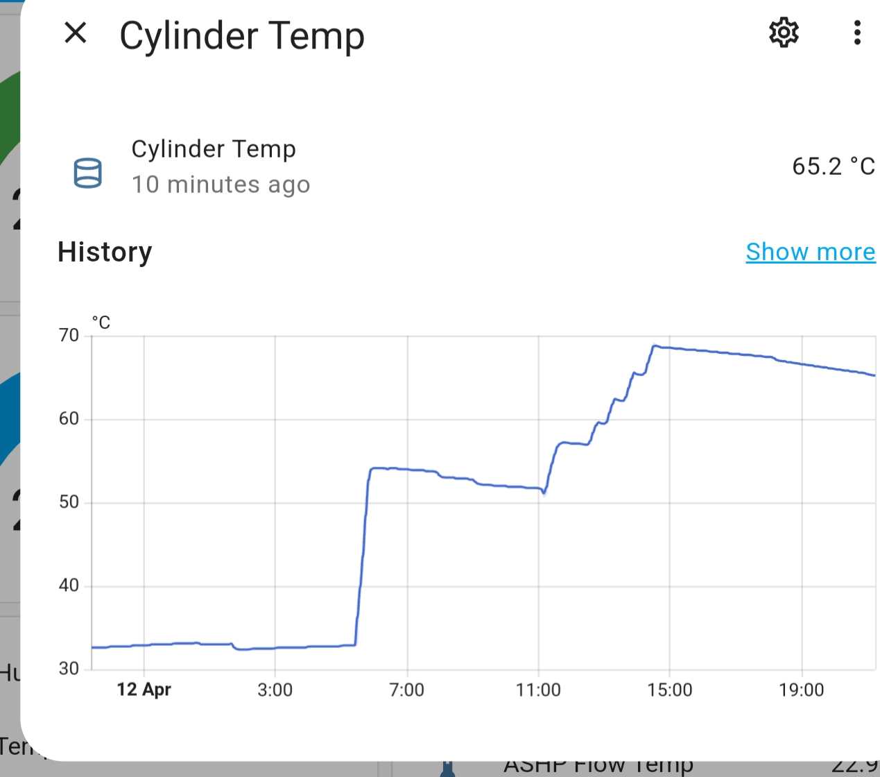

JohnMo Posted April 13 Posted April 13 17 minutes ago, Workerbee said: 150l We have a 210L heat pump cylinder this is the temperature profile today. Before 7am it was heated to the 53 degs, temp dropped doing wash up etc. At 11am excess solar PV heated to nearly 70. The drop around 1900 was me having a shower. The temperature sensor is in the bottom third of the cylinder, so loads of hot water left. So a 150L heater to decent temperature should be an issue. But the hotter you heat the quicker it looses temperature so you maybe better a slightly bigger cylinder heated slightly cooler? But if you are thinking heat pump in future, just install a heat pump UVC now and won't connect the heating coil, then do a 180 to 210L. Thermal store if connected to heating could be in the region of 300-400L to be useful.
ProDave Posted April 14 Posted April 14 A thermal store sounds like a good idea, just like a combo boiler does, until you drill down into the details. Un vented cylinder every day for me. Why are people so against a modest maintenance requirement to get something good?
