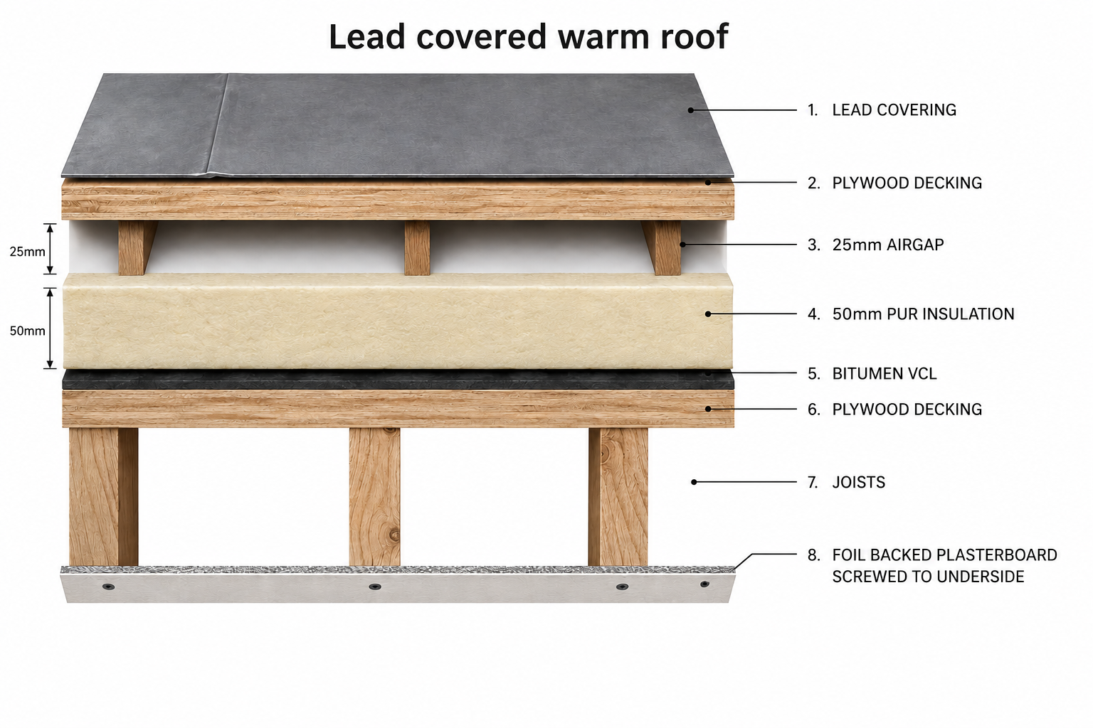

  1. Thank you @saveasteading. I thought the risk would be from warm moist air in the kitchen finding its way past the insulation to reach the (now colder) plywood deck. It would be a hybrid roof, which are sometimes seen as a bad idea. Particularly if the insulation was permeable like Rockwool. Even with PIR, gaps might appear over time as foil tape delaminates slightly, sealants shrink etc ?
  2. Thank you very much for the replies. You're right @JohnMo - I'm worried that moisture will get trapped between two vcls if I just replace the foil backed plasterboard. This isn't how a warm roof would normally be done. But bizarrely, it doesn't seem to have caused issues (that I can see) over the decades. Conversely, if I DON'T reinstall the foil backed plasterboard, then that too could cause issues because the insulation shrinkage might have caused cold spots for condensation on the plywood, and perhaps the bitumen layer has cracked over 3 decades? Damned if I do and damned if I don't. In terms of the insulation level, I think adding 25mm might make a thermal difference if the old insulation has shrunk? Thank you for the suggestions @saveasteading - is there no danger of condensation with creating a hybrid roof, though?
  3. Hello! My kitchen has an area of lead covered warm roof: It was installed 35 years ago so the insulation will have shrunk and developed gaps. And it's only 50mm anyway. I can't think of any safe way of increasing the insulation from below, as this would create a hybrid roof, but thought I'd put it out there in case anyone had some ideas. The foil backed board was removed during the rewire, so I wanted to explore options before just replacing it. A few things I thought of: 1) original 'bright' idea was to use wood wool boards instead of plasterboard, to give a tiny safe amount of extra insulation, then paint the underside of the lower plywood deck with a liquid vcl to make up for the wood wool board's vapour permeability. As I was finishing painting on the vcl I realised what a stupid mistake this was. Still, in a full renovation you're bound to make a few daft mistakes. 2) I've got some leftover 50mm Rockwool that I could push between the joists. However, I'm guessing this would allow vapour through but cool down the plywood deck, leading to condensation on the underside. 3) fit 25mm pir between the joists tight up to the plywood with pu foam adhesive, and seal the edges. But the detailing would have to be perfect, as otherwise I can imagine it would cause big issues. Thank you for any advice.
