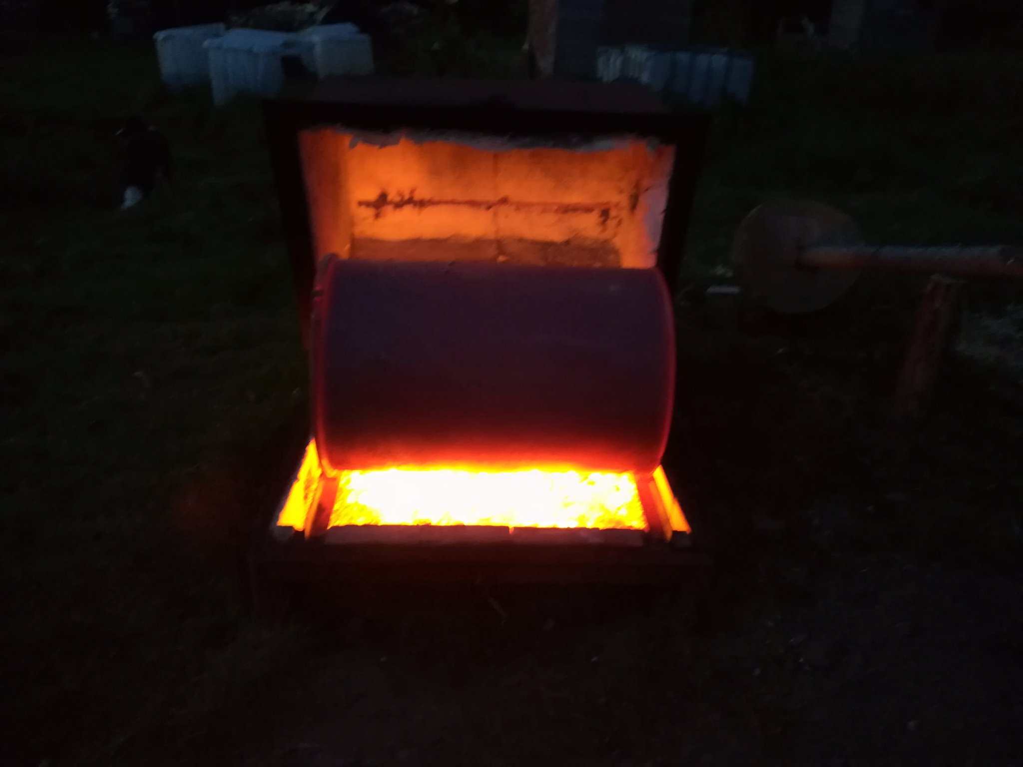

Beau Posted Wednesday at 17:30 Share Posted Wednesday at 17:30 (edited) Not really a stove but it does burn logs. My home made charcoal retort with the lid up. Had one of these up to 900C which was a tad exciting! Edited Wednesday at 17:31 by Beau Link to comment Share on other sites More sharing options...

SteamyTea Posted Wednesday at 19:32 Author Share Posted Wednesday at 19:32 2 hours ago, Beau said: Had one of these up to 900C which was a tad exciting A good laugh as it will have produced so N2O. Link to comment Share on other sites More sharing options...
