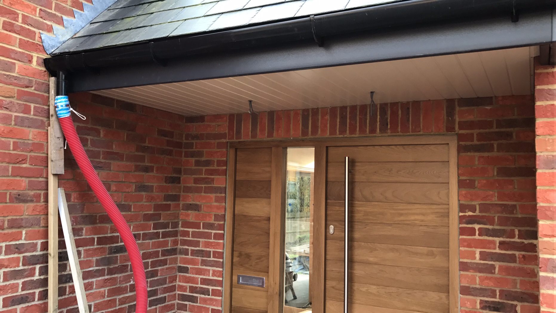

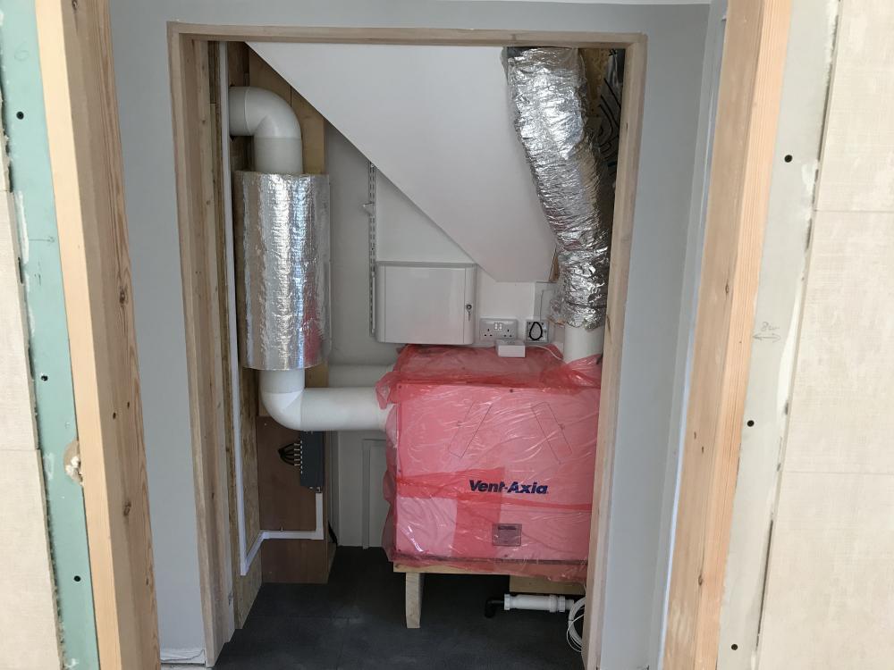

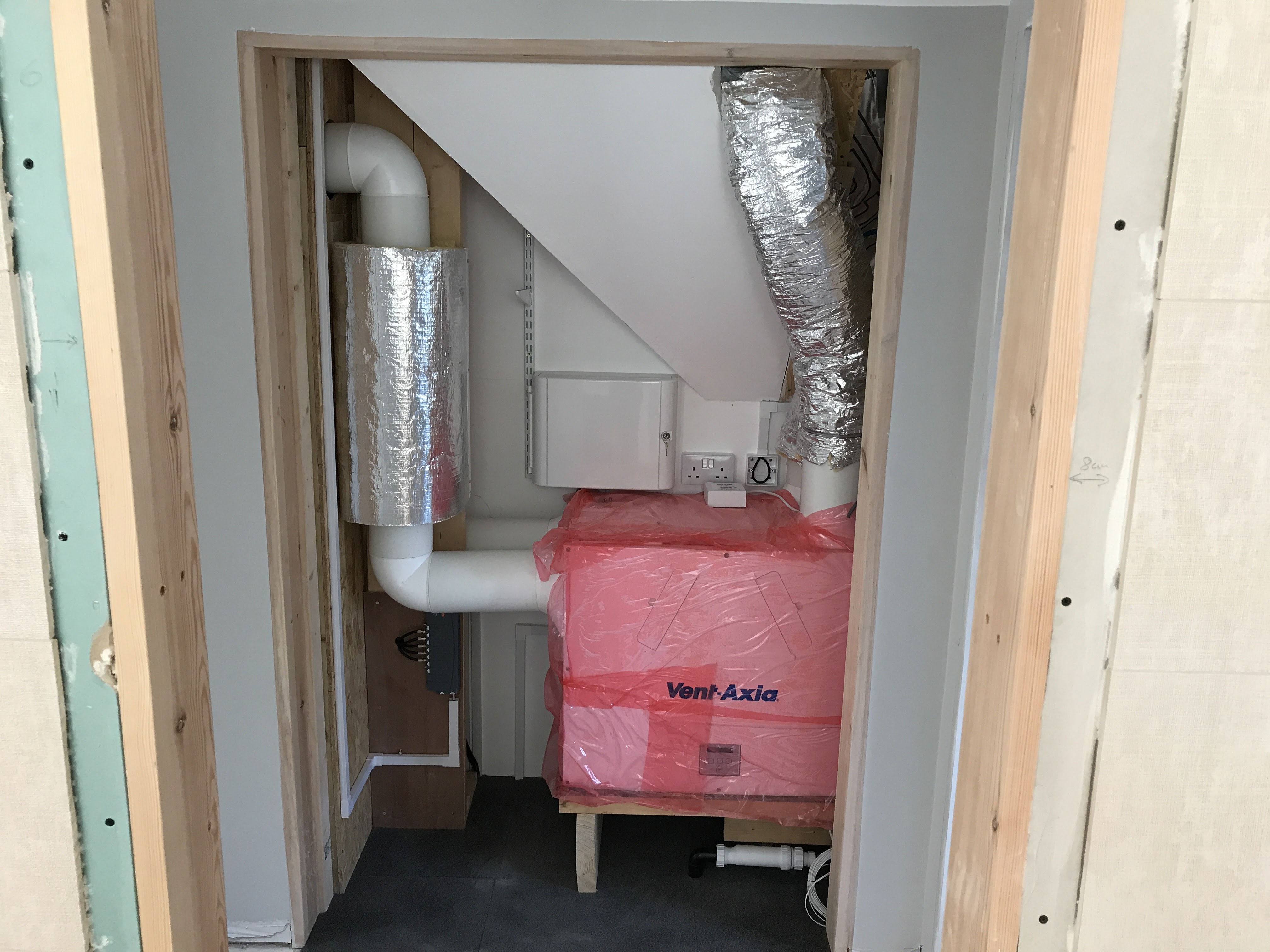

RandAbuild Posted November 22, 2017 Share Posted November 22, 2017 This is a subject very close to my heart and with a new build designed from scratch, there should be few reasons not to try to minimise future maintenance. Here is our (almost completed) MVHR cupboard, which also houses the network /data hub and TV aerial hub. I've also just finished the soffit ceiling under the entrance porch, which is finished in cream uPVC soffit boards. Even though this is very sheltered, it will never need painting. 1 Link to comment Share on other sites More sharing options...
