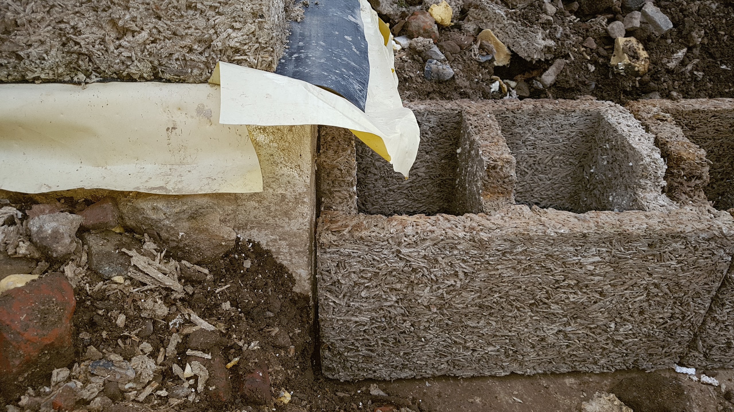

ToughButterCup Posted November 19, 2017 Share Posted November 19, 2017 Just about to build the wall connecting our house to the piggery. The wall has a full-on foundation, piles and all (for which there is no need, but thats another story) This is the junction between the house and the wall. You can see the DPC and radon barrier in the house. The wall hasn't been poured yet. (empty Durisol blocks) You can see the EPS300 butting up to the Durisol block. There's a 100mm + gap to make up the wall to the house DPC level. As it's a garden wall, there's no need for the horizontal DPC is there....? But should I run some DPC vertically between the house and the garden wall? Link to comment Share on other sites More sharing options...
nod Posted November 19, 2017 Share Posted November 19, 2017 No no need Ian Just bolt a stainless wall profile to the house so that you can tie each course in Somthing else I have surplus if you want it Link to comment Share on other sites More sharing options...
Russell griffiths Posted November 19, 2017 Share Posted November 19, 2017 Hmn had to think a bit about this without sounding like a c##k i think I may do this the opposite to what @nod has said. To work out out how to do things correctly sometimes you need to look at what has failed in the past. Garden walls or other exterior structures attached to the house can be a path for damp. In a former life I've I spent a lot of time looking for reasons things had failed damp was always a big thing we had to look into. How are you finishing the the top of the wall? What is preventing rain hitting the top of the wall and bouncing against the house. How are your durisol blocks being finished they look to be a bit porous, are they? How are you providing the rainscreen layer for the house. Two ways to look at it 1.you are building a big bridge across the damp course and a route for damp penetration 2. Is always been done like this tie it in slap some render on it go to pub it will be fine. Hope that didn't sound to c##k like. Link to comment Share on other sites More sharing options...
PeterW Posted November 19, 2017 Share Posted November 19, 2017 If they meet corner to corner and that will be a single render panel then I would look to break the joint and put a movement / expansion gap at that point. Render up to both sides of it with a stop bead and then fill the gap with a suitable sealant. Use something like this with the end bent up. https://www.twistfix.co.uk/slip-ties Link to comment Share on other sites More sharing options...
ProDave Posted November 19, 2017 Share Posted November 19, 2017 Do NOT use a DPC on a garden wall. On the occasions I have seen a brick garden wall blow over in a storm, it always topples at the DPC which created a weak bond to the brick. Probably not an issue with ICF a you would be filling it? Link to comment Share on other sites More sharing options...
Onoff Posted November 19, 2017 Share Posted November 19, 2017 I'd not attach it to the house but build a pier that end and have a gap. Do after the house wall is finished. Link to comment Share on other sites More sharing options...

Brickie Posted November 19, 2017 Share Posted November 19, 2017 +1 to Russell-personally I'd run a vertical Dpc at the junction & make it a movement joint. Link to comment Share on other sites More sharing options...

ToughButterCup Posted November 19, 2017 Author Share Posted November 19, 2017 11 minutes ago, Brickie said: +1 to Russell-personally I'd run a vertical Dpc at the junction & make it a movement joint. That's a decision, then. @nod, you've been out-voted, mate. (PS, I still owe you half a days labouring.) Link to comment Share on other sites More sharing options...

PeterW Posted November 19, 2017 Share Posted November 19, 2017 @recoveringacademic if it’s a movement joint then you need to use a wall starter that has slip joints on it and render / point as I suggest otherwise it will crack the render .... Or have you finished it already ..?? Link to comment Share on other sites More sharing options...
ToughButterCup Posted November 19, 2017 Author Share Posted November 19, 2017 Wall starter? Whasssar? Link to comment Share on other sites More sharing options...
Russell griffiths Posted November 19, 2017 Share Posted November 19, 2017 Wall starter. Why? Why would you want a garden wall joined to the house. Has it been on the sherry? Can't it stand up on its own. I would not want to penetrate the outer weather proof surface of the house with anything. Starter bars bits of reo wall ties nothing. Finish the house and build the garden wall up completely independently. If you don't want a gap you can fill it with a flexible mastic but I don't see the need to have it tied to the house. Link to comment Share on other sites More sharing options...
Nickfromwales Posted November 19, 2017 Share Posted November 19, 2017 Why conjoin them @recoveringacademic? Can't you build them detached and dispense with the concerns brewing here ? 8" gap between the two would suffice. Link to comment Share on other sites More sharing options...

ToughButterCup Posted November 20, 2017 Author Share Posted November 20, 2017 10 hours ago, Russell griffiths said: [...] If you don't want a gap you can fill it with a flexible mastic but I don't see the need to have it tied to the house. Cheapest, quickest, easiest. The cheque's in the post @Russell griffiths. Thanks everyone for helping me think this through. Much appreciated.. Link to comment Share on other sites More sharing options...
