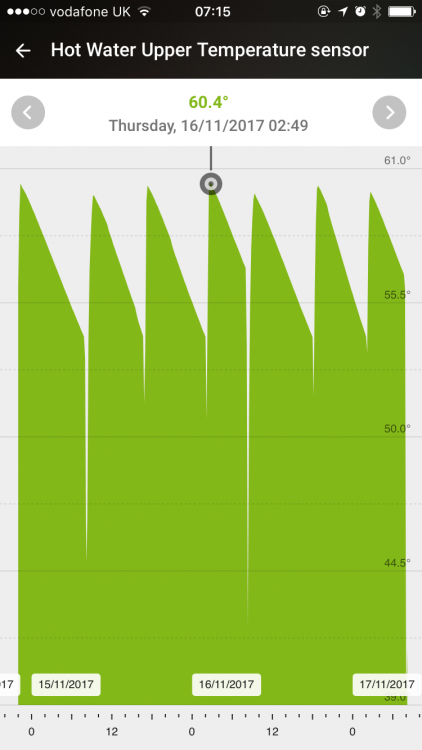

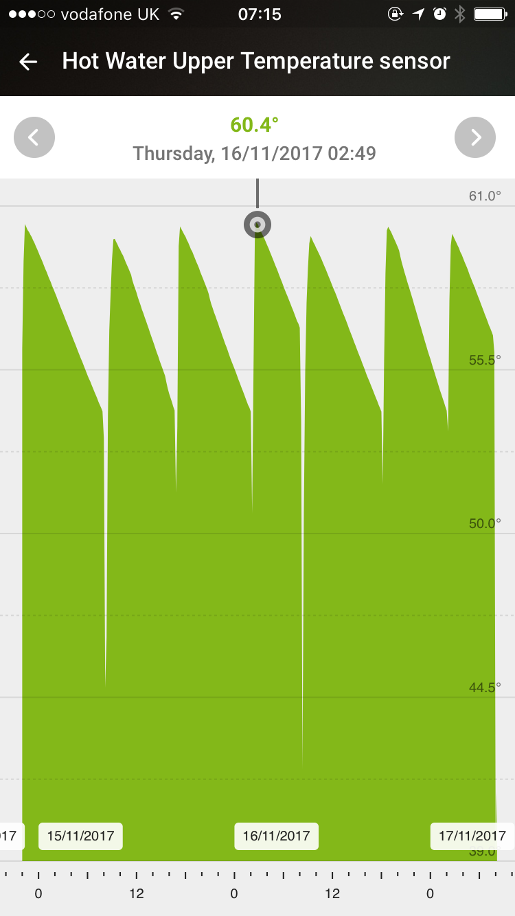

The one I am currently logging with a view to improving is the hot water tank - I m currently heating it to 60 degrees (allowing it to drop back to 55 before recharging) all the time so that it can cope with the demands of a shower and bath if used at a similar time. However I can already see how much energy is lost in doing this, so will look to change this to a high/low period whereby the tank temp is allowed to drop further during the day.

Sounds like the cylinder is loosing a fair bit of heat, how much insulation does it have?
Here's a graph from the last few days to show that steady heat loss from the cylinder....
Edit. Can anyone spot when I have a bath and read buildhub on my phone?!
Edited by Trw144

It's a valliant solar cylinder (aurostore or something like that) so whatever standard insulation is. However it is in my garage - which whilst insulated, isn't heated so the ambient temp is lower. To an extent I don't mind a bit of heat loss in there as I store quite a bit in there and it can help keep the moisture out. I just think I can reduce the unnecessary waste. Whilst not the point,  reality is the heat loss probably doesnt cost much - I'll do the calcs at some point.

Your tank is an UVC is it not?
1oC per hour is typical, even for an well insulated cylinder,  I think, and not disastrous tbh. Your backed up by gas though iirc, so with the boiler kicking in to replace lost heat do you find the heat exchange rate isn't enough to cope with demand ( linear )? Eg heat capacity of the UVC + gas boiler input doesn't give much sustain ?
Oh, and what kW boiler did you go for?
@Nickfromwales no, I don't think it's too bad - but I can improve it. Boiler is a 15kw, so either this or most likely the heat exchanger rate (will need to check what it is on my tank) is nt big enough to keep up with an 650 x 650 Bossini shower - it literally destroys the how water tank! To be honest I think I ll try and throttle the flow to it a bit by closing the isolator valve on the manifold to it - my wife won't notice flow rate but she does notice cold water.

@Nickfromwales a quick check and it looks like it takes about 30 mins to increase the tank 5 degrees.
