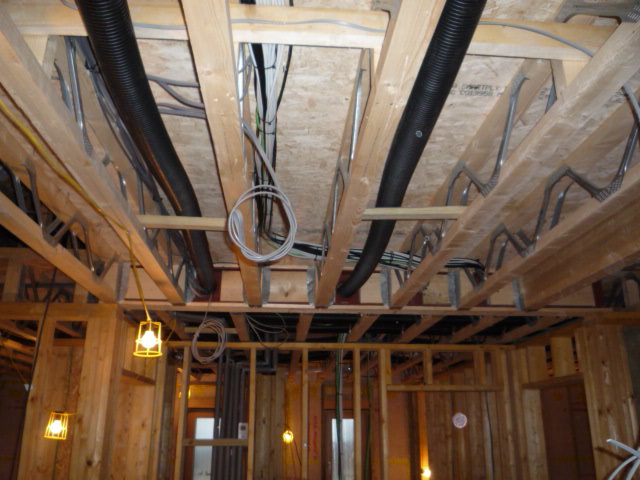

ToughButterCup Posted November 8, 2017 Posted November 8, 2017 With all our recent alarms and excursions, trips round the desert [insert your own cliche] I have not been thinking too far ahead. But, now we are able to plan a little way ahead. To first fix. What does first fix mean? I have done a few hours reading based on this search, and elsewhere; this YT search is useful I'd like to collate your responses into a simple list. One bit of reading about First Fix points to the contest for space in the gap between ceiling and floor. MVHR ducting seems to come out on top. So maybe an ordered list would add value: scheduling is a persistent self-build nightmare.
ProDave Posted November 8, 2017 Posted November 8, 2017 Drain runs first, they have to go in straight lines and downhill so have first grab at available space. MVHR runs next. They don't need to go up or downhill but take a lot of room. Normal pipe runs next. Electric last. Cable bends easily and does not mind taking a more tortuous route to go around all the other more fussy stuff. 1

Dudda Posted November 8, 2017 Posted November 8, 2017 I’ve tried to put them in order: Soil Pipes, Waste pipes, Copper pipes, MVHR Ducts and cable trays together or at least coordinated, Hep2O pipes, backing / support pieces (eg for TV’s or WC cistern in stud walls), electrical back boxes, cables, door frames (if going for shadow gaps only otherwise later).

Bitpipe Posted November 8, 2017 Posted November 8, 2017 For me, FF is everything before the cavity is closed with PB. Broadly agree with the services priority above but rather than taking a strict linear approach, after doing some preliminary planning for each set of services, we got the electrician and plumber (boss) on site at the same time and did a walk around of the site identifying any places where there would be a contest for space (I represented MVHR ) and we agreed alternative routes for a few things to make life easier all round. Because of steels, etc, we had a few 'highways' where lots of services needed to run but it got figured out in the end. MVHR can take up a lot of space if you have a high concentration of ducts coming together and the required bend radius can be a challenge - a poorly placed soil pipe can really bugger your plans. What you want to avoid is giving one trade carte blanche to do what they want and leaving the follow-on trades to figure out how they can live with what has gone before. Of course, if you have a detailed mechanical plan for all services prepared at the drawing stage then you can ensure that your construction has been designed to remove as many conflicts as possible - however these can be expensive to prepare so not everyone does it (and not every trade follows it) - plus you may change your mind about some things as the true internal shape of the house comes together - I know that our ensuite bathroom layout was constantly evolving until first fix commenced. Other things to consider - Data & AV requirements - cat 6 cabling for entertainment, media and old fashioned networking (computers, printers, wifi repeaters etc..). Don't rely on wifi to connect everything - if something is unlikely to move (TV, printer, workstation, STB, xbox etc..) and it supports wired ethernet then put a hard wired connection in - especially if its a high bandwith and delay intolerant service (like video). - Ducts for HDMI cables - we have a TV and media cupboard with trunking in the wall between them to avoid cables on the wall - speaker cables for surround sound (consider new innovations such as Atmos, 7.1 etc..) - Telephony (super old school but handy to have) Socket location for occasional or seasonal use like hoovering / ironing / xmas tree lights) etc. Guarantee is that however many 13a sockets you make provision for, there will always be one missing right where you need it. Double check your door opening orientation and make sure your light switches are in a logical place. Security system (sensors, alarm unit & keypads) Security video (perhaps use cat 6, is PoE a requirement?) Doorbell / Intercom / access systems (esp. if there are gates to be opened) Electric UFH power and control -( a last minute decision for us, had to pop some already tacked boards off over a weekend to make provision) Heated mirrors in bathrooms Drawstrings if the ducts are not dead straight (even if they are), always amazed at how hard it can be to thread a relatively stiff cable down a duct without it getting stuck. The old bit-of-sponge-tied-to-fishing-line-and-sucked-through-with-a-hoover trick is very useful. Noggins/ply for wall hung items such as mirrors, sinks, TVs etc - unless you are using fermacel or are plying/osb the whole wall. Double check the furniture measurements too - I totally cocked this up for bathroom sinks as I didn't check where the fixings actually were and despite putting in a huge noggin, only just caught the top of it. Pocket door frames. Support for stairs & banisters if fixing to wall is required. We had to rip out a slice of the hall wall, reinforce and re-plaster after realising that our chosen stairs were effectively cantilevered on one side and needed substantial support. Another part of FF that I forgot to budget for was joinery to enclose pipes, ducts, cisterns etc that sat proud of existing cavities in the studwork - turns out there was a lot to do there. Top tip - measure everything you ever want to find (or avoid drilling into later) and mark the dimensions clearly with a sharpie, making sure you allow or discount for FFL. Then photograph everything. Then photograph it all again and once more for good measure. Maybe take a video too and pan around. Can't count the number of times I have consulted these images to check what's where. Inevitable the detail I really want to see is just out of shot. Luckily our electrician is practiced at his and I've called him for help finding something totally unrelated I need a cup of tea and a lie down now - this thread has resurfaced a lot of trauma... 4

ToughButterCup Posted November 16, 2017 Author Posted November 16, 2017 Here's the draft checklist for comment 1. Drain runs: must be downhill and straight 2. Spare conduits: draw strings 3. Soil Pipes 4. Copper pipes 5. MVHR runs 6. Hep2O 7. Electrical backing boxes 8. Electricity cable 9. Data and Audio visual: printer, HDMI cables, speaker cables 10. Telephony 11. Socket location 12. Security 13. Fire alarm 14. Normal pipes 15. Door bell 16. Door frames 17. Pocket door frames 18. Stair well: floating / cantilevered? 19. Leave floor boarding unfixed to enable new cables to be fished across 20. Photograph everything, measure and mark with a sharpie as needed ( but not on Plaster Board) and/or take notes. Make allowance for finished floors & walls. 21. Sound insulation 22. Plaster Boarding 23. Support (noggins) for wall hung items such as cupboards, sinks, mirrors, TVs, What have we missed out? 2
