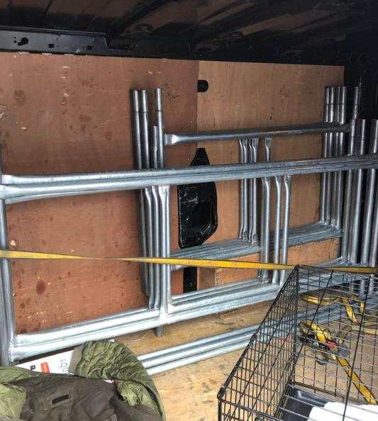

JohnBishop Posted August 20, 2024 Author Share Posted August 20, 2024 2 hours ago, SteamyTea said: I bought a cheap (£600) scaffold tower, makes doing anything outside easy. Takes me an hour to put it up, half that to take it down, fits in the car and I store it under the stairs in a self made box. is this something like this? I mean you paid twice as much so it must be a different scaffold Link to comment Share on other sites More sharing options...

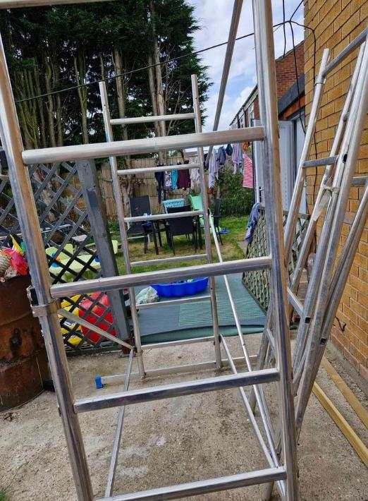

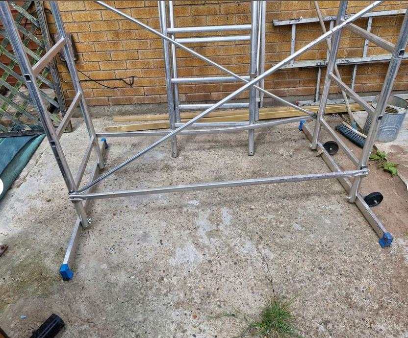

JohnBishop Posted August 20, 2024 Author Share Posted August 20, 2024 I also come across this aluminium one but I reckon this one is more likely to topple. Link to comment Share on other sites More sharing options...
joe90 Posted August 20, 2024 Share Posted August 20, 2024 (edited) 10 minutes ago, JohnBishop said: more likely to topple It has wide feet so I doubt it, mine was square at 4ft and steel, much cheaper than aluminium ones. https://www.ladders-999.co.uk/domestic-steel-towers.html Edited August 20, 2024 by joe90 1 Link to comment Share on other sites More sharing options...

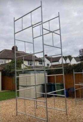

JohnBishop Posted August 20, 2024 Author Share Posted August 20, 2024 I can get a galvanised steel tower for £285 or this aluminium (used but like new) one for £300. The tower has a much higher work height I think. Link to comment Share on other sites More sharing options...

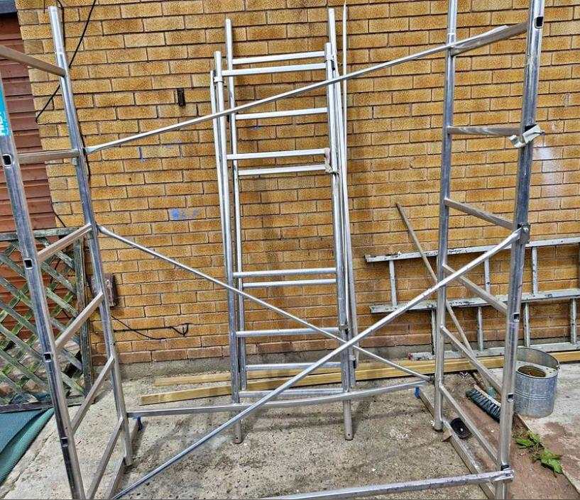

JohnBishop Posted September 4, 2024 Author Share Posted September 4, 2024 (edited) 4 hours ago, Bonner said: I bought a second hand MiTower (5m, 2 person) on FB, very solid and stable. Not cheap but should get back what I paid for it. right, I broke my back in the past and I am a bit hesitant to work from a platform that is not stable. This aluminium has certain advantages e.g. it's lightweight, does not rust but the whole scaffold is only 25kg. I am going to use it to remove the glass units from windows at about 4m so it's not like wall painting at a height. I am looking for some scaffold towers on Facebook Marketplace in the area but I don't see anything interesting apart from a bunch of scaffold hires and the guy selling these square steel scaffold towers for £285 but I need to get the boards on top of that and this also needs a ladder to climb it. Ideally I would want to climb one before I buy it. Edited September 4, 2024 by JohnBishop Link to comment Share on other sites More sharing options...
