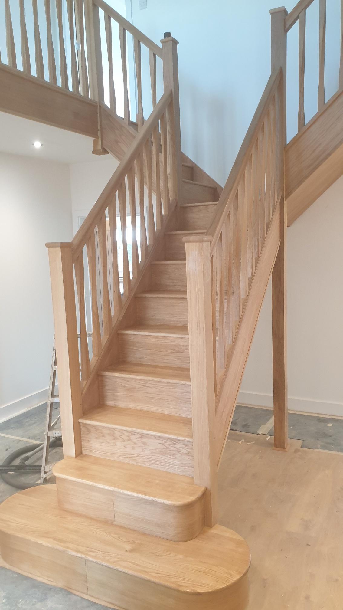

Faz Posted February 4, 2022 Share Posted February 4, 2022 Just done 3 plots in Osmo Polx Clear Matt - and my stairs come the think of it. Great stuff - well worth the money. Link to comment Share on other sites More sharing options...
Dave Jones Posted February 5, 2022 Share Posted February 5, 2022 shame about the join the bottom 2 steps. Link to comment Share on other sites More sharing options...
