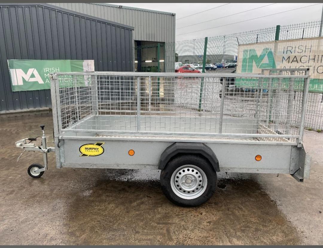

Iceverge Posted July 15, 2024 Posted July 15, 2024 However unless you're bringing lots of aggregate the tipping function is probably not needed. It adds a chunk of weight too so reduces your payload. A normal dropside flatbed gives the advantage that everything can be loaded and unloaded with a forklift but the higher bed can be more awkward to load by hand. I have an 8*4 trailer that a 1200*2400mm sheet will lie flat in but not an 8ftx4ft. Ideally it'd be 50mm bigger in both directions. It's only 230kg unladen though so it's super easy to pull (I used my 1.2l Fiat Panda!) and the ramp makes it simple to manhandle/wheelbarrow stuff in there. Would recommend. Same as this.
