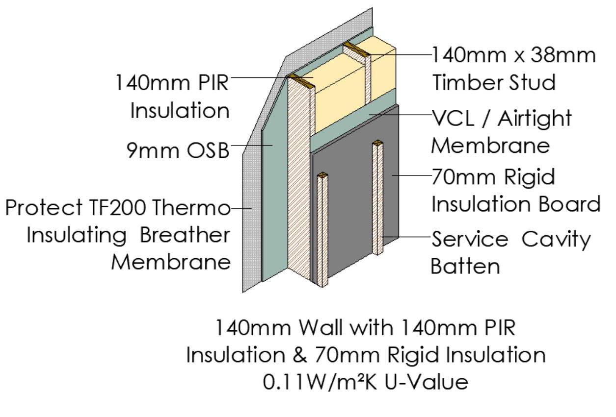

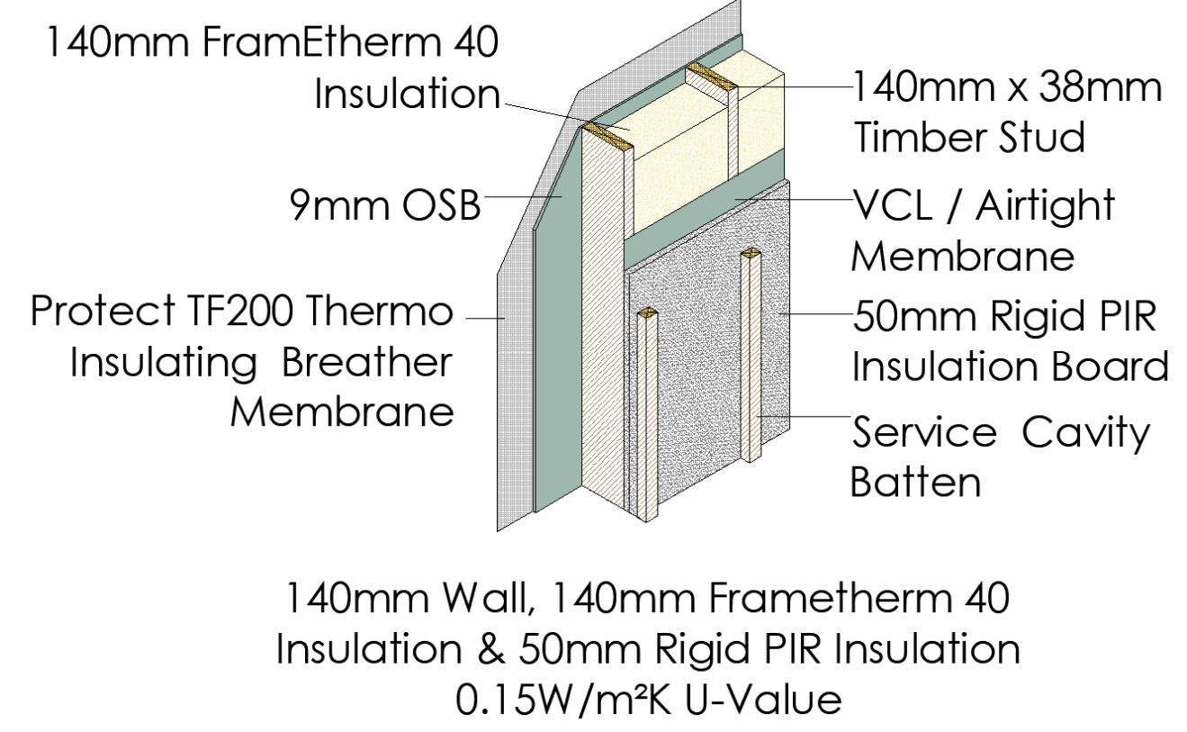

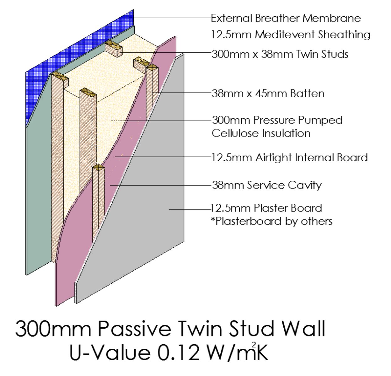

I'm looking for the advice from those who've gone with MBC for their builds with regards to the insulation that was chosen and how you feel it is performing?
We're undecided between MBC's options where the U value is 0.15 W/m2k or better (there is a condition of a maximum of 0.15, so that's the minimum spec we can go with. The goal is to have a balance between performance and cost, so a passive standard isn't on our set of objectives. However, we are mainly concerned with several other factors:
  • Longjevity
  • Sound Insulation
  • Air tightness
Cellulose appears to have the advantage in all three areas over mineral wool and PIR from the reading we've done. PIR appears to suffer from shrinkage, off-gassing (low u-value gases leaking, reducing the performance of the insulation overall) and doesn't appear as foolproof to install (inaccurately cut and fitted they leave gaps).
The main disadvantage is the cost of the cellulose option at+£10k on-top of our initial option of the U=0.15 mineral wool spec.
Any advice / experience would be really helpful! Thanks :)
Mineral Wool (MBC Upgrade to U=0.15)
PIR (MBC Upgrade to U=0.11)
Cellulose (MBC Passive Standard)

I can only comment on the MBC twin stud, filled with cellulose.  The performance is very good, in that the insulation value is pretty good and the decrement delay is pretty long, but the most noticeable effect is the soundproofing.  The house is very quiet inside, and acoustically pretty "dead", in that the reverberation time, even in our large, 6m high, entrance hall.  The result is that you can't hear what's going on outside at all, plus any sounds created inside the house seem to be absorbed.  We hadn't really expected this, but it's something that several visitors have mentioned, with comments ranging from "it feels snug", to being surprised at the noise (we're in a very rural area) when a door or window is opened.
I'm really glad we opted for the cellulose fill, as it seems to have so many advantages over the other options.
Like JSH i can only comment on the twin stud, although our last house was a SIP build.
We were and to some extent still are a fan of SIPS but having used MBC twin stud for the latest build i am glad we did. A lot is to do with MBC attitude and attention to detail but there are some aspects that are better in my opinion.
The foundation package and the lack of cold bridging are a the biggest advantage.. The studs inside the sips and other build methods are a cold bridge and the  need to add insulation on the inner skin adds problems such as fixing it to the frame
As JSH mentioned we found that the whole feeling of the house changed when the cellulose was pumped in and it is some much quieter than the sip house.

If money wasn’t an issue (which is never the case) I’d probably go with the cellulose. To be fair in you’re first option where you’ve Frametherm between the timbers, this is a mineral wool which will be tightly fitted between the joints. It’s also good at sound absorption (not as good as 300mm of cellulose but that’s a lot thicker and more expensive). The PIR that’s put over the wall hasn’t many joints as it’s placed over the whole wall and not cut between all the timbers. The second option of the 0.11 u-value where the PIR is cut between the timbers I’d be more worried about as that’s a lot of cutting with a lot of potential gaps. PIR is getting expensive and has crept up in price a huge amount over the last 12-18 months. A lot of the additional cost in the cellulose option is the additional timber. A compromise could be option one but with 70mm PIR insulation internally instead of 50mm which would reduce you’re u-value slightly while still having a low cost and the advantage of the sound reduction of the mineral wool. PIR doesn’t really do sound reduction like the cellulose or mineral wool. Of course you could always look at using the blue acoustic plasterboard internally on the external walls instead of the standard grey. This would really help with the sound if this is a concern and might be a more cost effective option.

I have gone with the 140 mineral wool between the studs and 50 PIR in front - so the first option.
my issues was the same as your in that the cost to the cellulose was hard to justify.

We have 300mm of cellulose in the walls and 400mm in the roof and are pleased with the outcome.  Not only is the thermal insulation good, but it has a high decrement delay and it works as very effective sound insulation, too,

The U Values being quoted in the images you've supplied are for a theoretical wall section with studs at their standard (300mm/400mm/600mm) centres. With the extra timber that will be needed within the walls around window and door openings or other structural elements such as supporting a ridge beam etc. the actual average U Value will be higher.
Depending on the wording of the condition, you may need to go for a wall build up that provides a theoretically higher U value, such that the actual U Value meets the condition.
You're right there @IanR, that's for the whole wall but I can double check when I get back from germany. We'll be adding not much more to the wall. A single layer of fermacell internally and vertical timber on counterbattens outside for cladding, so I'll have to do the calcs for these. It's another reason why we opted for cellulose at 0.12, gives us some leeway!
