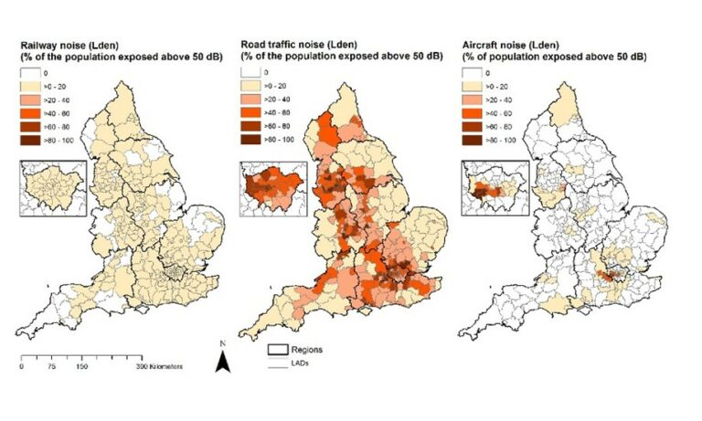

SteamyTea Posted May 29, 2024 Posted May 29, 2024 (edited) Before installing an ASHP, it is worth checking the background noise levels. Even quiet roads can be quite noisy. Edited May 29, 2024 by SteamyTea
Moonshine Posted May 29, 2024 Posted May 29, 2024 (edited) On 29/05/2024 at 17:30, SteamyTea said: Before installing an ASHP, it is worth checking the background noise levels. Even quiet roads can be quite noisy. Expand Not useful data, background noise levels are typically the LA90, this is Lden, which adds corrections to the evening and night period. Also this is % of population exposed to different noise levels. Background noise levels are very site specific. Edited May 29, 2024 by Moonshine

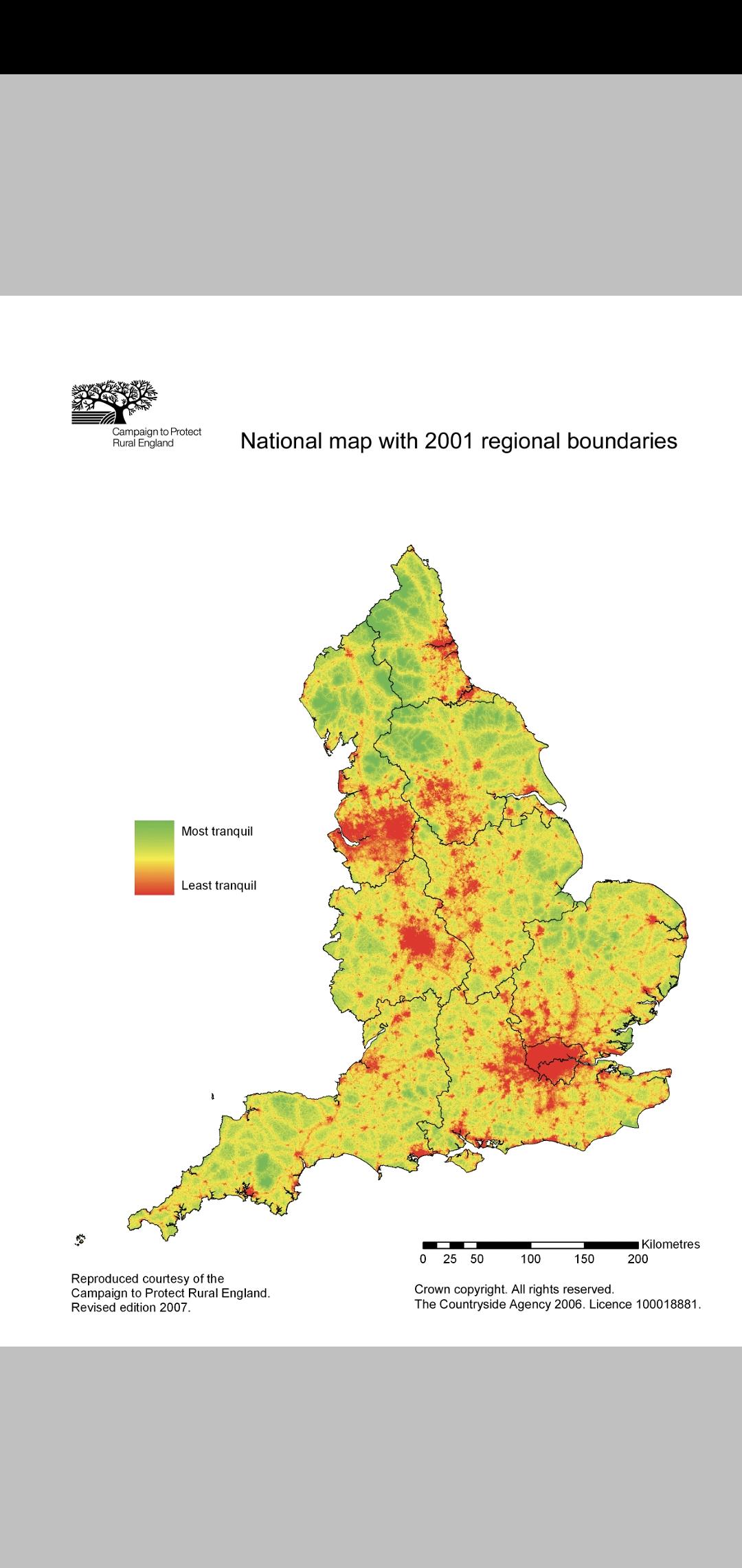

Moonshine Posted May 29, 2024 Posted May 29, 2024 this is better, areas away from roads are more tranquil 😀
