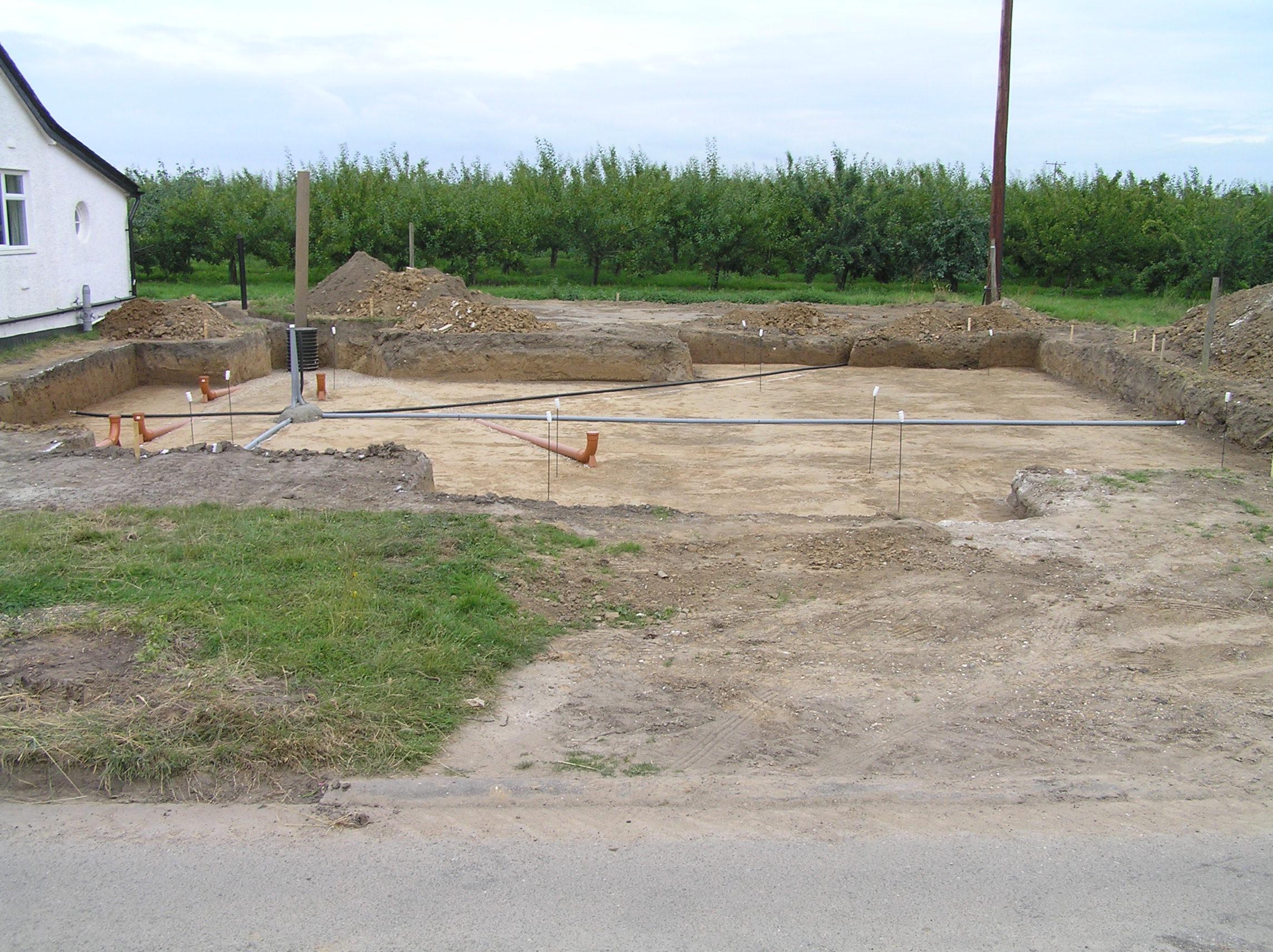

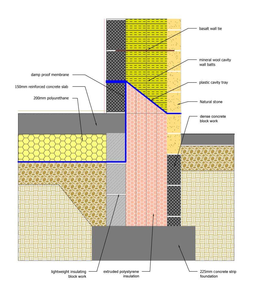

joe90 Posted May 30, 2024 Posted May 30, 2024 On 28/05/2024 at 09:50, Mark Greenfield said: We (my wife and I) like the idea of a passive foundation slab, but can't find a company that will help design, supply and do all the work. I too was in that situation so went with strip foundations but well insulated like this…
