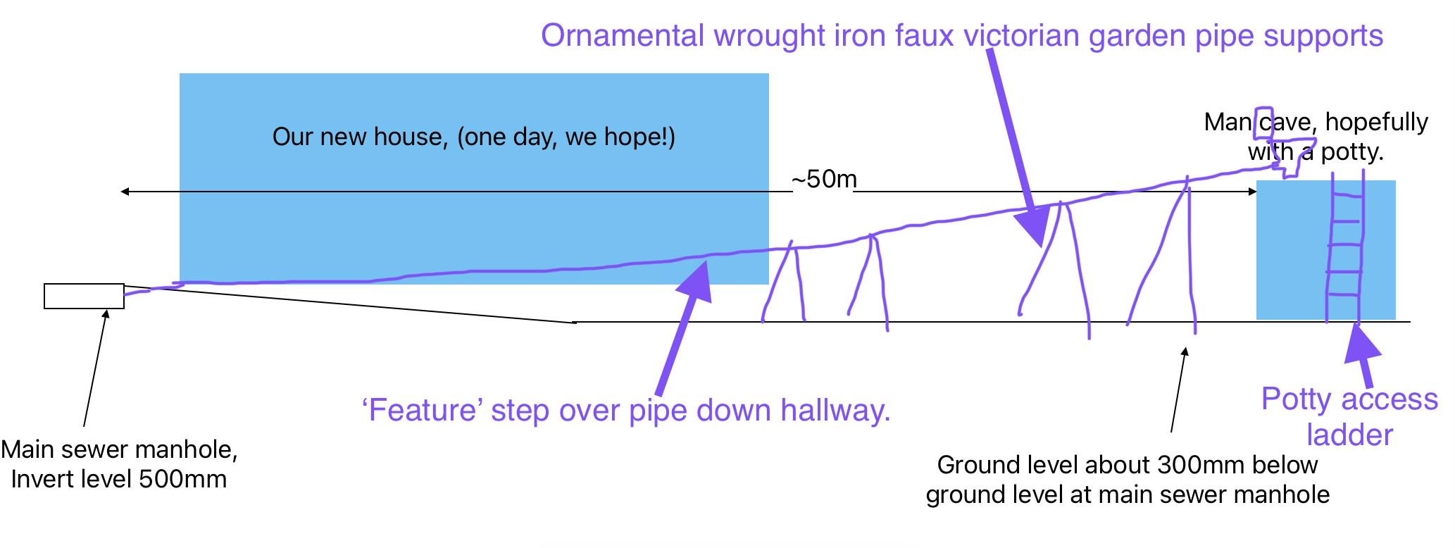

Ok, so if I adhere to the no poo rule then all I need is a bush. In fact, that was the on-site welfare arrangements we had when we built the first time.  It was a different world back then.
We've got bushes so that option is free.
Option 2, a macerator looking at circa £500 inc piping but opinions vary about feasibility.
Option 3, a chamber and pump, circa £1,200, appears feasible but some think it’s overkill.
Option 4, compost toilet - don’t know how much as I can’t contemplate it. Rather use a Thetford potty like in our campervan and I’d rather go without than have that.
Unless there’s no other options I can focus my research on options 2 and 3.

4 hours ago, Russell griffiths said:
will 100% not work in your situation
distance is to far, pump not powerful enough
So one of us is wrong. Tables show that 50m is no problem for a £300 unit.
Speak to the manufacturers...they might just know.
@Russell griffithswould be worried about a blockage. My ducting insurance with a pressure pipe all the way in it makes theoretical problems sortable.
Big commercial pumps have a big tank in case of  power cut,  and a spare pump in case one fails.
your plan b is to go round the back and plan c is to go into the house.

2 hours ago, Dave Jones said:
dont bodge it with macerators. pumped chamber is way to go.
I understand and appreciate your ‘do it right’ sentiment, but I’ve a nagging feeling that following that mindset might land me in ‘merde’.   I’ll explain.
Potty in man cave sits on floor whose level is just above the invert level of the sewer manhole at the front of our site.  If I dig a hole and put a pump in it, somewhere between the two, wherever I dig it in case of inevitable malfunction gravity ensures said hole receives all the nasty stuff that’s in the system.  Nasty.  Even if it’s only fermented pee.  In this case gravity is not my friend.
Imagine I lay a continuous length of black, 32mm pipe, from the potty, thence down into my duct, then more or less horizontal till it reaches my house, at which point it rises enough to finish its journey to the sewer manhole with a 1% fall.  One great big extended u bend.  Then imagine the macerator fails.  Unless an emergency has recently happened the pipe will be full of only (admittedly stinky) liquid.  I disconnect the macerator (if it can’t be fixed with a nose peg and rubber gloves) and the pipe just sits there, gravity in this case being my friend.  Maybe I can even attach a garden hose to flush it, there’s a thought.  Worst case new macerator, but I note some have five year warranties so that should cost me too often.
Unless, of course, I’ve missed something essential. Yet again.

So, I’ve done my measuring with my water level.
Oh dear.  Ground level around my man cave if 550mm below invert level of sewer access manhole at the front of my site.  Sigh.  I will never truly trust a laser level again.
I think that means a rethink …
  • Sad 1
Link to comment
Share on other sites
I did like the macerator plan when I thought the macerator would sit just above the main sewer manhole invert level.  That way if I disconnect the macerator there would be no backflow, and I could even flush the small bore waste pipe with a hose connection.  I know macerators can handle constant back pressure but everything goes wrong eventually and it’s not a good prospect if a load of filthy water escapes when dismantling.
I appreciate that a pump station is a proper job but I think the notion of dealing with a failed pump in a manhole full of filthy water really doesn’t appeal either.
I think it’s either put my potty on a 500mm pedestal or give up on having a potty.
Something is wrong if it does.
Pumps don't often fail. Yours would be operating for what? 5 minutes a day?
To do maintenance you hire another pump, or a tanker service, pump it out and sort it.
A very cheap and easy solution. I vote for that.
